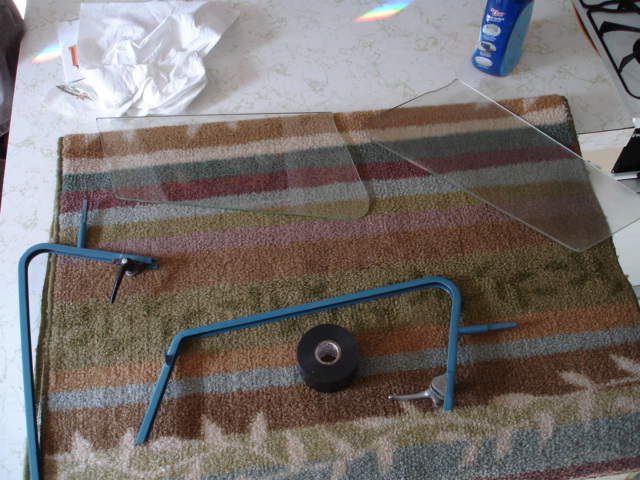

I started putting my door window frames together today. Everything when together real easy and as always the vent wing is a bitch. The vent wing seal that came from WW didn't work out so well for me so I thought I would share my process. I used a rubber mallet, some 3M 2242 Rubber Tape, and a exacto knife. The 3M tape is the secret here, makes the the installation real easy. I have outlined the process below with a pics.
Here is were I started.

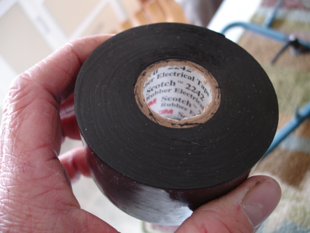

I used 3M 2242 Rubber Electric Tape.

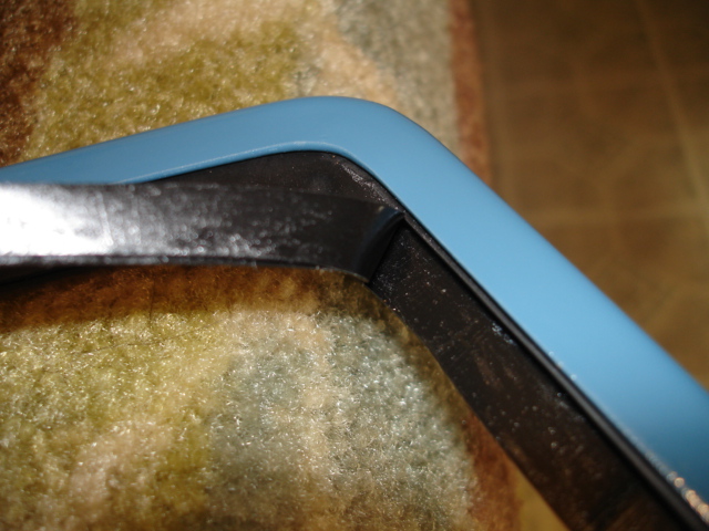

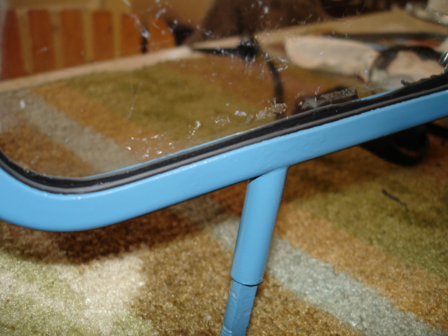

Wrap the tape around the glass. I used 2 ply thick. Its stretches around the glass real easy.

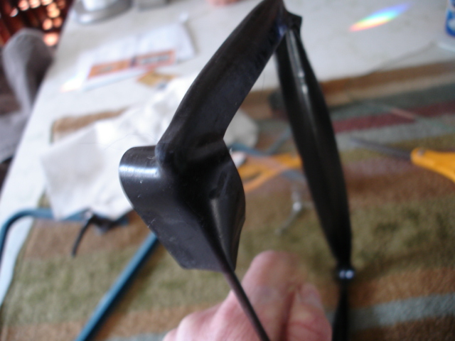

Smooth the rubber around the corners.

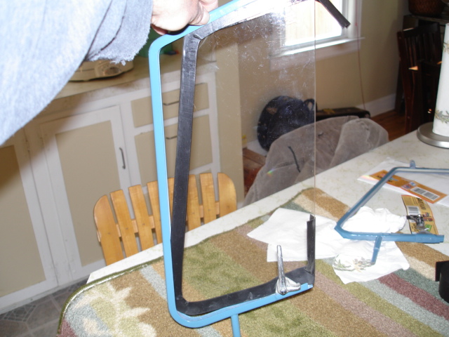

Slide the glass in the frame. It went in real easy for me. If it gets hung up use some soap water, or KY Jelly, Yes i said KY Jelly.

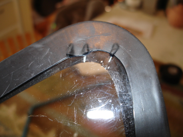

There is a bit of excess hanging out after you get it pushed in all the way.
Trim off the excess with a exacto knife.
After the seal is trimmed.

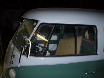

The window is in. And the tools of the trade.
I didn't apply any window rubber sealant or what ever to keep the glass from sliding out. But honestly its in there really tight so I dont see it being a problem. I hope this helps, good luck.

you forgot the rain deflector & the latch is for the wrong side.

Yeah I know, I didnt install the rain gutter by choice. Figured it would be easier to trim the seal without it there. You dont really need it there anyways.

Hey Buster, Where'd you get the tape? I've looked at a few different hardware stores and couldn't find it.

http://www.jamestowndistributors.com/userportal/show_product.do?pid=3879&PTECH Here is a place online

That tape is available at the depot. Its in a special section of electrical tapes, the bigger widths and such. Not in those bins with the crappy .49-1.99 tapes.

I believe the new rubbers are supposed to be thick. It's only a press-fit. If it is loosey-goosey in there it will fall out, while driving.
I wouldn't use electrical tape.

Found the tape at the Depot today and finished my windows. They look great. I forgot the drip guard in the first one (Even after reading this. Guess I'm a dumbass). I took it apart to add the drip guard, and let me tell you it was a beeeotch getting it apart. If you screw up, take all of the tape off and do it again. It stretches and bunches up the second time around. Do it right the first time, pay attention.
