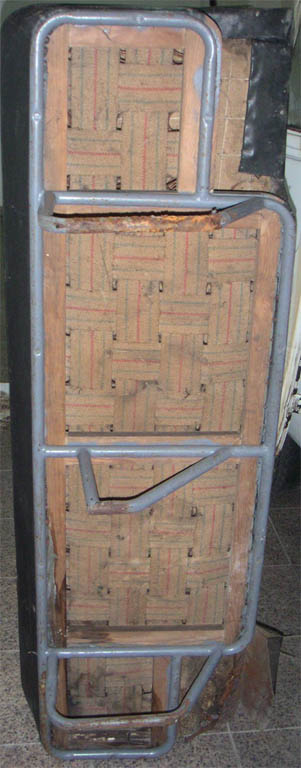

Barndoor:
Barndoor only, although the Barndoor rear seat base may be the same as a 1955 Bus rear seat base.
Barndoor rear seat back rest photos:
http://www.thesamba.com/vw/forum/album_search.php?search_keywords=Barndoor+rear+seat+back+rest
Barndoor rear seat base photos:
http://www.thesamba.com/vw/forum/album_search.php?search_keywords=Barndoor+rear+seat+base
55 is considered "55 only" (may be same as Barndoor)

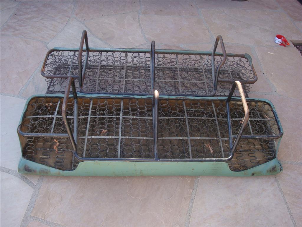

Mid-63 rear seat base design change photos
http://www.thesamba.com/vw/forum/album_search.php?search_keywords=rear+seat+base+comparison
Example (note twist on left-hand leg here for primary difference)
In the photo above, the early seat is the bare frame, the mid-63-up frame is in green upholstery.

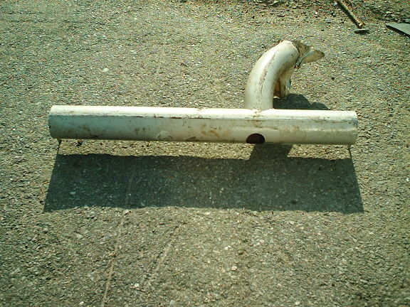

Other:
Back seat back rest mounts
https://www.thesamba.com/vw/forum/album_page.php?pic_id=218219
Mounting information for the bracket above:
The above bracket is from a '64 Deluxe.
The single bolt is M6x15.
The 2 machine screws are M6x15. 1.00 thread pitch.
My '63 has 2 machine screws:
M5x15 0.8 thread pitch

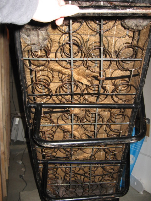

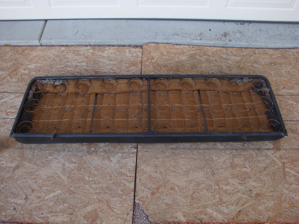

Cargo floor seat mounts:
57 and earlier "big spring" seat design:
58 and later spring design:

I would like to see the spring on a 53 earlier middle seat and back seat i'm assuming they're different like the front seat
