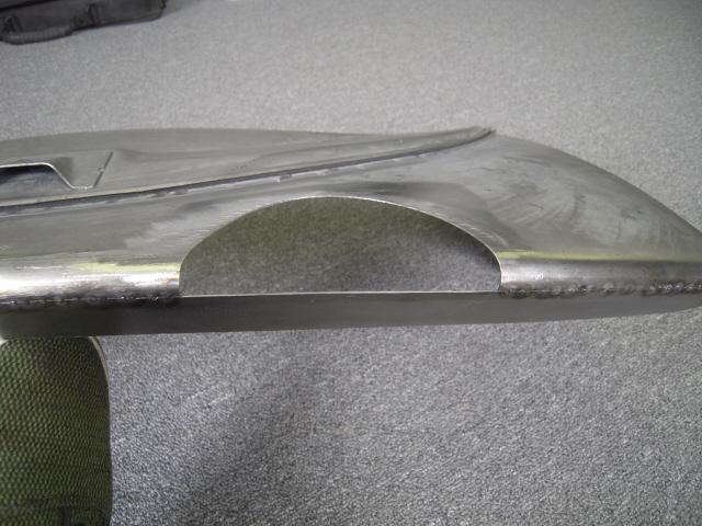

Filling rear apron.First I cut out bottom and tacked new bottom on a NOS apron

Everything welded,ground,hammer'd and file'd flat

Another angle. NO filler need'd

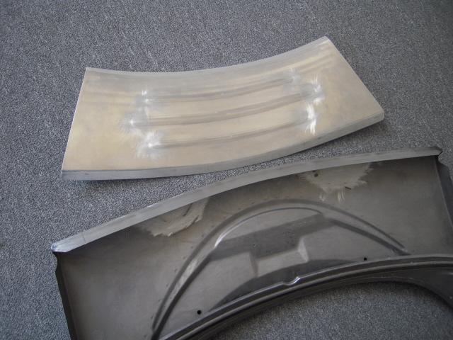

Thought it might need some extra strength where I removed stock inner structure, So I made this to mount back in.
Shipping is NOT included in any of my products or parts. Just want to say thanks from GAB-FAB for any purchase!!

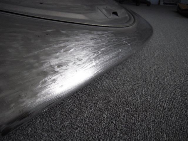

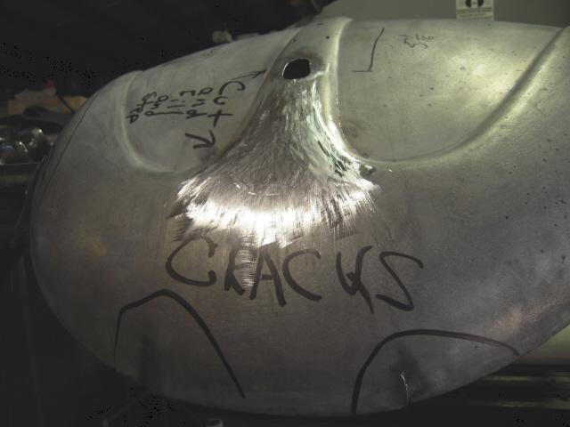

What I started with before repairing hood handle area

After fileing and grinding holes, Made and tack welded new peice's in

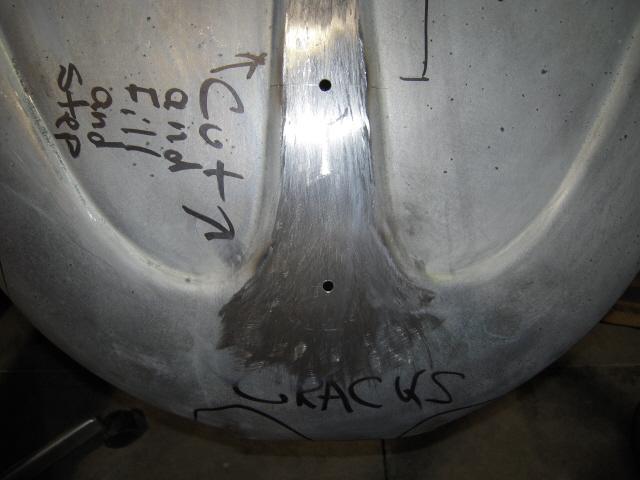

Now I tig weld useing .023 steel rod

Now I use my cut-off wheel and shave down weld. I try to only grind weld and save the metal

Now I finish by hammer/dolly work and file area flat.

I machined a male/female die for embossed hood handle area
