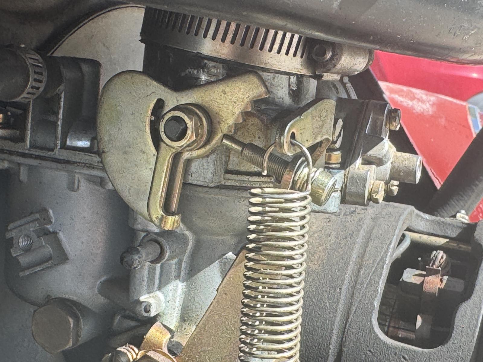

PostPosted: Sat Jun 28, 2025 4:32 pm    Post subject: Throttle lever setting? Reply with quote
I’ve searched and watched and googled but I can’t find much information on this part. I believe it’s called a throttle lever according to what I’ve been able to learn. IF this thing is closed at startup, my engine will flood. If it’s open it will start right up. What’s the proper adjustment and where should it be on startup, and running?

That's the fast idle cam. There should be a choke thermostat on the opposite side of it. Sounds like you need to adjust it. When adjusted properly it'll start up on fast idle and as the choke thermostat warms up the cam will drop down to normal idle speed.
thanks! Off to google adjustment procedures.

PostPosted: Sat Jun 28, 2025 5:06 pm    Post subject: Re: Throttle lever setting? Reply with quote
https://www.youtube.com/watch?v=dTSekv82ZMQ&t=66s

PostPosted: Sat Jun 28, 2025 5:15 pm    Post subject: Re: Throttle lever setting? Reply with quote
Thanks Ray.
Now I'm wondering if it really was the trailering, or if *I* actually flooded the engine when we got home. I pumped the accelerator before I knew they actually didn't need that. Because when my engine is cold, and you hit the accelerator, the lever actually goes ALL the way down and the butterfly is completely closed. cutting out most if not all the air to the carb.

PostPosted: Sat Jun 28, 2025 7:21 pm    Post subject: Re: Throttle lever setting? Reply with quote
You are doing it correctly. You give the pedal a pat to allow the fast idle cam to set to the cold start position. This also gives a shot of gas out of the accelerator pump to help prime the cylinders. Then hit the key an the motor should fire right up and idle fast. Another pat on the throttle allows the choke pull-off diaphragm to pull the fast idle cam to a lower rpm setting.
For the summer time I would adjust the choke bimetal coil so that the choke butterfly has about 1/4'' of air gap. Adjust the fast idle to about 1200 rpm. This all takes some tinkering to find out what your combination needs to give you fast starts but not be prone to flooding. You also have to experiment with starting techniques.
I would also check the fuel level in the bowl to make sure it's in spec. It sounds like it may be a bit high which makes it easy to flood the engine.

PostPosted: Sat Jun 28, 2025 7:24 pm    Post subject: Re: Throttle lever setting? Reply with quote
I was wondering about this. I bought this car from an hour north of Ft Worth, and I live about 10 miles off the Gulf on the coast. I was curious to know if ambient air temp means I am going to have to adjust the choke seasonally.
And there's NO gap whatsoever if you hit the gas pedal and set the choke. It goes to completely closed. So I definitely need to adjust it.

PostPosted: Sat Jun 28, 2025 11:54 pm    Post subject: Re: Throttle lever setting? Reply with quote
The butterfly control screw looks to be in way too much
https://www.thesamba.com/vw/forum/viewtopic.php?t=435993

PostPosted: Sat Jun 28, 2025 11:57 pm    Post subject: Re: Throttle lever setting? Reply with quote
It's ALL the way in. That's how it was when I picked it up on Thursday. I haven't turned a single screw in that engine yet.

PostPosted: Sun Jun 29, 2025 6:09 am    Post subject: Re: Throttle lever setting? Reply with quote
CoastalBug wrote:
Your car has a lot of POP!!!!

Buy the Bentley manual if you didn't get one with the car. Then start going through the car one end to the other. First is the carb. Then the distributor. Then adjust the valves. Change the oil. Inspect the entire brake system. Normal stuff on any used car.

PostPosted: Sun Jun 29, 2025 10:04 am    Post subject: Re: Throttle lever setting? Reply with quote
Disconnect NEG of coil
Air cleaner off
Key on
Amount of time needed for choke to fully open -
3 to 5 minutes (3=summer & 5= winter)
Adjust accordingly
THEN set fast idle cam screw
unscrew the PO's "screw up"- off the cam
screw should JUST touch cam then 1/4 turn, no more
DO NOT TOUCH AGAIN
Fuel, air, & idle are done using the screws on left side of carburetor
Works for :
30PICT/3, 30PICT/4, 31PICT/3, 31PICT/4, & H30/31

PostPosted: Sun Jun 29, 2025 3:39 pm    Post subject: Re: Throttle lever setting? Reply with quote
Adjusting the choke seasonally is mandatory here.
One of the few things I take issue with in the "Keep your VW alive" book is John's opinion and treatment of the choke. He is completely out to lunch on that issue! If I could reach back through history I would grab him by the bong and drag him and his chokeless car up here to Canada in the dead of winter and video him trying to get it started! It would be hilarious!
