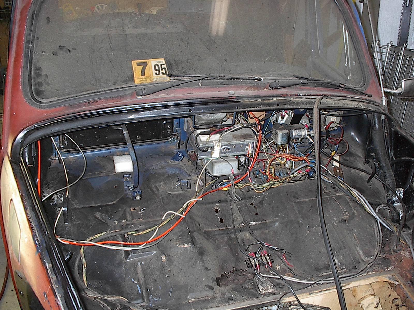

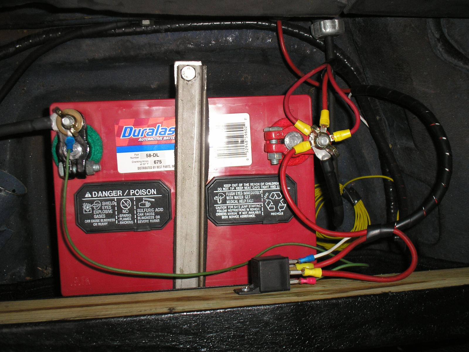

use as inspiration to wire my beetle better!
I rewired it the way the Germans should have done it if cost wasn't an issue. In the photo you'll notice my main wiring harness goes into a EMT conduit to under the rear seat on the passenger side where the battery is. Main reason I did that way was the replacement heater channels didn't have the two holes for the harness to pass thru as shown in the photo.
under the rear seat wiring
what I started with
I use only T&B crimp connectors. They are tin plated copper. Close up of how I installed a brake light test connection. Put 12v on it to see if the lights or the switch is the problem.
