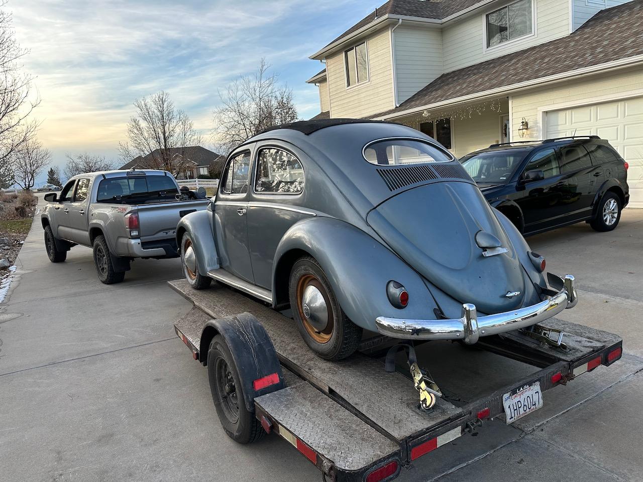

I made plans with the PO to come out two weeks later with a trailer. The car had a lowered beam and a tunnel transmission that we needed to take out and replace with the stock beam and a split case transmission as per the agreement. Thankfully the original beam was saved and will now live in the car once again.
Two weeks later, I drove out from Los Angeles to Denver with a trailer and picked up the car. It was a crazy trip given I decided to cut some time off the leg out and went north through Vail. Thankfully I opted for a 4x4 when I bought my Tacoma or I would have been in pretty bad shape. Even with a 4x4 the drive through Vail was nuts. It was 2 hours of white knuckles. On the way back I decided to not risk it and went the southern route through Albuquerque. Other than a lot of rain, it was uneventful. I made it home safe with the car in tow. Let the restoration adventure begin!

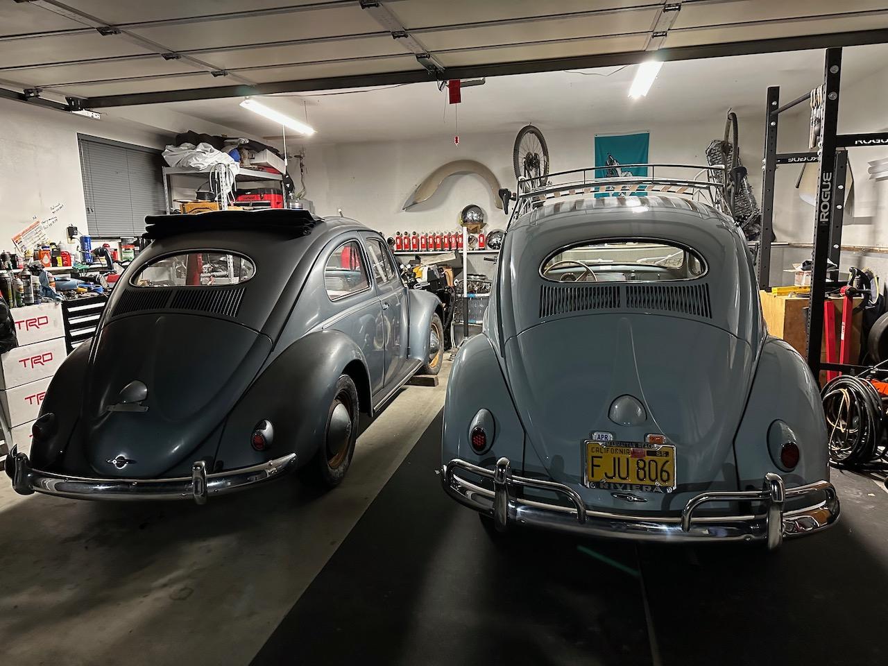

Thanks for posting this up lardawge. I'm with you on starting a thread to ensure the motivation to keep things rolling and getting the project done.
That looks like a really clean car and I love the pic of the two ovals side by side in your garage. What a treat. Looking forward to "the plan"...

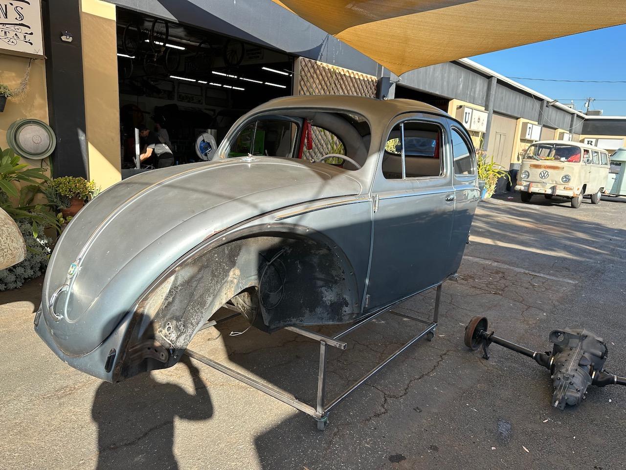

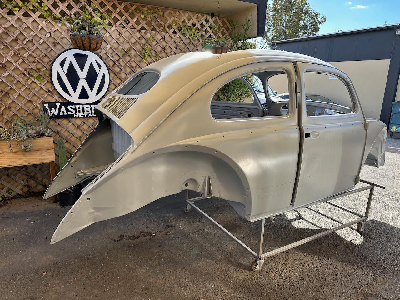

I went about stripping the interior and pulling the top so that I could get it sorted. I then made plans to tow the car down to Washburn’s Metal to get the rear apron repaired and see if we could get the heater channel patched.
Full disclosure, I do not do metalwork. I do have a good idea of what it takes to do it and understand how things go together and what it should look like when successfully fixed. In my mind, I thought we could just patch the panel behind the running board and call it a day. Remember, at this point, I am thinking to drive it then worry about a full restoration and correct repair later.
Brian gets eyes on it at which point he points out the crack in the inner apron as well as cracks just in front of both bumper brackets and informs me the pan has to come off to do the heater channel repair. Ugh. The main reason I didn't want to pull the pan was that I didn't want to risk breaking bolts off in the body. Usually, any amount of rust in the heater channel adds to the risk. The upside of doing this is that I could repair/replace the stuck choke cable tube as well as powder coat the pan. So I agreed that would be the path forward. Thus starts the run down the rabbit hole.
Brian was kind enough to lend me tools and space and I went about the process of removing the car from the pan. I was amazed at how easily the pan bolts came out of the passenger side. I didn’t start having issues until I got close to the damaged area on the driver's side. That was a good sign because it meant that we could likely replace only the affected area. I was able to get all the bolts out without issue (penetrating oil helps). It took me about 2 hours to get the body off the pan and strip the pan down for sandblasting.
At this point, I was sticking to the original plan with the addition of a restored chassis. I then went home and slept on it over the weekend. The more I did the math, the more sense it made to put the 55 on pause and get the 54 ready for paint. I have been wanting a 3-fold for as long as I have been into VW’s. I don’t know how many cars I want to restore. It is a painful expensive process and finding parts and good skilled people to help is extremely difficult. So I made the tough decision to stop work on the 55 and sell it if possible. The only thing it would take is convincing Brian to take swap cars and take on the 54 (the 55 was already being worked on).
Thankfully, He was up for it. He was working on the rear apron on the 55 and agreed to finish it while the 54 was at media blasting. We would save the rest of the work on the 55 for a later date or a new owner. So I went about stripping the 54 down to just the body so we could send it out and get it blasted and epoxy primed. That took about 2 hours and again, Brian was kind enough to let me take up space in his shop to do it.

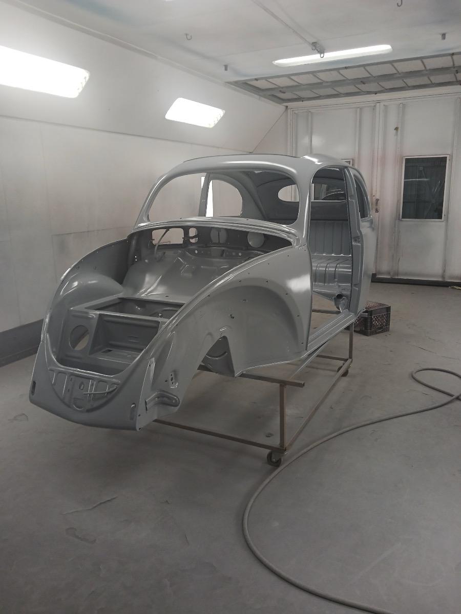

New plan, full restoration. The other kicker, I am going to change the color from Strato Silver to L275 Light Beige. It is such a classy color and even nicer on a ragtop. This is probably the most controversial part of the build. I would likely not do that if the color was listed on the Birth Certificate, but given it isn’t, it is getting a color change. It is going to be bone stock as it would be driven off the showroom floor.
Post Media Blasting
Epoxy Primer
