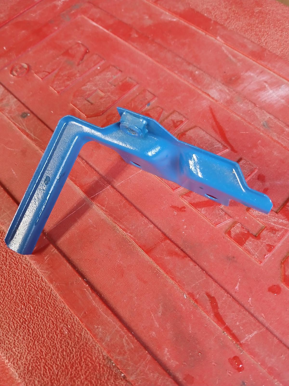

ook this off about 8 months ago, think it was on the trans axle ? Its stamped VW. Where does it go?
Since I'm here, should the clutch and throttle cable be sleeved both new cables are not, this is a sand rail I am restoring. Thanks in advance

its called a hoover bit . helps seal around the oil cooler . 1600 dog house ..
https://www.cbperformance.com/product-p/1743.htm?s...FkDdIUFVdX

Often eliminated due to misguided thinking. It does make a difference in the cooler of #3 cylinder.
