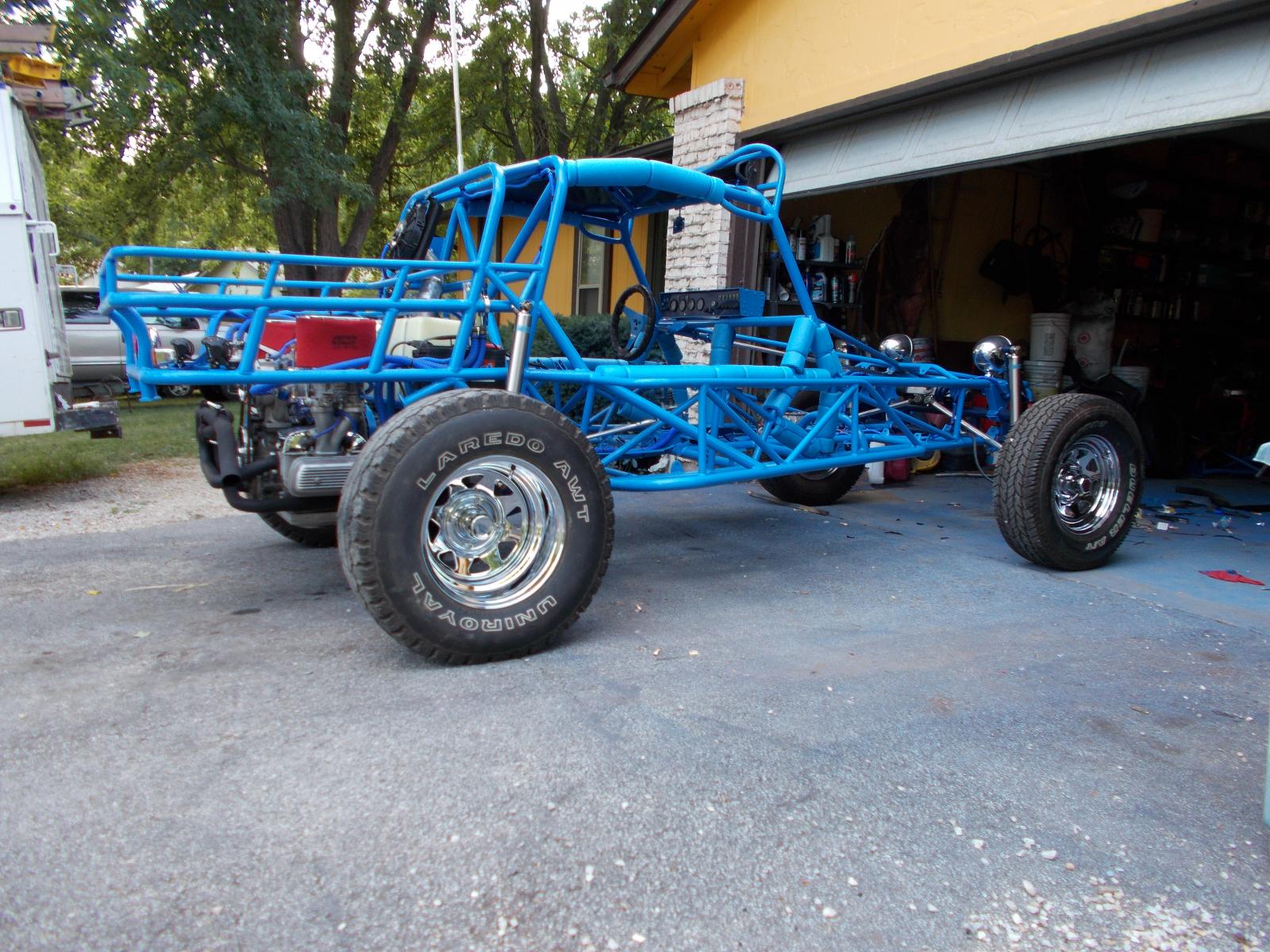

10 gallon jaz cell. Foam filled. Roll over valve in the vent, rubber flap on the fill neck. Opaque enough to see the fuel level.

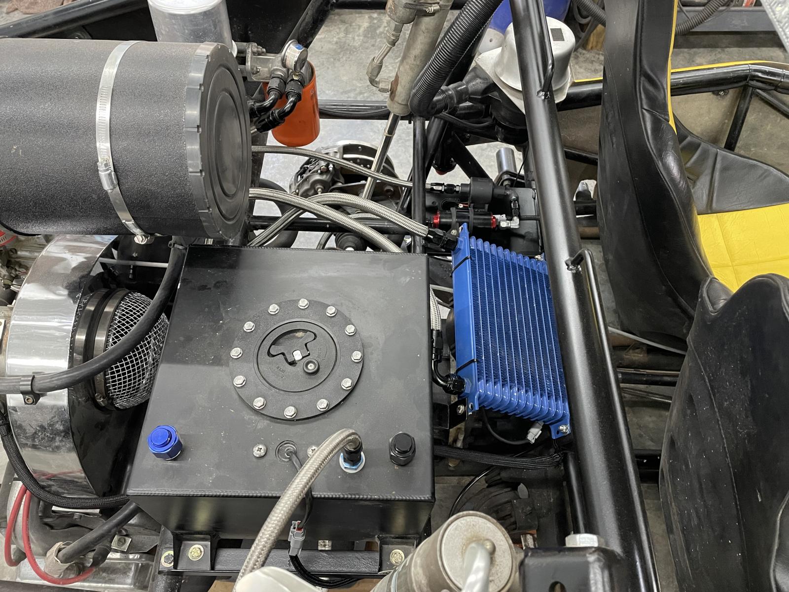

Old photo, but this is the 5 gallon cell I'm running for now. It has a typical sending unit wired to a fuel level gauge on the dash and a small sumped outlet going to the external pump.
I may consider swapping to a larger tank over the Winter; haven't decided yet. Thus far, it's been fine.

Better photo:
