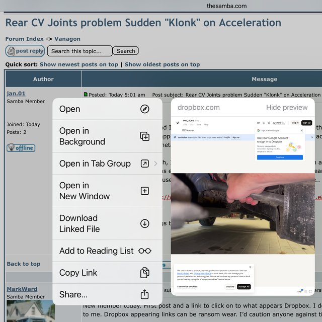

The play that I have: https://www.dropbox.com/scl/fi/xuuzcmr81eu11pnkmfq...e&dl=0

New member today. First post and a link to click on to what appears Dropbox. I don’t click on links, but this seems suspect to me. Dropbox appearing links can be ransom wear. I’d caution anyone against till we have more details.

Regarding the Dropbox link: it is just a plain video I recorded it with my phone showing the play I noticed. I don't know what the custom way is to upload a video.

FWIW, preview on my iPad appears legit…proceed at your peril:
OP: Maybe you’ve already discovered, but Samba currently only supports direct links to YouTube & Vimeo. Perfectly handy if that’s your platform, otherwise we get stuck here in the weeds.
