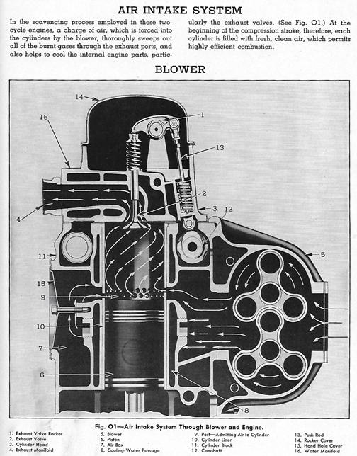

Put the intake ports in the barrel like a proper two smoke at least. Like a detroit diesel

I was thinking perhaps reverse that, put the exhaust ports directly in the cylinder and run intake valves fed with a supercharger. It could encourage a top to bottom scavenging and the intake valve runs cooler (especially since it will have less time closed). Of course, the boxer design means that 2 opposite cylinder reach TDC at the same time. On a 2-stroke that means they will fire at the same time -- put that wasted spark ignition to good use.

But I bet one could do a really bad job of it in a day and it could run, just enough to prove it can.
We agree it is not a simple job to fully prove what a bad idea this is.
People don't realize right away, that it's not gonna make any more power unless you can flow more AIR through it.
You've got twice as many intake strokes, but each stroke is only half as long, so perhaps it would move the same amount of air, except that whole intake too long problem just got twice as bad.
and
If the cam duration is only 140@ .050 how much lift could you even get? Not much
That's two of the many reasons you put the intake ports in the cylinder.
And I think it would be better to have variable timing on the exhaust valves rather than intake.
And the head can take more heat than the cylinder
So that's four

Here ya go. Just drill some intake holes down low on the cylinder, weld the intake on the heads up, custom grind a cam for the exhaust valves, and slap on a blower. Easy peasy.

PostPosted: Tue Jul 22, 2025 1:07 am    Post subject: Re: Converting a VW flat 4 to double the power strokes Reply with quote
Yeah, I love those old detroits. Miss hearing them in the fire trucks and big rigs. They could just sing. Haven't worked on one in a long time. Used to rebuild the heads for the army.
Still have a pile of spare rockers and bits for them, can't bring myself to throw it away, just very neat design. Check out the spring on the lifter!
Story was they'd never pass any kind of smog regulations.....but, they really gave up on that BEFORE any of this variable valve timing and high pressure electronic injection, and soot filters, and all that even hit the scene.
So it's a darn shame they went extinct, at least the small ones did.
There is still the opposed piston cummins ACE (advanced combat engine), but that's a thousand hp
I'd like to have maybe a small one, maybe a two stroke motorcycle that doesn't blow up every other season.
