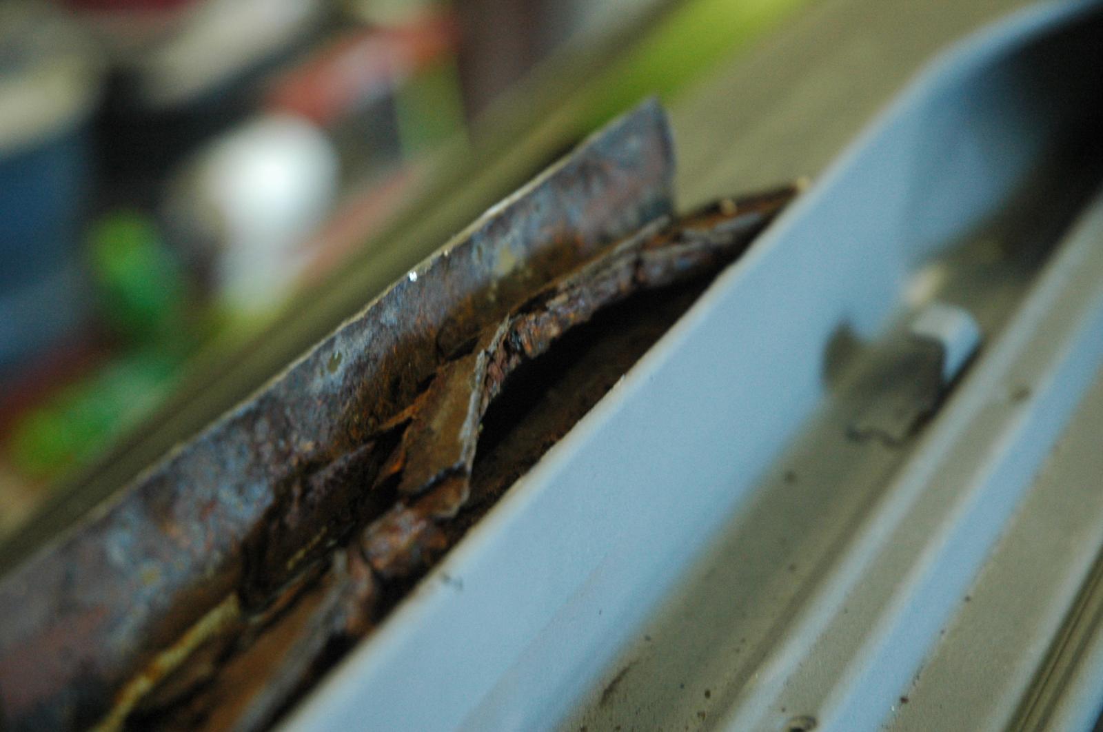

This was mine before media blasting followed by after blasting followed by what was under this. Three layers of metal which are upper roof, sunroof pan and the bracing pan. It is a lot of work, and there is no easy inexpensive fix. It takes a lot to get replace all the rust. Then add in a new headliner and all the worn sun warped sunroof parts - It is easily a $2500 - $3000 USD venture that someone will not pay that much more for a working sun roof.
