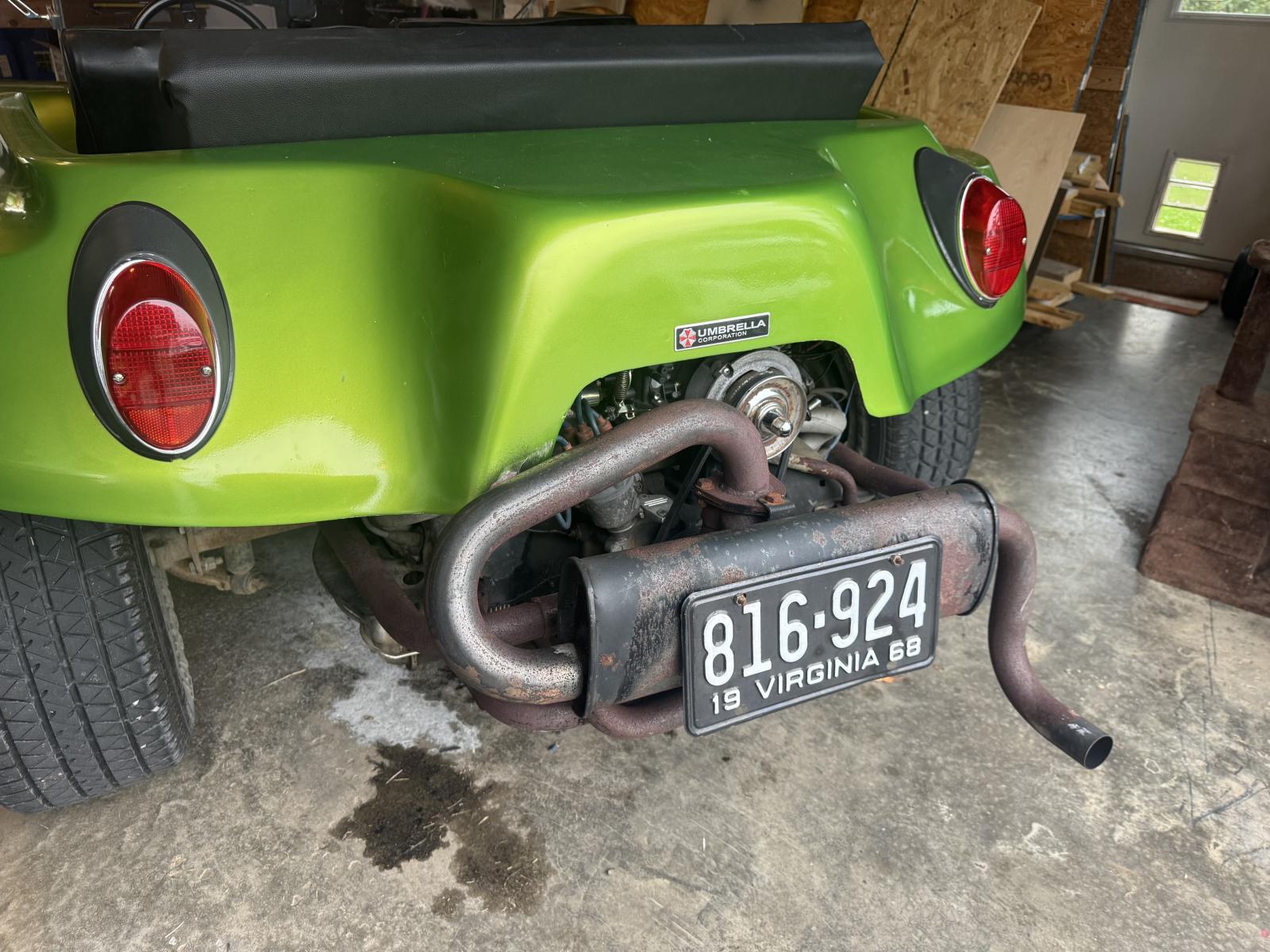

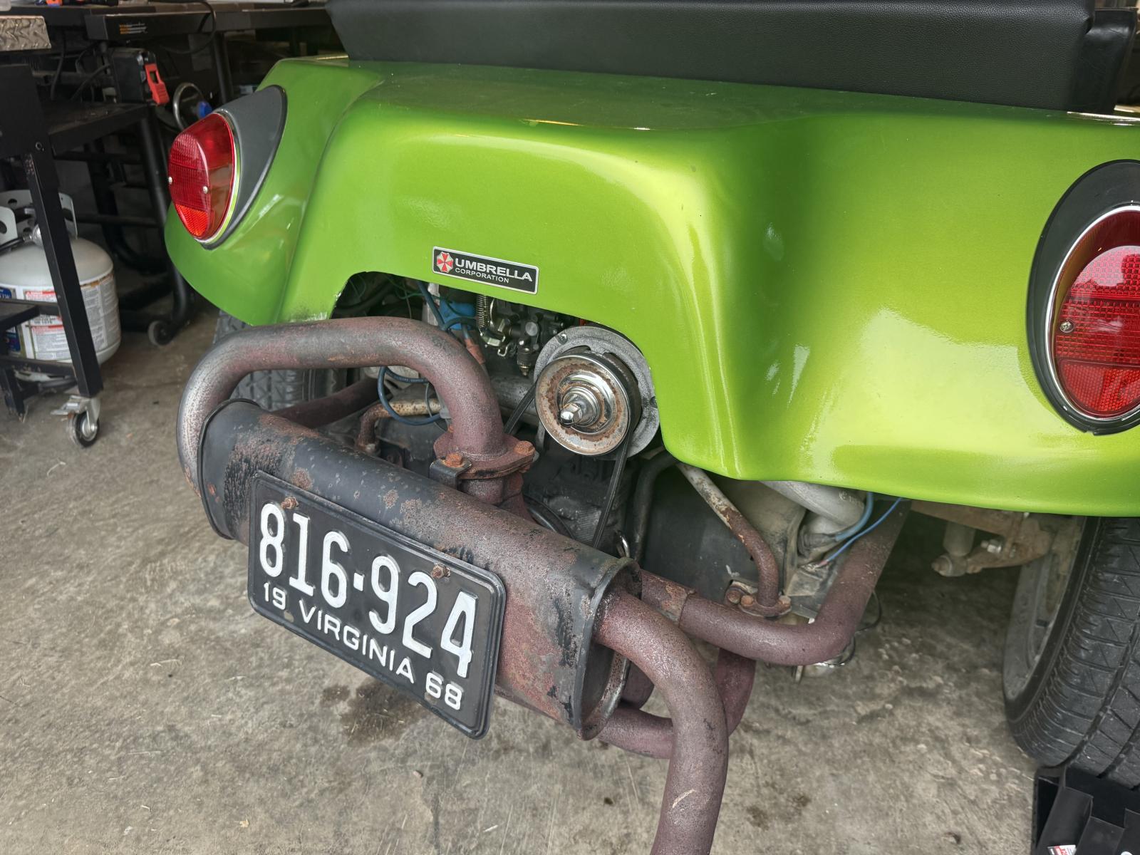

Here’s a few photos:

PostPosted: Tue Jul 08, 2025 3:53 pm    Post subject: Re: Alternator Change on 1968 Bug with Manx Dune Buggy kit Reply with quote
Take the engine out.... 4 bolts.

PostPosted: Tue Jul 08, 2025 4:56 pm    Post subject: Re: Alternator Change on 1968 Bug with Manx Dune Buggy kit Reply with quote
And it looks like it would be real easy to clear the body on the way out. I would still put it as high in the air as my jack stands would allow. Getting down on my knees is not the issue. Getting up takes some effort.

PostPosted: Tue Jul 08, 2025 5:03 pm    Post subject: Re: Alternator Change on 1968 Bug with Manx Dune Buggy kit Reply with quote
bsairhead wrote:
Watched a couple more videos and I think I’ll go this route. Seems like the far lessor of 2 evils.

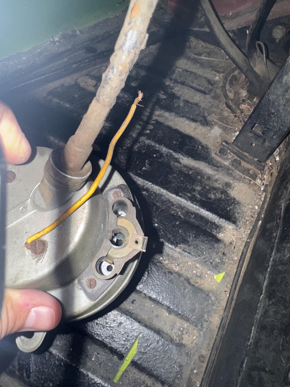

PostPosted: Wed Jul 09, 2025 7:55 am    Post subject: Re: Alternator Change on 1968 Bug with Manx Dune Buggy kit Reply with quote
Yep, so I don’t have a warning light at all! Haha. I’ll have to get one ordered.
For wiring, can I just use an unused strand from the wiring harness? It’s a direct connection from the alternator to that bulb, right?

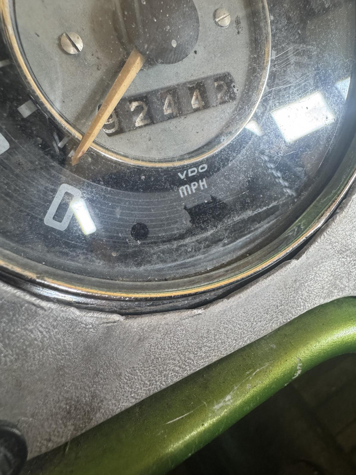

PostPosted: Wed Jul 09, 2025 10:38 am    Post subject: Re: Alternator Change on 1968 Bug with Manx Dune Buggy kit Reply with quote
So, in troubleshooting today, the neutral indicator light was still in the Speedo, just not connected. I made sure it still functioned and it does. I hooked it up to the alternator and nothing. No light when the ignition is on and the car off. Nothing when I start the car.
Are we back to bad alternator? Anything else it could be? I’m assuming this light is the same as the ones I ordered. It’s green, but that doesn’t matter I’m sure.

PostPosted: Wed Jul 09, 2025 11:23 am    Post subject: Re: Alternator Change on 1968 Bug with Manx Dune Buggy kit Reply with quote
You need key on power to the tab for the lights, (oil pressure and generator) Neutral indicator light? No such thing.

PostPosted: Wed Jul 09, 2025 11:38 am    Post subject: Re: Alternator Change on 1968 Bug with Manx Dune Buggy kit Reply with quote
bsairhead wrote:
Correct. It had power to it. May not be neutral. Possibly shift indicator? Top middle indicator on the speedo.

PostPosted: Wed Jul 09, 2025 11:40 am    Post subject: Re: Alternator Change on 1968 Bug with Manx Dune Buggy kit Reply with quote
Govolsguy31 wrote:
bsairhead wrote:
Top middle?

PostPosted: Wed Jul 09, 2025 11:56 am    Post subject: Re: Alternator Change on 1968 Bug with Manx Dune Buggy kit Reply with quote
Top middle (blue) is for high beam headlights.
