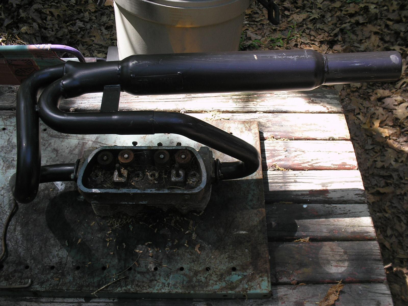

my head 'studs' were long enough so that I could double nut them
Long studs on the #1 and #3 lower studs can hit the bend of the heater boxes.
Heater boxes? The long studs don't interfere with the bends in my 'Bazooka' exhaust.
Here hold this while I paint it w/BBQ Grill paint
