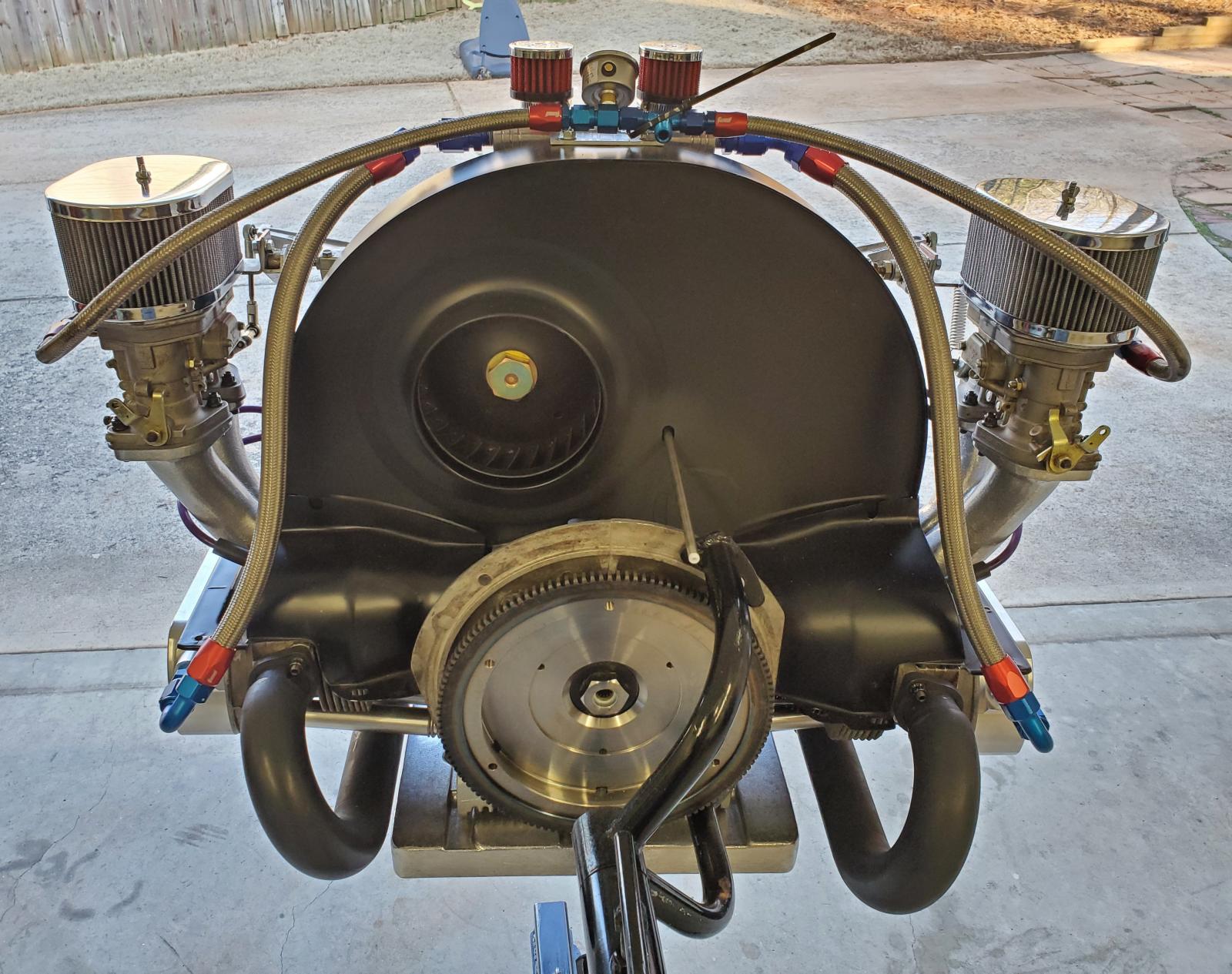

Hello! Last week I ordered a custom GBE oil fill breather, and after the fact I have some concerns. Below is a pic of my present set-up. I understand the GBE breather is functionally better, but now it seems I'm going to be running breather hoses from my valve covers around the front of the fan shroud somehow, and I'm afraid it's going to clutter up the look. I'm trying to clean up my engine bay, not make it look more "busy." Do any of you have pics for how you mounted and run your breather hoses? I'd appreciate looking at what some others did. Peace. BTW, I no longer have fresh air hoses running from the fan shroud.

PostPosted: Tue Mar 09, 2021 12:32 pm    Post subject: Re: Gene Berg Breather Pics Reply with quote
I went with the "cluttered" look. Laughing

PostPosted: Tue Mar 09, 2021 12:44 pm    Post subject: Re: Gene Berg Breather Pics Reply with quote
Turnswrenches, that doesn't look cluttered at all. Everything serves a purpose. Nice engine!

PostPosted: Tue Mar 09, 2021 12:54 pm    Post subject: Re: Gene Berg Breather Pics Reply with quote
I agree. But, it's not a Berg breather.

PostPosted: Tue Mar 09, 2021 3:36 pm    Post subject: Re: Gene Berg Breather Pics Reply with quote
I have the same style carb linkage and my Gene Berg breather wouldn't fit. I have the crossbar in the lower hole and it interferes with the vertical AN fitting on the breather. I think it would fit if the crossbar were installed in the upper hole though.

PostPosted: Tue Mar 09, 2021 3:44 pm    Post subject: Re: Gene Berg Breather Pics Reply with quote
If running vc breathers just use the 1&2 side and not the 3&4 side since that side fills up with oil anyways. Check out the old Muffler Mike Sheldon video with the window valve covers.
And your engine looks good already :D

PostPosted: Tue Mar 09, 2021 4:22 pm    Post subject: Re: Gene Berg Breather Pics Reply with quote
Are you going to keep your breather box?

PostPosted: Tue Mar 09, 2021 7:09 pm    Post subject: Re: Gene Berg Breather Pics Reply with quote
Are you asking me? If so, are you talking about the breather in the pic I posted, or the one from Berg that's on the way?

PostPosted: Tue Mar 09, 2021 7:26 pm    Post subject: Re: Gene Berg Breather Pics Reply with quote
You want clutter, I will show you clutter. I have used many after market breathers on my bugs and sqbk's and some were just overkill.
I then just ran the hose to the air cleaner, but after having my carbs rebuilt, Rick Hunt the rebuilder said not to run the hose directly to the air cleaner, the oil will mess up the carb. So I ran it out to the atmosphere and started to smell oil fumes.
OK built my own small breather out of an aftermarket oil filler tube. Works great, been driving it for months and no oil just fumes going into the carb.
The oil and fumes goes up, but cannot exit and drips back down into the case.
Keep in mind what VW used as breathers, they were very small. For larger engines I understand larger breathers, my breather would probably explode, ha.

PostPosted: Tue Mar 09, 2021 7:31 pm    Post subject: Re: Gene Berg Breather Pics Reply with quote
The Berg breather provides a nice way to add oil and let the engine breath. I thought it was bulky so I fabbed a filler and used a Clyde Berg breather.
