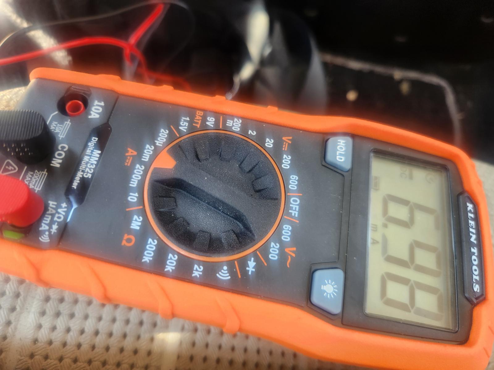

I have a 69 bug with an alternator conversion that I inhereted from my dad. He would leave a battery tender on it to keep a charge. I am now trying to troubleshoot it. I’ve put a multimeter in series between the neg terminal and cable. I pulled the fuses one at a time and the reading never changed. I’ve visually checked the wiring and found no problems. I even disconnected the radio. Anybody got any ideas. If I let the car sit for a week it has to be jumpers….Steve
Well...what is it reading? Are you using the 'special' 10amp plug on the meter or are you using the 2amp max 'regular' plug? Some digital meters get a 'noise' reading. It might not always be 0.00, especially on the 2amp max. Switch the + lead between the two plugs and see if the readings are the same value.

SAMBA readers 'luv' photos, post a photo of the VOM reading you're getting with it connected.

PostPosted: Mon Jul 14, 2025 7:30 am    Post subject: Re: Battery drain Reply with quote
I'll do that this morning
Multi meters have multiple functions. What function was your MM set to when connected between the battery post and the loose battery cable? If looking for a parasitic drain you usually set the meter to read amps/current. What was the reading you get? Any positive or negative current reading indicates current is flowing thru the meter. If you started with zero reading disconnecting wires would not increase the reading. More details please. Pics are good.
When you disconnected the alternator wire did you disconnect BOTH alternator wires? Does your alternator have just 2-wire (AL82) or 4-wires (AL78)?

PostPosted: Mon Jul 14, 2025 1:13 pm    Post subject: Re: Battery drain Reply with quote

talljordan wrote:
7ma of parasitic drain is likely normal and nothing to worry about. That's practically nothing.
I agree with this. Anything less than 50mA is normal for most modern cars and not worth chasing. For example, if you had a modern stereo with an internal clock and preset memory, 50mA would be the expected power draw. Just be aware there is someting draining the battery and disconnect it if you plan to not start the car for more than a week or two.

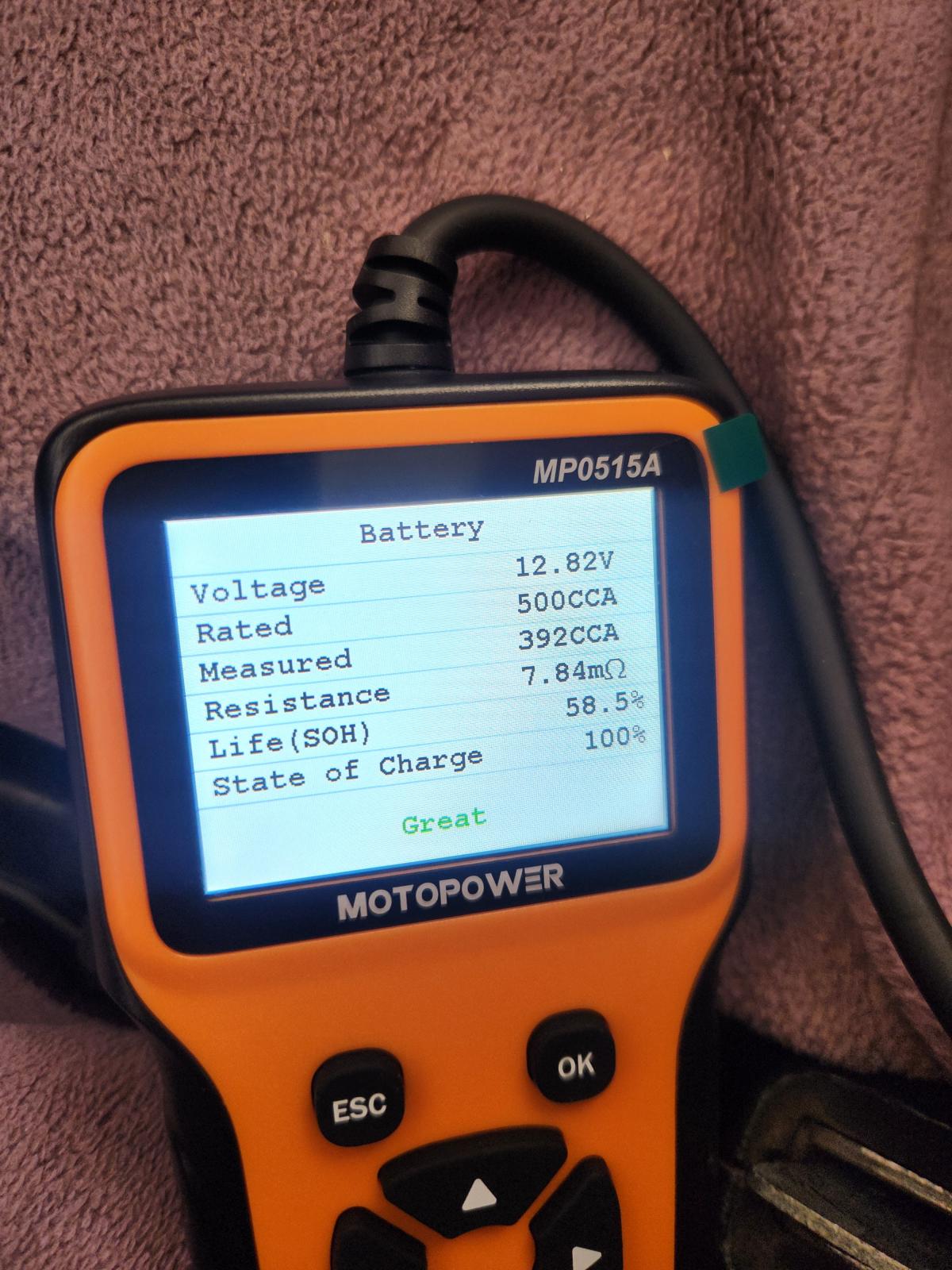

Next, test the battery. What is the voltage between the two battery posts when your battery is fully charged?
Put the battery on your tender/charger. Charge it overnight or until is shows fully charged. Test the voltage at the battery posts. It will likely read well above 13.0v having just come off the charger.
Crank the engine for a second or two to load the battery and remove any surface charge left over from the charger. Test the voltage now with everything powered OFF. A fully charged (100% state of charge) 12v car battery should read 12.6v. A reading of 12.0v and your battery is down to 50% state of charge. If you reach 11.1v your battery is 0% state of charge.
State of charge is just one measure of the battery. If possible take it to a shop that can load test it. This is where they simulate the load of a starter and confirm the battery can carry a 450A load for a few seconds. A battery that shows a full charge but cannot carry its rated load... is bad and should be replaced.

PostPosted: Yesterday 3:28 pm    Post subject: Re: Battery drain Reply with quote
