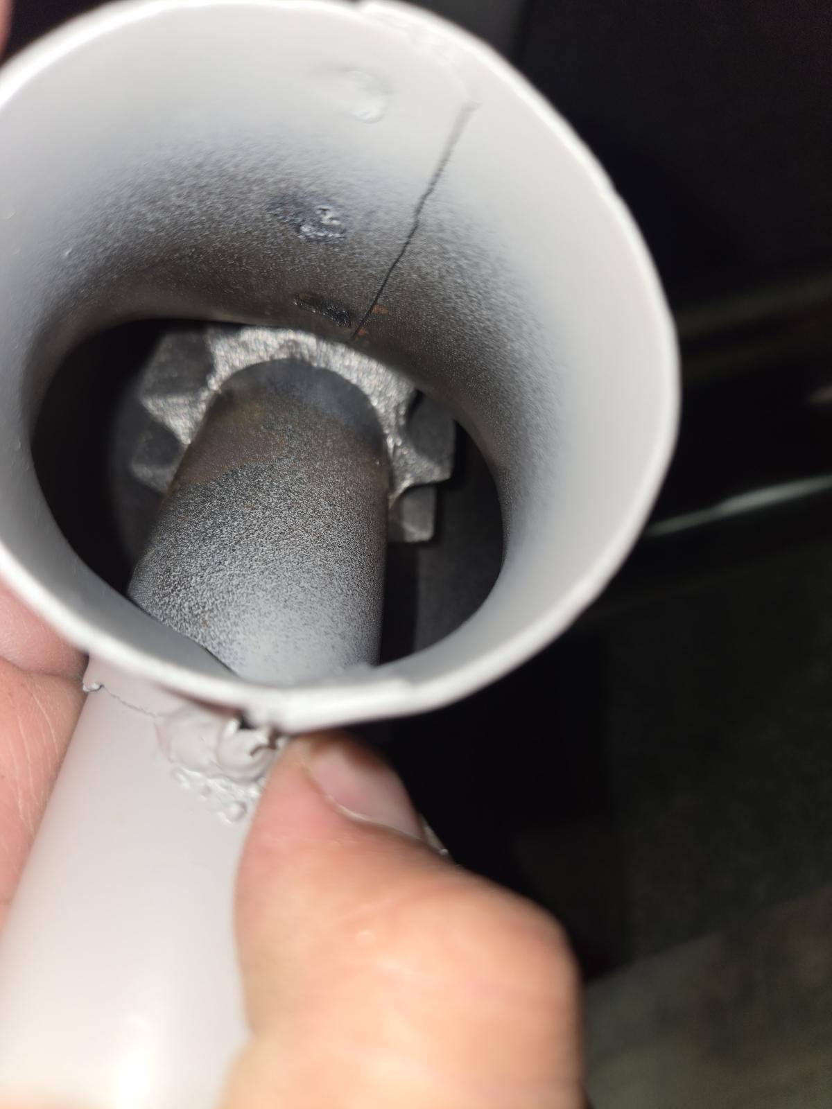

Those heater boxes are not a good option, they neither heat the interior well in cold weather, nor cool the engine in warm weather well. With bigger engines this latter problem gets worse.

hmm thank you. I'll admit that I didn't spend alot of time researching heater boxes. I am going to run them so hopefully it all works out okay.
I'm not in a super cold climate so Im sure they will be enough to knock the chill off.

Understood, but you will have a hotter running engine during the hot weather, that is not good for engine longevity.
On the other hand it does get cold the farther out east you go, and not that much distance.
Talked to Steve of Wolfgang Int. years ago and he had big cooling problems with the early fresh air heater boxes with big engines. Only fixed by going to the later 1500/1600 fresh air heater boxes.

Has anyone opened up one of these aftermarket heater boxes lately to see if the heat exchangers have gotten improved?

You can tell a lot by the weight.

One needs to only look up the rear of the exhaust tube with a flashlight in a dark room. Peering past that first small curve will show the inside fining.

Here is the inside. Unfortunately it doesn't look very heavy duty as stated on their site.
