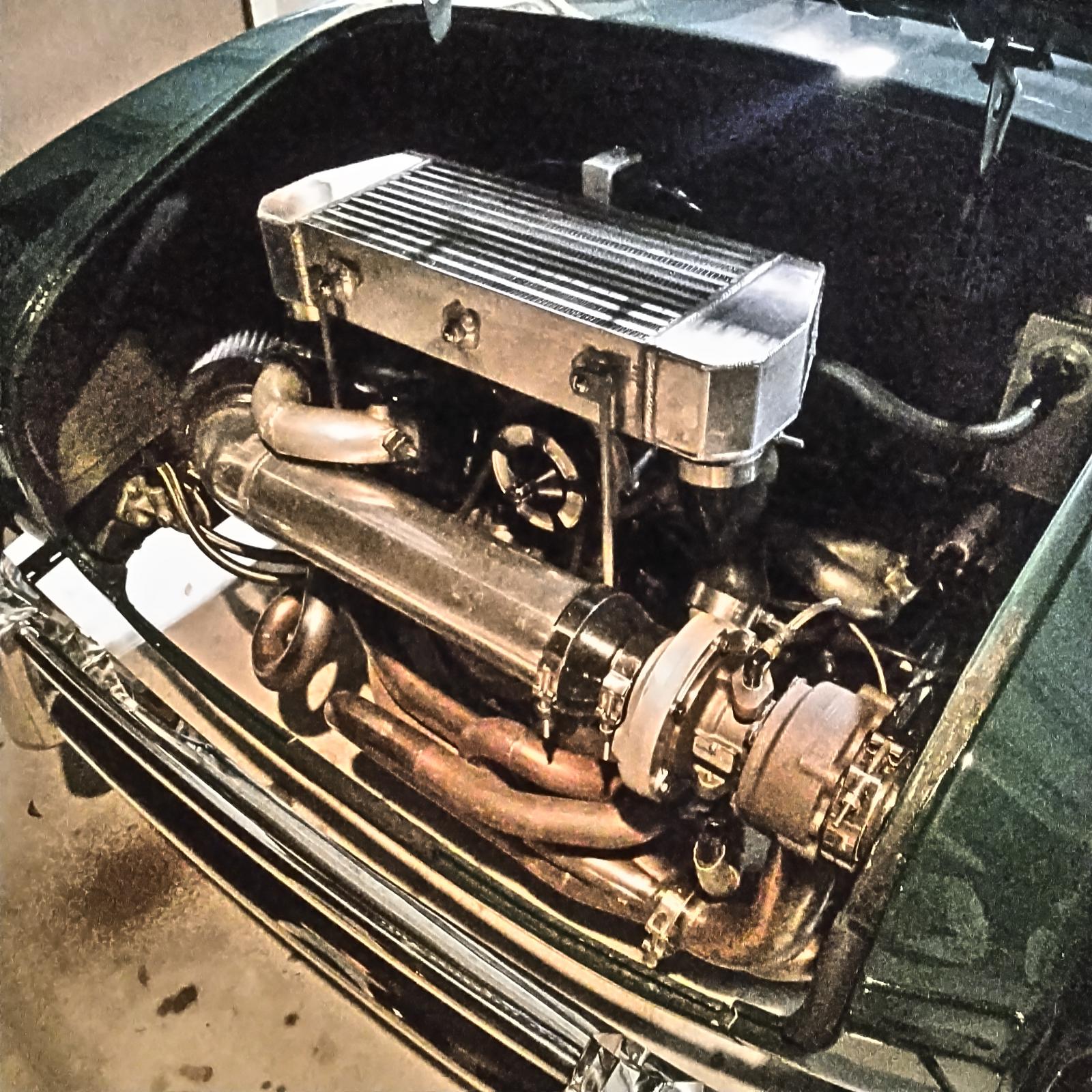

Hello All,
Would like to get more air into the engine bay. I have a Ghia with a 2.0ltr turbo. Was wondering if, cutting holes in the deck lid behind the license plate would be helpful or harmful?
Thank you for reading and any thoughts or ideas.

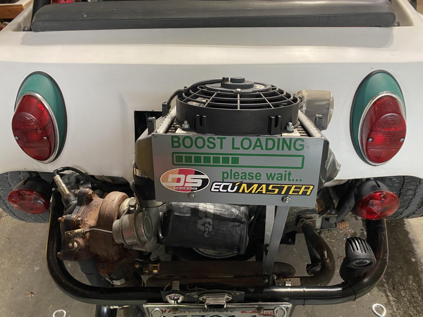

I got this pic from your gallery. Yeah, you definitely need to move some air through there.

Do you not have any positive air flow through the intercooler? A fan? You will need that and it needs to exit the engine compartment or it will preheat the cooling air for the engine.
Oh ya! You definitely need more airflow in that engine compartment! A lot more! A few holes behind the license plate will be diddely squat compared to what you really need! Not only do you need more air in for that intercooler, you also need someplace for it to move out. You can get a good idea about the size needed for both by measuring the surface area of that intercooler. A slightly smaller inlet could do the trick if there is a good strong fan involved.
One of the problems with our air cooled VWs is that the rear of the car where we are trying to get this air to move is in a low pressure area. Front engine cars have the advantage of the high pressure from the air trying to get around the front of the car.

Thank you oprn. I guess I’ll have to lift the deck lid a tad. No fan on the inter cooler so far. 87 degree and humid day the air intake temps never reached 140 degrees. That was a 50 mile cruise with a few wot shots. Trying to get it down to 100 if possible.
