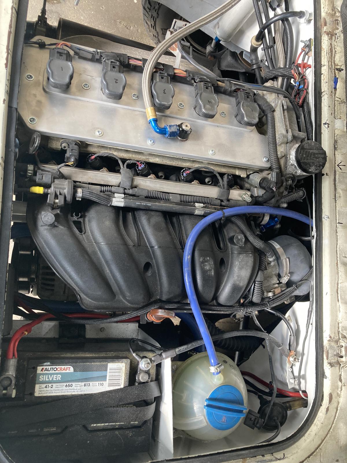

Yes the 07k from a 2.5 jetta will fit in a vanagon.
It will take some fabrication. I posted what I did in the earlier linked thread.
Also suggest you read Pchills thread on Honda k-24 swap. His excellent skill is what inspired me. There are a couple of other k-24 threads also.
https://www.thesamba.com/vw/forum/viewtopic.php?t=766259&highlight=k24
The biggest hurdle is the front timing cover. I opted to raise my engine cover but have since learned of a better solution. The audi DAZA found in RS3's has a timing cover that would solve this problem pretty easily. Then its the intake manifold, again aftermarket solutions are available or just keep it stock.
Got more then 2000 miles so far and am very happy. Torque is your friend when trying to push a brick down the road. This engine has it. Maybe not as much as a diesel, but a big jump over the old 1.8 8v that was in my van when I got it.

There's a link to a spreadsheet with cost brake down in the 07k thread. I'm just guy in his garage also, so don't underrate yourself. Though do have access to some equipment at work there really isn't anything that can't be done with a mig welder and angle grinder. If you want it you can do it! But also much respect a man who know his limitations.
