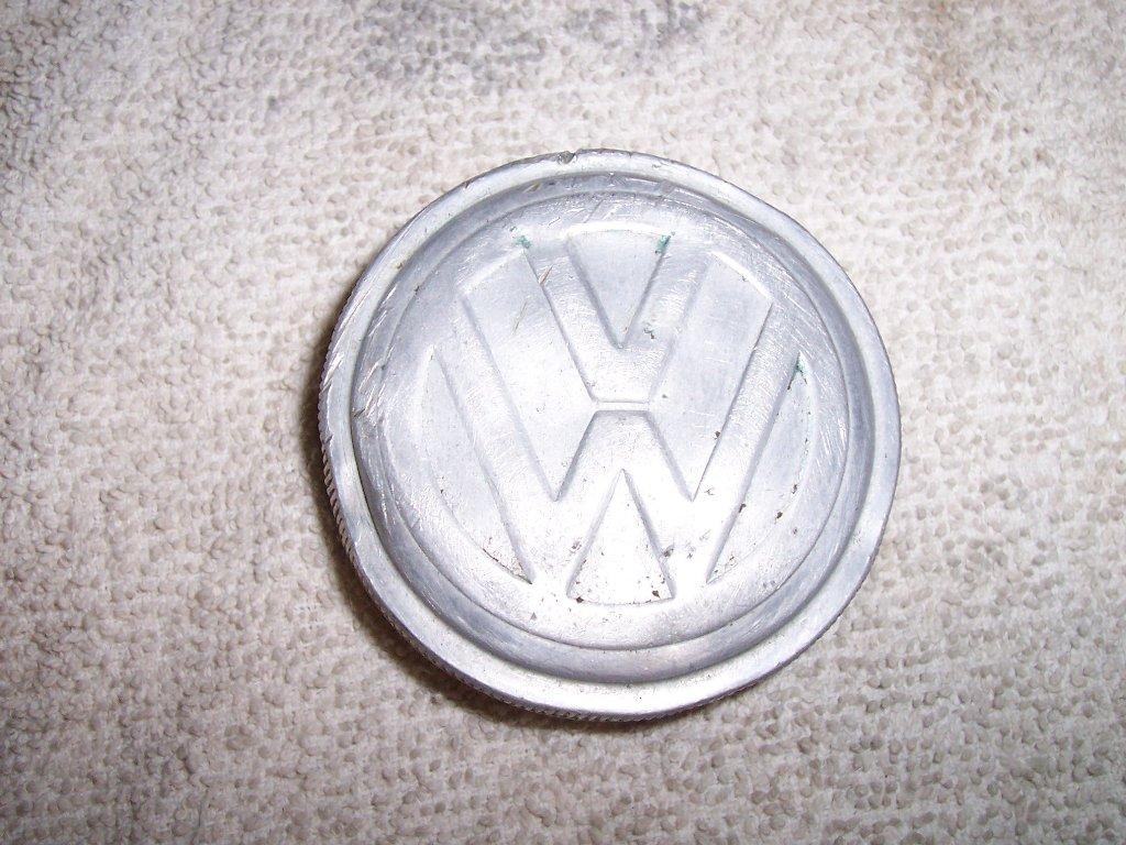

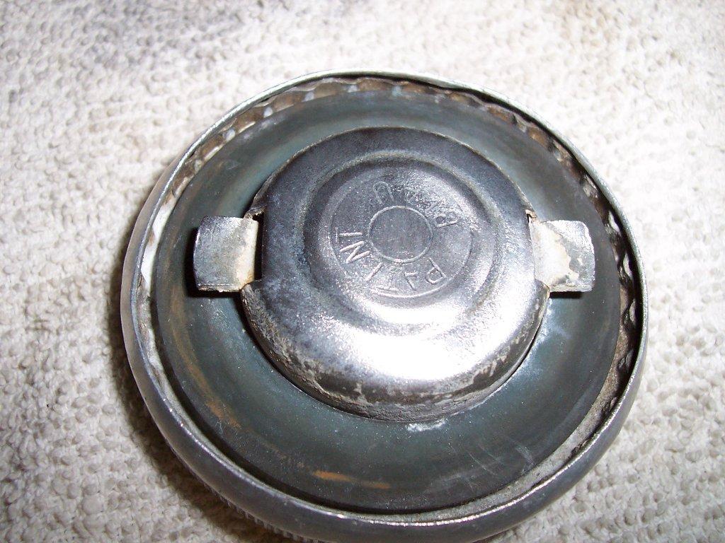

Here is an original 67 and older cap:
If you look around the edge, you will see the vent holes.
There is nothing magical about the old caps: no springs, no diaphragms inside. They are just vented to the atmosphere.
