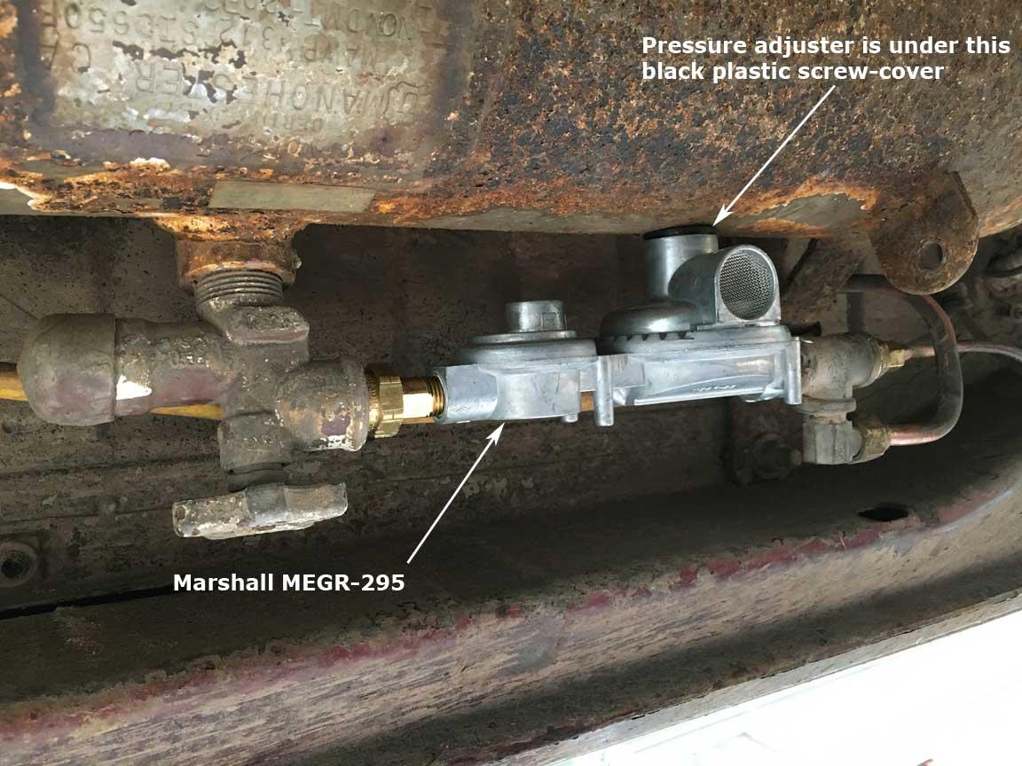

Rick I have this specialized tool. (part#jimf909)
Somewhere I read that you cannot install a regulator upside-down. I suppose the water-drain would not function properly?
Back when I replaced my regulator, folks were saying the Marshall MEGR-295 was the only replacement available.
If your regulator is set at 11" WC, you don't really need access to the adjustment screw.
