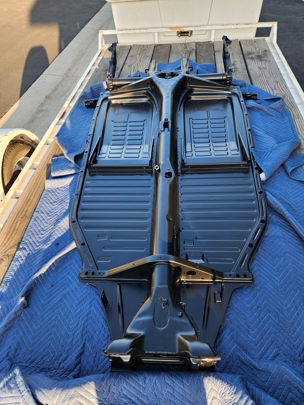

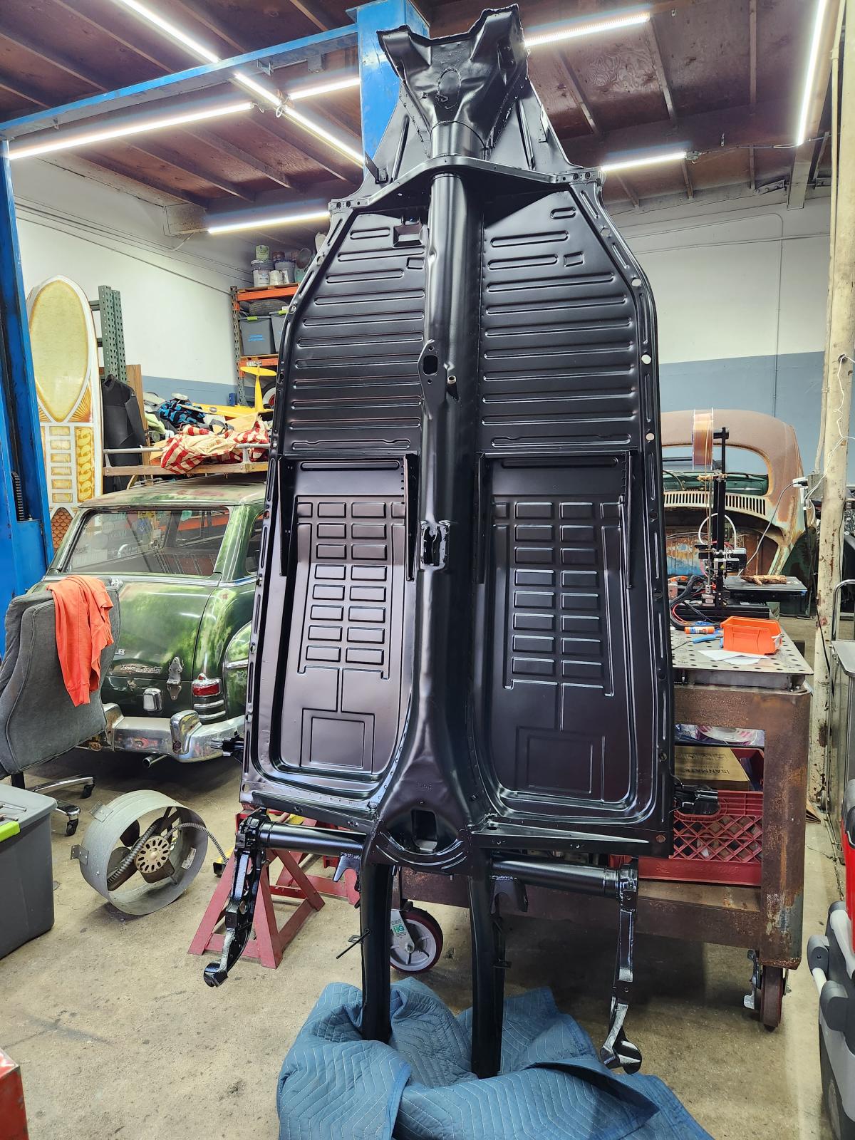

Its been quite a while since I've had time to make any progress but this week hasn't been too bad so far. Pan is back from powdercoating. It is absolutely stunning and I'm kinda bummed all that work will be hidden. But now I have set the bar for myself in terms of quality and it'll be a big challenge for me to remain disciplined and do it as clean as I possibly can.
Here's some pics.
[/img]

Battery tie down is missing from the pan.

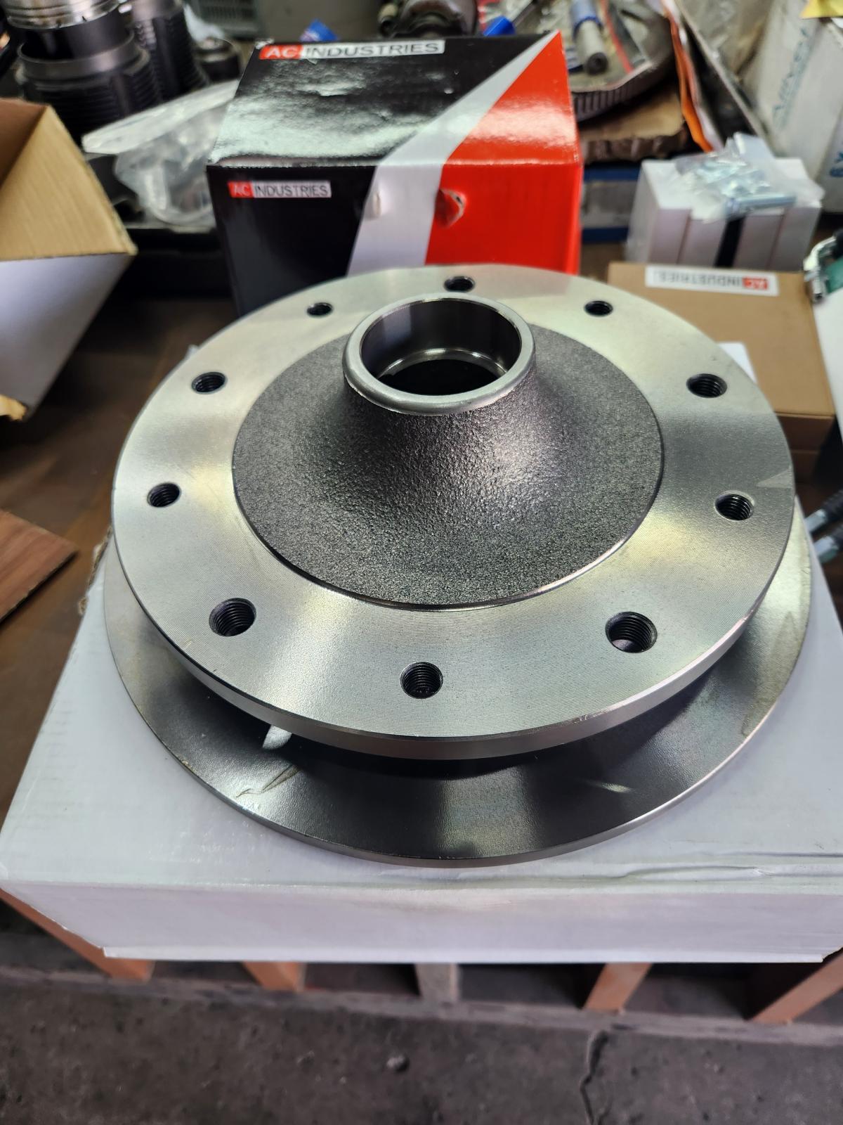

Next up is rear brake options. It looks like I can use the existing 4 lug style drums and drill them for wide 5. Then spot face and install studs. There's enough meat when compared to the 5 lug drum. The other option looks like using the wide 5 drum and adding a spacer between the drum and axle nut to make up for the ~1" difference in spline length. I already powdercoated the backing plates so ideally I would like to use the 4 lug brakes.
OG wide 5 drums
IRS 4 lug drums
Barndoor Mafia

you can use late wide five rear drums and a spacer kit like what buttys bits sells
https://www.buttysbits.com/product/bb-034-4-stud-beetle-to-wide-5-drum-spacer-kit/
