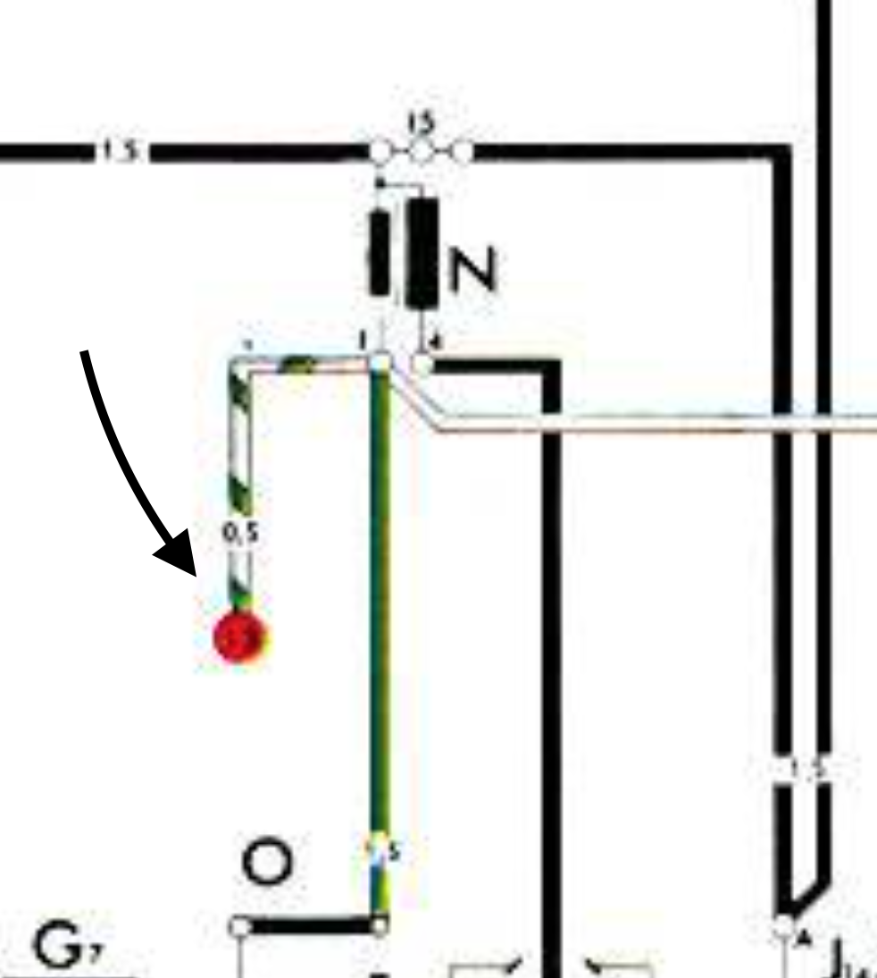

Whats this Wire - Coil 78 Bus FI Its Coming off the 1 Terminal of Coil. I have the other two ( the white one goes to ECU, the other goes to coil ) What is this third? See arrow in picture.
The full diagrams and legend are here if it helps anyone
https://www.thesamba.com/vw/archives/info/wiring/baybus_77-78.jpg
https://www.thesamba.com/vw/archives/info/wiring/baybus_77-78_key.jpg

Orange dots are diagnostic socket terminals.
