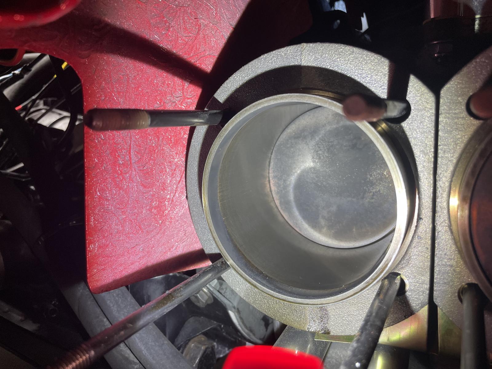

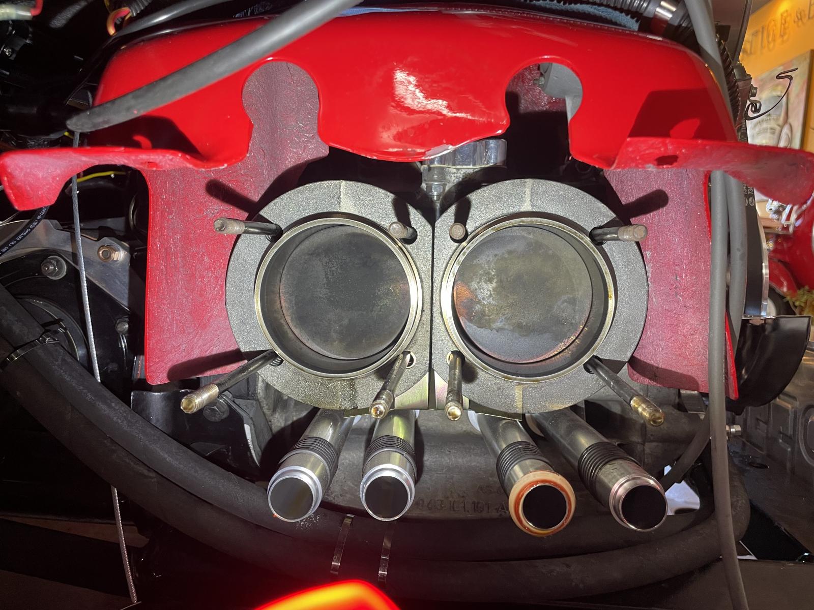

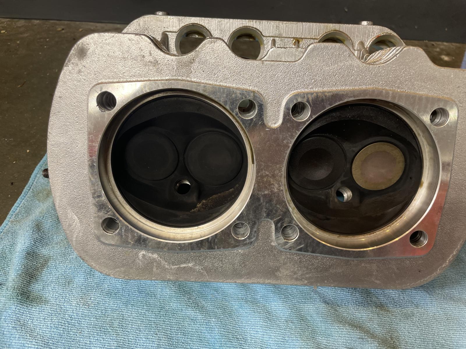

Both compression rings gaps are sitting at the bottom/right side of piston #3
And some pics of the heads and cylinder just in case.
