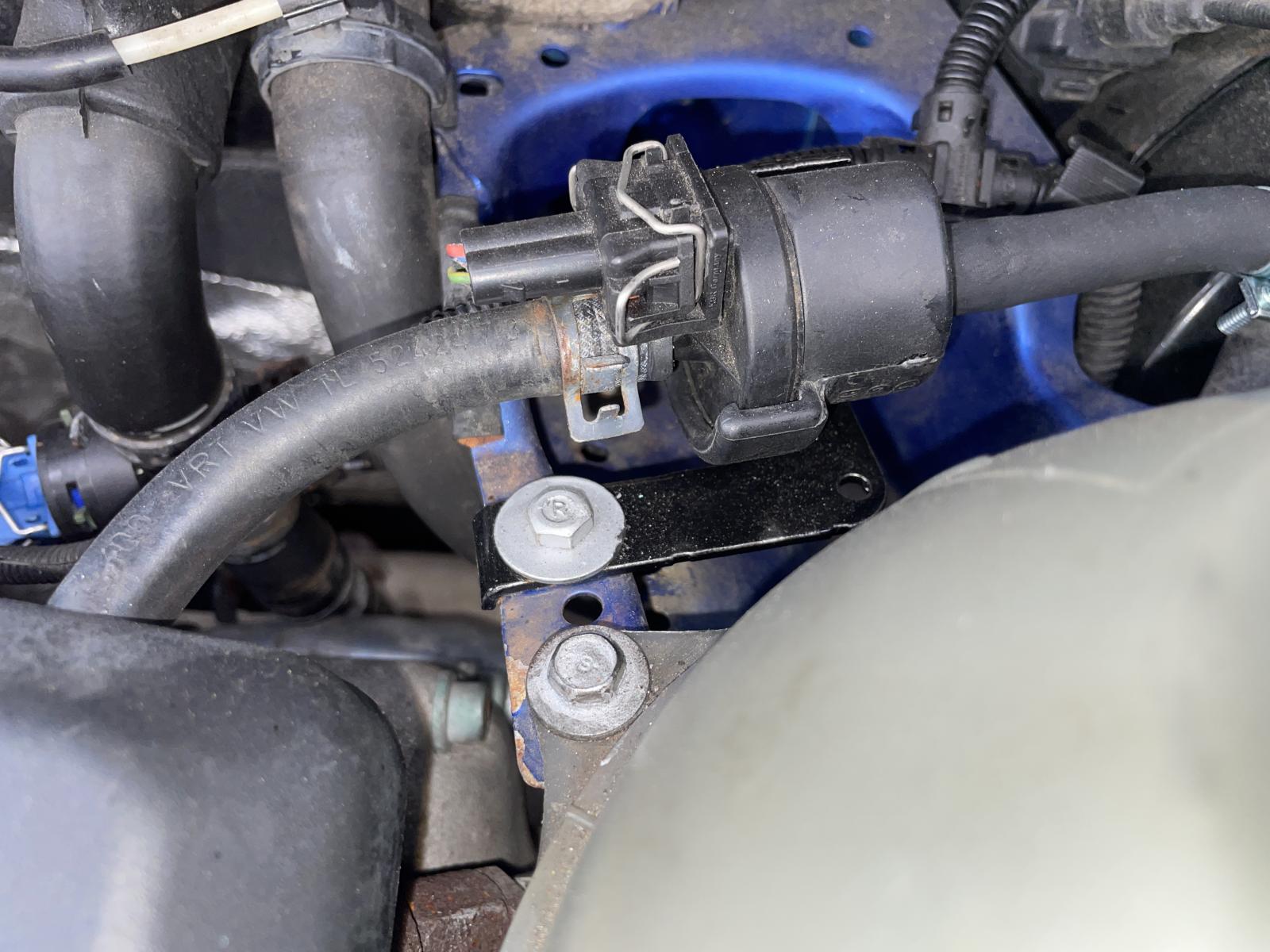

Can you post a picture of your N80?

PostPosted: Wed Aug 27, 2025 4:17 pm    Post subject: Re: Purge Valve Noise - 2000 VR6 Reply with quote
xEVC wrote:
The N80 is mounted inside a rubber case, and the rubber case is mounted to the engine. I presume this is to make it quieter.
I wonder if your N80 is not mounted properly, so the N80 case is directly touching some part of the engine, increasing the noise?

PostPosted: Wed Aug 27, 2025 6:46 pm    Post subject: Re: Purge Valve Noise - 2000 VR6 Reply with quote
That looks quite similar to mine, though I notice a couple of differences:
1. On the right side in your picture, there's a hose clamp which doesn't look stock.
2. In both our pictures, there is a white vacuum hose that connects to a black rubber hose. But it seems to be going different directions in the two pictures.
Could one of us have a misrouted vacuum line?

PostPosted: Thu Aug 28, 2025 10:28 am    Post subject: Re: Purge Valve Noise - 2000 VR6 Reply with quote
I'm not sure why that clamp is there, its on the low pressure/vacuum side of the N80 valve and the hoses are all good, so it's somewhat redundant.
My vacuum line goes to the same place as yours, up between the heater core hoses, it just takes a curve to the left before it reaches that point. It's fastened to other hoses in two places with factory clips then tees into a line coming off the brake booster hose.
