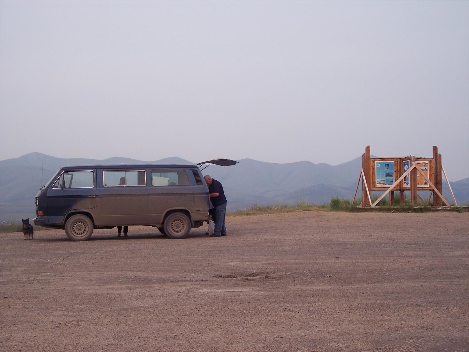

We went as far as Tombstone in August, which was only about 100km up the Dempster. We took it fairly slow but I think that section of the road is the best maintained section. One of the biggest reasons we didn’t go farther was that I was worried about my tires. I think a good set of All Terrains with one good spare would suffice, but two spares would give more piece of mind. There’s not a lot of services up there and any vehicle problems you’d be on your own.

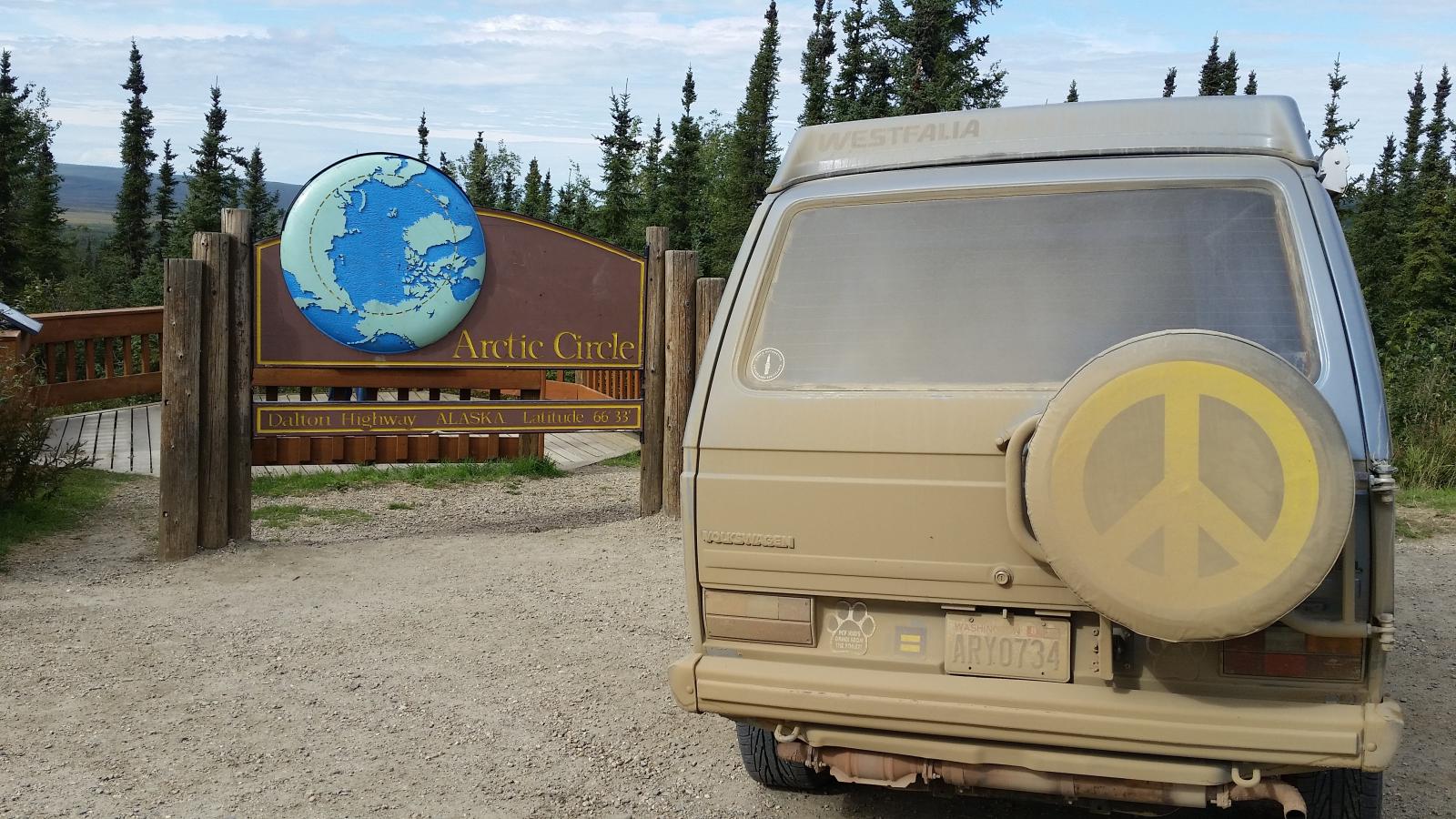

I drove the Dempster in August 2016. I have a syncro Vanagon and I carried just 1 spare. We drove slowly and carefully and had no flat. The only problem we encountered was the ferry crossing at the Mackenzie River had washed out. So we had to detour though Dawson City to Chicken, Alaska and continue north on the Dalton Highway to the Arctic Circle.
I believe the Mackenzie river crossing may be closed now until the river freezes over solidly, but you might check that before leaving.
Good luck and have a great adventure!

Below at the Arctic Circle in July, 1993 ('83 with 2.0 Air-cool engine). See those cheap tires with white walls ??? Very Happy
Below at the Arctic Circle in July, 2016 ('84 with TDI engine) We had another couple with us and all their stuff .... heavy load. We left the popup camper at Dawson City (I took the photo) Uniroyal Tiger Paws 215/75/15.
