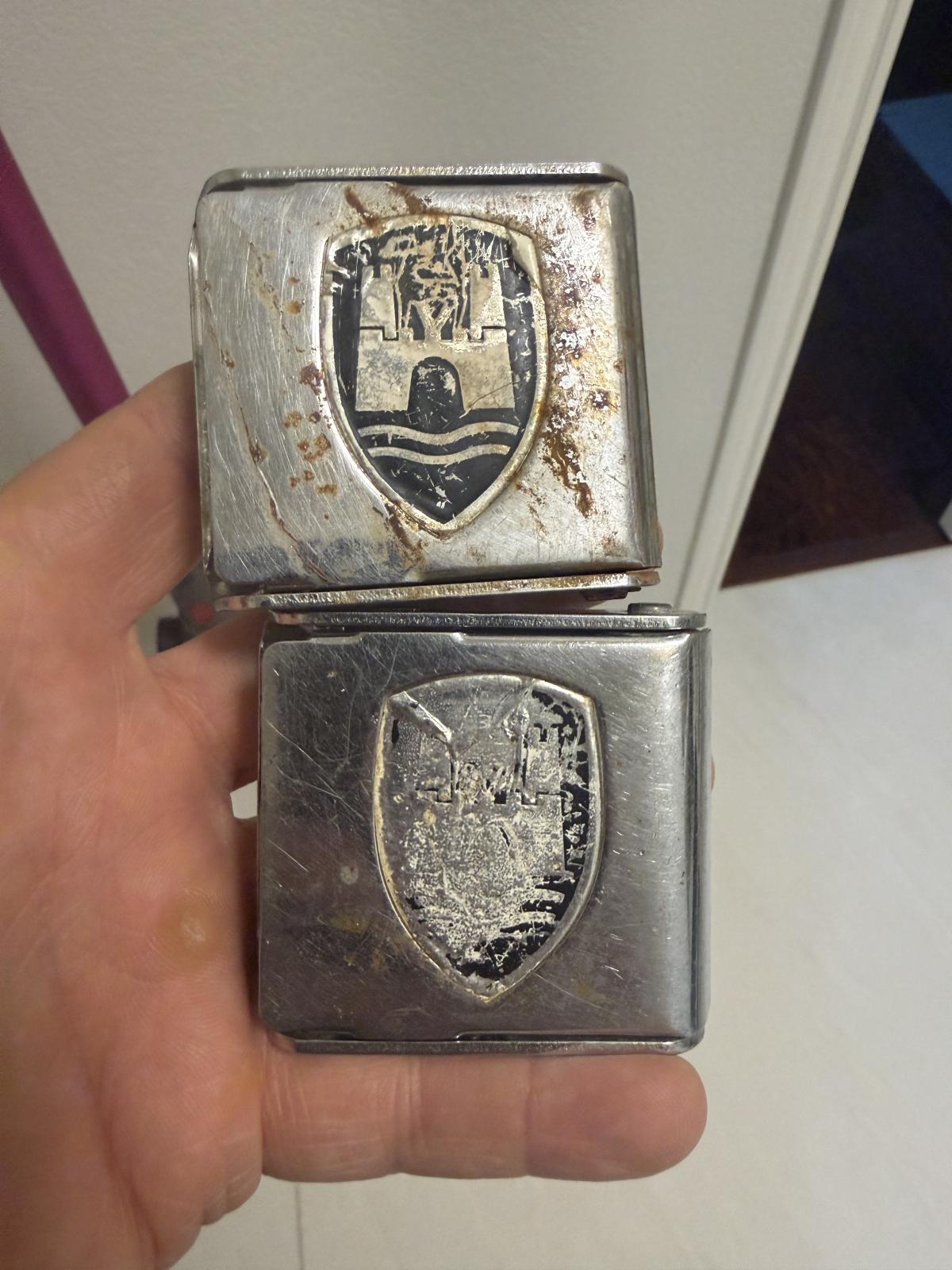

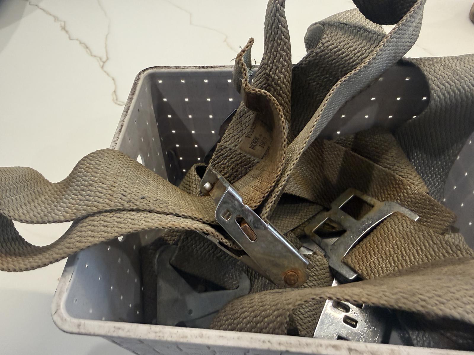

These Hickok seatbelts from 1963 came with my 62 bug. I assume this was some upgrade the original owner did.
I am washing the belt part and I need to clean the latches. Any tips on how to get the rust out?

The classic way to do it is to use diet coke/pepsi and a ball of aluminium foil and then scrub, scrub, scrub. It is slow but does work. Don't use sugar based cola as it becomes a sticky mess.
I can't see what else is in the mechanism, but alternatively you could try covering the surface with a cloth and pouring vinegar onto the cloth and leave it overnight and keep it constantly wet and in contact with the metal. Then have a look at how much rust is left. Use fine steel wool (0000) grade to polish and then repeat. Once it is rust free, you need to cover it with a polish to prevent re-rusting.
You might lose the black paint but you can always redo that easily.
Do not get any on the webbing.

I ended up cleaning the belt itself with soap and water then some on the buckles as well then dunk in 99.9 IPA and blow air.

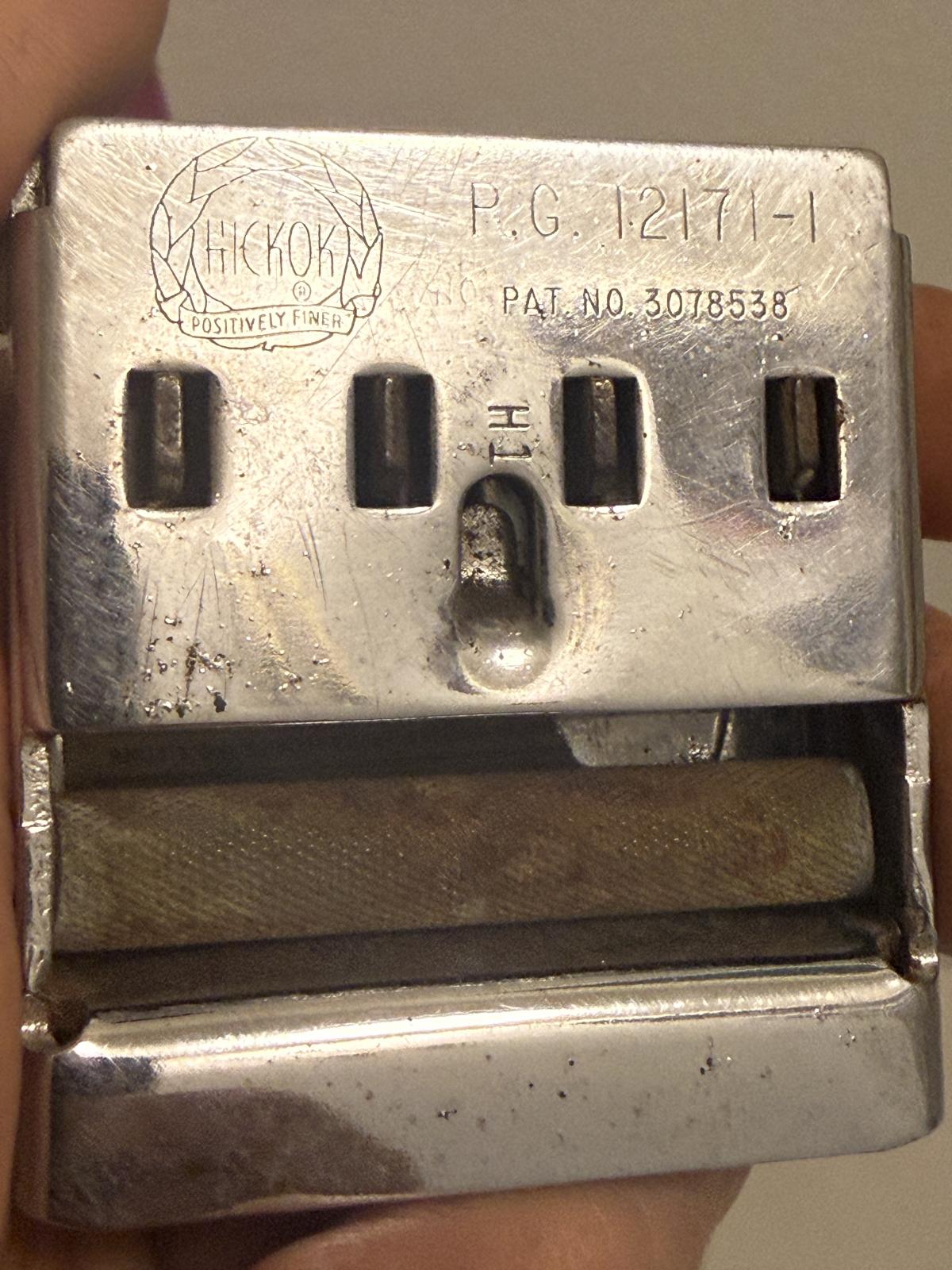

PostPosted: Sun Oct 26, 2025 6:20 pm    Post subject: Re: How to clean seatbelt latch? Reply with quote
End result

PostPosted: Mon Oct 27, 2025 6:29 am    Post subject: Re: How to clean seatbelt latch? Reply with quote
zoti wrote:
End result
Look good, nice work. Cool

PostPosted: Mon Oct 27, 2025 9:42 am    Post subject: Re: How to clean seatbelt latch? Reply with quote
They turned out pretty good.
