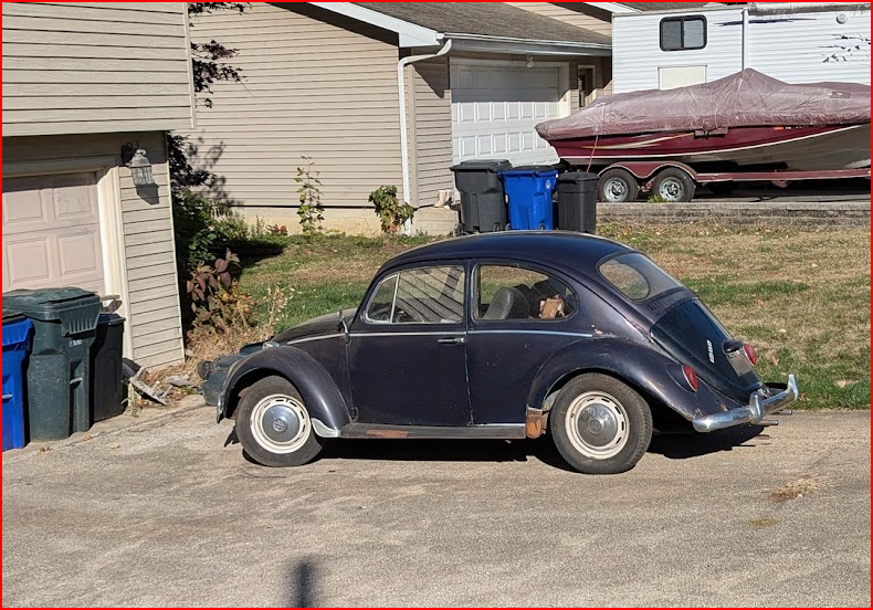

Well I pullled the trigger. I bought a 1966 bug and it has a later model 1600 DP with an alternator. Runs but doesn't idle. So the carb needs rebuilt or replaced... But that's what I'm looking forward to.
And Sunday I'm picking up a free DP long block. One to drive, one to build.
Thanks for all the help. I think I've collected almost all the VW books. I have lots of plans and ideas. Maybe I'll just make this my build thread if that's OK.
Dan

PostPosted: Fri Oct 24, 2025 7:30 pm    Post subject: Re: Engine cases & Type of VW Reply with quote
Congratulations on buying a suitable Beetle! We look forward to some photos of it, as well as your freebie engine.
'66 is an attractive year, and since it already has been converted to 12 volts, one of the few "weak" points- the original 6 volt system- has been resolved.

PostPosted: Sat Oct 25, 2025 6:59 am    Post subject: Re: Engine cases & Type of VW Reply with quote
I will 2nd that opinion on the 66. It is a very good year and in my mind the year that ushered in the feeling of a more modern driving bug with more power, ball joint suspension and a nicely matched transmission to engine power curve. Good luck with it and enjoy it.

PostPosted: Mon Nov 03, 2025 6:14 pm    Post subject: Re: Engine cases & Type of VW Reply with quote
Freebie engine was a bust. It said free but it was free plus $700.
The car is here in the driveway. I need to rebuild the carb first. It won't idle and the accelerator pump is rotten. But it will run. Brakes work. I was told a newer clutch - and I trust him.
Lots and lots of spare parts and new parts. It's sort of a dark purple/black color. Stock it was green. I know the word patina is overused but this car has earned its patina. I plan to seal it and leave it alone. It has stock wheels, wheel covers and trim rings. Tires are full of tread but date code was a long, long time ago. It has VW highback buckets, the pasenger needs the outside hinge bolt. The carb is an H30/31 Pict. Looks like an 009 distributor plus an extra. I've done my first bonehead thing. I locked the drivers door. Now it won't unlock... Doh!
Has an alternator so already 12 volt. Pans look good, heater channels look good. It has been hit in the nose at some point - has some cracks in the sheet metal No unusual rust in the spare tire well. Still has the under bonnet carpet and some original looking tools. I need the emblem and front chrome for the bonnet (OK trunk lid). The engine lid needs to be adjusted, it just touches the bumpers. Instead of an engine number on the alternator stand it says "FIRING ORDER 1-4-3-2" I'll read up on that.
Needs the fuel tank cleaned, a new rear window rubber. I will need to work on the window regulators. If possible I would love to drive it in a Christmas parade in a small town near here.

It has stock wheels
Yes, but yours are all white instead of the original white/cream outer rim and semi gloss black center "hump' (sedan). Easily remedied with some careful masking and a can of spray paint. '66/'67 Beetle Cabrio wheels were all-black so that with the stock beauty rings you would not see the cream outer rim portion through the 10 cooling slots.

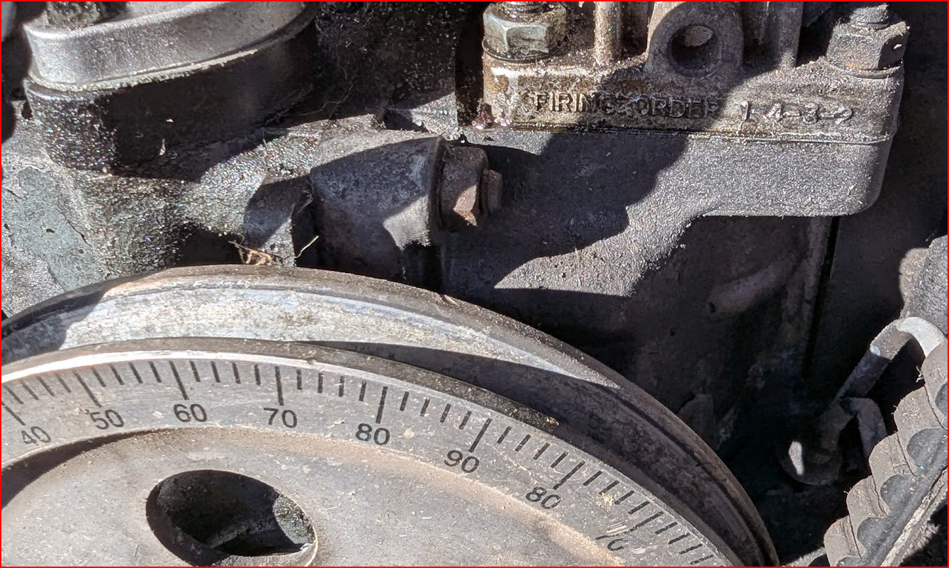

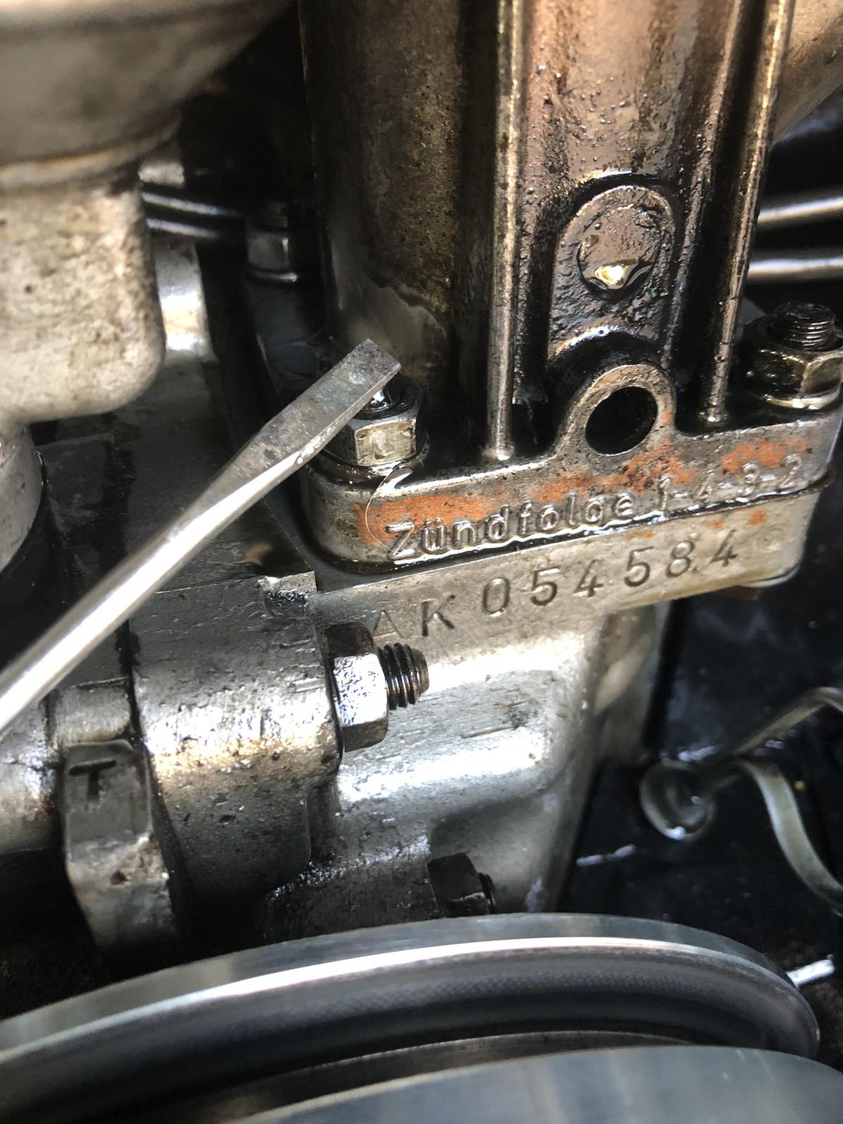

Your engine case is likely a replacement "universal" case which has not been stamped with a number. The number would not be on the alternator stand itself, but stamped into the case just below the parting line for the stand. Your alt stand is an aftermarket one; German ones would have the word "Zundfolge 1-4-3-2". The "u" is actually an umlaut with the 2 small dots above it but those are not easily seen. slayer56 gallery-
Your crankshaft degree pulley is also a lower-priced one that has its markings at every 2 degrees. Original/better ones have the markings at EACH degree. Yours will work fine to get your timing settings "close".
