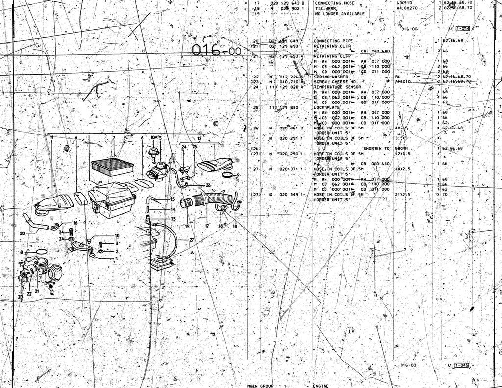

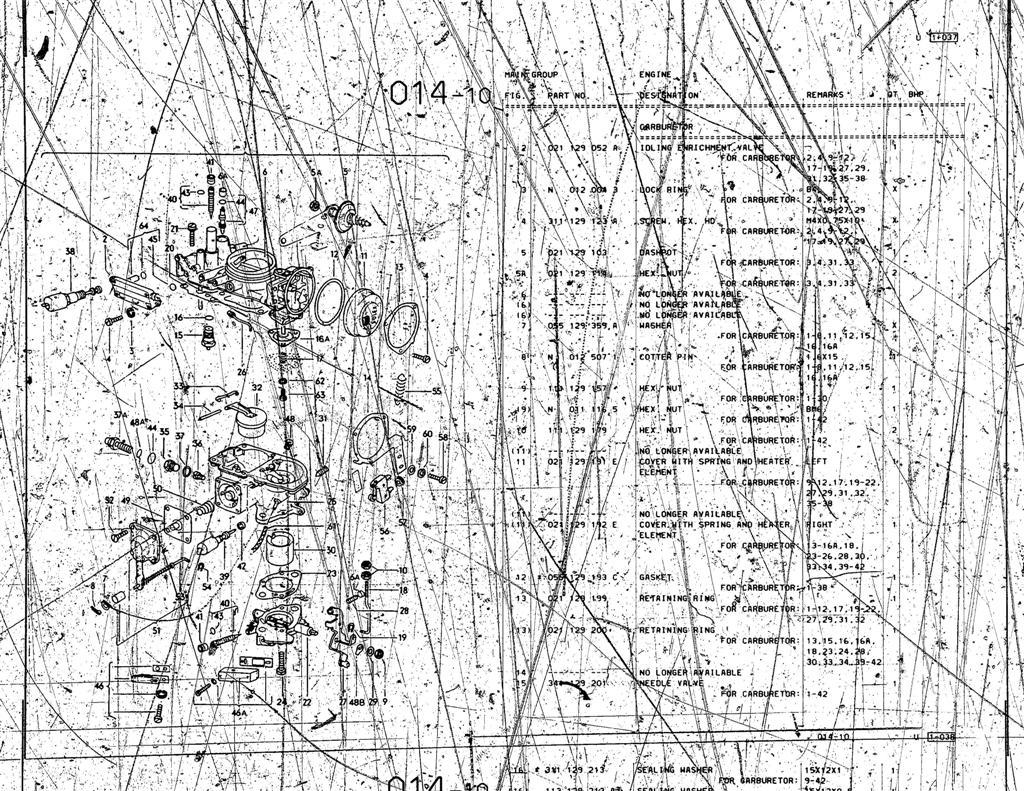

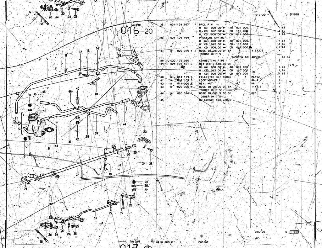

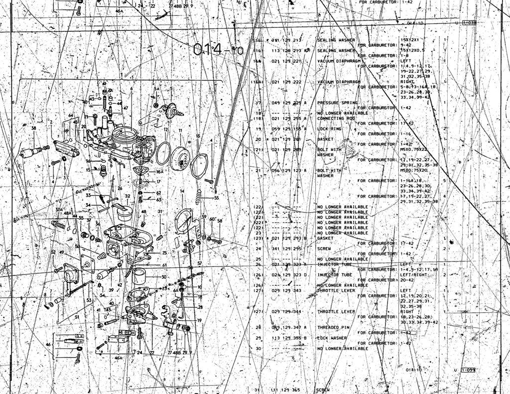

There is a lot of postings and information on the Solex PDSIT 32-34 carbs and their different characteristics (jets, screws, etc...). I would like to start a posting that provides a table on the Solex parts number (tag and stamping on bottom of float bowl). To date I have found most of the information scattered throughout various postings and pics.
Please provide feedback and input to complete the table accurately. I will update upon consensus.
TYPE 2
1972 Type 2, 1.7L, Manual Trans., Engine Code CB 000 001, M157
Left Side Tag#: 021 129 027 L Float Bowl Stamp#: VW337-1 & 2104
Right Side Tag#: 021 129 028 L Float Bowl Stamp#: VW338-1 & 1195,1153?
Left Side Tag#: ### ### ### X Float Bowl Stamp#: VW337-2 & 2137
Right Side Tag#: ### ### ### X Float Bowl Stamp#: VW338-2 & 2138
1973 Type 2, 1.7L, Manual Trans., Engine Code CB 062 001, M157
Left Side Tag#: 021 129 027 P Float Bowl Stamp#: VW383-1 & ####
Right Side Tag#: 021 129 028 P Float Bowl Stamp#: VW384-1 & 3004
1973 Type 2, 1.7L, Auto Trans., Engine Code CD 000 001, M157, M249
Left Side Tag#: 021 129 027 M Float Bowl Stamp#: VW339-1 & ####
Right Side Tag#: 021 129 028 M Float Bowl Stamp#: VW340-1 & ####
1973 Type 2, 1.8L, Manual Trans., Engine Code CD, M157
Left Side Tag#: 021 129 031 Q Float Bowl Stamp#: VW454-1 & 4002
Right Side Tag#: 021 129 032 Q Float Bowl Stamp#: VW455-1 & 4003, 3324?
1973 Type 2, 1.8L, Auto Trans., Engine Code CD, M157, M249
Left Side Tag#: 021 129 031 Float Bowl Stamp#: VW456-1 & ####
Right Side Tag#: 021 129 032 Float Bowl Stamp#: VW457-1 & ####
1974 Type 2, 1.8L, Manual Trans., Engine Code XX ### ###, M157
Left Side Tag#: 021 129 031 N Float Bowl Stamp#: VW445-1 & ####
Right Side Tag#: 021 129 032 N Float Bowl Stamp#: VW446-1, & #####
1974 Type 2, 1.8L, Auto Trans., Engine Code XX ### ###, M157, M249
Left Side Tag#: 021 129 031 P Float Bowl Stamp#: VW447-1 & ####
Right Side Tag#: 021 129 032 P Float Bowl Stamp#: VW448-1 & ####
TYPE 3
1971 Type 3, L, Auto Trans., Engine Code XX ### ###, M###, M###
Left Side Tag#: ### ### ### Float Bowl Stamp#: VW316-1 & 1062
Right Side Tag#: ### ### ### P Float Bowl Stamp#: VW317-1 & 1060
YYYY Type 3, 1.7L, Manual Trans., Engine Code XX ### ###, M###, M###
Left Side Tag#: 021 129 027 N Float Bowl Stamp#: VW381-1 & ####
Right Side Tag#: 021 129 028 N Float Bowl Stamp#: VW382-1 & ####
TYPE 4
YYYY Type 4, L, Manual Trans., Engine Code XX ### ###, M###, M###
Left Side Tag#: 021 129 027 A Float Bowl Stamp#: VW###-# & ####
Right Side Tag#: 021 129 028 A Float Bowl Stamp#: VW###-# & ####
