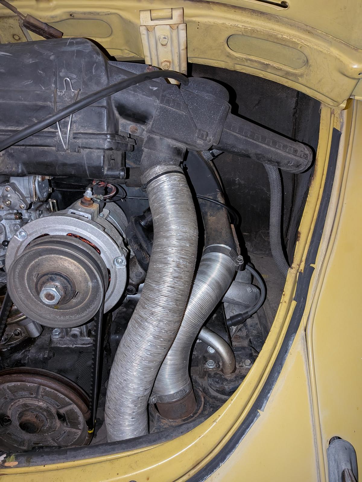

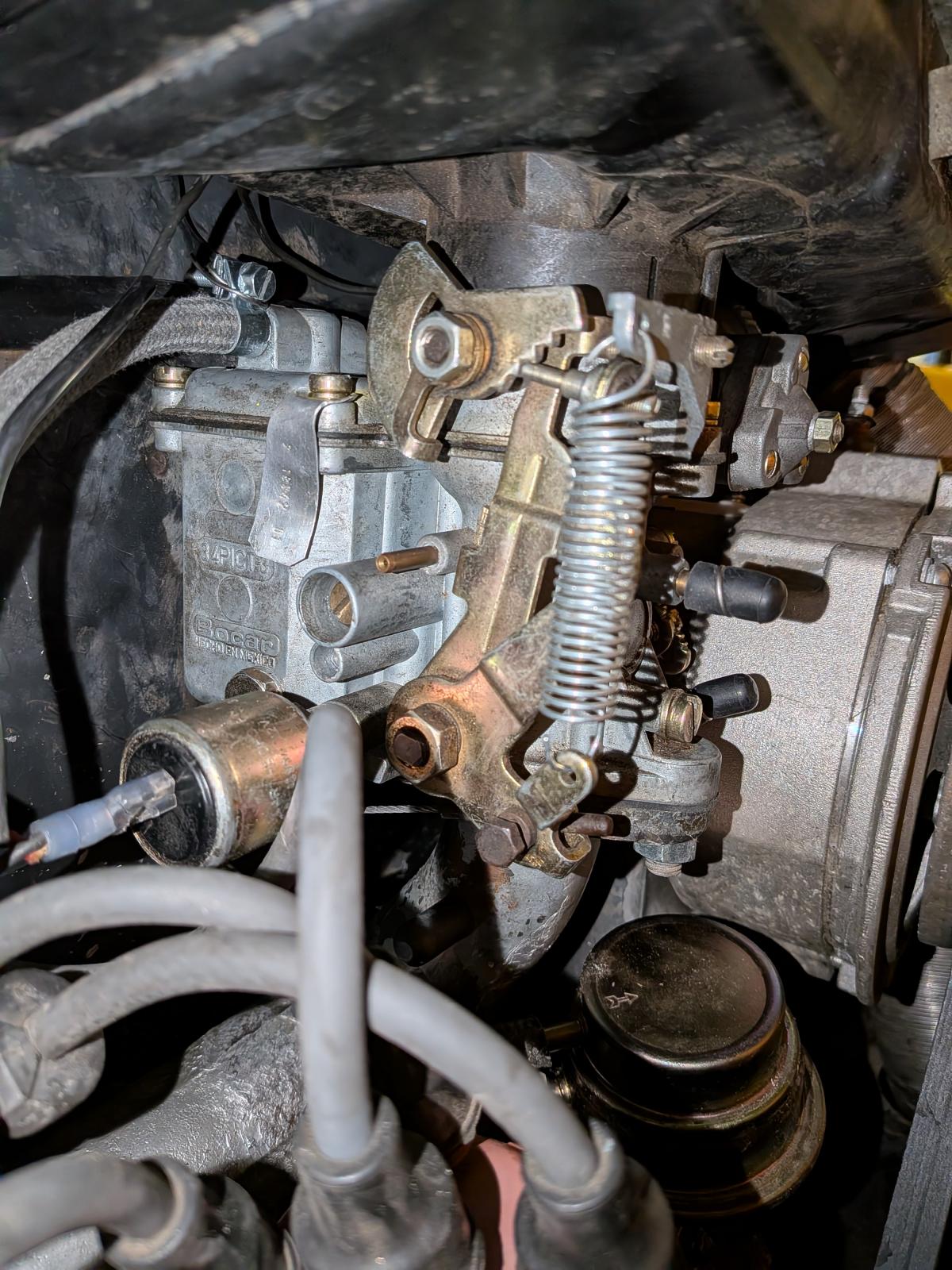

Here are some pictures from the engine bay and underneath. Unless I'm mistaken, it appears that all of my tins are in place, including the lowers. It does have a vintage 4 Tuned muffler on it.
All comments are welcome! Sounds like it's in my best interest to go back to an SVDA distributor for a street driven car. I'm not opposed to keeping the Bocar 34 PICT 3 for now, if I can find spare jets (would be nice to try a 130 or 135 main... or at least have an extra 127 to drill out). The accelerator pump has a nice healthy squirt as soon as you open the throttle.
Anyone know if the heat risers can be checked without pulling it off the car? Like, with an IR thermometer to see if exhaust is passing through the middle of the crossover?

PostPosted: Sat Nov 15, 2025 10:40 pm    Post subject: Re: New Member Reply with quote
Is that a socket stuck on the drain plug?

I see you have the fabric wrapped fuel line in the engine compartment. There have been many problems with that line cracking internally. Suggest you replace it with gates barricade.
I have no issues with using the Gates Barricade since it holds up well to fuel with ethanol (which is pretty much everywhere now). As far as I know, however, it doesn't come in metric sizes, so you'd want to be sure all connections are well clamped. I noticed that the PO used fuel injection style clamps for the fuel hose. That's what you'd want to use regardless of what fuel hose you use ... their design creates a more uniform, secure seal. BTW ... the original style fabric wrapped fuel hose most definitely does not hold up as well to ethanol, however, there is ethanol resistant fabric wrapped fuel hose available in metric sizes. Here's one source:
https://belmetric.com/eckstein-braided-multi-fuel-rubber-hose/?
Beware ... many VW parts sellers are still selling the original, non-ethanol resistant fabric covered fuel hose and some will tell you it has to be replaced at least once yearly regardless of miles driven ... I'd guess most of us would prefer not to deal with that chore that frequently.
On a side note ... IMO, it would be wise to move the fuel filter out of the engine compartment. Those clear plastic filters aren't as durable as metal bodied ones and the fewer fuel line connections in the engine bay, the better. Next to the transaxle or under the fuel tank are safer locations.
BTW, I believe your fuel pump is a non rebuildable aftermarket style. They're very common, but I doubt yours is delivering fuel at the proper psi. One of my bugs came with one and it was putting out over 5 psi ... proper psi is around 2.8 - 3.5.

Cap off that vacuum advance port of the left side of the carb, like the others

Re: The heat riser test. Start the engine and as you have already stated, check the heat across the heat riser tubes to see what temp they are reaching.
I suspect it will be very little. Typically, most header systems don't provide a good amount of flow across the heat riser tubes unless, you modify the header tubes to catch the how exhaust gasses to help get the gasses flowing across the heat risers.

It does indeed appear to have all the bottom tins and a thermostat! That is very rare today!
The first order of business in my view is to take a hot pressure washer to that engine top and bottom and clean off all that accumulated muck. This will help you to locate the oil leaks.
It is hard to tell by the photo but it looks as though the thermostat is fully extended. If it is it could have failed and holding the flaps open causing the engine to run cold. Awesome Powder Coat on this site has new ones available. It could also have all the flutes plugged up with that muck and that will hold it open too.
Yes you can use a heat gun to establish flow through the heat riser. It would be very rare to have that style of exhaust properly support flow. You should be seeing at least 90*F on the aluminum heat sink directly below the carb after a good run on the road. Never mind what the temperature is at the ends of the heat riser, the center tells the story. Here is a good read. https://www.thesamba.com/vw/forum/viewtopic.php?t=755518&highlight=
Yes, move that plastic fuel filter out of the engine compartment. It is perfectly positioned to spray fuel in the ignition system when it cracks. And given enough time it will.
I played with a Bocar carb for several years and never did get it to run right. Maybe you are better at it? I also have no idea what the vacuum signal is from it and which distributor matches that signal properly.
Appears to be a pipe plug. Confused
