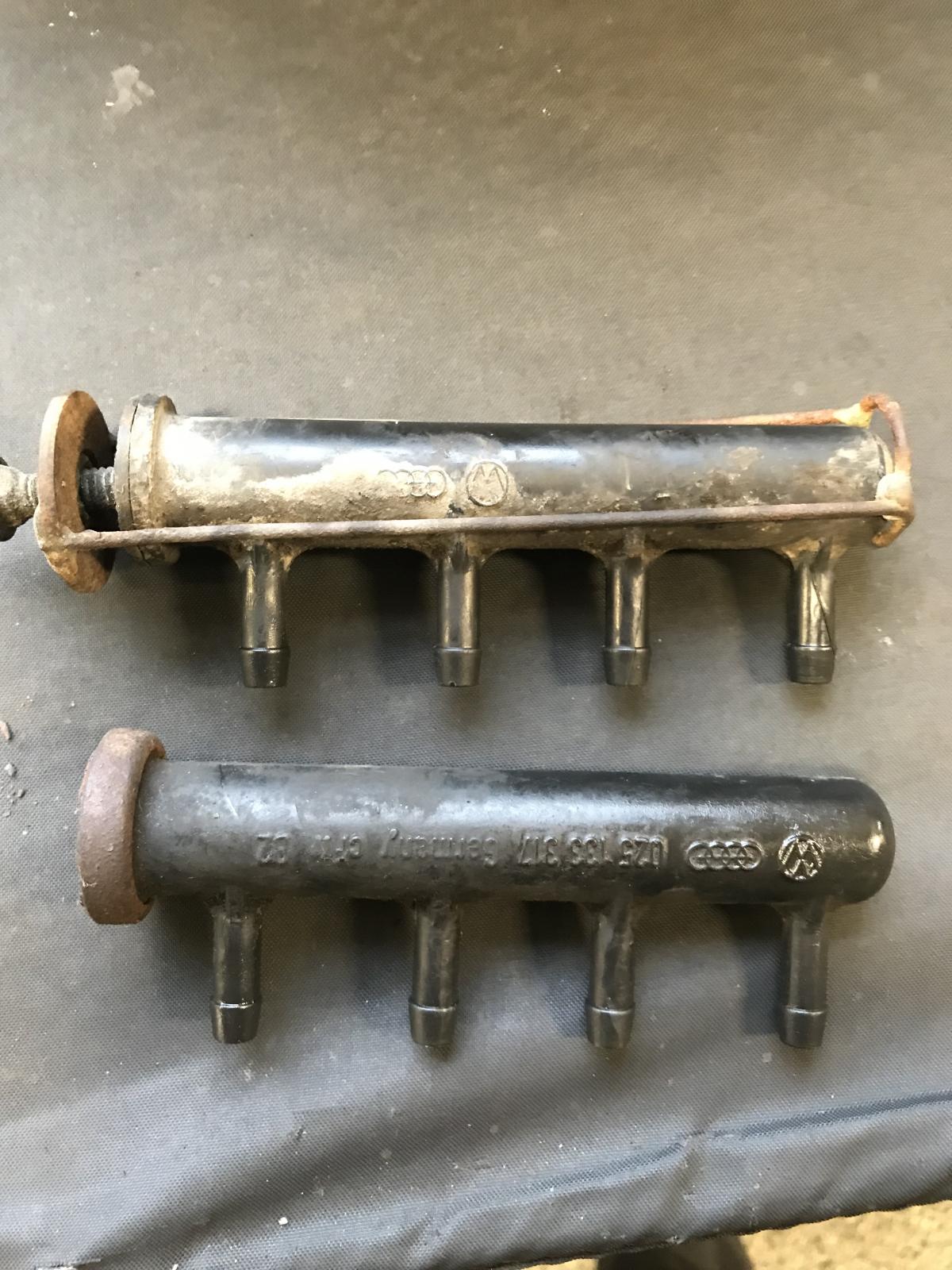

Don't forget to remove the rotor and oil the felt 'sponge' that should be under the rotor, on the distributor shaft. Even if it's missing, add a few drops of oil to the shaft before putting the rotor back on.
Clean all your engine grounds. Get to those fuel hoses as soon as you can.
I recommend new Fuel Manifolds over keeping the original plastic ones that the VW came with.
Here's how scary ours looked when we first got the Vanagon in Fall 2018. Didn't actually leak,,,,,yet........ Shocked Shocked Shocked

Thanks. It already has the billet ones.
