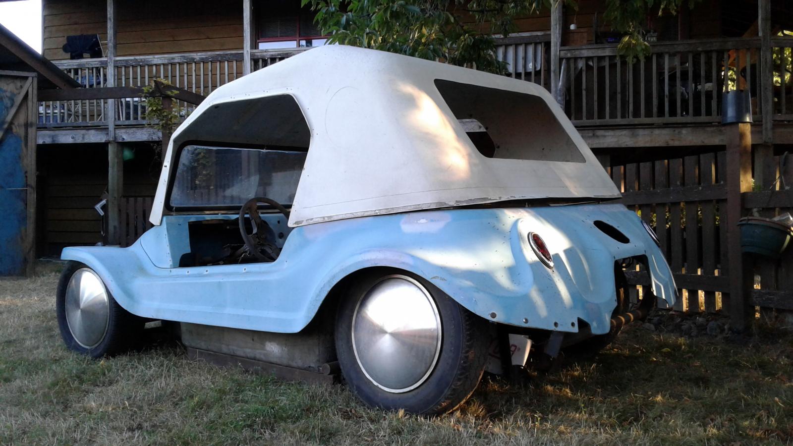

Here's my Hillbilly, they were made during the 60s and 70s I believe in Coquitlam BC, Canada. Not many people have seen this design as it was produced locally and may not have been widely distributed. When I saw this body I knew I had to build something cool with it. I originally started this project 16 years ago and then mortgages, marriage and other projects got in the way. Just started up again a week ago...
You can see how far tucked under the stock rims have the rear wheels. New tires will be 225/60/r15, and the rims are 7" wide with 2" less back spacing.
As it's not going to have a big bore motor I decide to make a plate from 3/16" mild steel and just weld the stock mount 3" higher.
Pretty crusty looking 1600dp. I've been hanging onto this motor for 16 years only to find the distributor drive shaft does not turn with the motor. Going to open this thing up this winter, will try not to get carried away...
Tubing across between the shocks was to check the clearance after trans raise.

Interesting body that I've never seen before. I like the built in headlights. It looks to have low sides for easy entry and more engine covering that most. I think it's begging for a top chop to go with the slammed styling. Cool

Today I bought a pair of 225/60/15 TA Radials for the rear and wrestled the body on by myself. Luckily everything appears to fit together. The tire height seems good so I won't need to alter the suspension further due to the increased tire height. Looks like a 3/4" spacer around the base of the body and it should all lay flat on the ground without the tires contacting the body when aired out. I'll be building my own bomber seats and running the salt flat discs on the rear too.
Tuck it in, tuck it in. In the lower left you can just see the frame rail/ground contact and a 5/8" MDF spacer to lift the body.
The area above the carb will need to be reshaped and a cover made with an opening for the air filter. Things are pretty tight with the 3" trans raise, the body needs to be notched even to clear the exhaust.
Body will need a notch a couple inches deep in the rear bulkhead.
Seems like every cool thing you do creates 5 more problems to solve Rolling Eyes

I agree with evfun, need to fit a lower/simpler roof or cut out a healthy chunk out of the original

Like this?

Topless

Got Air? Cool

Cool buggy! I agree, that thing needs a couple (2? 3?) inches removed from the windshield and the roof line about 6" lower. Are you in the Lower Mainland? I'm in Burnaby. Al

I like the hard top, and since you are just north of me I think it would be a good idea too (still looking for my Berry C-cab top.) Running around windshieldless on the nicest days would be cool too. It just looks, to me, like the top needs to make a contribution to the low stance you have chosen. The same low stance that the body really seems to work with. Perhaps a 4 inch top chop with the center and/or the back angle reworked to fit, after chopping the windshield pulls the top of the A pillars forward. A lot easier to do in fiberglass than in steel!

EVFUN: I understand these were produced on the Vancouver's lower mainland, Coquitlam is what I read on another forum. As rare as these are I don't see cutting the top up too much but I do plan to cut the windshield off and make a folding metal framed one. It's surprising how big a forward bind spot the fiberglass windshield frame creates.
