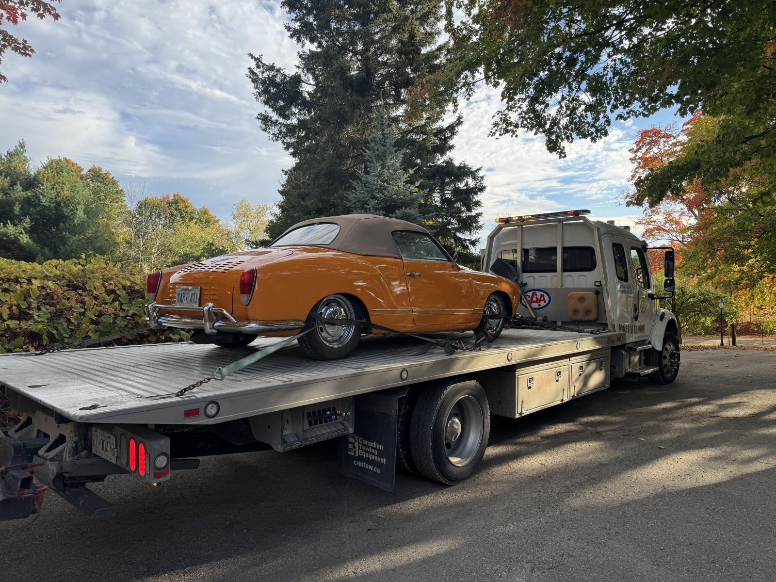

Here she is broken down...
And so I text my wife that it won't start and we'll be delayed getting home. We shared some LOL and she was just sad for me.
We had the car towed to Don's home/shop.

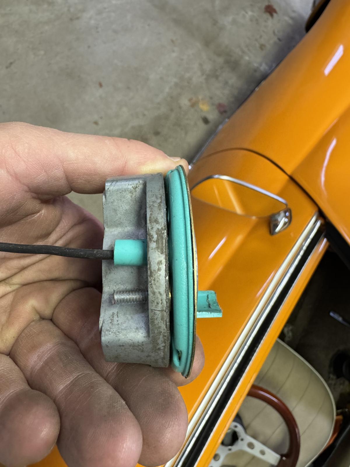

Project 1: Horn Restoration.
When I bought this car, the owner told me that the horn was not working. This is something I need to repair before I can get a safety on it in the spring. I investigated and noted that it did have an aftermarket horn which was grounded but had no power hooked up to it. It had a Grant horn button with a section of speaker wire dangling out of it connected to nothing and it had a hole in the front of the car where the factory horns used to be. Thankfully, just a little bit of surface rust in that area.
My donor car has horns so I removed them and tested them, but they did not work.
I looked up the wiring for the horn on a thread here, which was very helpfull.
https://www.thesamba.com/vw/forum/viewtopic.php?t=566567
I also found this graphic on The Samba which really helped me understand.
Armed with knowledge, I began to investigate the wiring in my car. First I noted that the ground jumper which goes over the connection near the steering box was not present, and there was no horn wire coming up the steering column. I’ve seen versions of the wiring where it was just a jumper that went over the insulated section and then the horn is wired to the column and other scenarios where there is a wire Fed up the column. I chose to feed a wire up the column because my horn button has two wire contacts on it.
The wire is attached on the steering box side of the insulator. You’ll note that in this picture it looks like the wire is on the wrong side. The bolt goes through and contacts correct portion of the steering box. I initially used one of the insulated bolts. I figured that out after getting a lot of dust in my face and using a whole bunch of colourful language.
And then fed up the steering column.
From there will be connected to my horn button, and from the horn button to a wire that exits the steering column through a horn ring on the bottom of the steering wheel adapter, and a matching tab on the turn signal switch where the wire comes from, as seen here.
My car has neither the contact ring that mounts on the bottom of the steering wheel adapter, nor the copper tabs on the turn signal switch. My turn signal is also missing the W shaped spring that allows for auto cancelling signals. So I have those two parts on order.
Moving farther into the wiring. There is supposed to be a heavier, gauge red wire, which comes from the far right tab on the fuse panel down through the headlight harness to the horn relay. My car had this, but it was cut off loose and stuffed in a corner. Thankfully, the wire was not live because whoever painted the car orange, painted the fuse panel which insulated the fuse. Once I clean that up, this wire was hot with ignition as it should be. A previous owner probably couldn’t figure this out so they ran their own hot wire from somewhere else on the fuse box using speaker wire, scotch locks, a giant fuse holder and electrical tape. This was removed, along with the aftermarket horn. I also found the brown horn wire in the original harness however, someone else had connected that to constant power and it was left stuffed in a corner too. That one was live, but thankfully didn’t short on anything.
With all of the wires sorted out, I moved on to restoring the original horns. I found this YouTube video, which was very helpful.
https://youtu.be/oC1Vf2M1HGw?si=jcbRzJE1vAXp3Azl

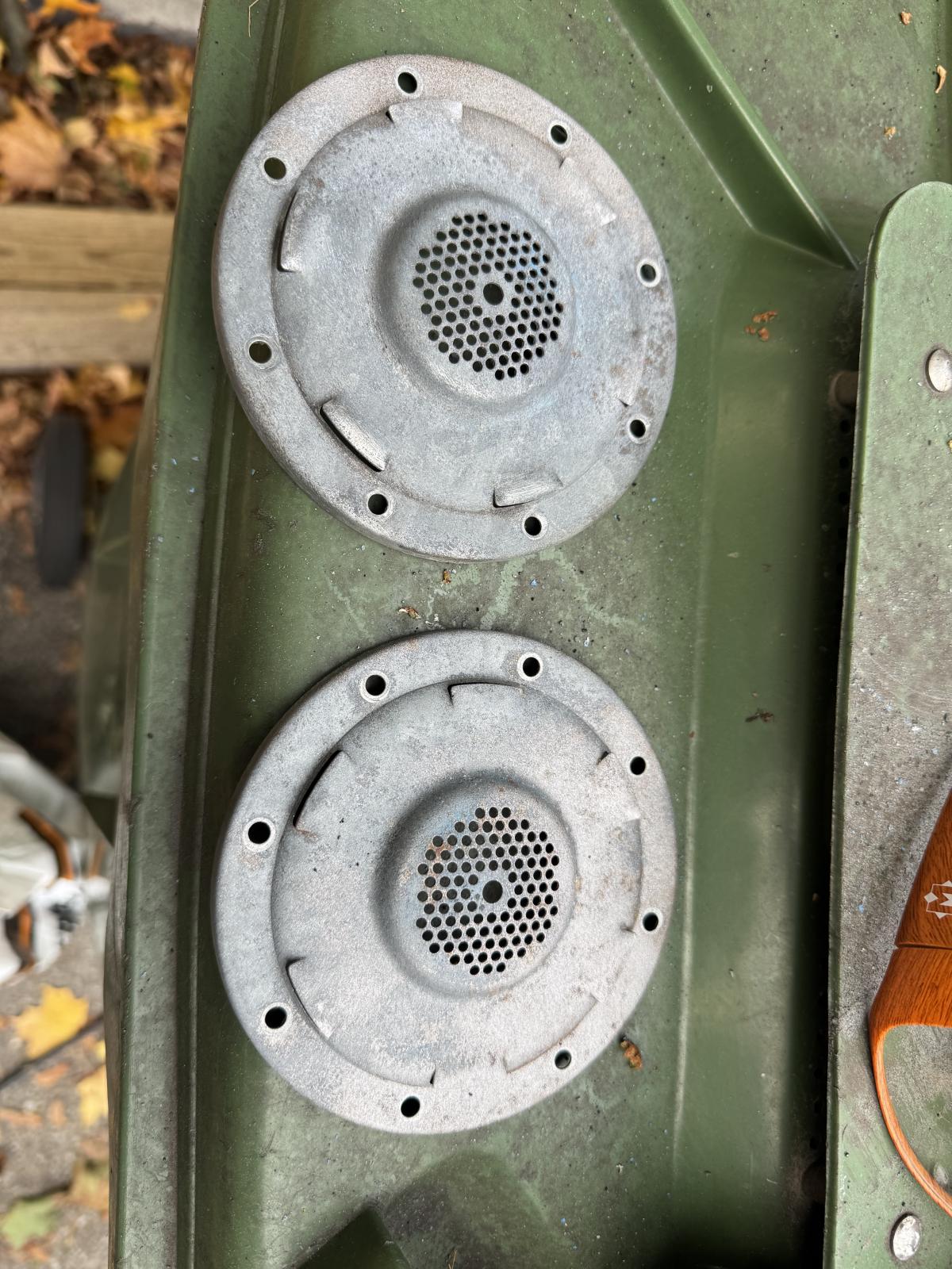

Earned with knowledge, I disassembled my horns. Thankfully, they came apart, quite easily with a little bit of penetrating oil.
I won’t bother going through the procedure as the fellow in the video does a wonderful job of taking you through it so if that interests you, you should just watch the video. Basically, I had to isolate this contact which spread apart like a pocket knife and has two contacts that vibrate against each other, which needed to be sanded.
Next, I hit them with the wire wheel which cleaned them up really nicely, but still left some rust
So after Princess AUTO to get a 50 pound bag of copper oxide and I hit them with the sandblaster.
The last step was to paint the front of the horns with a bit of Tremclad Gloss Black.
That’s it for now, I’ll update this when new parts come in the mail and things are reassembled!
Craig.
Update: October 27, 2025
Today was a big day for the horns! My package from CIP1 arrived.
Prior to installing the turn signal switch, I compared it to the one in the car. There was four interesting differences.
1. The black wire on the new one corresponded to a black/white/green wire on the switch in the car. This wire is supposed to go to the unfused tab on fuse box position 2, providing a switched 12v signal to the switch. (Edit: I learned later that I had this wrong as I was following the black wire on the VW diagram. This wire goes to terminal 49a on the signal flasher relay-the JBug graphics up top helped me figure this out)
2. The actual horn wire is white. I had read this would be a possibility in other threads and confirmed with a continuity test. The brown wire (shown as the horn on factory wiring diagrams, on this switch goes to ground and causes a momentary ground condition on the brown and white wire to activate the high beam relay when the lever is pulled forward.
3. The contacts for the high beam switch, which are supposed to be normally open, were assembled such that they were in constant contact. This was an easy fix with some needle nose pliers.
4. This switch has a duplicate set of contacts to the first set. There is a red and a grey wire coming off of this switch. The red goes to the common pole (as the black does on the other set of contacts. The grey is bridged between the duplicate set of the left and right contacts. It creates a condition where there is continuity between the red and the grey wire when the switch is in either the left or right position. For my car these are not needed but I think I read that later model cars, or maybe a Type 3, do use these so I’m thinking this switch is useful for a variety of cars. Anyway I left these wires lose as they could be fun to use later. As a trigger for a starter kill, for example, where I leave the switch on and it prevents the car from being started. Who knows. Anyway I could have removed them to clean things up, but opted to leave them.
Going back to the black wire….. as described above, on the original switch it’s a black/white/green wire and it didn’t go to the fuse box. I started out thinking I would move the wire to the fuse box but opted to investigate first. It was butt spliced to a 6” long piece of grey/red wire, and then butt spliced to a blue wire which went back to the emergency flasher switch. It’s way back in the corner so I followed it with my fingers into a loom that goes to that switch. Position 2 on the fuse panel had no tab for an additional wire. I cut the wire and tested the blue one that goes back to the emergency flasher switch. It’s hot on ignition. So, I opted to just connect my black wire there since that’s where it was before and it was working fine. Also since there was no tab to connect it on the fuse panel it would have required a splice or an adaptor so this made sense. I might address this later if/when I rewire the car.
Edit:
I figured out the black Vs black/white/green mystery. On the JBugs website they have a tech help section with diagrams where is found these two… one of the flasher relay and one of the turn signal switch:
The black/white/green wire from the turn signal switch gets its power from terminal 49a of the flasher relay (J2) It also connects to the emergency flasher switch (E3) This would explain why in my car, it was connected to the emergency flasher switch, as that connection could have been made a junction, or on terminals 49a of the flasher relay or the emergency flasher switch.
The black wire I was following on the diagram was actually the switched 12v out from the ignition harness. I was just confused because it was black. Basically what it all boils down to is that my after market turn signal switch has a black wire where it should have a black/white/green wire.
After that fun exercise, everything was working great… but I noticed my passenger side head light was out. Armed with the wiring diagram I narrowed it down to the fuse, but the fuse was intact. The fuse panel was however painted by the excited painter…
I sanded the ends of the headlight fuse and the holder and it came back to life. What a relief!! I took this opportunity to sand all of the other fuses and contacts. I was really concerned when right after doing wiring, another electrical item stopped working. What are the odds! Hopefully that won’t happen again now that they are all clean.
Finally the white wire was connected to the horn negative that goes through the headlight harness to the horn relay.
The next step is to install the horn relay, the horns, and finally the contact ring on the back of the steering wheel.
Craig.
Update: October 30, 2025

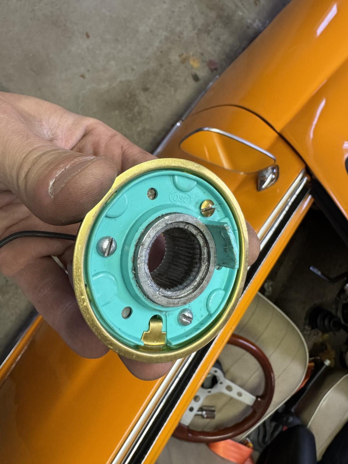

I got to work on the horn contact ring today. It would not fit over the stump on the back side of the Grant adapter so I used a file to widen the hole just a bit, and found some 6/32 screws that fit the adapter.
With the ring flat on the back of the adapter it barely made contact with the turn signal switch so I put a washer between it and the adapter. I tried a few washers first but it pushed it forward enough that it closed the high beam contact. One washer was perfect.
Here it is fully seated again shed the steering shaft and there is plenty of clearance on the high beam contacts.
And with that complete, all that remains is to install the horn cap, the relay, and put the horns back in the car.
Oh and as an added bonus, thanks to the tab here and the new turn signal switch…
I have auto cancelling signals again!
Craig
Final update!! October 31, 2025
Today I officially wrapped up the restoration of the horn.
I installed the horns and the wiring that I scavenged from my donor car. The mounting bracket and ring terminal got hit with a wire wheel to ensure a good ground.
And since this is an environment where there is bound to be moisture, all electrical contact surfaces got a little spray or dielectric grease.
I found a 40A relay in my collection and it was wired in. It doesn’t have a mounting tab so I made one from a zip tie that has a screw tab. I also wrapped the relay in electrical tape just incase.
The last piece was the horn button. The wheel has a cool button with a Wolfsburg logo on it but it doesn’t fit the wheel. The previous own solved this with some bits of chrome body trim stuck around the edges. The stuck out past the button and made it stand proud about 1/8”, which all looked terrible.
My other passion is model railroading and I have lots of plastic strips and shapes in stock. I decided to wrap the buttons mounting tabs in a couple of layers of strip styrene.
Once I had a nice press fit, I added three extra short pieces just to create a bit of extra friction.
I wired it up and popped it in…
And it’s done!! I have a working horn, back to factory spec!! I still need the rubber boot but I’m calling this one

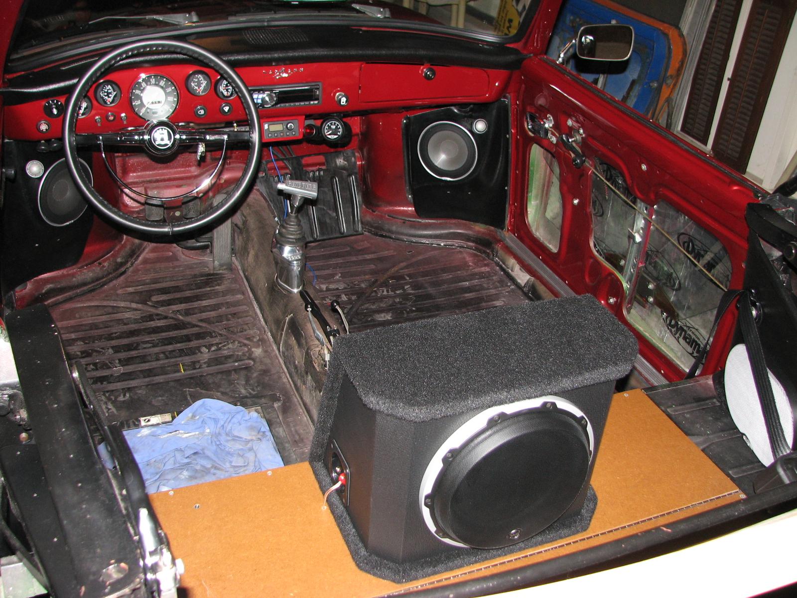

There was also progress on the ... audio system (I put in a CD player and actually have tunes now).
That Alpine unit looks familiar; my photo doesn't belong in your thread, so here's a link if you're interested. https://www.thesamba.com/vw/gallery/pix/2111840.jpg
When I bought that head unit many years ago, I felt at the time that I was buying into one of the most respected brands in car audio. I had always wanted an Alpine. I’m glad I hung onto it for all these years. To be honest, I didn’t even remember that I had it.
Thank you very much for sharing your picture. I spent some time looking over it and I see a lot there that I really like. Your kick panels do not look like the aftermarket ones that you can buy. Did you custom make those? I also really like your instrument cluster. It’s very tastefully laid out with the gauges and kind of an upward curve versus the straight across that you see quite often. If the outside of your car looks anything like the inside, I imagine it’s stunning.

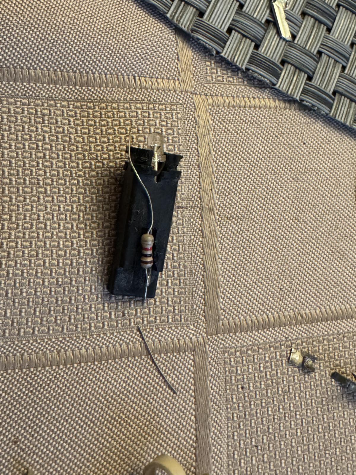

I decided I would try and light it with an LED using the original light socket. To prove the idea, I used a socket that had one of the tabs broken off, so it wouldn’t stay permanently in the hole. For this project I needed a light holder, a 3 mm warm, white LED and a 1K resistor. In the lightbulb holder, I removed the positive contact by ripping it out with needle nose pliers. It broke into two pieces. Part came out the front, and part came out the back. I also used a small screwdriver to bend the remaining negative side contacts closer together.
For the LED, the negative, or an anode side, is the shorter leg. I bent that over itself three times to make a bulky leg that would be trapped in the remaining negative side connector.
This was inserted into the bulb holder with the positive, or cathode leg, sticking out the hole where the positive tab used to be. I trimmed it short and then soldered a 1K resistor to it. For soldering in a high impact environment, like a car, I always use silver bearing solder as it creates a much stronger joint.
I wrapped tape around that to secure it to the bulb holder, leaving the other end of the resistor free to be soldered on a male spade terminal.
I didn’t have a small size male spade terminal that would match the factory terminal so I modified a wider one to fit.
I removed the plastic on the outside of the connector, squished it flat and soldered that onto the exposed leg of the resistor. That was wrapped in tape again to secure it to the side of the bulb holder.
A test in the car yielded a much brighter indicator. Again difficult to see how accurate is here, but it is definitely brighter.
