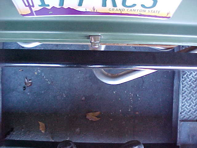

TimGud
Joined: March 03, 2002
Posts: 6459
Location: Rio Rico Arizona
TimGud is offline
PostPosted: Wed Jul 28, 2004 1:16 pm    Post subject: Reply with quote
I'm running the Kymco header with tuck away muffler as well and am very happy with it.

TimGud
Posts: 6459
TimGud is offline
PostPosted: Wed Jul 28, 2004 9:10 pm    Post subject: Reply with quote
Tim, can you be more specific about your muffler? Got any pics?
Sure. Here ya go.
These are the only ones I have.
I have hit the skid plates quite a few times and never hit the extractor or the muffler. The muffler is tucked in right behind the shock tower so it is somewhat protected from getting hit by rocks by its placement. I doubt it flows as well as the fatboy though.

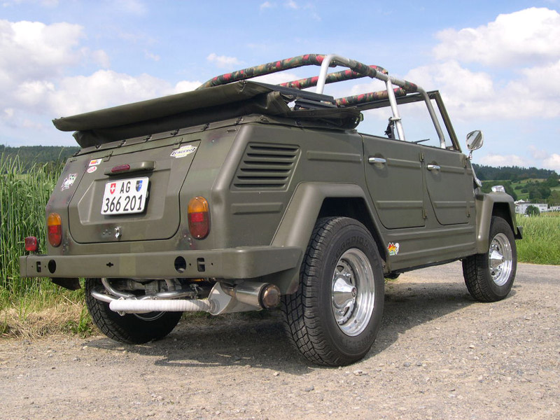

fathing
Joined: February 09, 2004
Posts: 110
Location: Switzerland
fathing is offline
PostPosted: Fri Jul 30, 2004 4:31 pm    Post subject: Reply with quote
I went with a Empi Premium Header system and added a bugpack hide a way muffler which I altered a little. The clearance is ok and it looks and sounds great.
To prevent nasty burns by the header I wrapped it with heat insulation wrap.
radioman, in theory a 4 into one header system has an advantage over a "dual header" system on a 4 banger engine. Every 180° you have a stroke. This helps the scavanging effect on the heads. (Kind of draws the exhaust fumes out of the head.
Greetings Dom Cool
