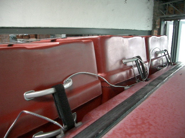

PostPosted: Sun Mar 09, 2008 3:26 pm    Post subject: Reply with quote
Cris

Cris, where did you get those boxes, that's beautiful!

A friend of mine and I designed them a few years ago and made a few. The idea is to be able to:
A) Load and unload them without too much effort (that is the reason why there are three of them).
B) Be able to access the contents with ease without taking the boxes out of the rack. They open forward, so it is very easy to access the contents from the pop top opening.
C) Be compatible with the Westfalia roof rack. They match the grooves, size, and support bracket locations. The slope in the front of the boxes is the same as the one in the Westy roof rack.
D) Be completely waterproof.
We did a few with integrated color in the material (such as the ones shown in the photos), to match VW colors, so they never get scratches or spots where paint is damaged or missing.
Cris

V cool!

How were they manufactured? Do you still have the molds? What material...etc?

Yes, we still have the molds; they are in Argentina. They boxes are made of fiberglass. All the sets ever produced (not many) were distributed among the few Westy enthusiasts in Argentina. I brought two sets to the USA, sold one and kept the other one for myself. Do you think that there is enough interest to produce and bring another batch of these? It could take a few months...
Cris

So you are the owner of the only other set in the US? I am glad you liked them. There are a few finishing details that I would improve upon, if we were to make some more, but overall they have worked for me too.
Cris

Wouldn't vacuum forming be a more efficient way of making them? Just looking at the shape, they would vacuum form really well, it is way faster and cleaner than fiber glass and cheaper to make.
I am just wondering what the hinges look like?

I forgot to mention that the Westfalia logo is actually a relief within the mold, so it has a depth. It is not just a sticker that would erode after the first trip...
I have no idea about what costs would be, but I will certainly find out and report back, since there seems to be enough interest in this item.
Cris
