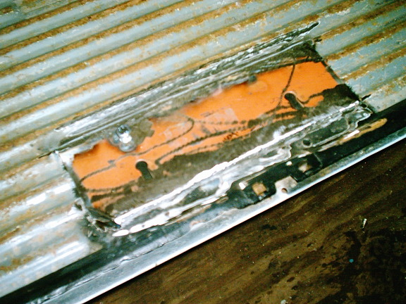

I just got some Bay Window seats (69) for my split (64). The rear seat fits into the spot just fine, but the seat legs do not line up with the floor mounts. That's okay, because there are no floor mounts in my bus! So I have bought the mounts from Wolfsburg West and will weld them to the floor.
The Middle seat is a 3/4. Its legs do not match up with the floor mounts either. I bought the big plates from WW to weld to the floor.

The seatbelts from a bay window should work in your '67. I stripped two '67 standards this year and I don't think either one had seat belt mounting holes for the middle seat. They both had plastic plugs in the mounting holes for rear seat belts as I recall though.
I welded a nut on the bottom of the WW seat mount plates that I had welded into my panel floor. The silver thing next to the left (rear) seat mount keyhole is a bolt for mounting a seatbelt. It works great and it's much better than cutting a hole in the floor/belly pans to mount the seat belts.
