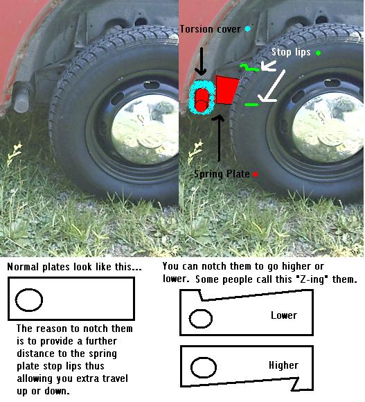

On an IRS there really is not much of a point to notch the spring plates. About all you can do to an IRS car after what you have already done is go about 1/2 lower. Its not really worth cutting the plates for that small of a drop. Actually, Airkewlds Ghia with the custom IRS pan is the only bagged VW ive seen lay rocker panels on the ground...Well, Except for the Kustom Koach Werks 51, but that car has a totally custom bag setup too. I thought about notching my plates but with the body back on and engine in, it will be much lower than any bug that isnt bagged. I should be close to laying Oil sump.
Ill post a pic of what a spring plate is

PostPosted: Wed Dec 08, 2004 8:35 pm    Post subject: Reply with quote
Maybe this will help.

Do you mean that the trailing arms are touching the stopper on the rear shock tower? If so then the only alternative I see is Notching the hell out of your plates and cutting the stop on the tower off to keep the trailing arm from stoping. Doing that should get you lower but I dont know about doing all that man... Theres nothing a sawzall can do that a welder and some time cant fix though!
