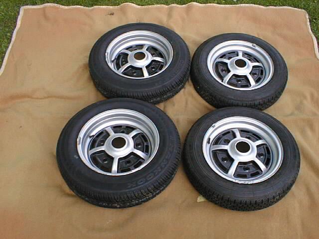

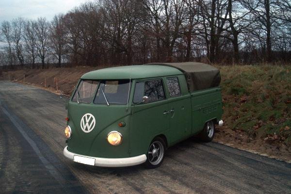

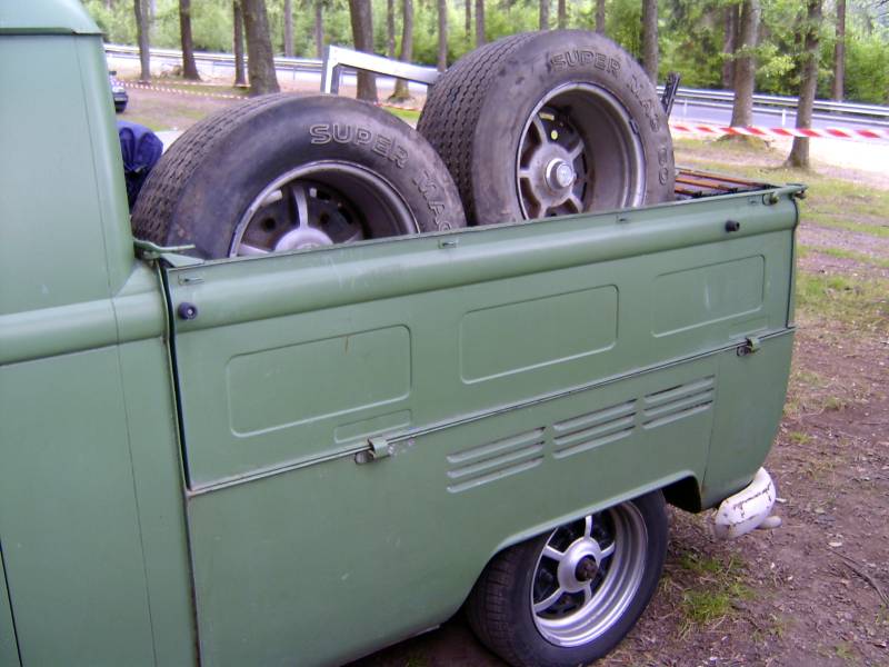

I had 5.5 x 15 lemmertz sprints on my 67 bus a few years back. The fronts i machined off the welds holding the centres in to the rim and flipped the centre round to make the wheel more inset. This gave me a front wheel that sat inside the front wheel arch. I didn't have any problems with the inner edge rubbing on full lock either. The bus was lowered.
At the rear i think you will struggle with a standard reduction box set up and a stock 5.5 lemmertz sprint as they are quite offset. I had IRS from a super beetle (1302 / 03 for us europeans) which gave me a narrower rear track allowing the wheels to sit just right at the back too.
Take a straight edge across your rear brake drum then measure from that to the inner lip of the wheel arch. take these measurements with you when you are loking at wheels and be armed with the info you need. Remember that the tyre will more than lokely be wider than the wheel by a little.
There's no saying you can't modify the steel lemmertz sprints to fit your application. You could even cut out the centres and graft into a 4.5" rim i suppose. Just get an engineer to align and weld them back up. Jobs a good un. Wink
Of course if you are talking about repro sprints all this is to be ignored but then who would want copies anyways? There mean't to be steel. Steel wheels rule. Razz
