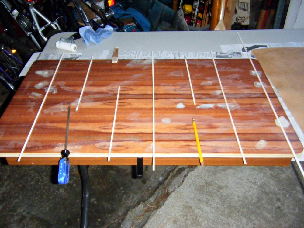

I just did my sink cabinet top with mahogany veneer. iron steps were great...even figured that out before reading about it. Very Happy
some pics... Ah, also a 77 westy job here
I used a total of 2 coats of laminate type contact cement and 4 coats of poly
on top. just waiting for the final coat to cure before gluing on the edging.
I used a filler to level off the surface...
