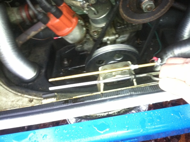

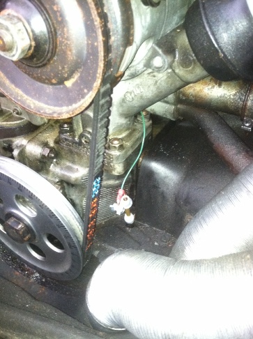

PostPosted: Tue Dec 06, 2011 10:30 am    Post subject: Reply with quote
I'll post some pics when I get home tonight. Of the old and new dipsticks side by side as well as the new dipstick in the engine.
IIRC they were the same length, it was basically pull the old one out, put the new one in, route the wire behind the generator stand, make the new connection at the oil pressure sender, done. It is slightly more difficult to remove, mostly due to the wire being attached, but certainly nothing to worry about.

PostPosted: Wed Dec 07, 2011 7:41 am    Post subject: Reply with quote
Here's some pics:
