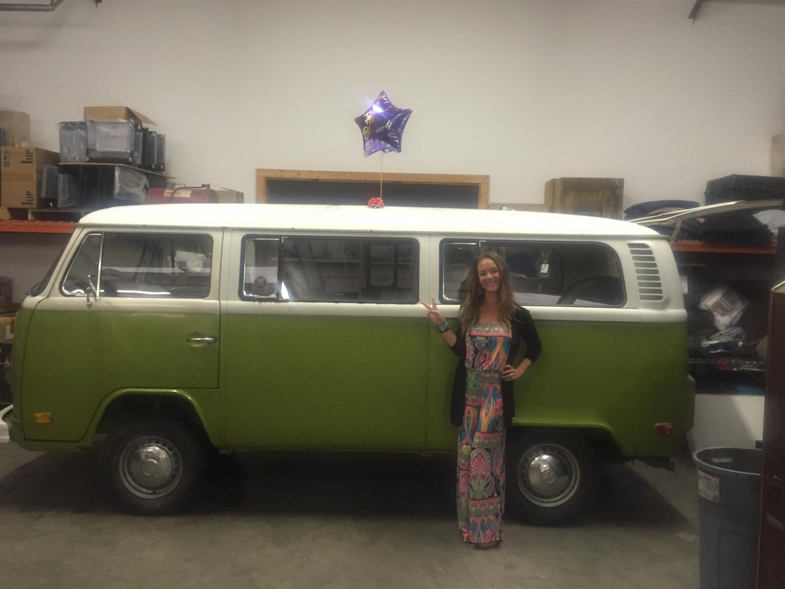

So , I bought the wife a 1976 Bus for her birthday. I wanted to get a '76 because my wife is a '76 year model also. I found this little beauty ,gave to her on b-day , then proceed to rebuild

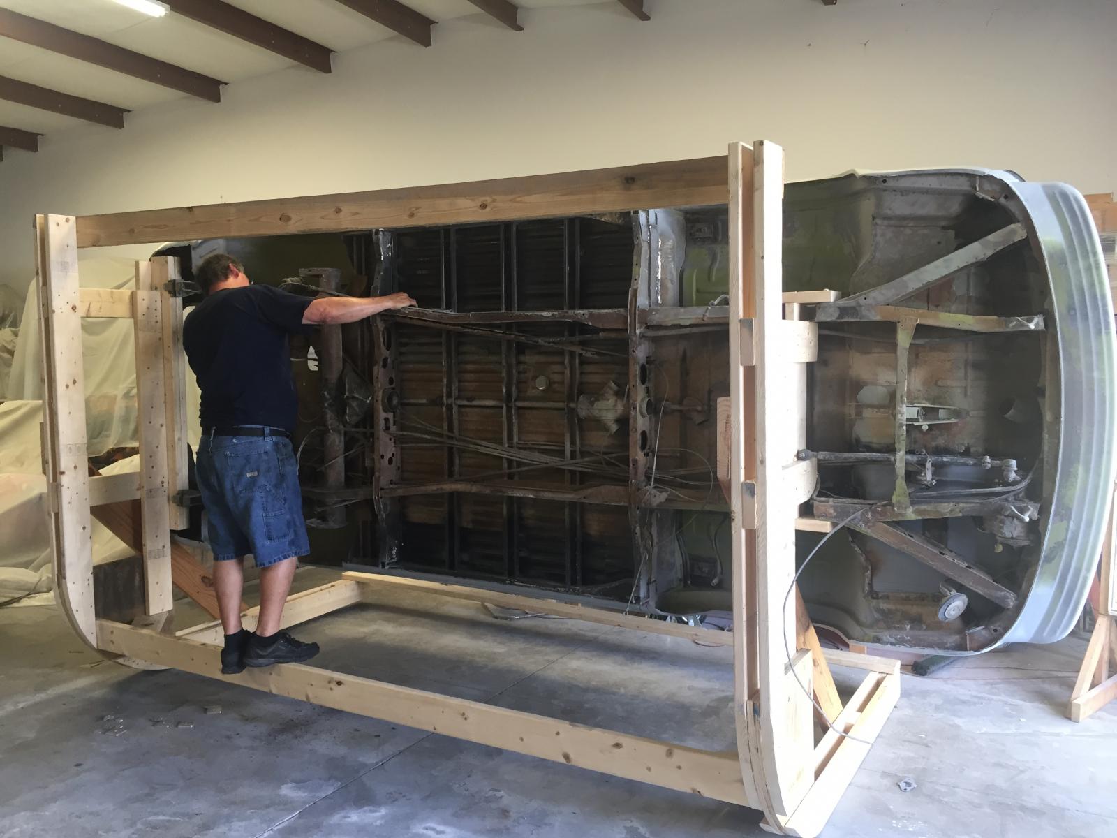

cool homemade rotating rack! I can't wait to see this project when finished.

Thanks, been working on topside , decided to "flip" and now gonna soda blast the under side and Por 15 and paint . Been bead blasting all parts , painting and baking !!! .

But really, that’s an impressive roller over’er…I’ve never seen one made of wood. Are you a framer? And that’s some nice shop space to tear into a project like that.

Thanks, @ busstom, No I'm not a framer. Just me and an employee of mine are doing this. Will have a pro shoot the paint though, in a paint booth. I'm not in this business by any means, thought it would be fun to do. The " redneck rotisserie" was something I saw on you-tube and we built it ourselves , took about aday and a half ,about $150 in materials, Works like a charm!!! I'LL shoot a video of it in operation.

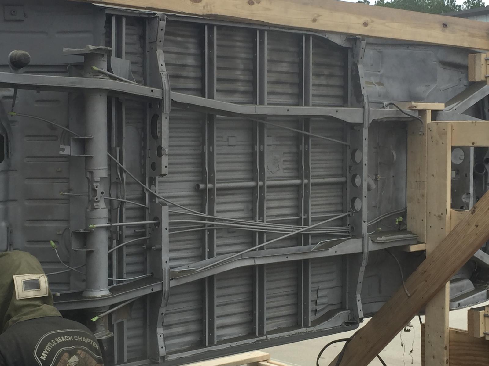

Rolled her out on the " Redneck Rotisserie " to do a little sand blasting. Pics, are - before , during and after.

I've not seen one made out of wood before, but that rotisserie sure seems to be doing the job. Best of luck with the work!

A suggestion? Since you have it all down to bare metal under there, go to an Auto body paint supplier and get some GOOD primer (etching first) and then a primer/sealer w/hardener in it and then some good paint. Let them recommend a good product/products after you tell them what you're trying to achieve. I've had mixed results with POR 15 and if I went to all the work that you have to get it back to bare metal, I'd use good automotive paint products that you shoot w/a gun. I think there much better than POR15.

Thanks wcfvw69, I have read a lot of opinions on the por15 vs auto paint subject. I have already blasted some parts and painted with por15 , that stuff is on rock hard !!! Im prepping per specs and going to apply " wet" top coat with por15 chassis top coat. Thanks for your input , I'm committed now to using por15 , we'll see how it goes

Since you're going that route, make sure you use all the pre-prep products it recommends before putting the por-15 on. I used Por15 on my pan on my 69 vert during it's restoration. Well, the master cylinder developed a small leak and before I noticed it, it ruined all the Por15 paint it came in contact with. It lifted right up and peeled off in sheets. Maybe I was expecting too much from the product.
