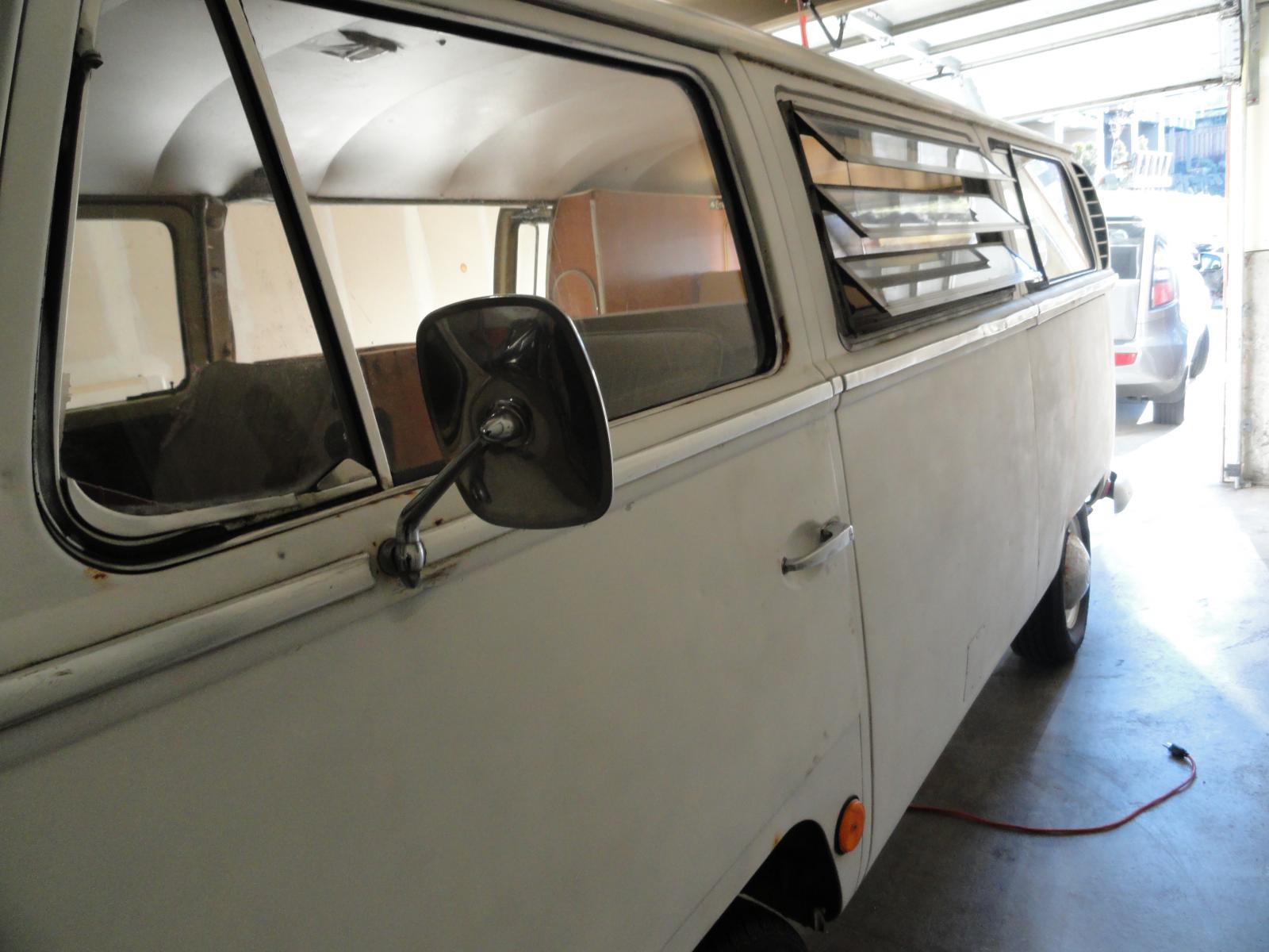

Hi folks - on new years 2015 I bought a 1968 camper. ( I had 71 daily driver bus back in 2005, but had to sell it, new baby blah blah blah, needed a car w heater...anyway...back to now, I wanted a bus to work on and drive again. )
the 68 was living in Seattle, and I brought it down to Portland for some TLC and to clean it up.
Bus is a bit rusty in spots, a bit rough, but it is mine.

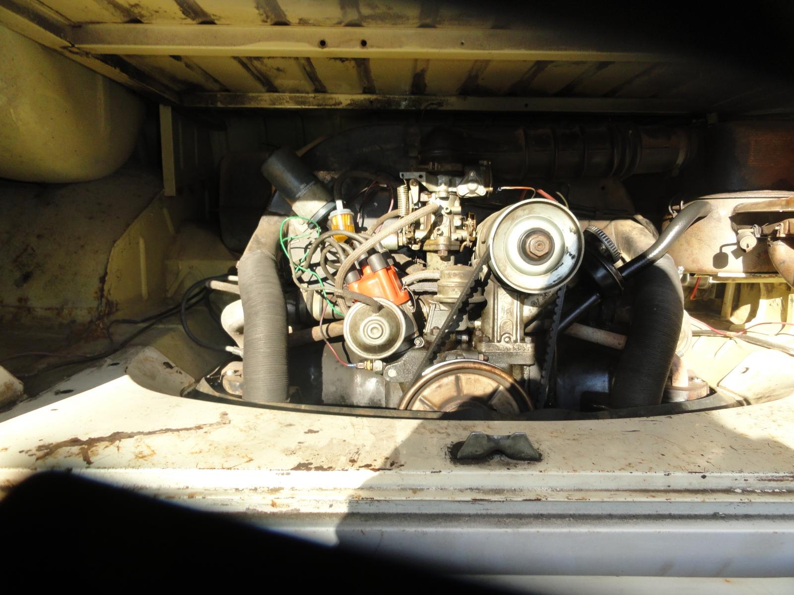

The engine seemed strong on drive home, but, after driving it home, I took it to local shop for engine check out. Shop said engine has a knock and engine needs a rebuild.
While I save up for rebuild costs, I am redoing the interior. The interior was complete, but old and musty and kind of rotten in spots from leakage. Here is what interior looked like:
Oh and yeah the bus has some front floor rust issues
Current status: Right now, camper interior is out, wood floor is out, rust in cargo area and back deck are being worked on, and cabinets have a fresh coats of spar varnish on the inside to prevent moisture damage. Steering wheel is back in. (Drivers side front floor is cleaned up and patched as best I can - por15 and patch panel w rivets - I know not the right fix for some samba folks, but due to space restrictions and fire hazards in narrow garage, I went w rivets...).

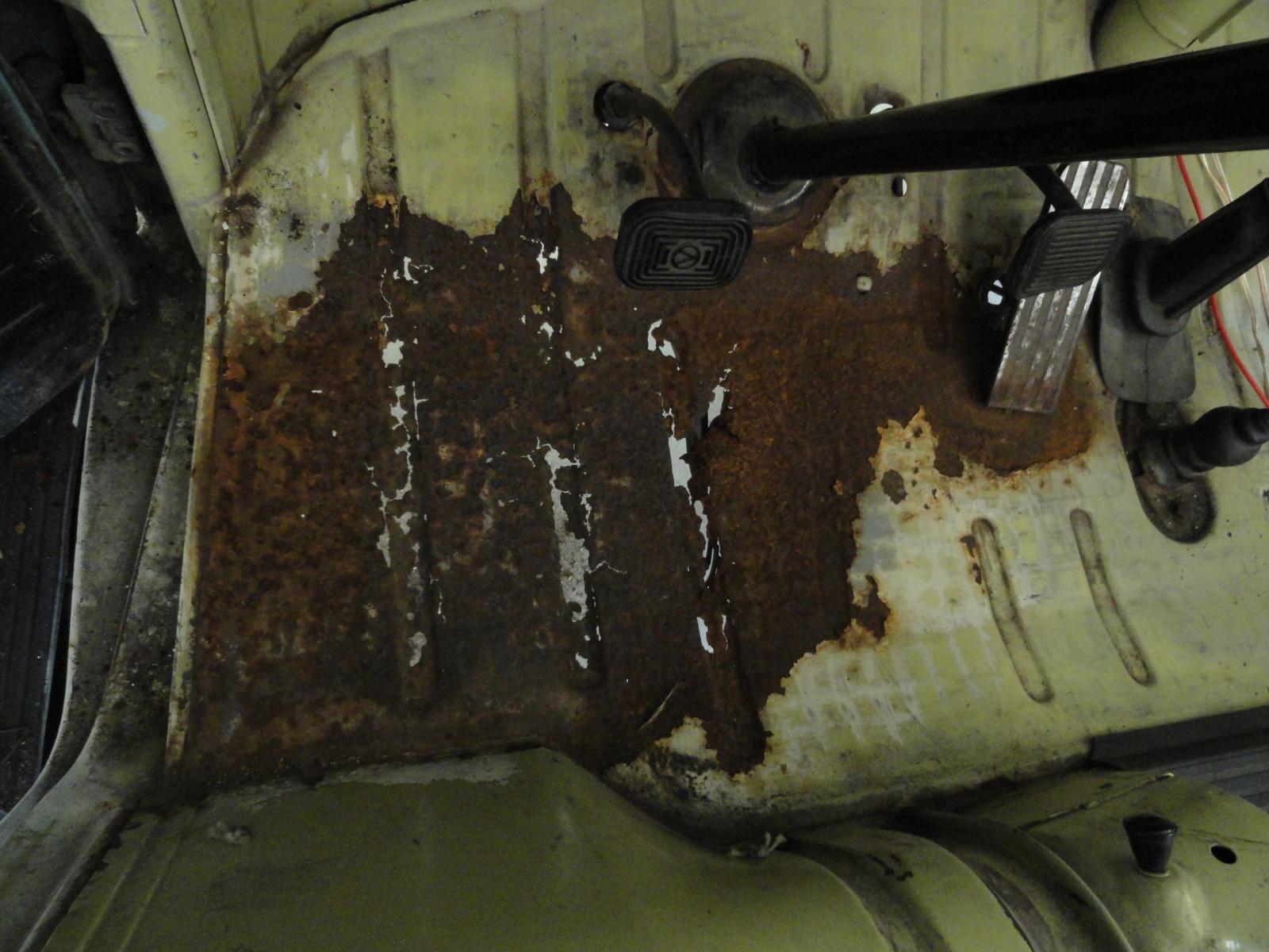

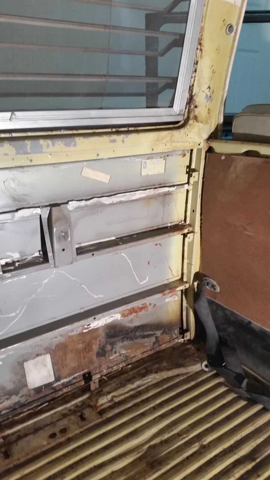

Here are some pictures of the interior as I did the rust repair.
The horse hair dread locks on the back deck were rotten and had little bugs crawling in the fibers.
Behind drivers seat. Ouch.
Cleaner!
The result of leaky windows and insulation glued in place behind panels:
Cleaner!
This glue was a bitch to get off the sheet metal.
Cleaner!

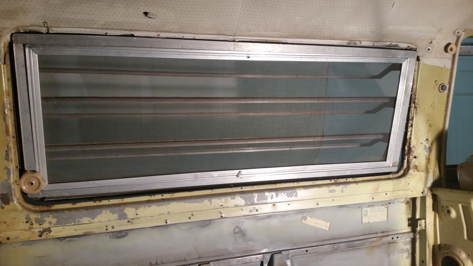

Leaky window. 7 different sized screws held window in place, non evenly drilled, with a big 'oh bus what happened?' on the frame behind drivers side.
Window is out. Need to repair window frame before putting it back in.

here is my floor it looks like a cow...por15 down
wall shot..por15
side louvered window got cleaned and a new screen

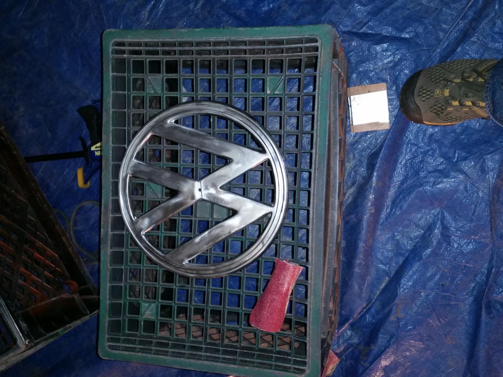

cleaned off paint off emblem, plan is to take it in to get re chromed and hole filled

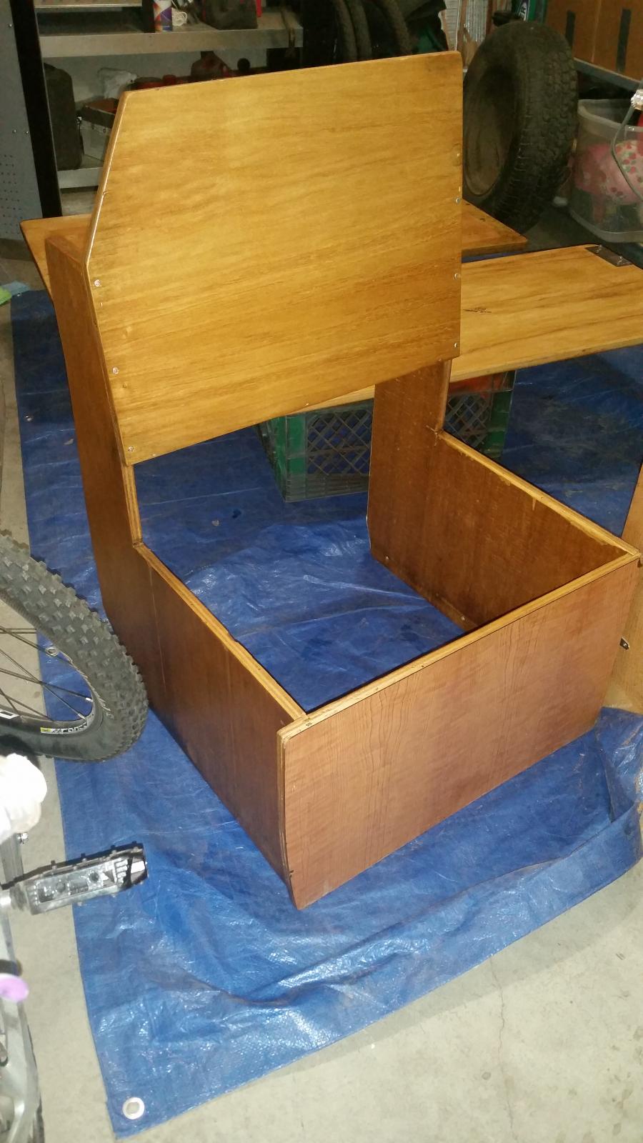

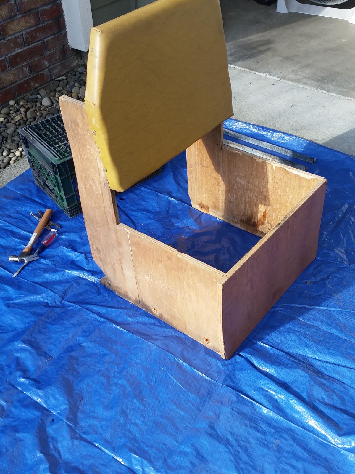

took camper stuff out to sand and re finish, here is the jump seat before
after, w spar varnish...still rough sealed off as best I could

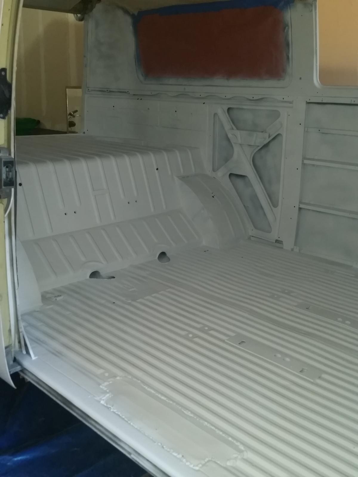

ok an update on my progress
I primered / painted the inside.
The floor and side walls that will be behind panels are going to be hidden so they will stay white.
The visible sides of the inside I repainted Arizona Yellow

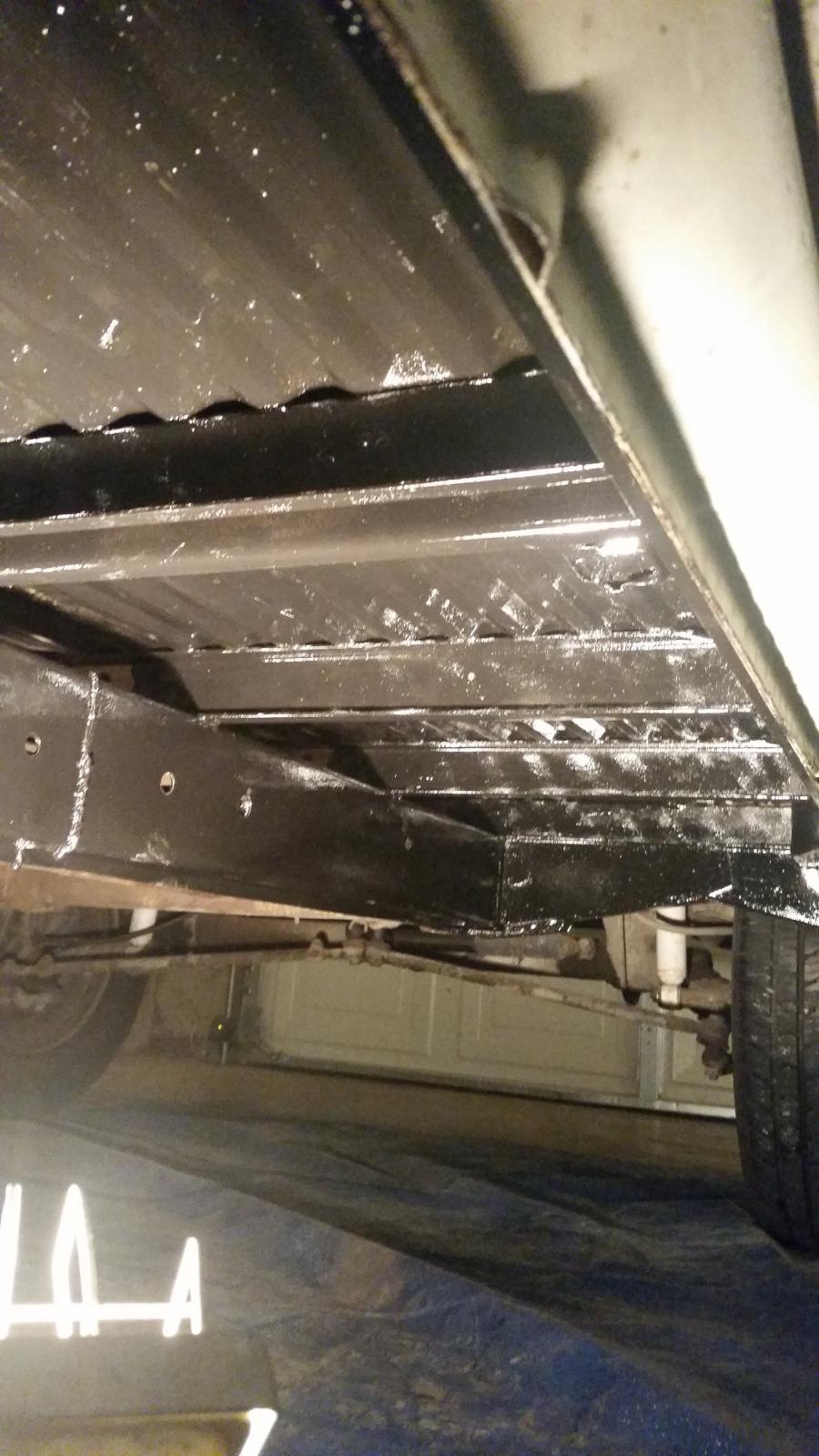

And also got the passenger side under side of the bus coated with some por15
Next up is the louvered window..which is taken apart...re doing the seals...which will keep me busy for a while...then putting louvered window back into bus....

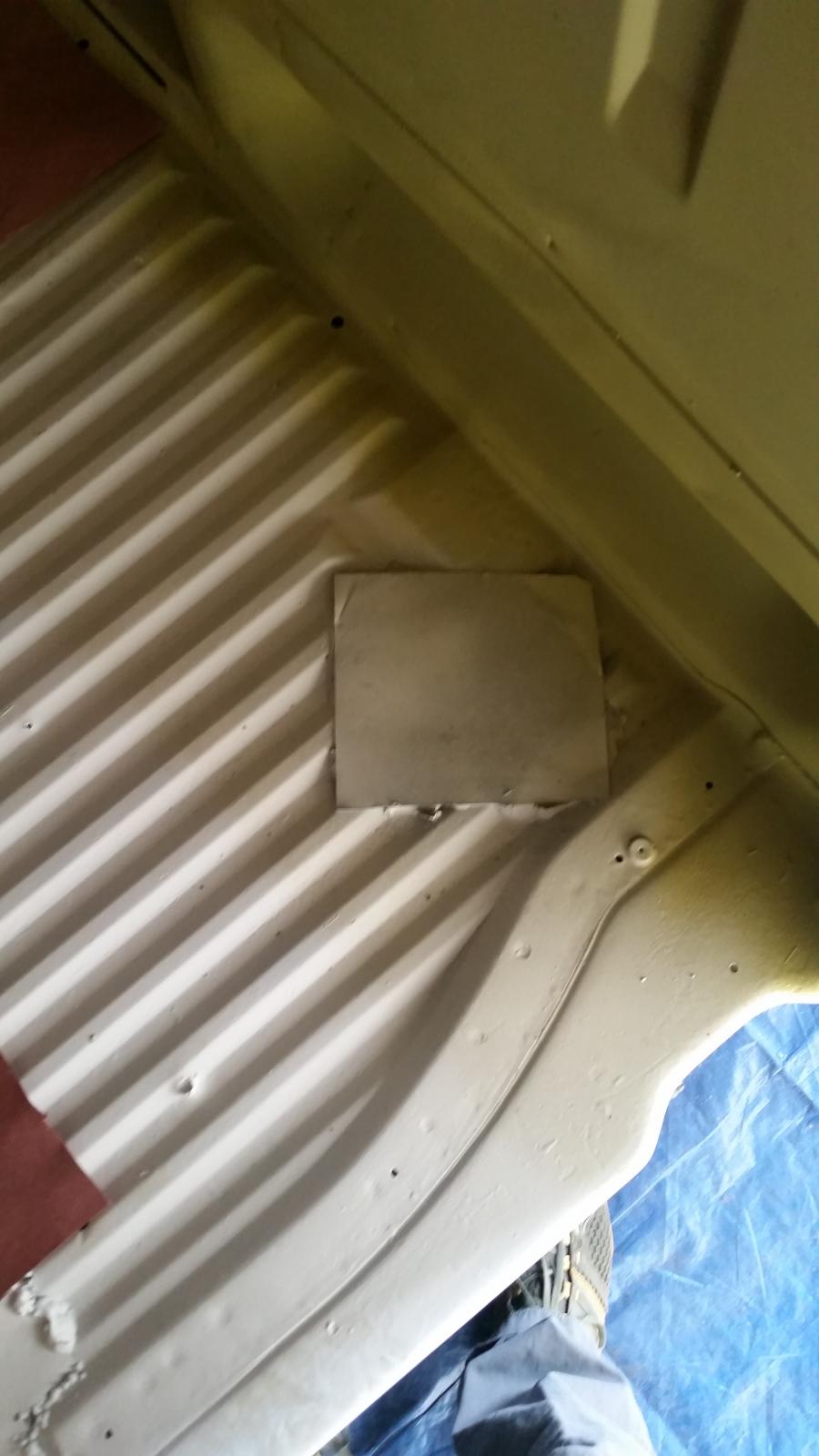

Also, can you tell me more about the patch over your sink drain hole? Mine is a bit trickier because of the belly pans, but I want to formulate a good plan for covering it up before I replace the floor. I'm leaning toward a small piece of sheet metal and silicone.

hi -camping68 my process for removing surface rust was a drill with coarse wire wheels.
I then applied por15 cleaner then por15 metal prep then por15 paint, which I painted on w brush. Over por15 went some por15 black top coat spray. Over that went basic white primer, then white enamel both rattle can from the local auto parts store. the yellow walls were painted w rattle can touch up paint matched to color from automotivetouchup.com , covered w clear coat.
the patch on the floor for sink hole was done by previous owner. it is a piece of sheet metal glued to floor with a silicone adhesive. Not pretty, but I'm not putting a sink back in and the patch is going to be covered by flooring, so I left it be.
d21998 - I got the screen replaced from a local screen shop in Tigard Oregon. Mobile Screen was the name.
( Cleaning and replacing seals in louvered windows is maddening. Fear of cracking glass and rusted in place screws have replaced counting sheep at night. )
