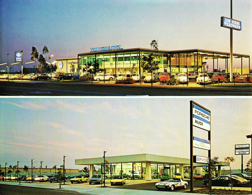

It must have been amazing to see these things new, a 72 bus in the show room. Something from a thread over on 914world, a little off topic, but...
Found an old pic of you, Chris. Very Happy
It would be cool to put a manual toggle front to a relay. I read somewhere old 911's used to have a cable adjust distributor advance right in the cabin. I've always thought that sounded cool, to adjust advance based on temps and how warmed up the car is, really get a feel for it in real time.
