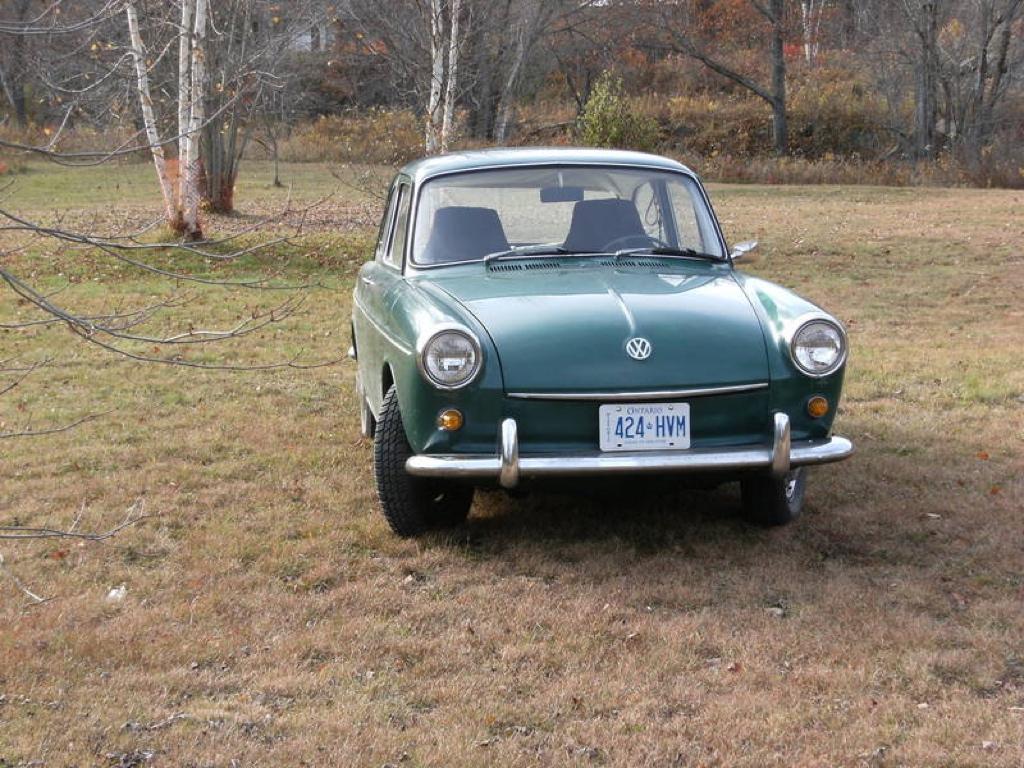

Picture from the add on Kijiji:

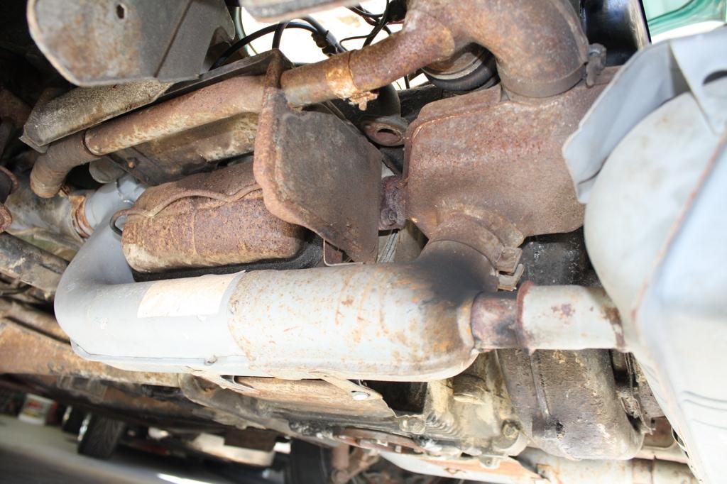

I know that the p.o. had some parts off the exhaust changed, and there is missing something on the driver side, I think it might be a pipe for hot air that goes in the carb:

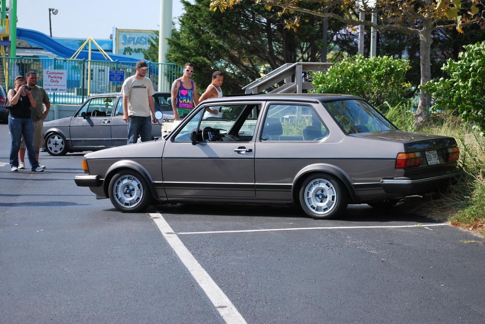

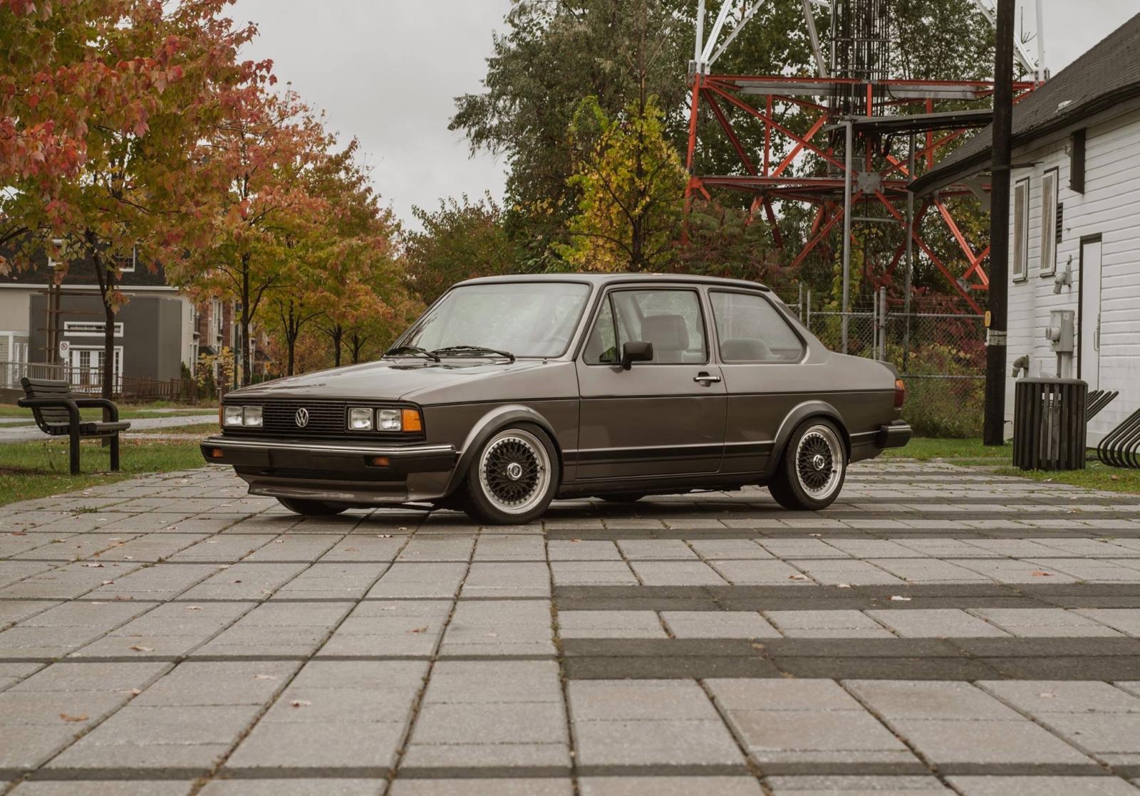

Also just to show you how I work here is my jetta:

Oh yeah that 68 is original. Its a Standard or a model or two up from a standard. Not sure how they did the options for Canada. I do know that for your market FI was an option, so a single port 1500cc single carb motor is perfectly ok there. You dont have a clock eithor, no side pad back trunk, plain black front liner but an Eberspacher!, non wrap around reflectors and painted wing windows-all standard-plain jane VW stuff, nothing fancy.
Sweet find. You do not see them that compleet anymore!

Fix this ASAP. The muffler is missing the clamp to the heat exchanger. You can see the black soot that has been shot out aimed to the front. This blows CO right into your heater!
The problem is you will have to remove the muffler to get the asbestos and metal rings on the heat exchanger outlet.
I also see the outlet of a heat riser on the intake manifold in this picture. Either the single carb was not original, or the wrong muffler/rear heat exchanger is on it.
From the looks of the left front heat exchanger (at least the front half!) it's new, no rust and a label still on it. Do you know the story here?
Nice car, all things considered. Clean but some rust issues. Should be fun!

Phil, I think the muffler got changed, as that's where the tube for the heat riser would attach. I know, as I've got to remove mine from my new muffler for my T-34 (the muffler was originally designed for a single carb), which is a 1500, with welded on pre-heaters. Where would you find a "late" muffler for a single carb t-3 engine? My first guess is Europe, as they got that combo until the end of production.

Right here:
http://www.thesamba.com/vw/classifieds/detail.php?id=985288
Also have one in my stash. Wink

Couldn't you leave the muffler in place and just remove the heat exchanger? It looks like you could just slide it forward...

You could, but I'm betting the right side is the same, so the effort is the same regardless.

Thank you for the info I'll fix that before driving it. I know that the po had the rear muffler and the heat exchanger changed by a garage...they clearly put the wrong parts on it. I still don't know how I'm going to fix the exhaust part, do I buy the right heat exchanger (the one that tram pictuted) or... put ips west ceramic over the top exhaust with J-tubes, after all I have a gas heater so I think I could live without the exhaust heat.

just currious, where were those pics of your jetta taken? i swear it looks like Ocean city Maryland...

Well you are good, that's in Maryland, at h20 international it's far from Québec, but it is worth the drive.

AWESOME! i go to ocean city alot and go to H20 almost every year, in fact i know the guy jay shoup that started H20.
