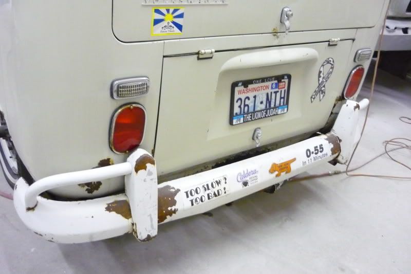

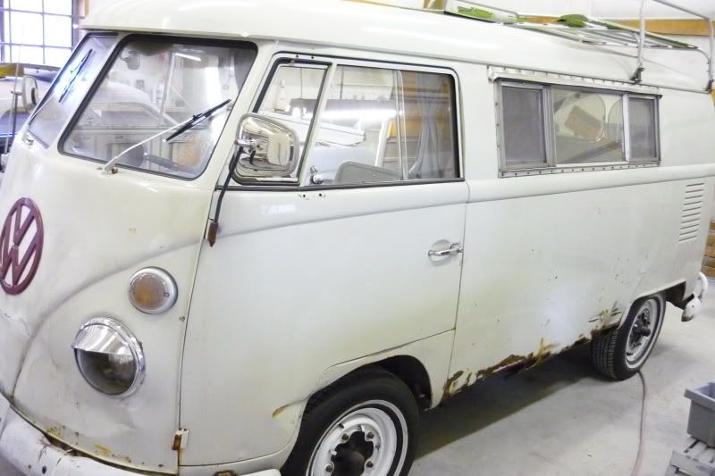

Thought I would share my project. It's my buddy Eric Williams' bus, and ended up being a partial restore. It needed rust repair, some interior, and touch body/paint. Looking to make it a little more respectable.
Hope you enjoy the pics Smile
What I started with.....

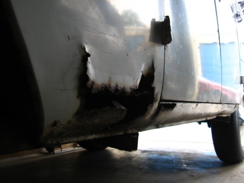

PostPosted: Sun Jul 12, 2009 3:14 pm    Post subject: Reply with quote

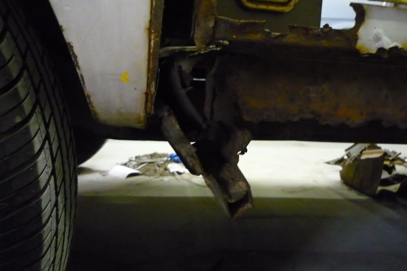

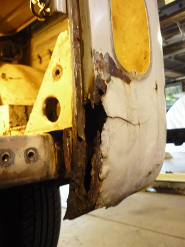

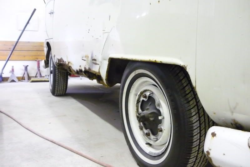

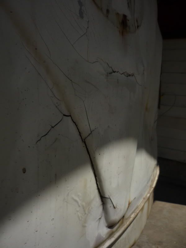

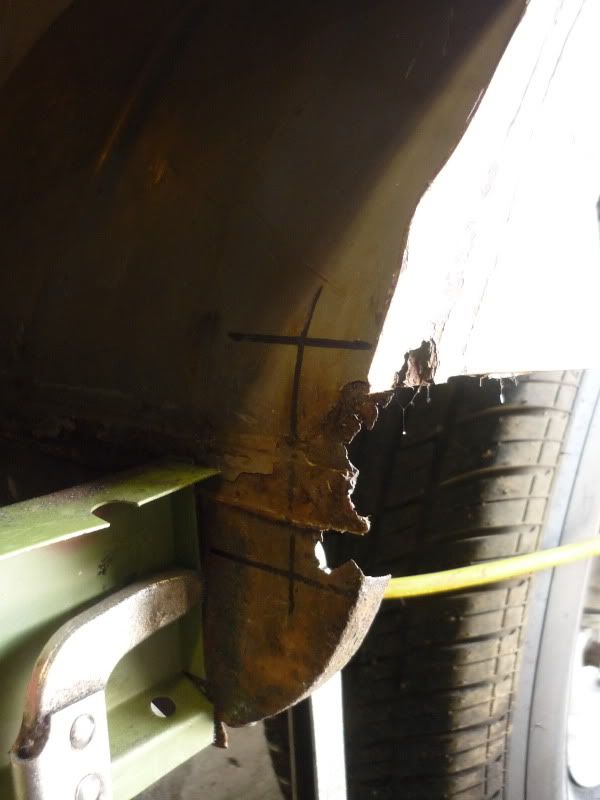

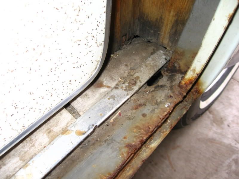

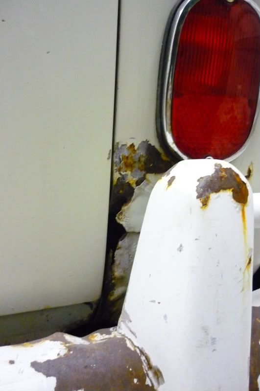

The drivers rocker was pretty bad.
http://www.thesamba.com/vw/forum/viewtopic.php?t=355803

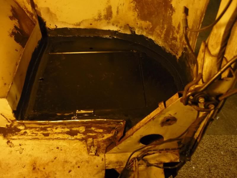

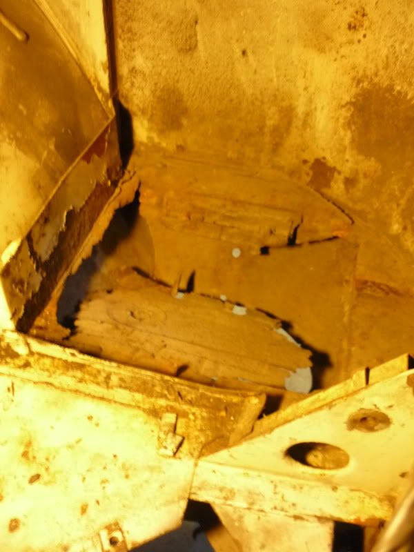

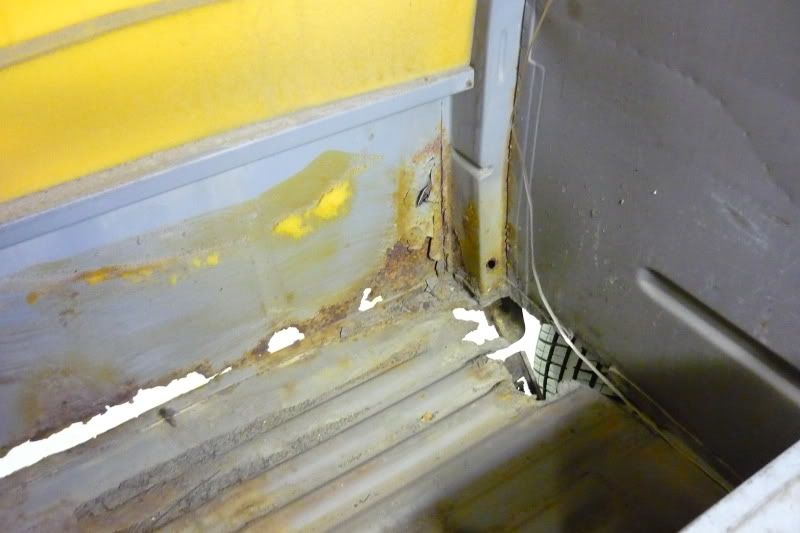

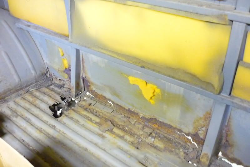

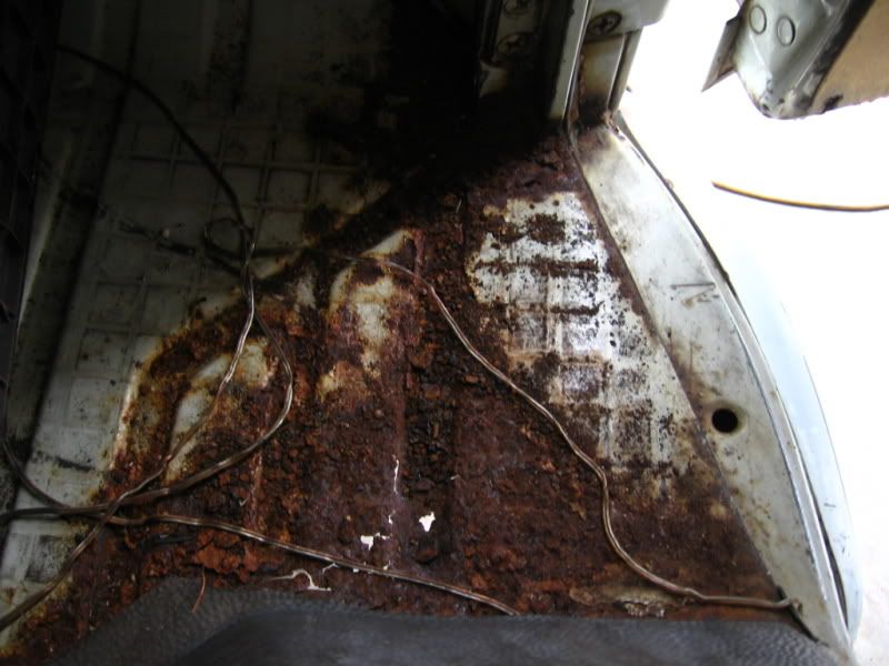

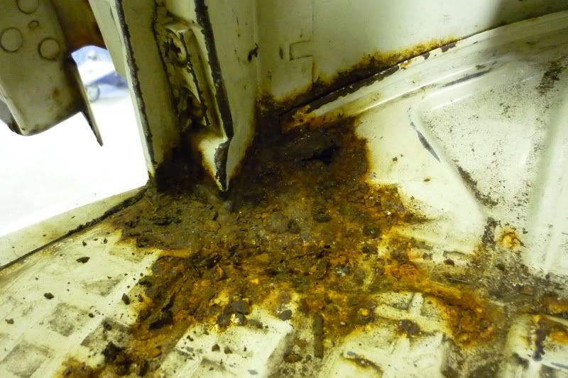

Took out all the camper interior to find out just how deep the rust was going.

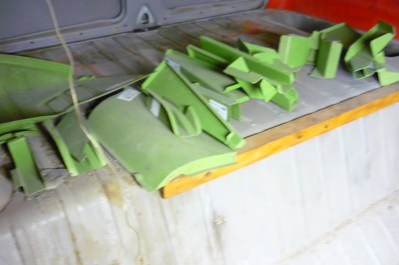

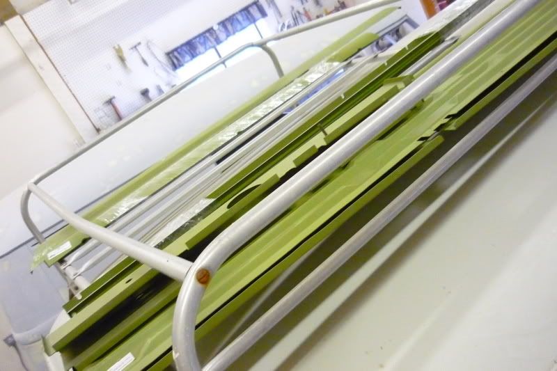

the parts list.....

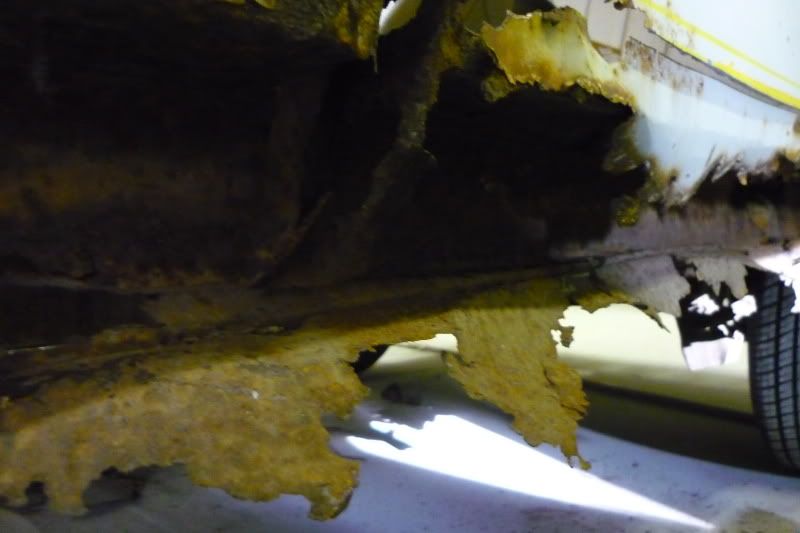

Started cutting out the cancer here.......

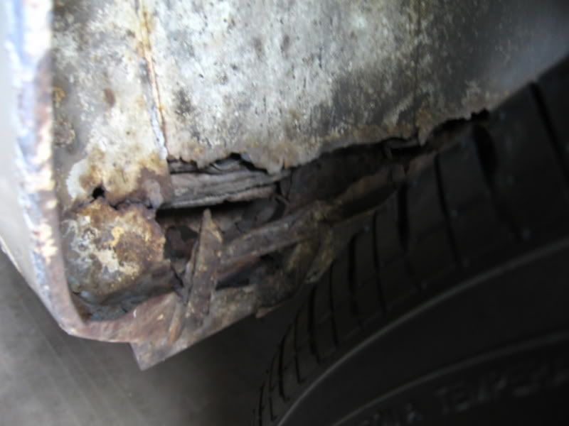

PostPosted: Sun Jul 12, 2009 3:31 pm    Post subject: Reply with quote

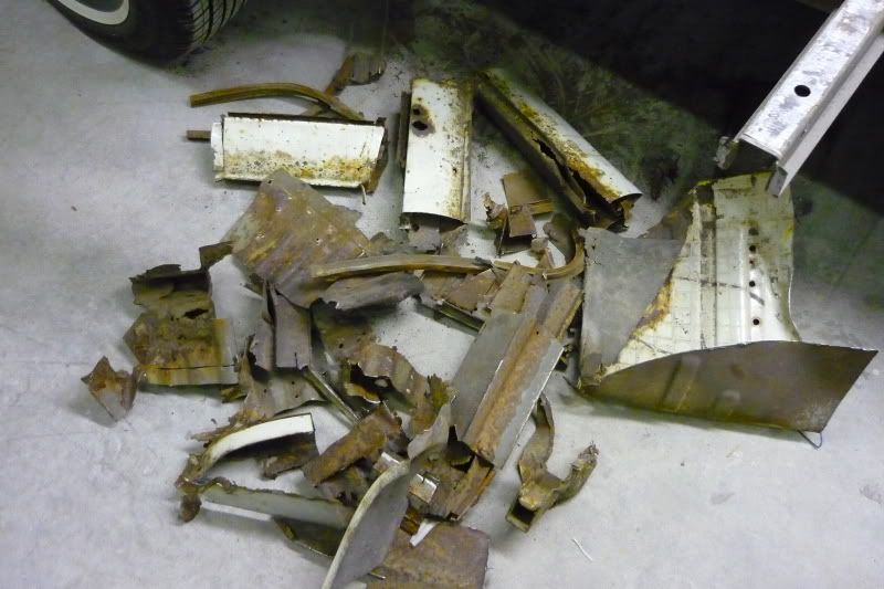

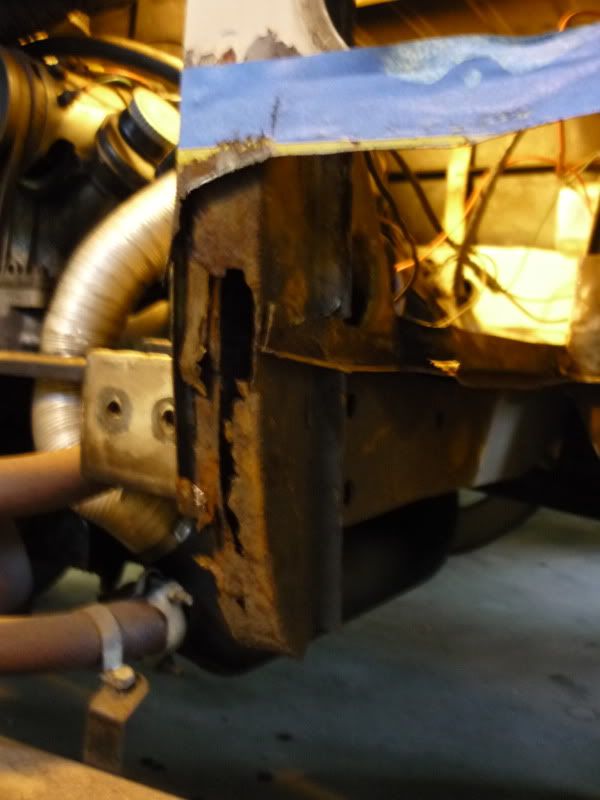

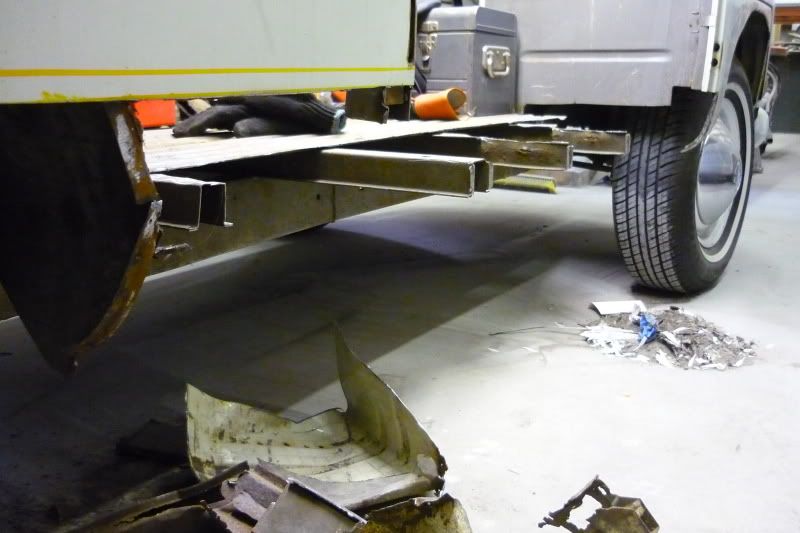

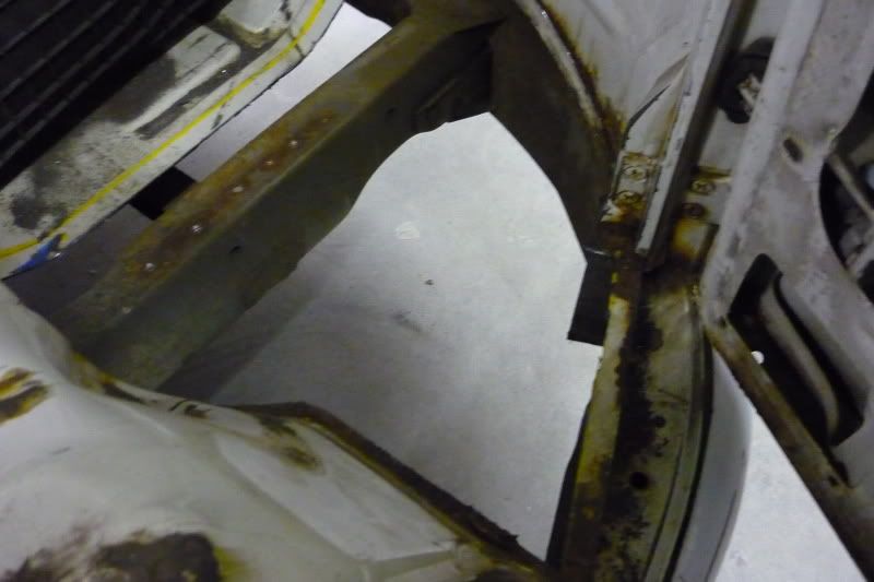

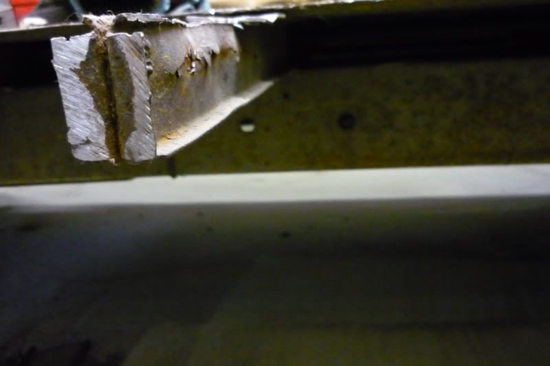

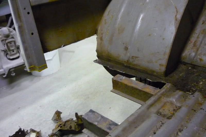

Found that the I beams were toast also.....

mmm...mmm...rust!

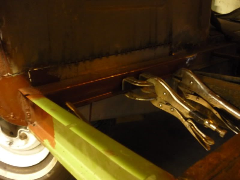

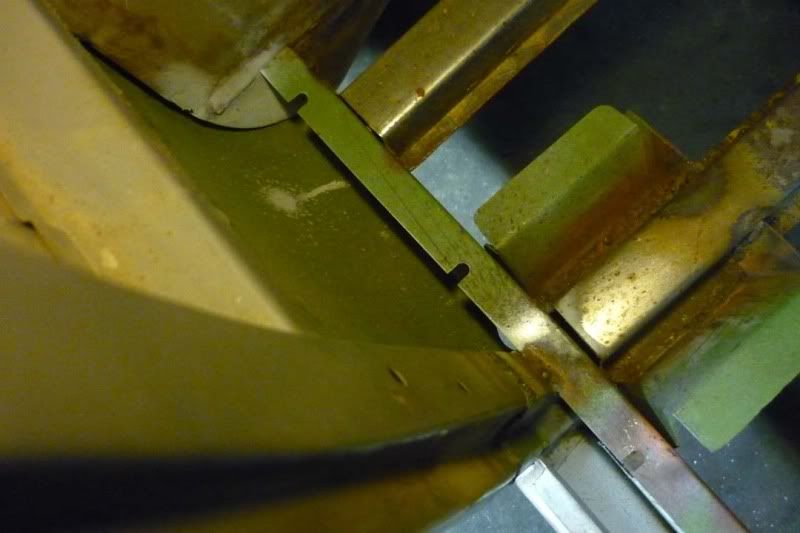

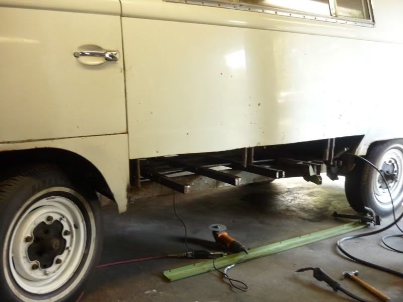

PostPosted: Sun Jul 12, 2009 4:12 pm    Post subject: Reply with quote

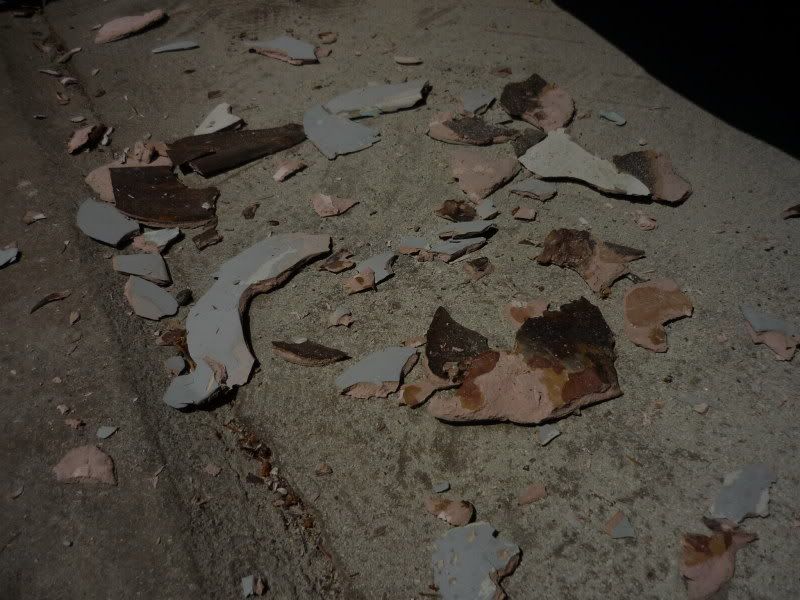

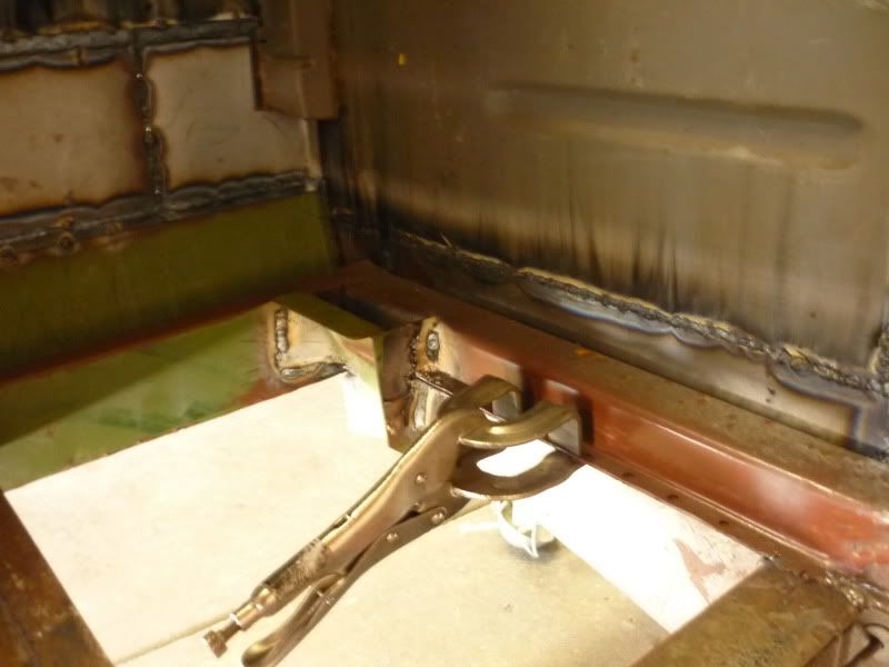

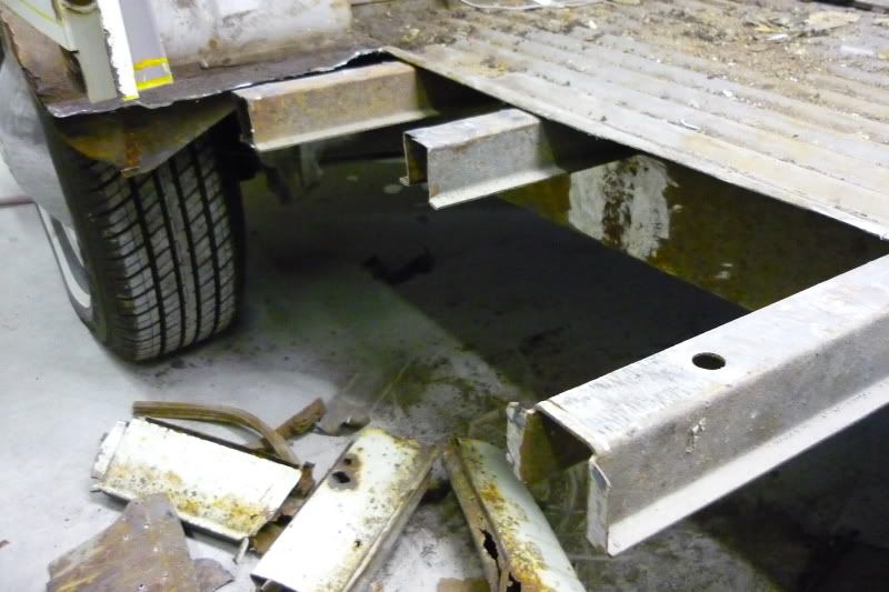

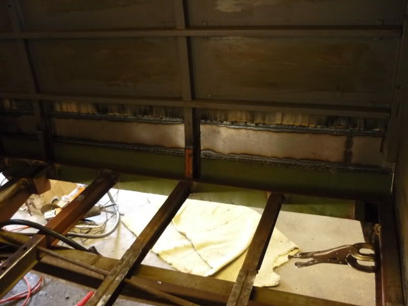

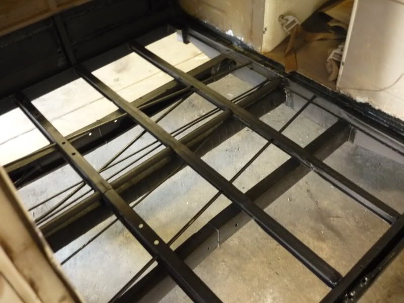

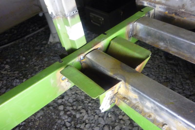

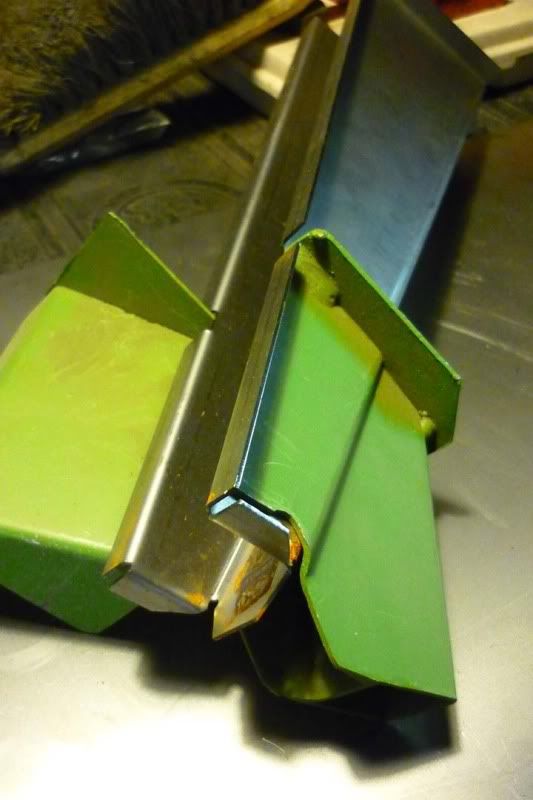

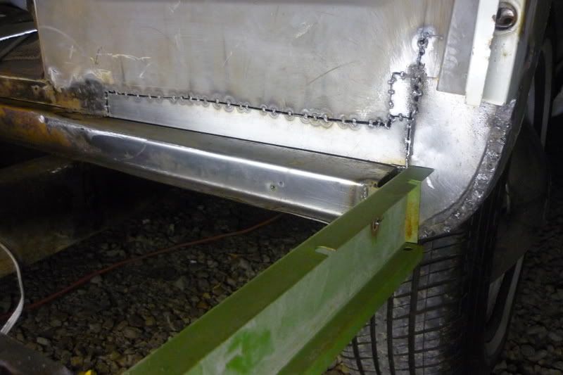

I tried to tackle the whole right side first. I made the I beams and crossmembers in a welding certification class I was taking at the time. They had some kick ass machinery there, so in my freetime I would take advantage of using them while I could for vw projects. After those were installed, I moved on to the bulkhead, rockers, and rear qtr area...

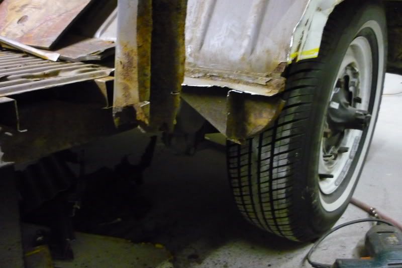

PostPosted: Mon Jul 13, 2009 10:49 am    Post subject: Reply with quote

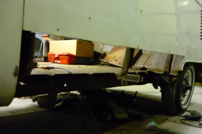

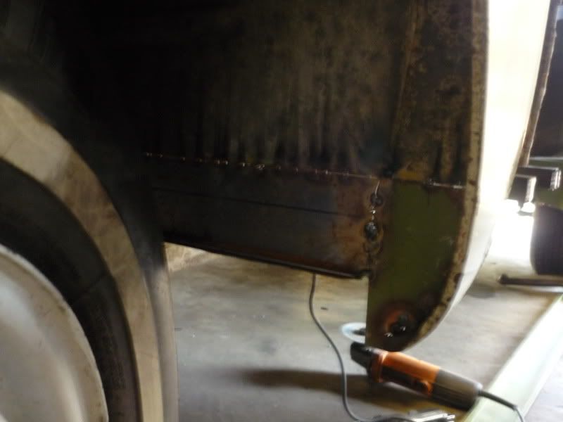

Started doing the drivers side here. Background wise. The bus had originally been found leaning in a ditch, and eventually rusted out everything on that side.

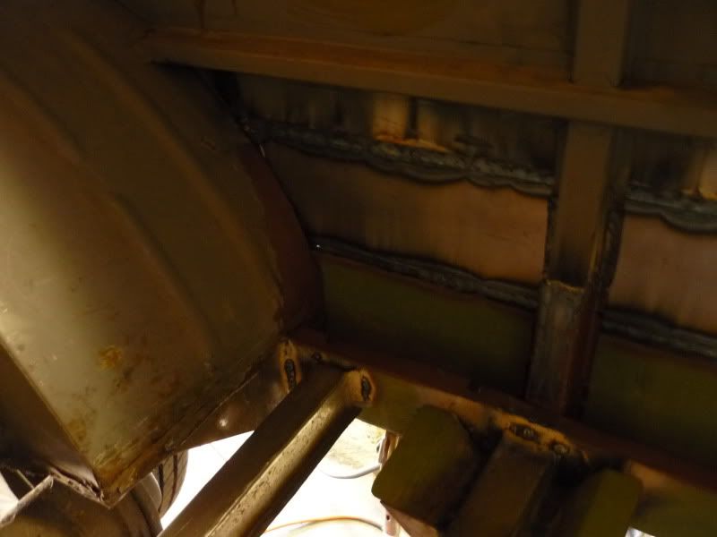

PostPosted: Mon Jul 13, 2009 11:01 am    Post subject: Reply with quote

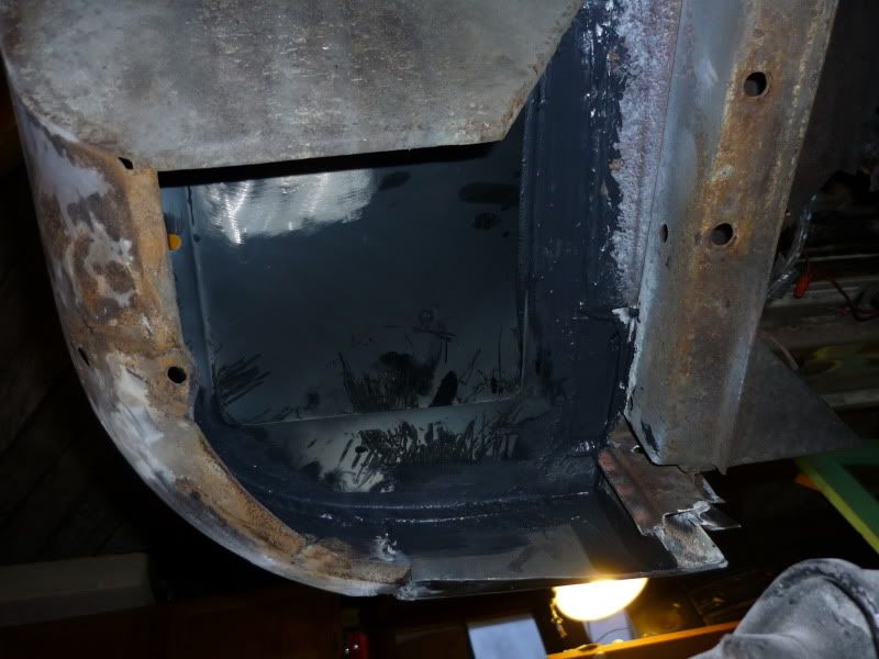

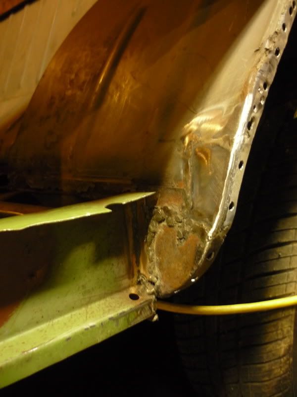

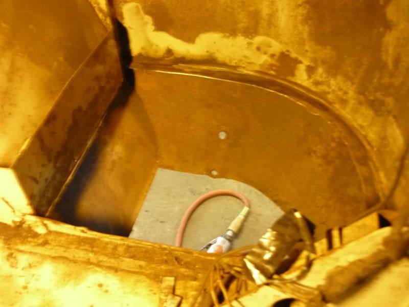

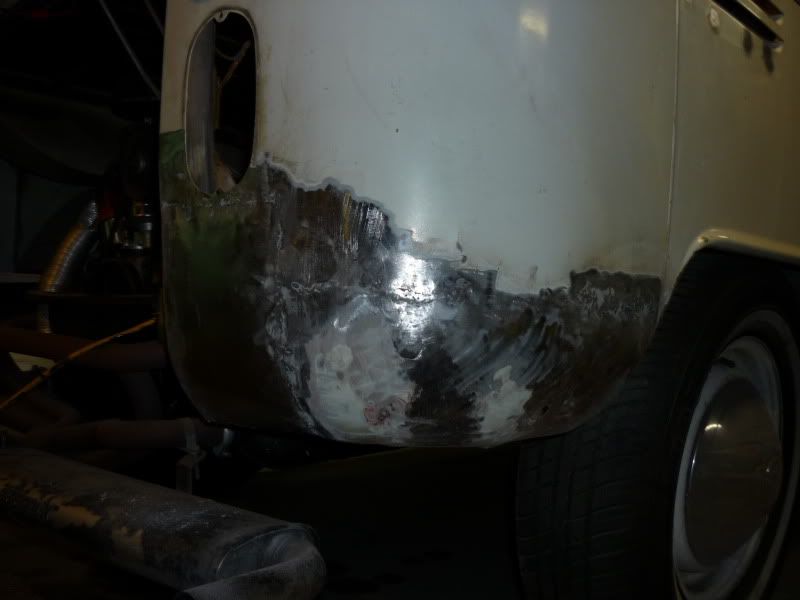

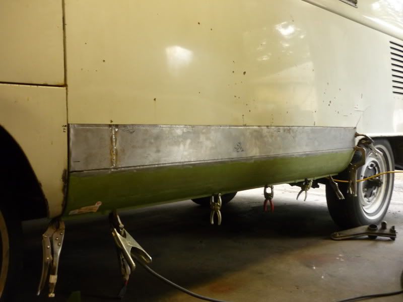

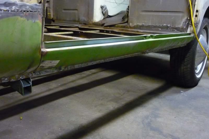

After finishing some welds, and getting everything ground down. I started mocking up the drivers rocker. The rust was beyond where the replacement panel laid.

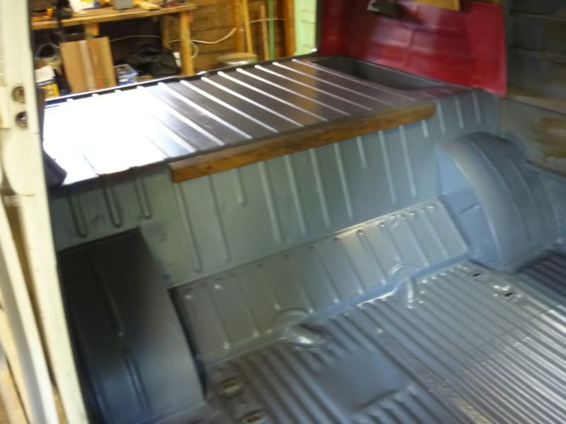

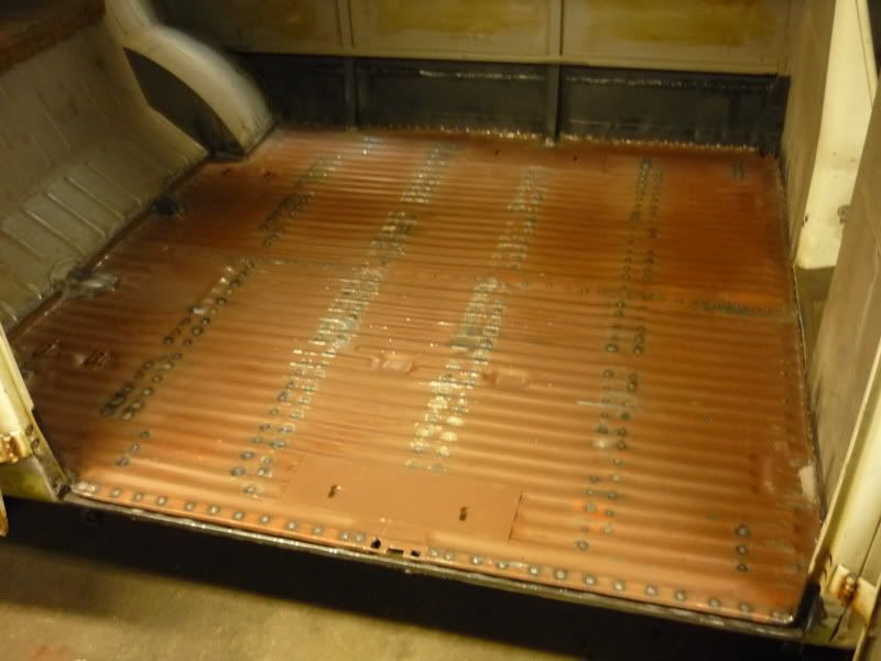

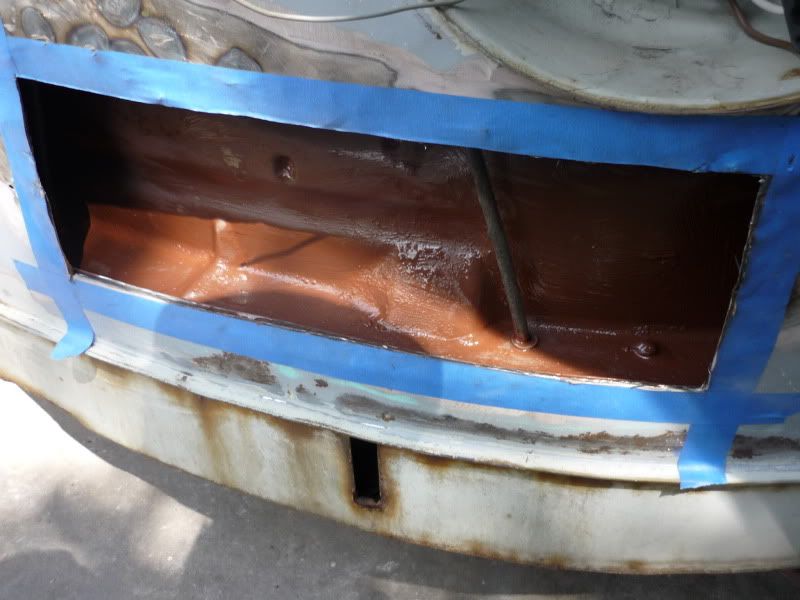

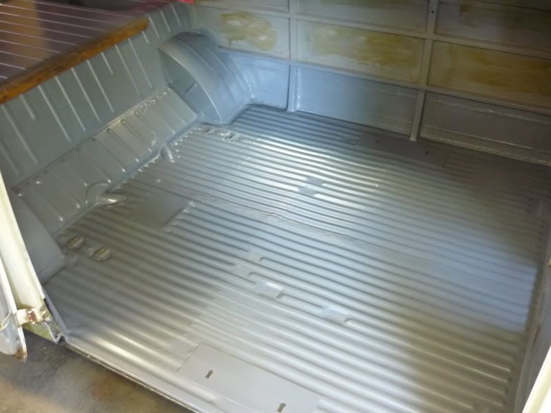

After replacing the center supports. I formed a new heater tube and coated everything with POR15 twice before putting in the floors.
Floors had gotten a couple of coats of rust proof paint also.

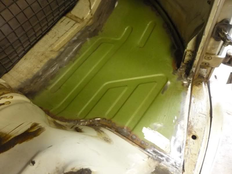

thanks for the props guys. This bus turned out to be more work than anticipated.....suprise suprise.
Ended up making the inner pillar piece, stripping the excess bondo off, and making a new patch panel....
The battery tray was toast also....

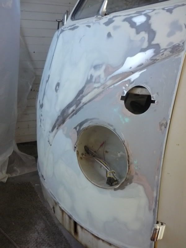

PostPosted: Mon Jul 13, 2009 10:03 pm    Post subject: Reply with quote

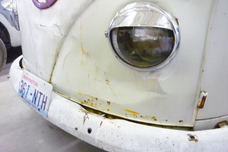

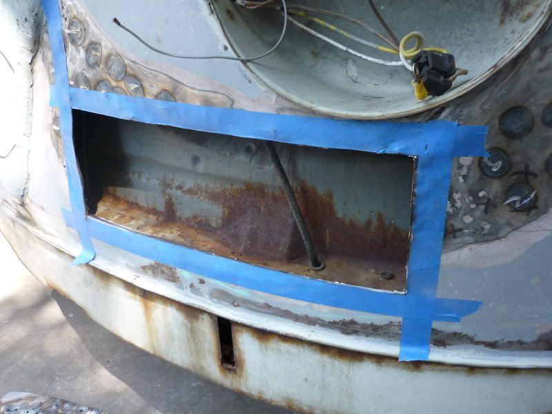

Next the front nose. Found that it had previously been hit right under the
drivers headlight and lower V below the emblem. Took off alot of filler here....
Tried getting that nasty section straight, but no luck, so it got cut.
After the welds were finished up. Almost the whole nose receive a skim coat of filler. Nothing compared to what was applied previously.

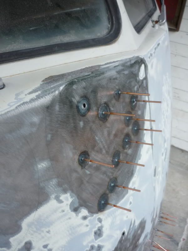

PostPosted: Wed Jul 15, 2009 12:08 am    Post subject: Reply with quote
^^^Thanks Atrain...

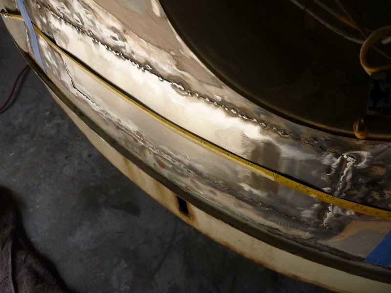

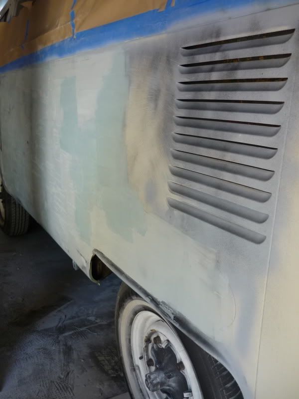

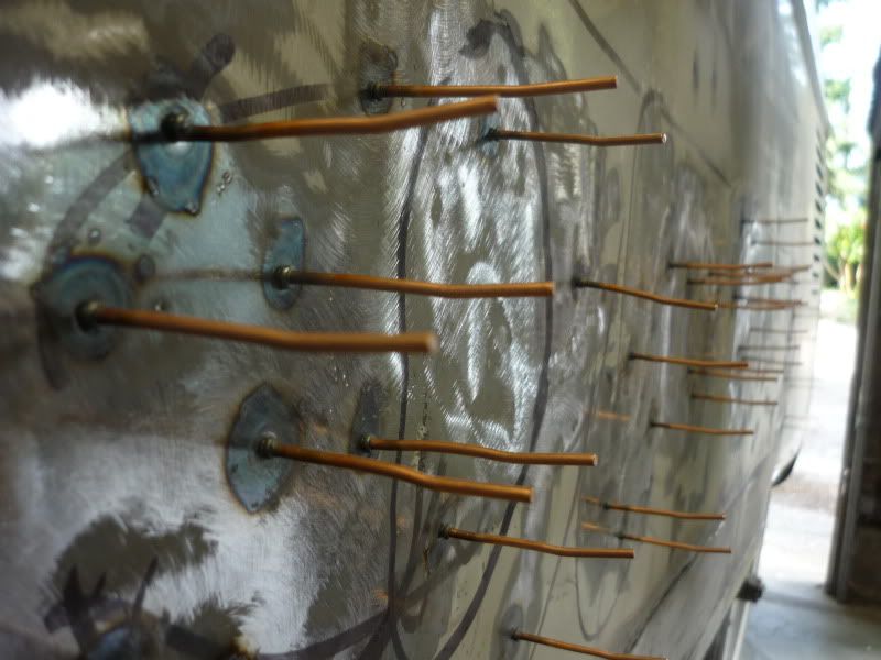

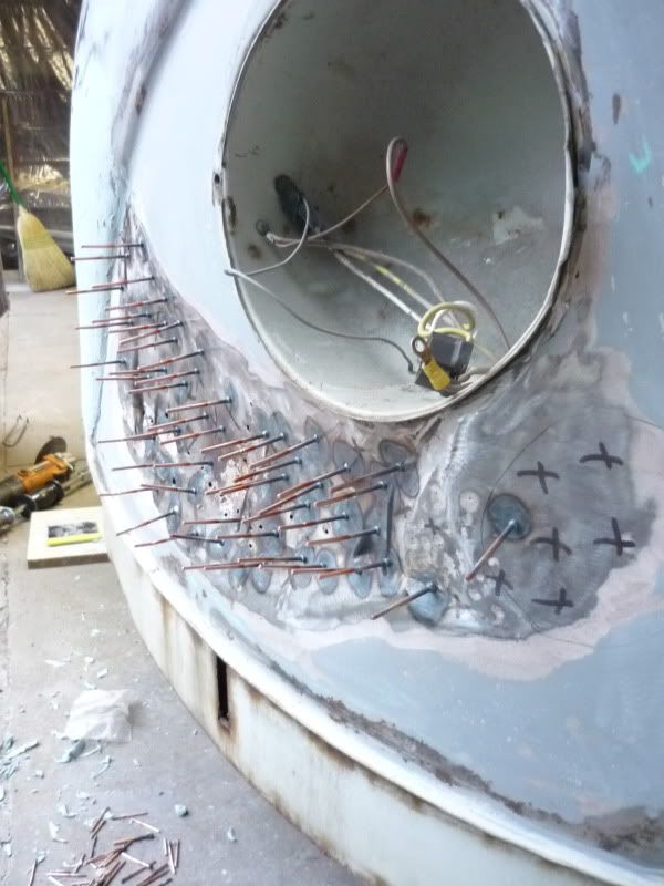

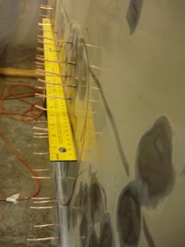

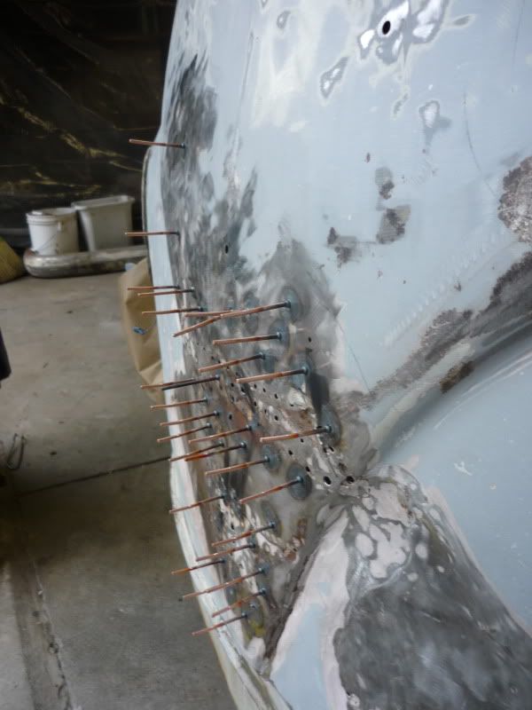

Here's when I started the drivers panel. Alot of waves initially, and a few more after welding that lower section in due to the heat. I used a yard stick to indicate just how much I needed to pull and push in different areas.
I didn't want to apply a ton of mud, so alot of slide hammer nails were used instead. Worked out pretty well in the end with only minimal filler.
