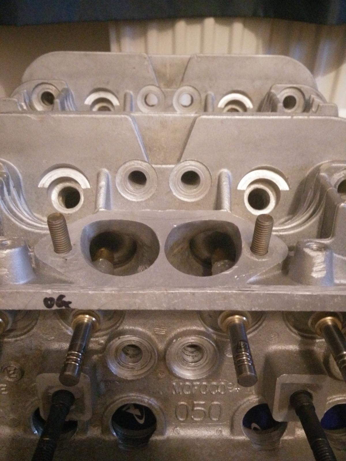

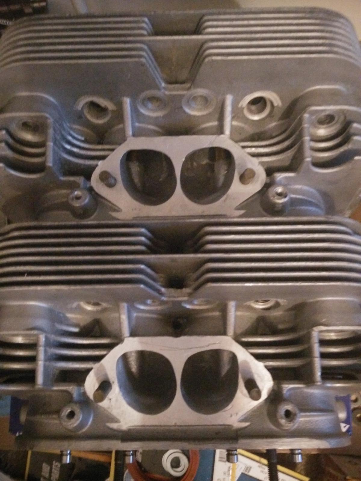

I wood doo some chamber work,, a lot of chamber work to those heads,(those chambers leave a lot to be disired) and bring deck to about .040 and around 10.~10.5 cr. and use a 30 mm oil pump as you are sending more oil to the heads with the hoover vac can mod, so you need more flow. make sure the geo is right ( probably have to cut the rocker blocks on the shafts to lower the rockers around .050") to get proper geo with lash caps. and make sure the springs can handle the real time lift, not the card math lift as most of those type rockers are more ratio than you think and there also a variable ratio. more lift more ratio, and rockers that are too high have even more ratio....and harder on guides too. good luck and have fun.

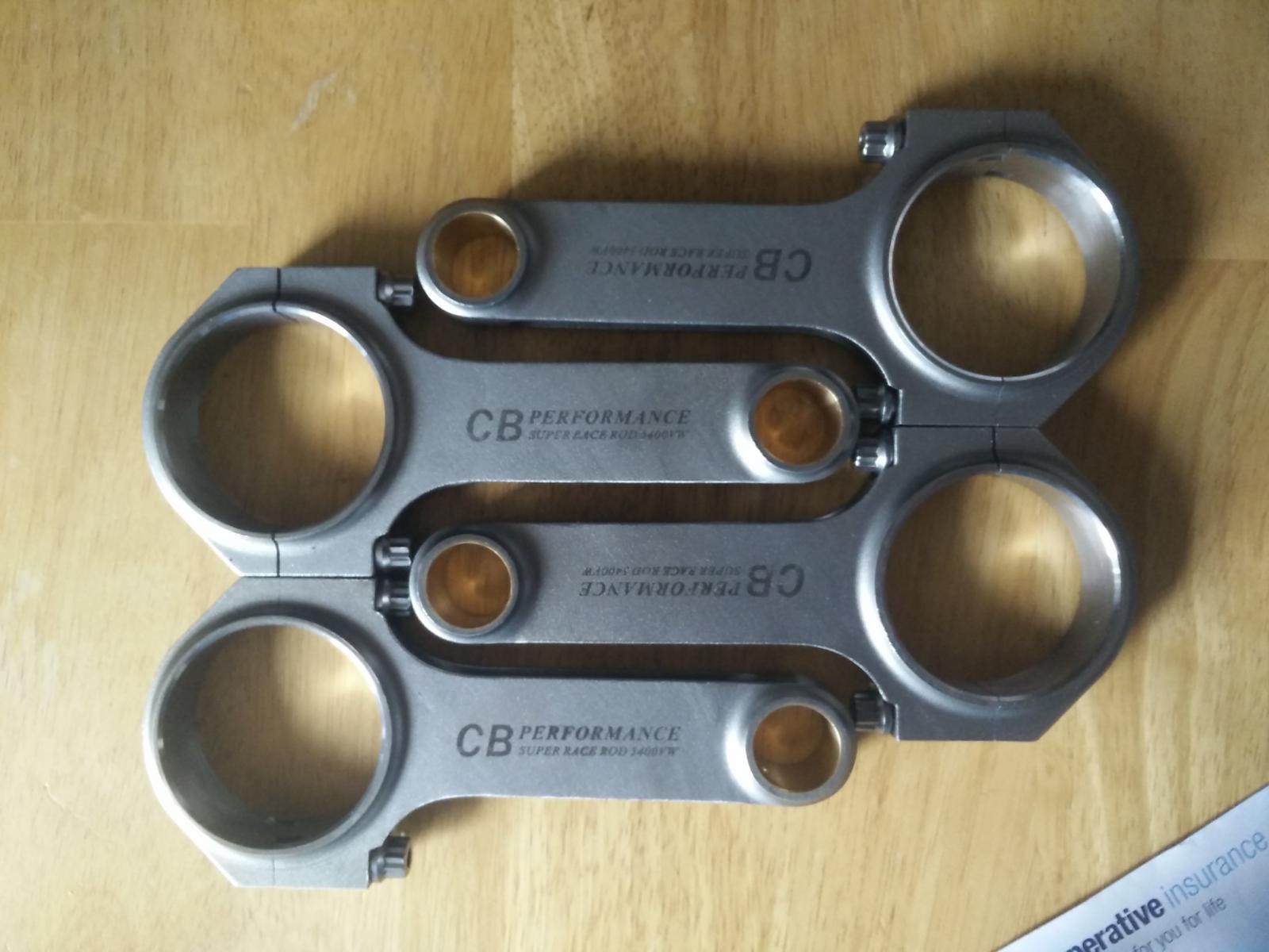

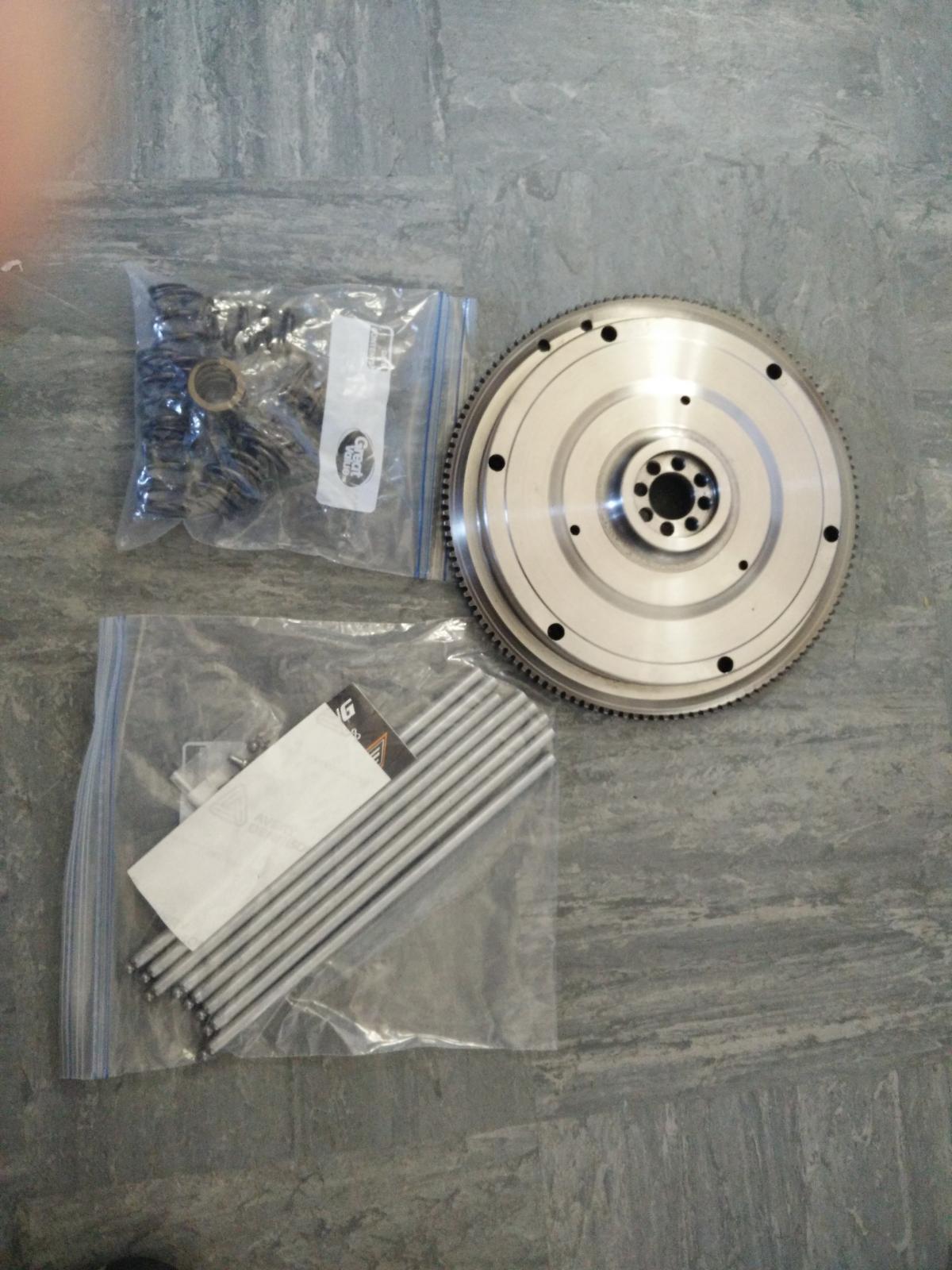

Right, pictures...
The first machinist I used did the full flowing... A little different but as far as I can tell should still work well.

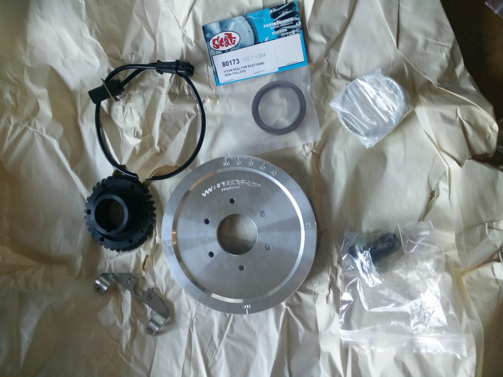

Crank, adjustable straight cut gears, flywheel, Smith bros pushrods and single springs.
VW Speedshop crank trigger kit
Heads, stripped and one vapour blasted

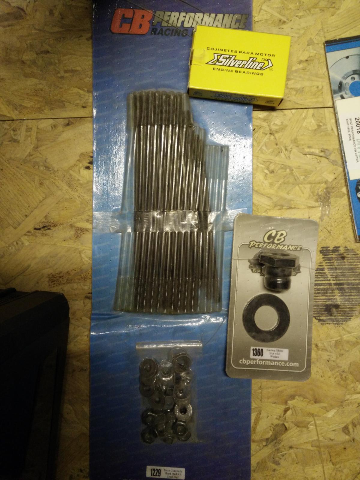

More of the heads

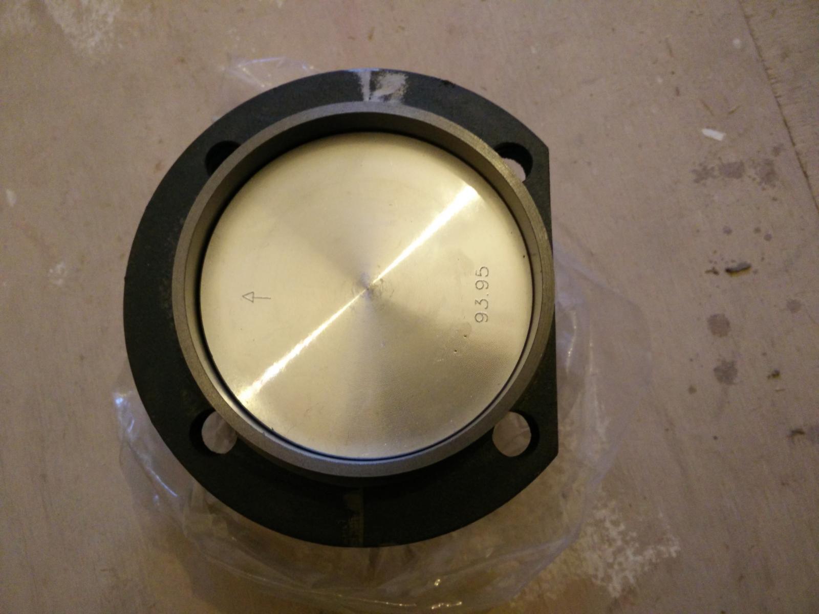

AA Slippers

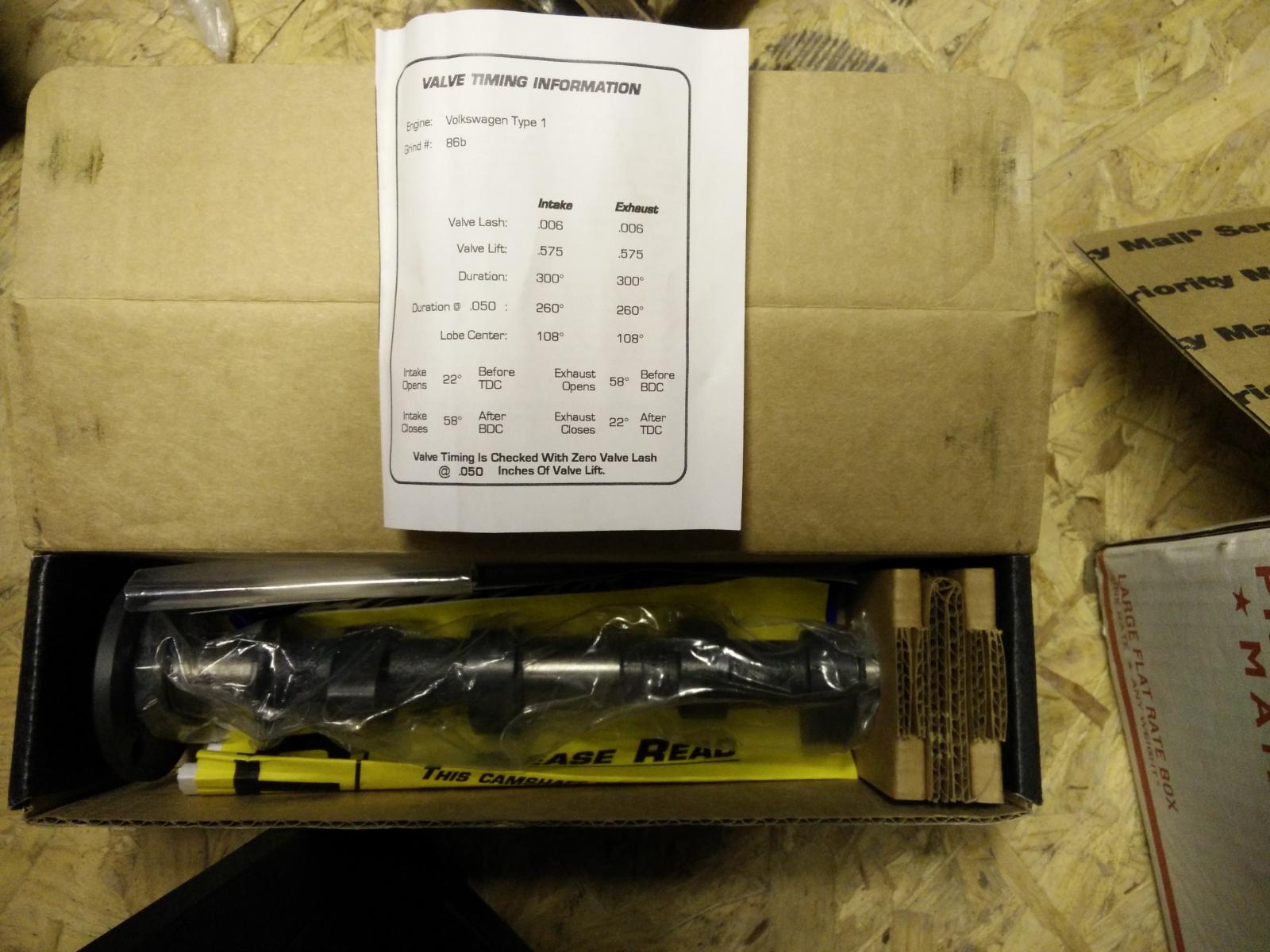

Web cam 86b. EP12 billet so not pre clearanced

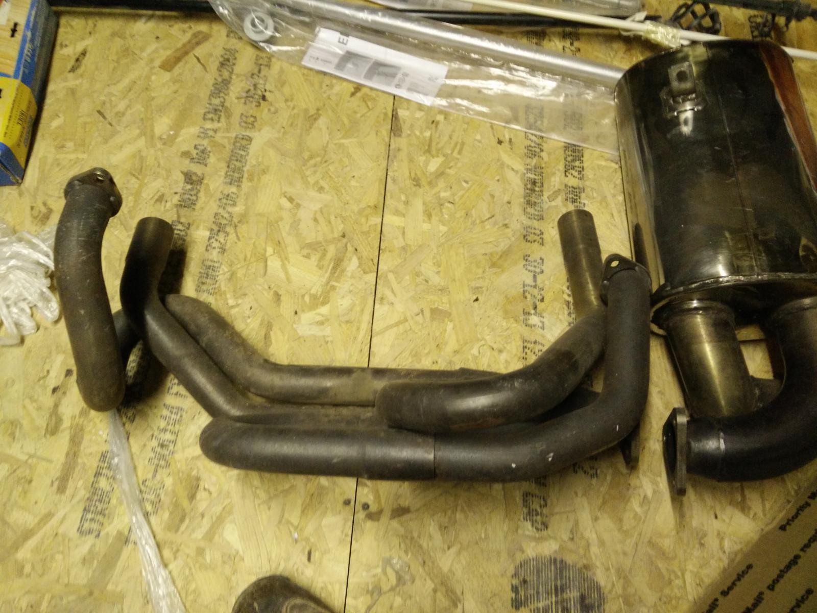

1 5/8"
Headstuds... Will stick to 8mm OG headstuds I think
Rods, 5.4", VW journal
andy198712
Joined: December 05, 2010
Posts: 1209
Location: Cornwall - UK
andy198712 is offline
PostPosted: Sun Jan 15, 2017 3:44 pm    Post subject: Re: 2276/86b beetle daily Reply with quote
Nice parts!
When you cut the push rods, measure the internal step (you'll see what I mean when you look) make sure that's deep enough for the tip other wise you won't seat the tip and can't get it out..... learnt that one
So drill the step deeper if needed (may not need to)

I think I'll take the pushrods up to Danny at Reichspeed for cutting, its not a job I enjoy in the slightest and he only charges £30 for the lot... Point noted though, I remember you saying about the one you knackered Very Happy
Next time you need any machine work check him out... First guy had his issues, Danny's was perfect.
