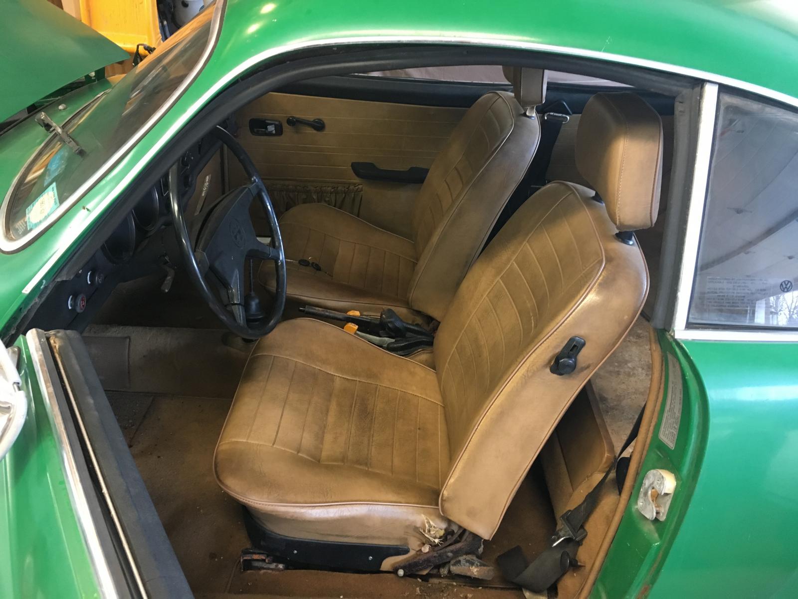

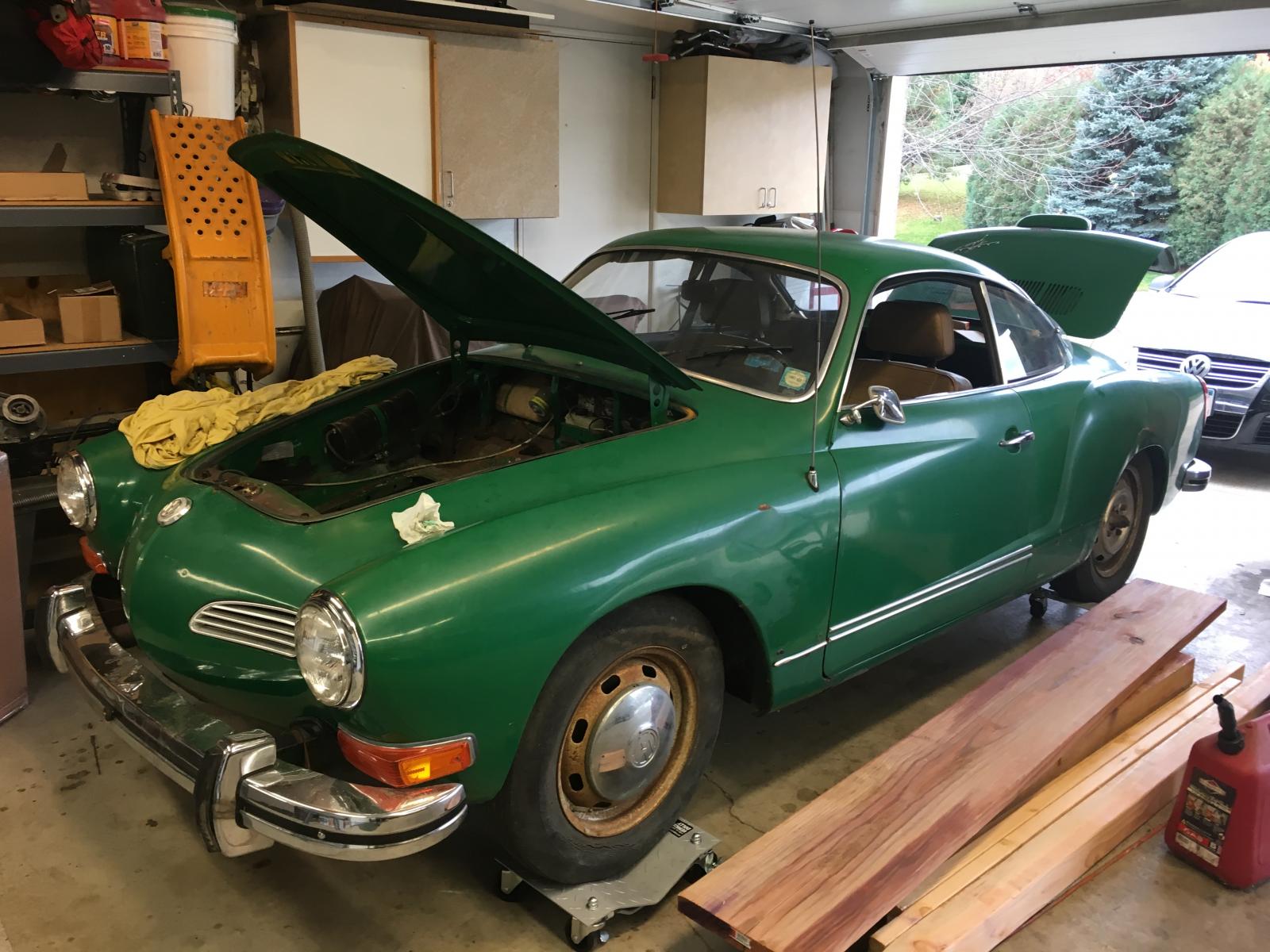

After 35 plus years away from Air Cooled, i Found nice little '73 Ghia Coupe.
Yup, an autostick

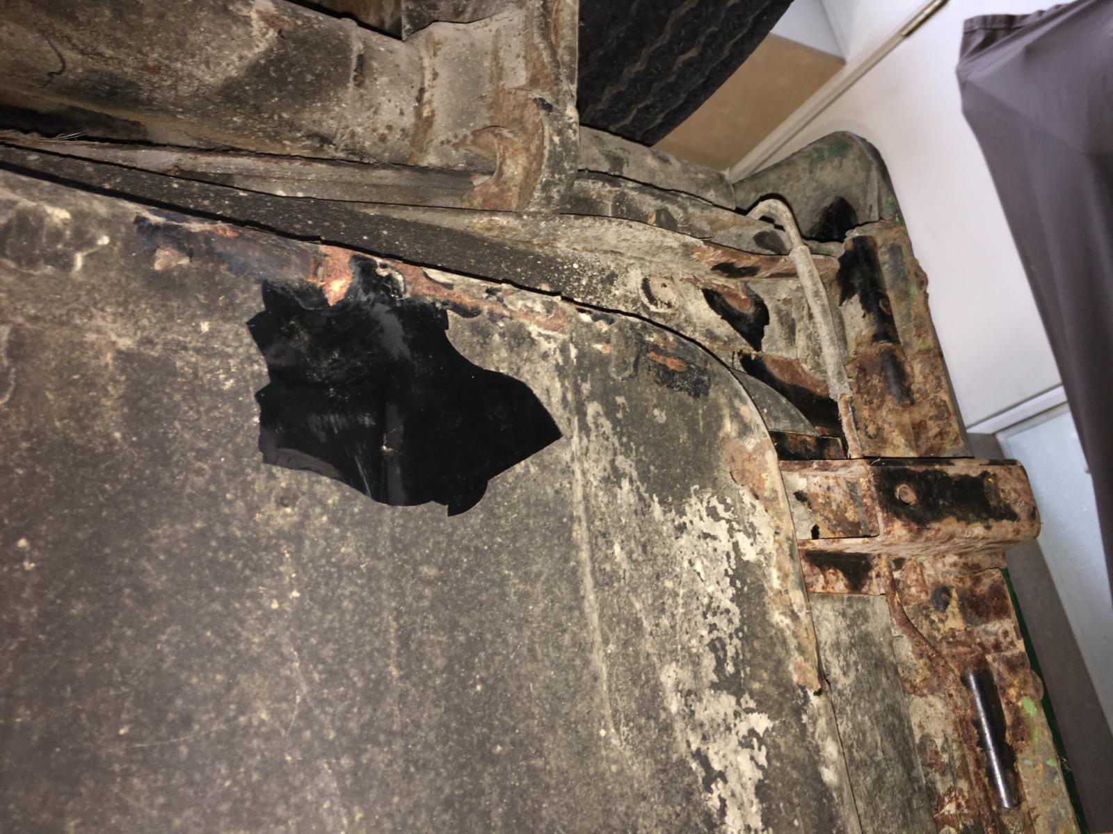

The biggest issue I found (at the time) was this.
The story is, that it was purchased in Luxembourg, French Tax sticker
New York Inspection Sticker
Then was shipped to the Minneapolis area and sat in a warehouse for 30 years.

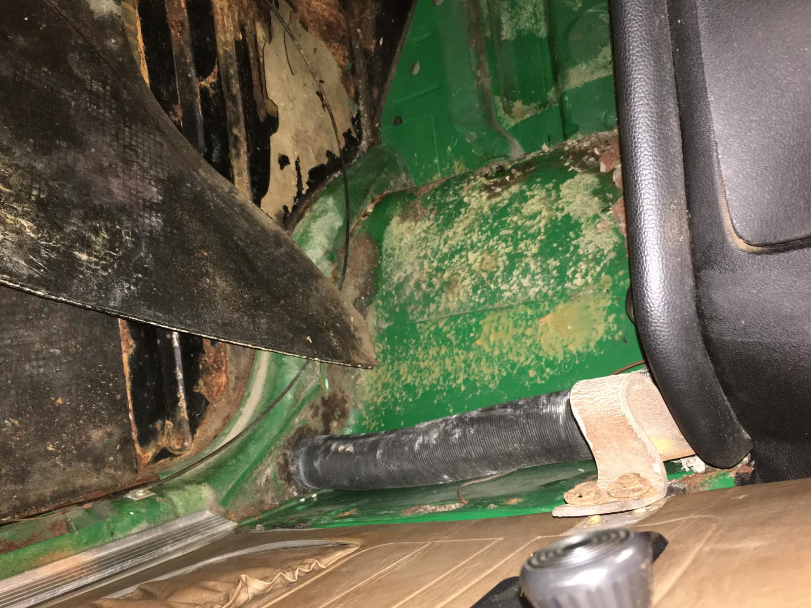

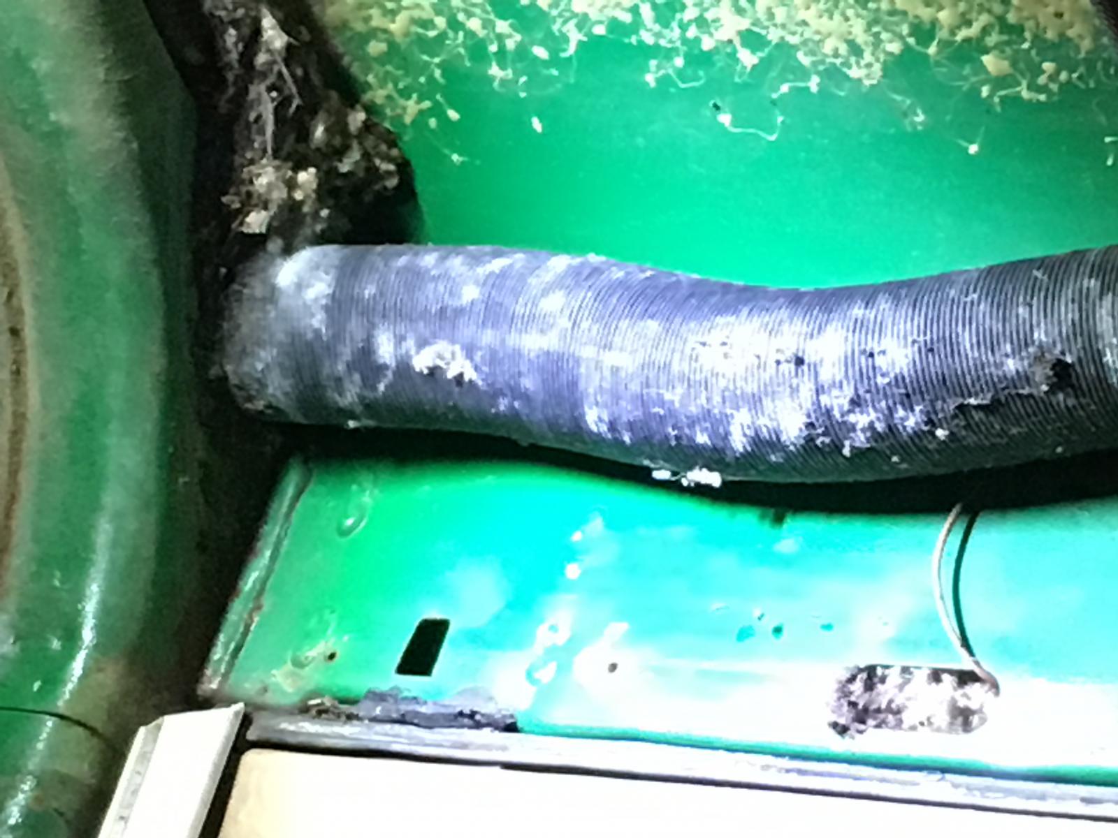

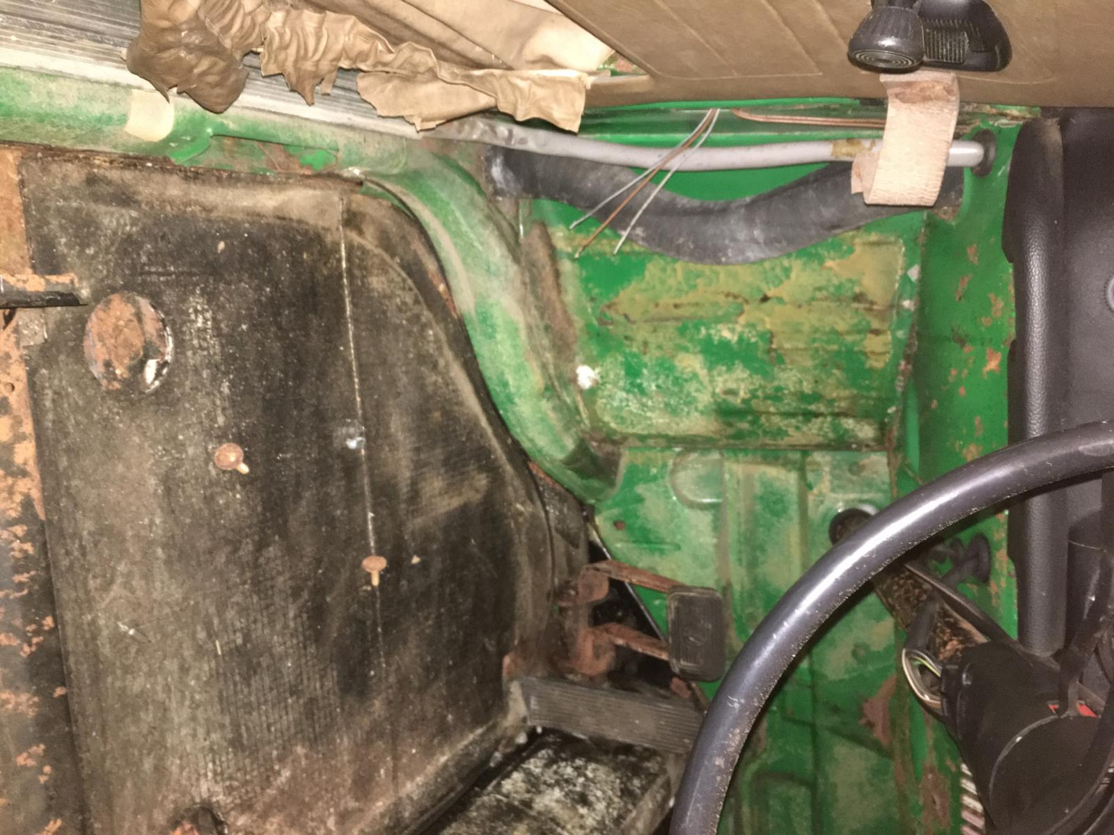

I got it started last weekend to see if the AutoStick still worked. I wanted to know if it did, or if I needed to convert it to an manual.
The Autostick did still work!
The person I bought it from had about 4 boxes of dryer sheets in there "to keep the mice out".
Too late for that!
In the headliner.
And behind the defroster ducts.
And passenger footwell...(I used to keep an bottle of Rum and Trojans there in my old 72 Squareback...)
Did I mention I HATE mice??

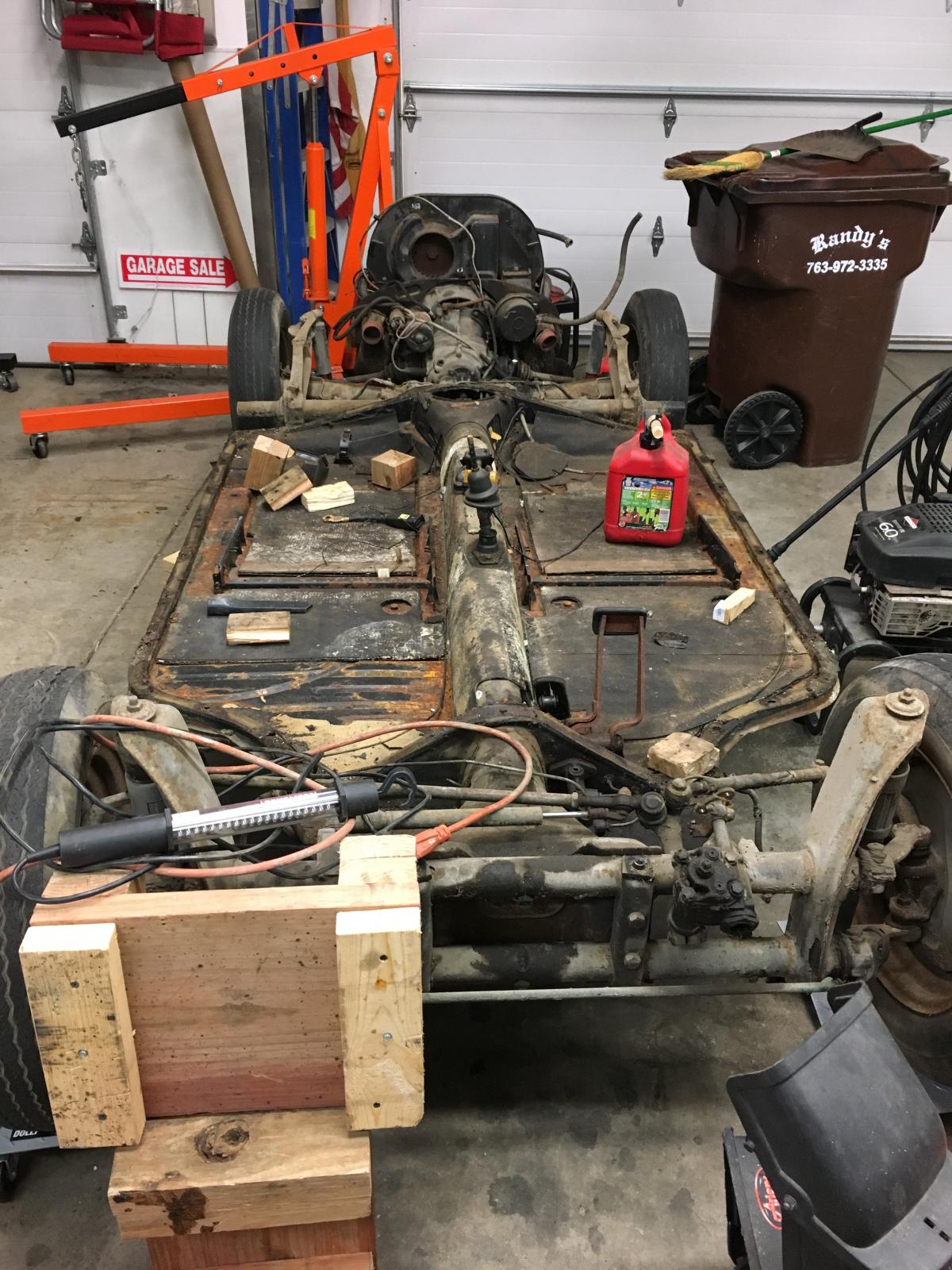

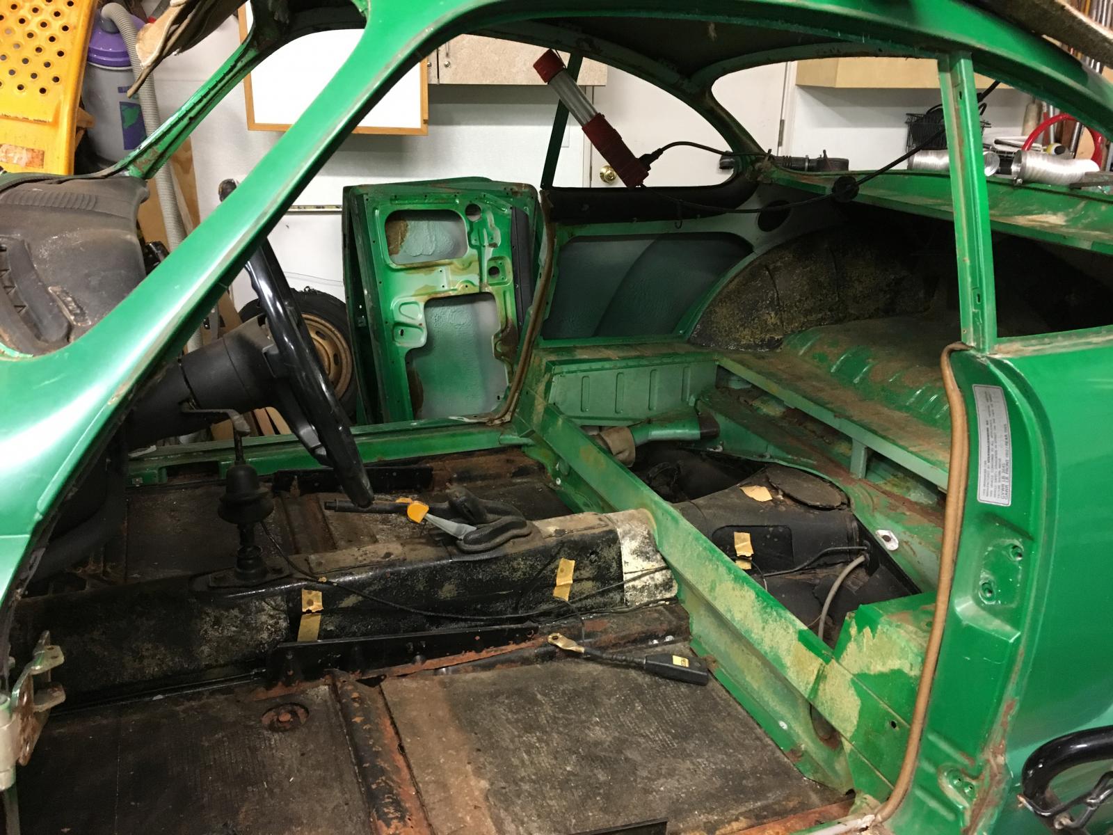

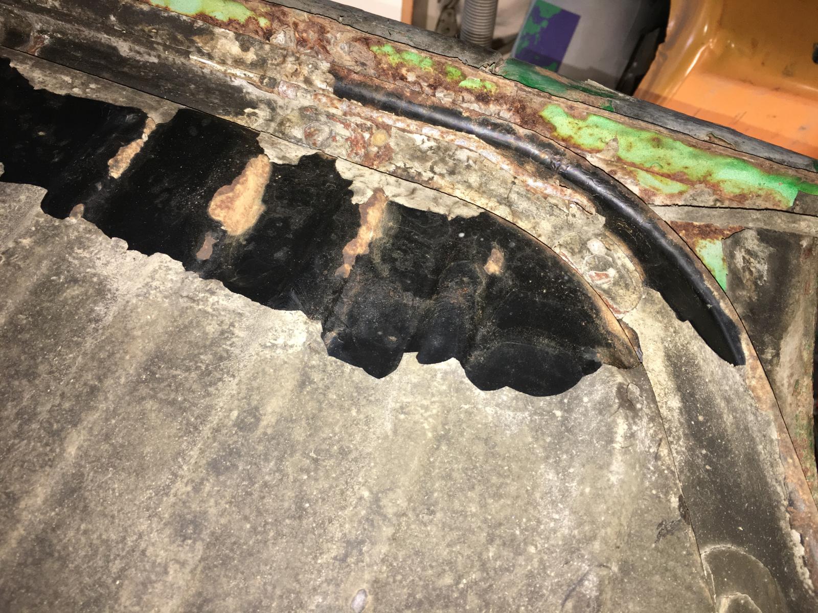

So the good news is that the pan is rock solid!
Apparently it was undercoated which is now peeling off, it looks great underneath it!
I plan to pull the body off and get it shotblasted. There is some body work on the drivers side and nose.
I'll have to see how bad it is.

PostPosted: Thu Nov 03, 2016 7:06 pm    Post subject: Re: 1973 Coupe Reply with quote
I want to salvage as much of the original equipment as possible.
Any hints on getting the "tar boards" off the pan so I can re-use them?
The carpet is actually in very good shape, just dirty and stinky.
I plan on using a commercial extractor to clean them.
sputnick60
Joined: July 22, 2007
Posts: 4141
Location: In Molinya Orbit
sputnick60 is offline
PostPosted: Thu Nov 03, 2016 11:38 pm    Post subject: Re: 1973 Coupe Reply with quote
Yes, Hot air gun or hair dryer to heat them up evenly till they are sticky and then peel them off the floor pan starting in one corner and lifting diagonally.
You can use roofing pitch ( black tar) to rejuvenate then. Lay them in a tray and heat them up till they are soft then pour the roofing pitch on them so it soaks up. After cooling down they'll be like new. It is a messy job though.
I did the small sections of tarboard at the rear of the chassis in this manner and it came out like this.
I did something else for the larger pieces underfoot because I wanted something that would lift out. Mine's a cabriolet and more prone to rain getting in.

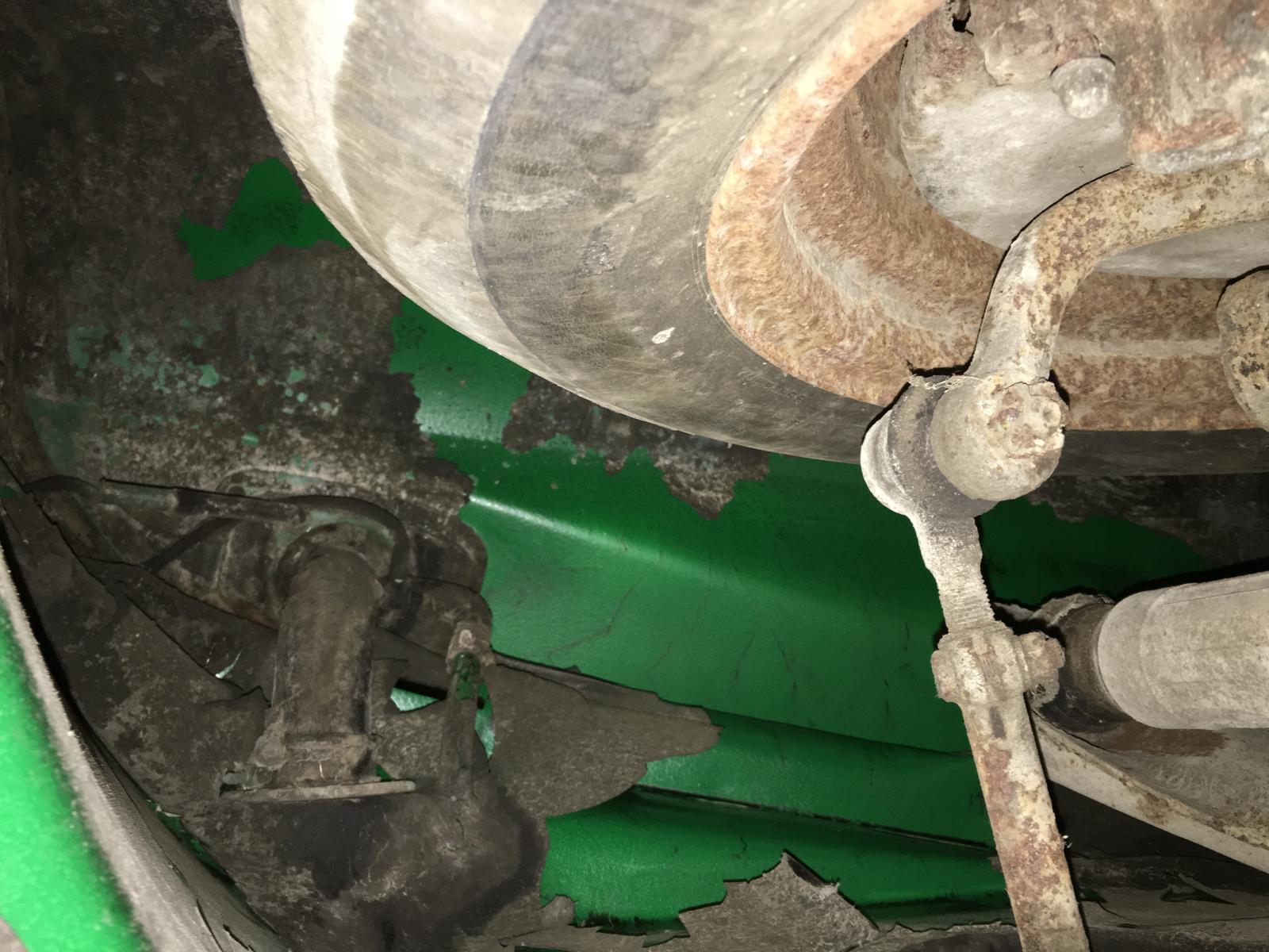

PostPosted: Fri Nov 04, 2016 10:52 am    Post subject: Re: 1973 Coupe Reply with quote

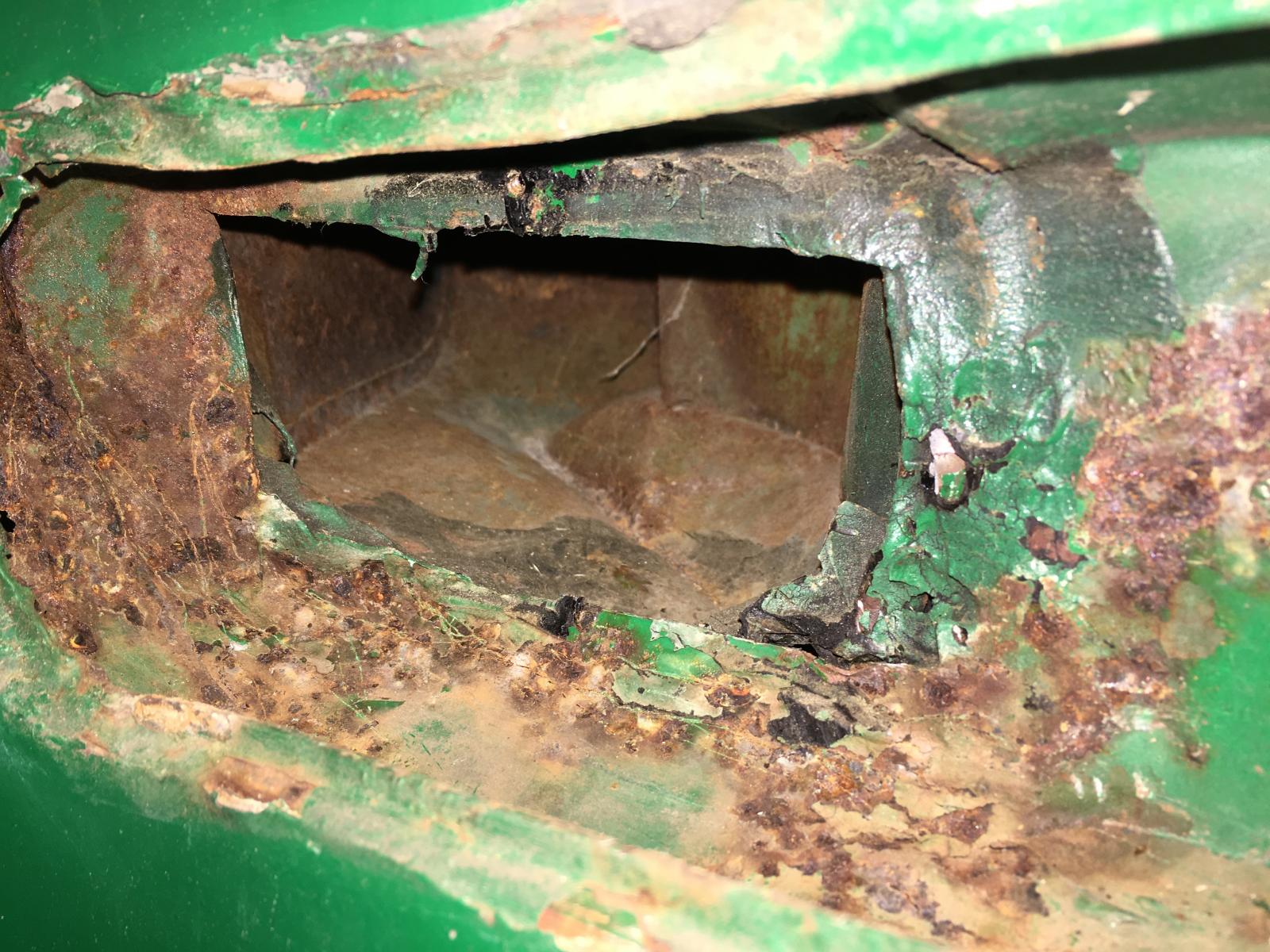

Car looks great, i cant believe how much it rusted inside the trunk area. Odd spot. Why? The rest looks so good, guess that undercoating protected the other parts very well. Enjoy.
GhiaBuild
1967 DC build
Redlabel6
Joined: October 17, 2016
Posts: 394
Location: Minnesota
Redlabel6 is offline
PostPosted: Fri Nov 04, 2016 1:54 pm    Post subject: Re: 1973 Coupe Reply with quote
Given the shape of the rest of it, it's a very odd spot. I thought brake fluid at first, but that would only eat the paint.
No I think that must have been the mouse mothership and the urine ate it out... Confused
Thankfully a member of the local VW club has a few '70s Ghias that are being scrapped. he is checking to see what kind of shape his are in.

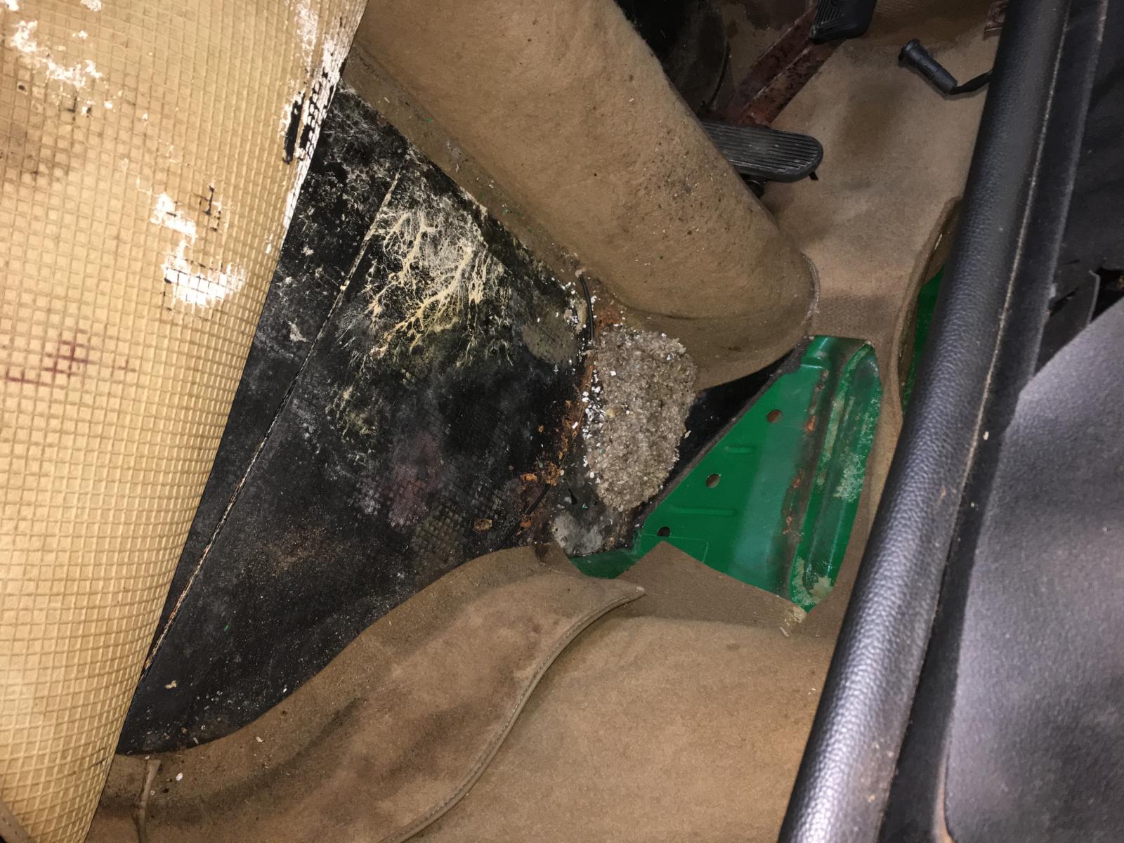

PostPosted: Tue Nov 08, 2016 5:27 pm    Post subject: Re: 1973 Coupe Reply with quote

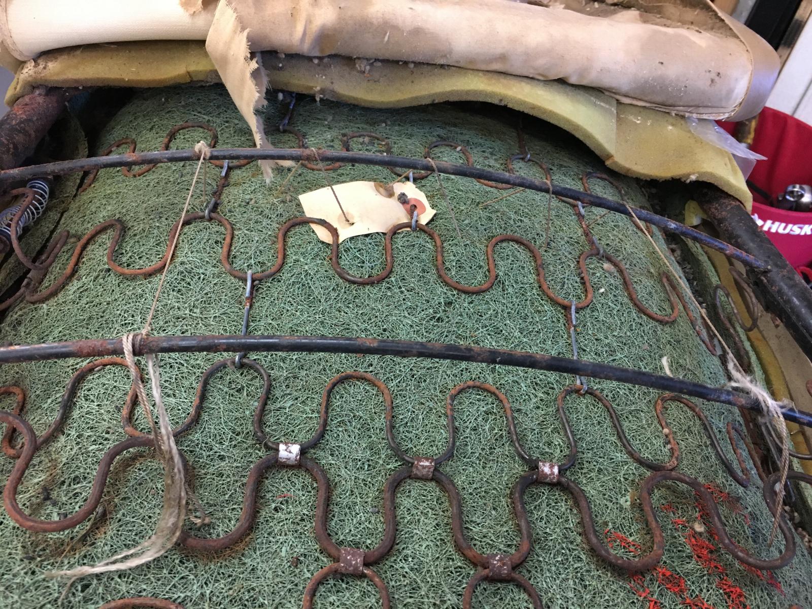

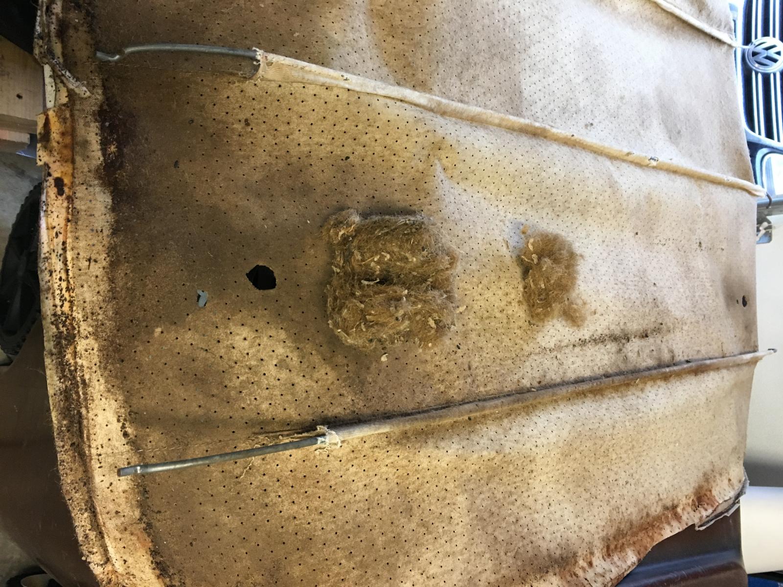

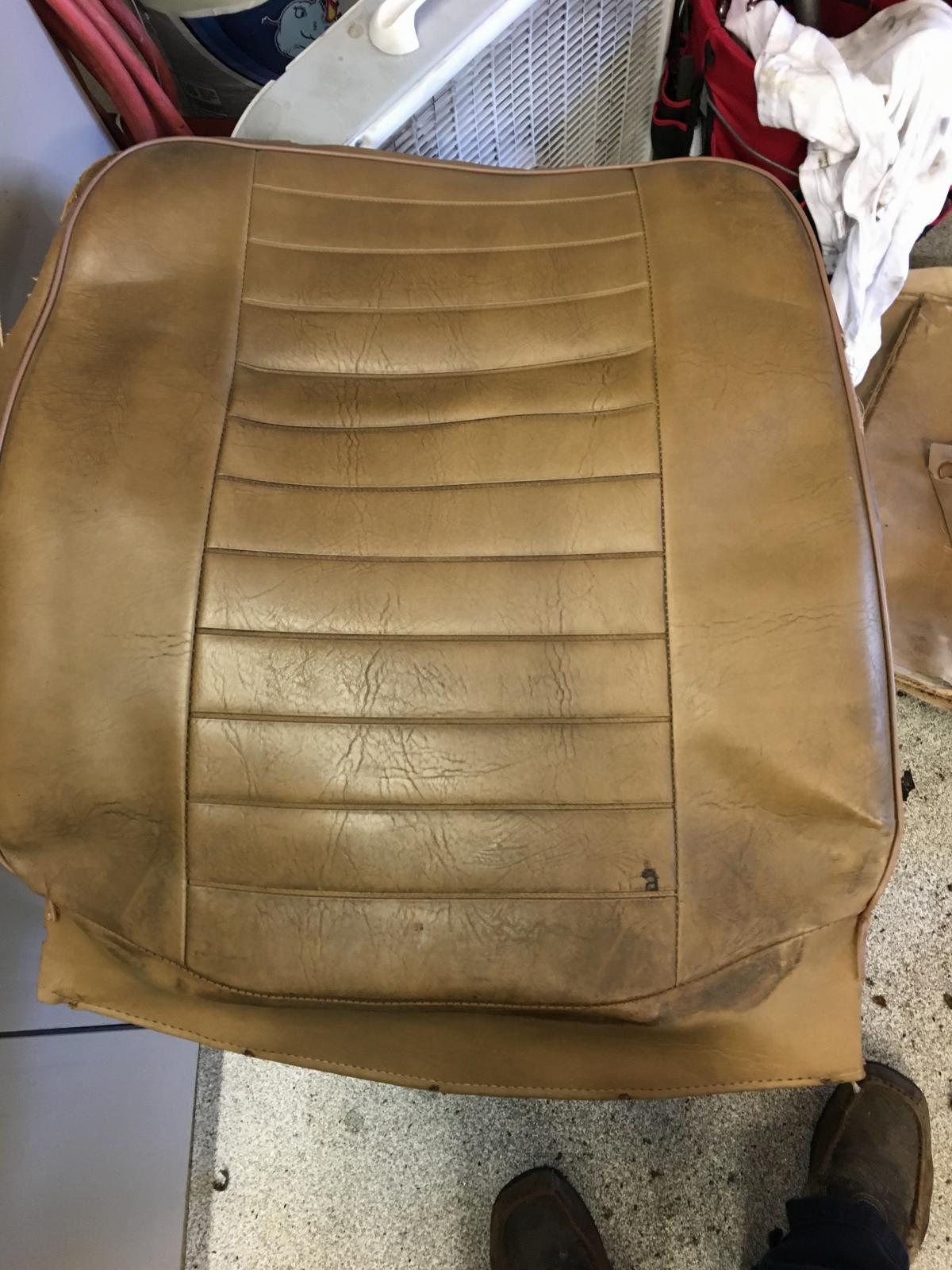

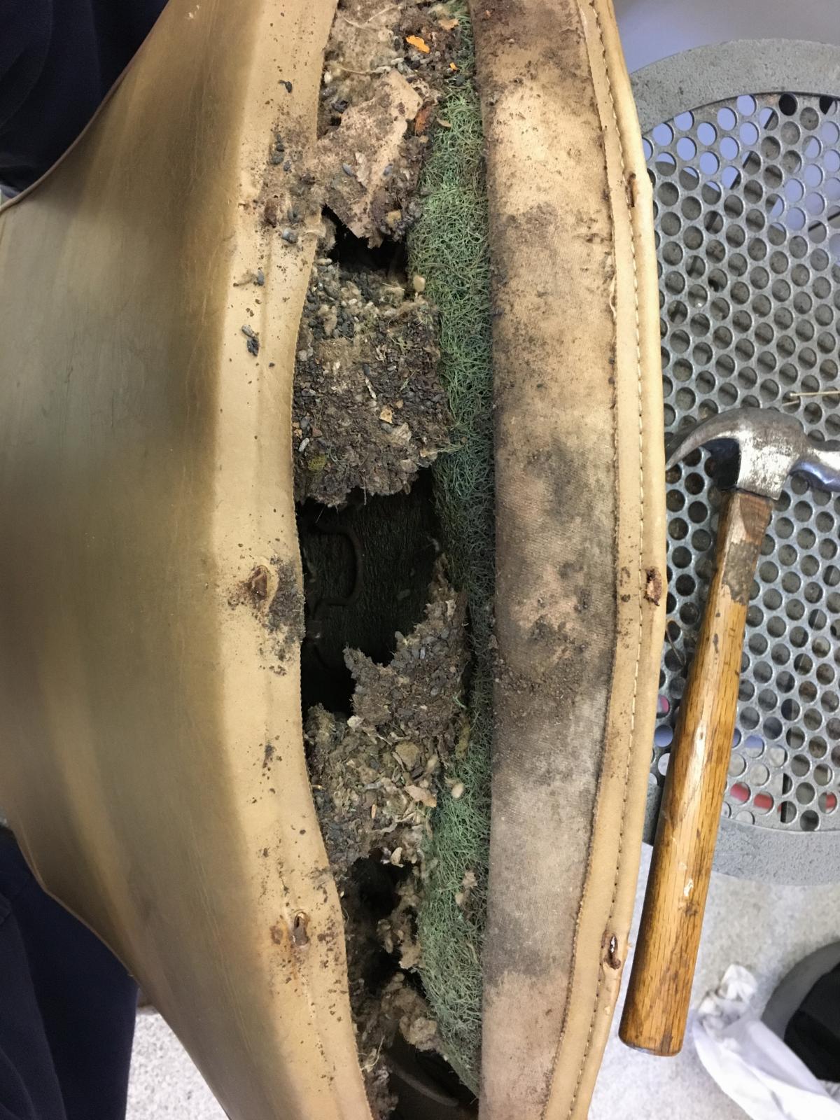

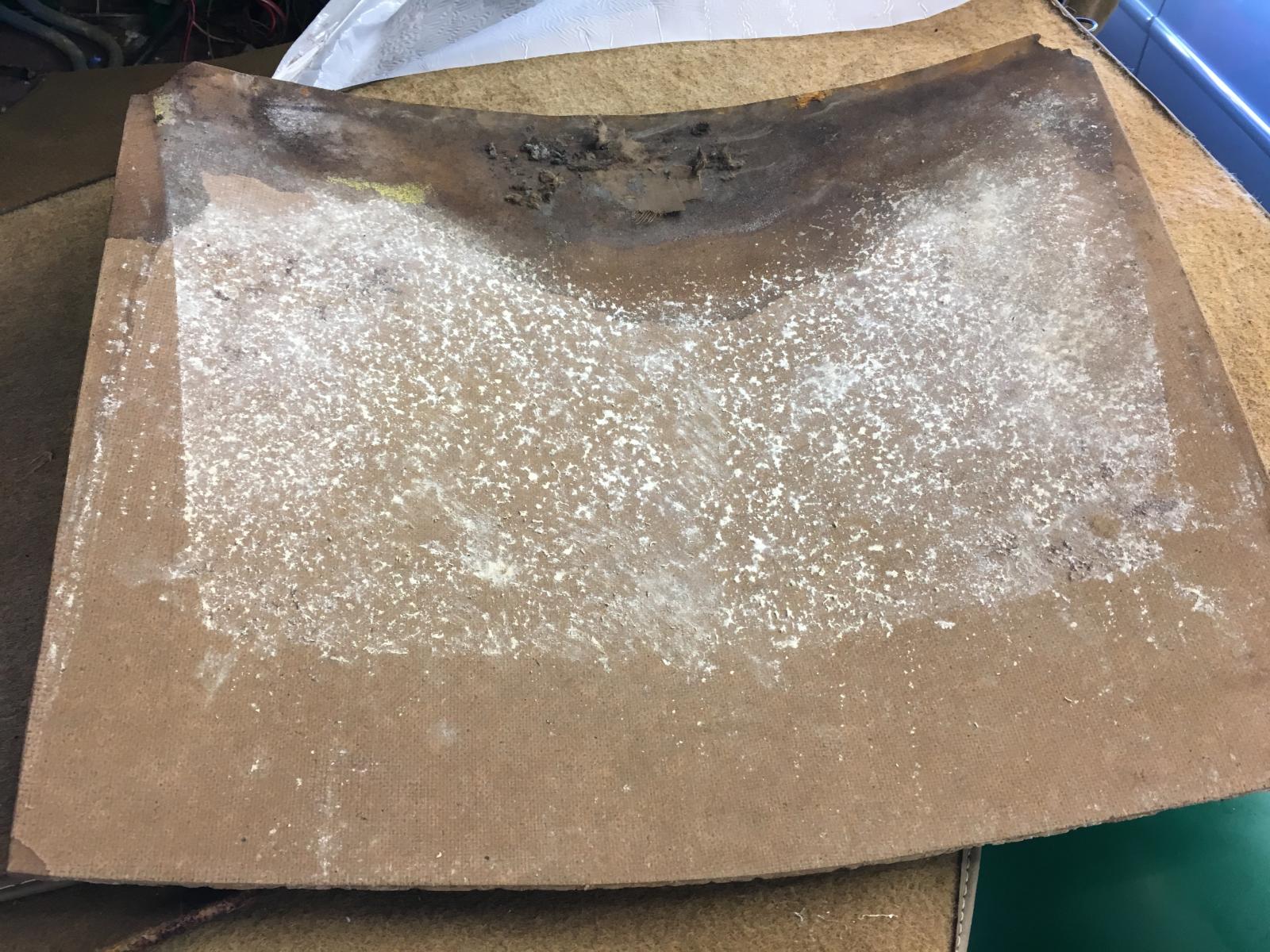

The battle with mice continues. I was hoping to save the seats. The vinyl was not cracked or torn.
Every time I walked by them I could smell mouse...This is what I found in both of the backs.
When I tried to peel the covers off, the seams started to give... oh well... It's just money right????
Also had mildew and mouse urine on the fiberboard back stiffeners.
The coconut padding looks pretty good, I hit it with the pressure washer. We'll see how it smells once it dries.
I took the carpets and pressure washed them. Then dipped them in a vinegar water solution to soak for about ten minutes. Then a dunk into water and baking soda! Nice fizz from that!

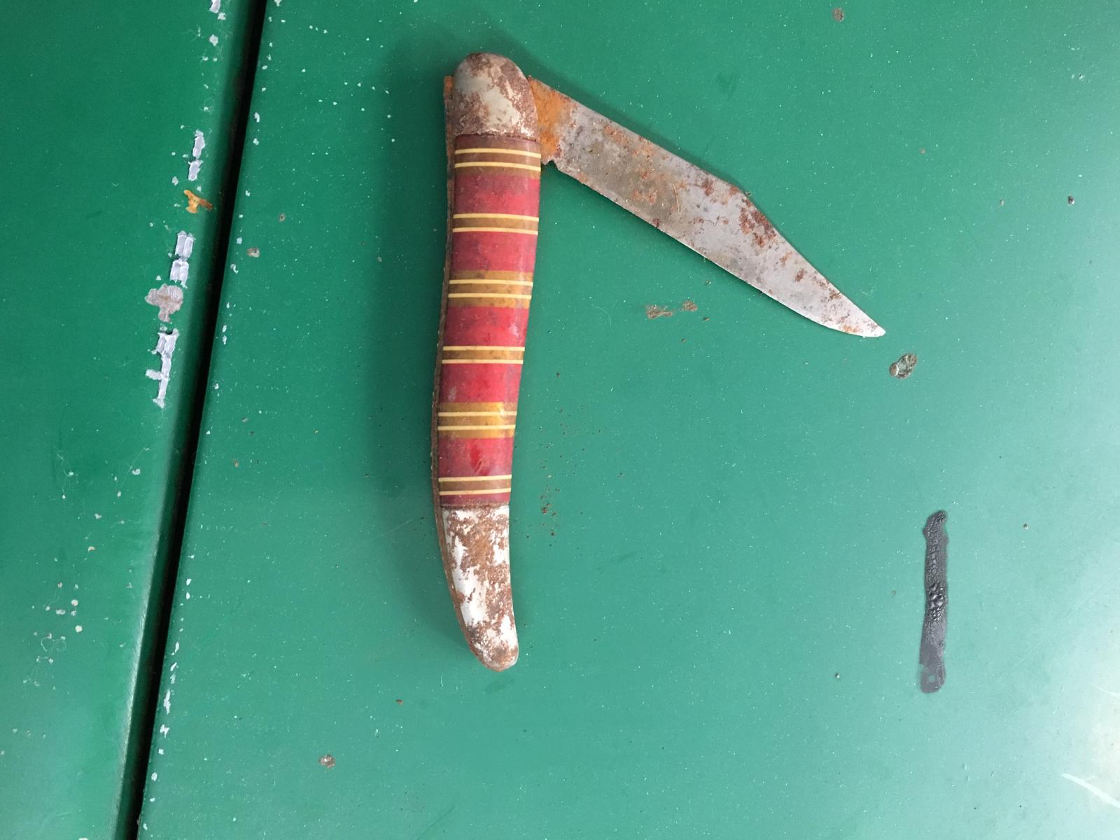

Found this under the passenger seat when I pulled it out.

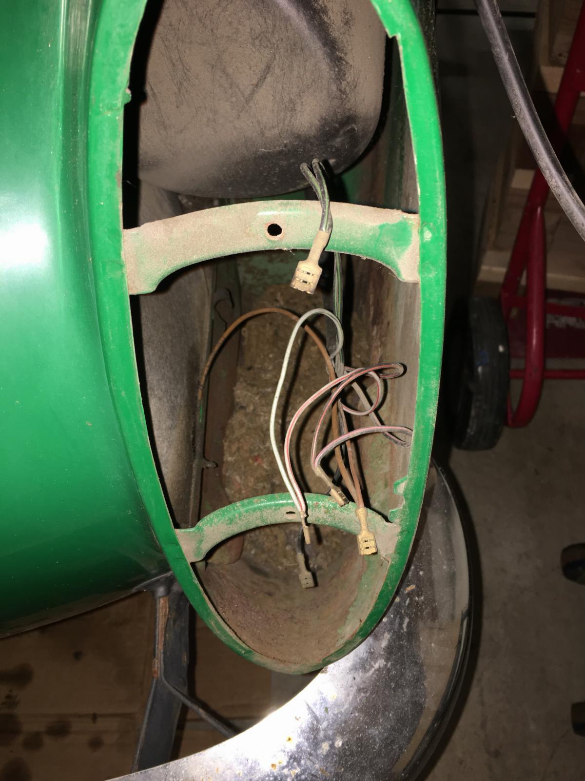

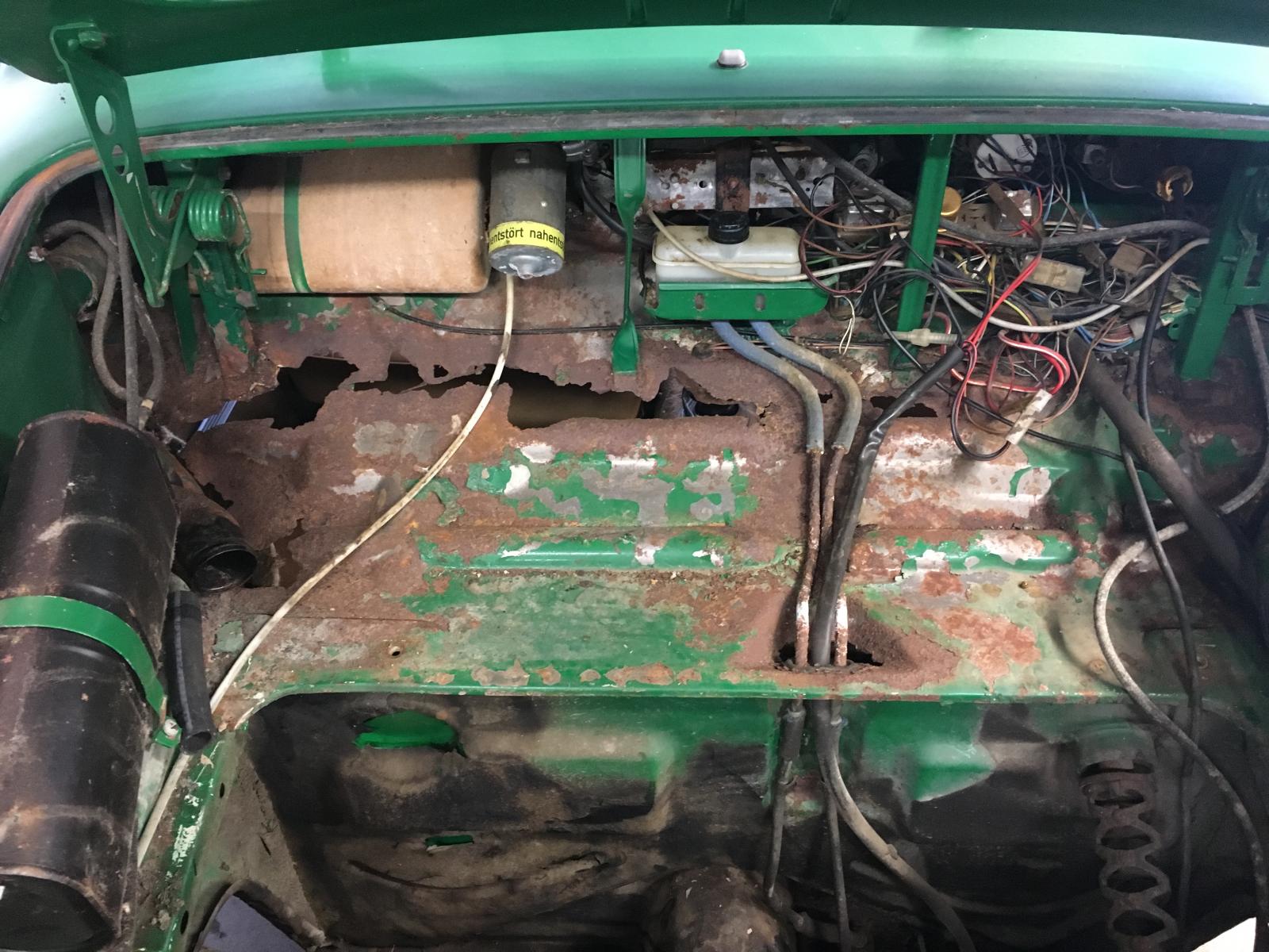

The mouse battle continues!
In the rain shield
And behind the passenger side tail light.
I also found some damage to the nose area.
I think once it's bead blasted I'm going to find more.
Almost ready to pull the body from the pan. I'm working out what I need to disconnect from the AutoStick parts and pieces.
I'm hopeful that I will have my repair panels next week! A member of the VW club here is giving me an entire front end.

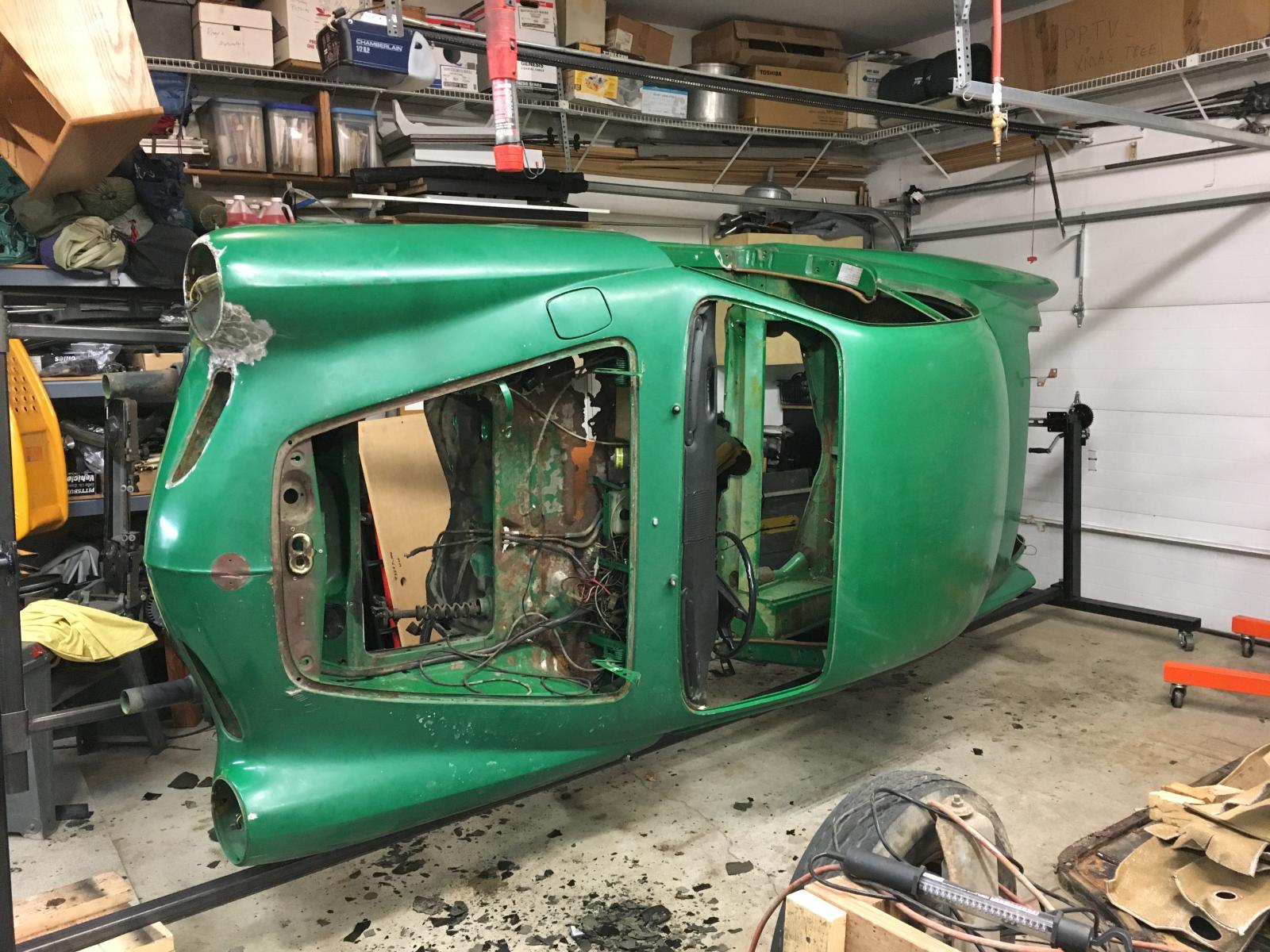

PostPosted: Mon Jan 02, 2017 6:47 pm    Post subject: Re: 1973 Coupe Reply with quote

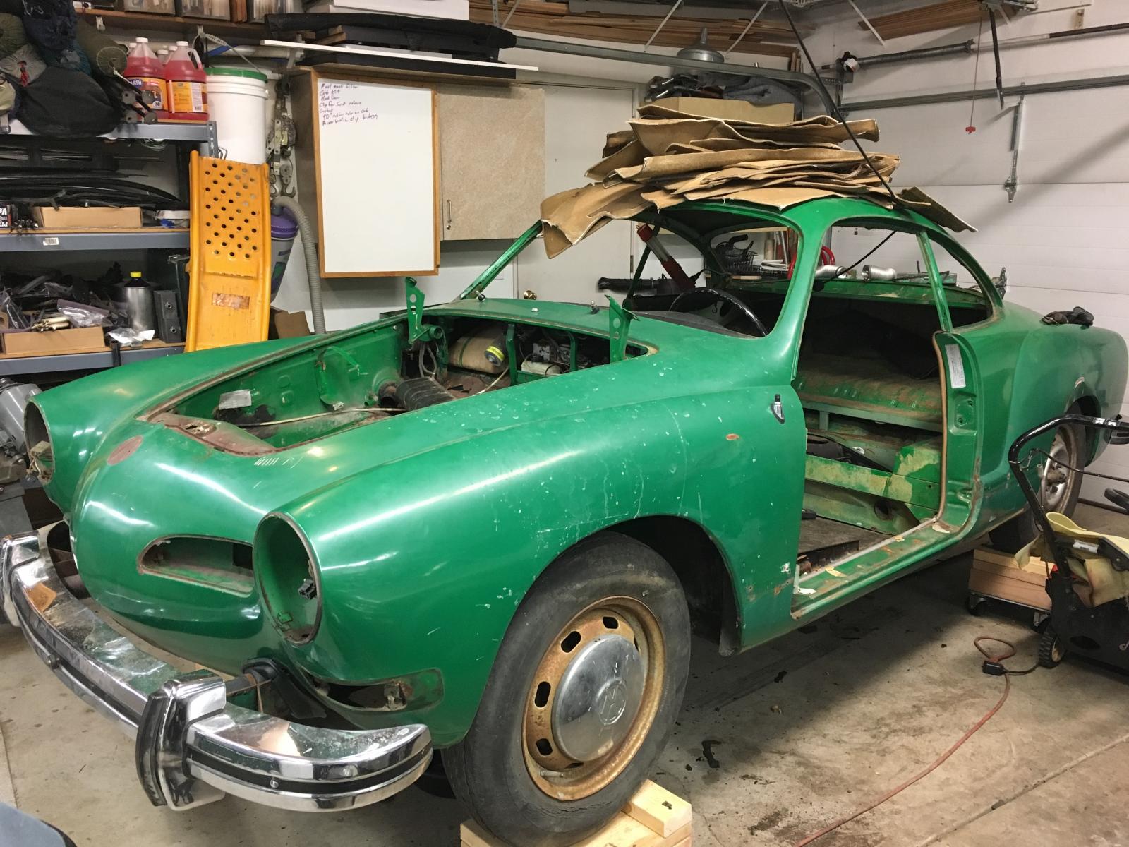

It's been a while, but I have made good progress on my '73.
We have separation!
Body mounted on the rotisserie
More mice.....
Pan ready to go !
Donor vehicle before
Donor vehicle after. All I needed was the Orange under dash piece. The donor car apparently had a heater in it. I'm wondering if I should put one in mine??

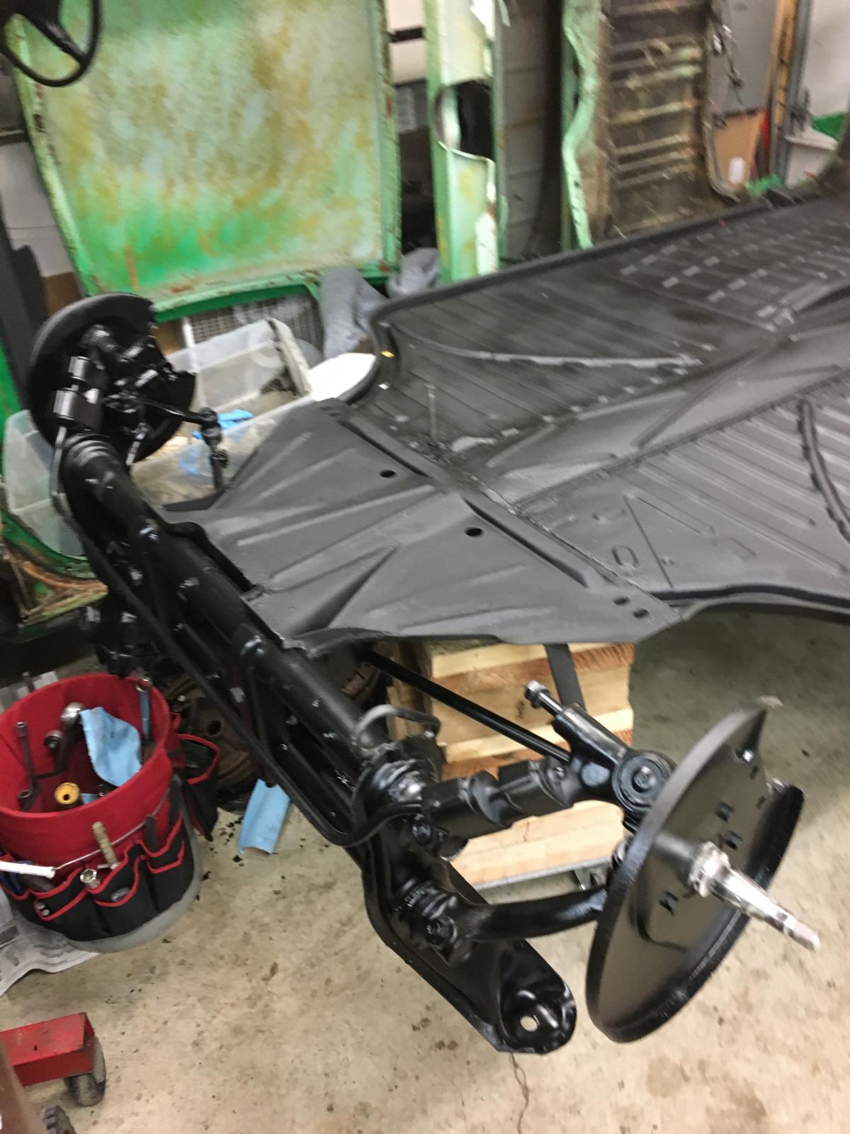

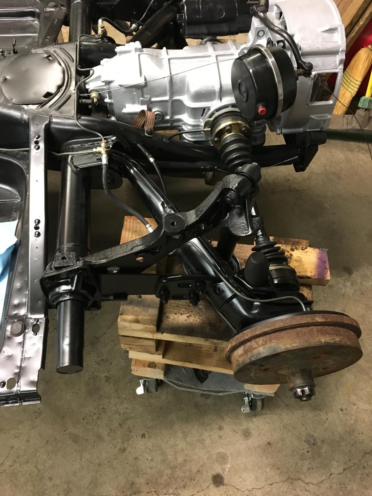

I undercoated the bottom while it was upside down, and remounted the front beam.
Autotrans cleaned up. I replaced one axle seal too.
Transmission remounted. CV joints cleaned and re-lubed. New CV joint boots.
All new brake system.
On to the engine!

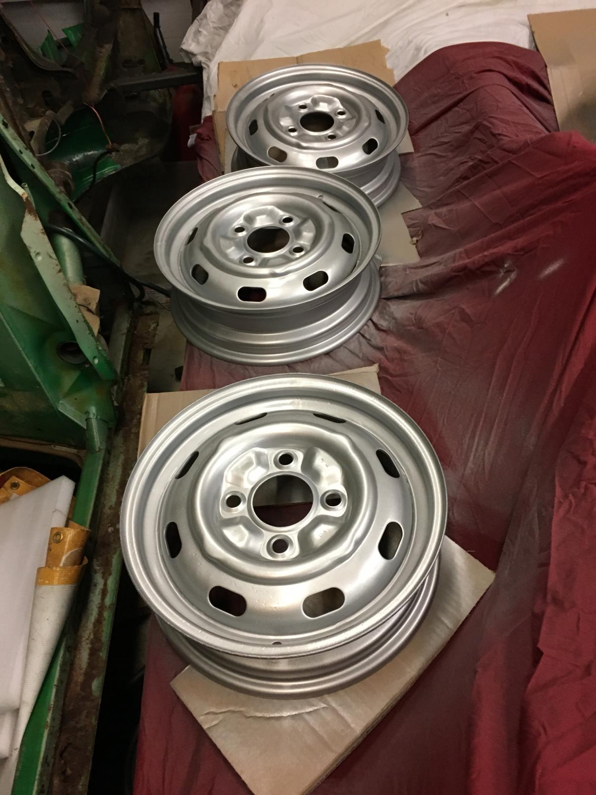

The wheels cleaned up nicely!
Now I need to decide if I want to spend the extra $$ for some nice whitewalls to put back on them....

How did you handle the wheels?
I'm thinking of dustless blasting mine and then repainting

The guy that blasted my pan blasted the rust off the wheels and primed them. I seam sealed the "joint" and painted them with Duplicolor HWP101 wheel paint. Supposedly its a match for the factory color.

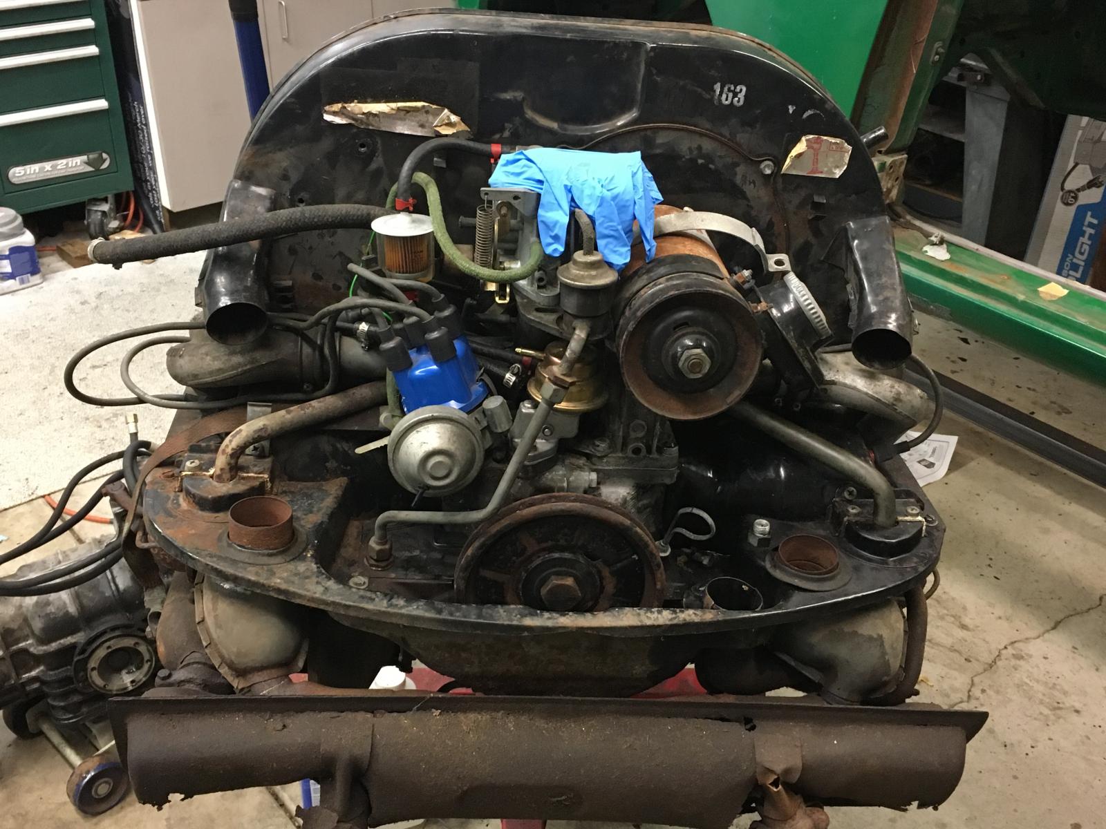

Moving ahead with the '73
I cleaned, lubed replaced the seals on the tie rod ends.

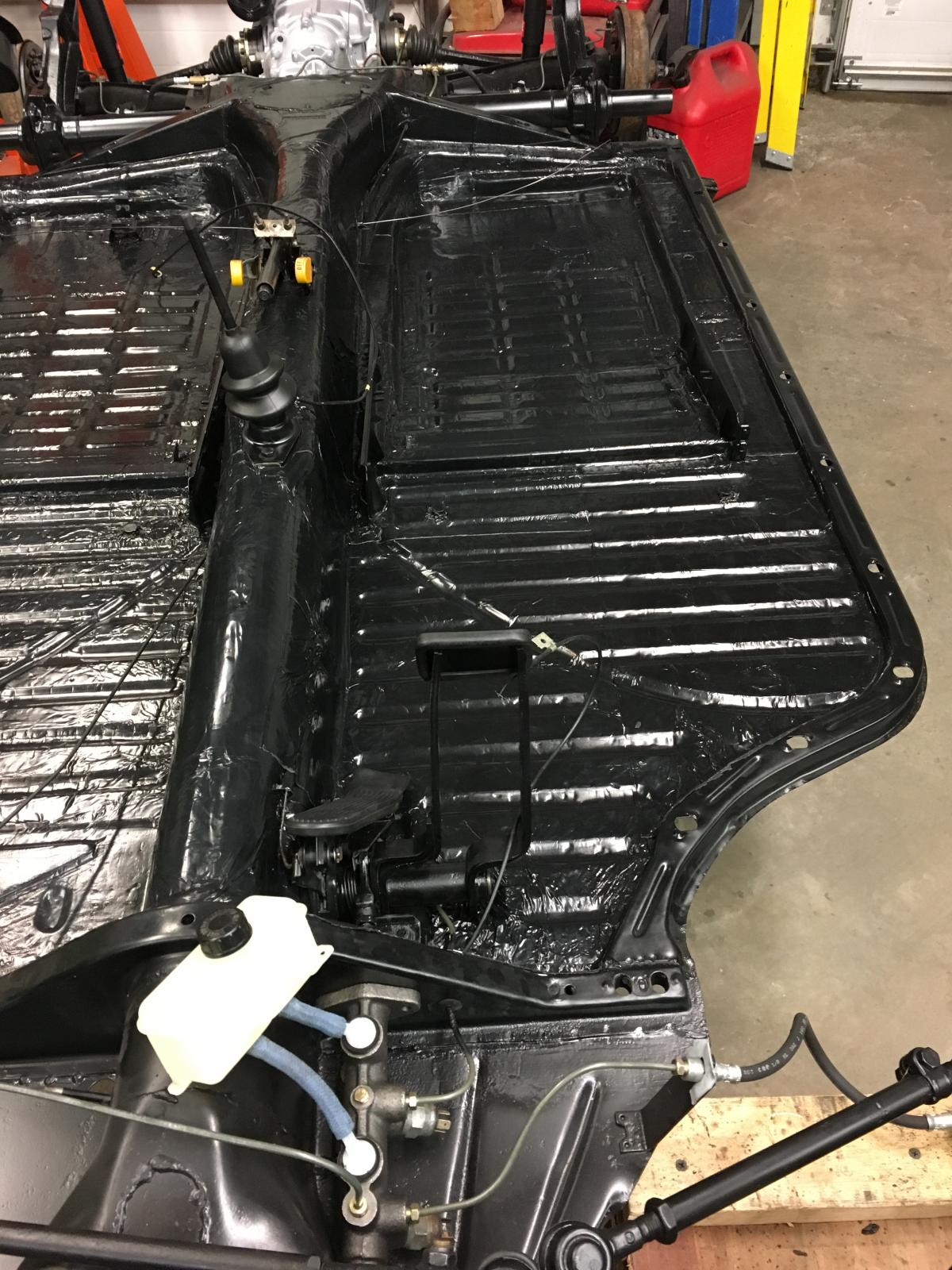

I lined the pan with HushMat, The original tar boards just smelled too bad to re-use.
Finished getting the engine cleaned up and put back together.
Before
After
Anyone know what the numbers on the tin signify?
I bought some raised letter stickers from a Hobby store and used them to recreate the numbers. I couldn't find the exact font, but I think its OK.

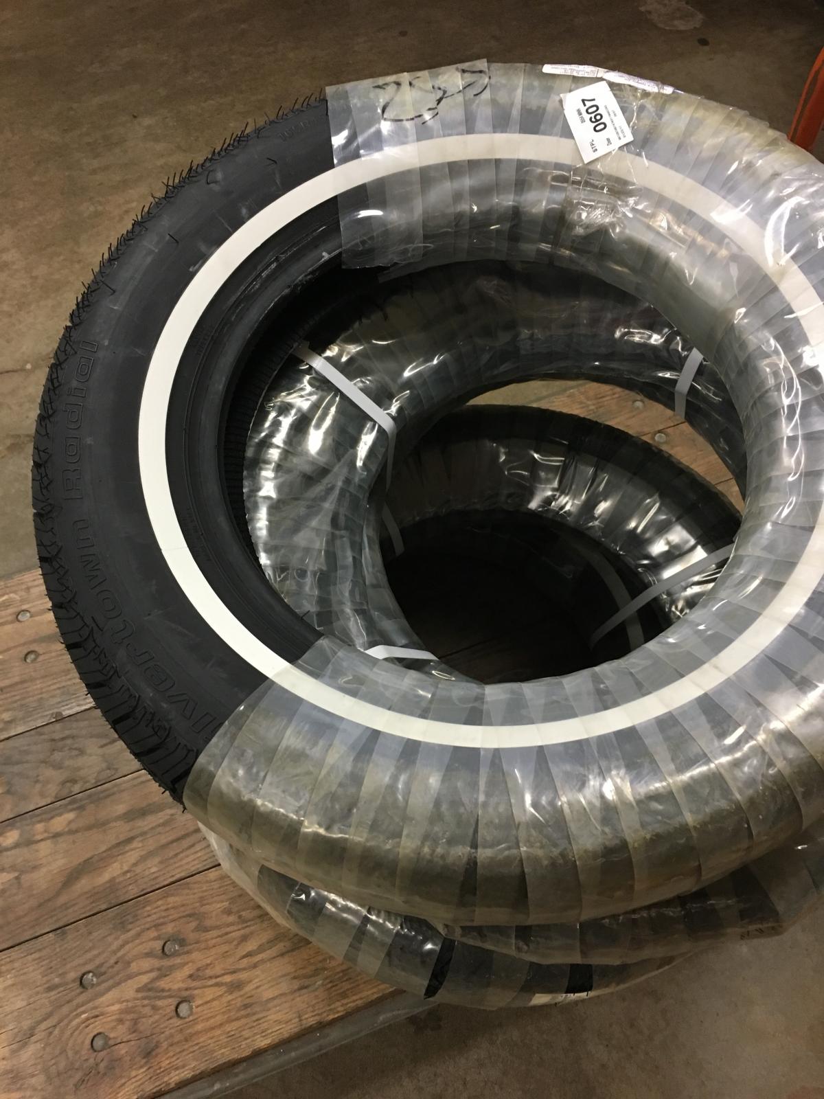

Whitewalls came in
Got them mounted

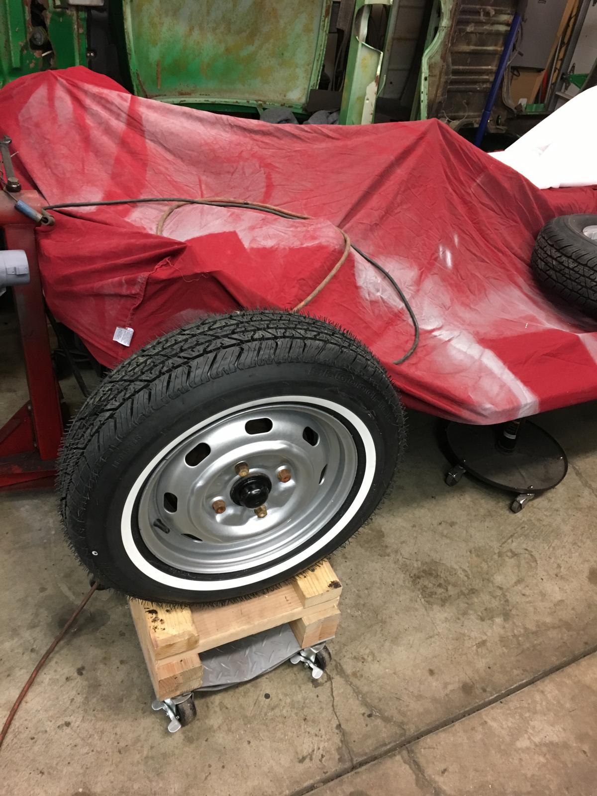

Bled the brakes using DOT 5 silicone since everything was new and put the tires on to get them out of the way.
I need to replace the rear main seal, and rehang the motor. Any thoughts on using synthetic oils in a 40+ year old engine?
I may try to rig up a tank for the transmission pump and fire it up before I put the body on. Of course that could be a year or so out....
