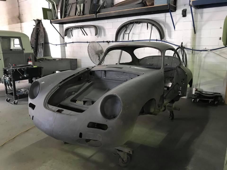

I’ve jumped into this with my eyes wide open but there is a chance Im not seeing everything. There’s a reason for that, namely, the car is scattered all over the country. Most of the body is on the Gold Coast near Brisbane, much of the mechanicals and interior is in Melbourne and I’m in Sydney.
However, I have completed a Karmann Ghia restoration and I’m pretty sure I can repeat that success with this 365.
I saw this car in September 2017 and recognised it was a great project when I learned the owner wanted to sell it. My friend Angus Dowrie snapped it up quicker than I but when another car, an SC, showed up, He grabbed that and passed this one over to me.
This project has had a number of false starts but from now the plan it to get the bodywork done at least to paint ready. That should give me enough time to plan the project out and get it done in a proper and timely fashion.
Some pictures for your enjoyment.

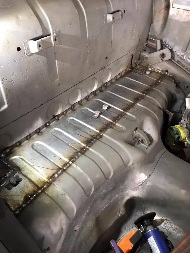

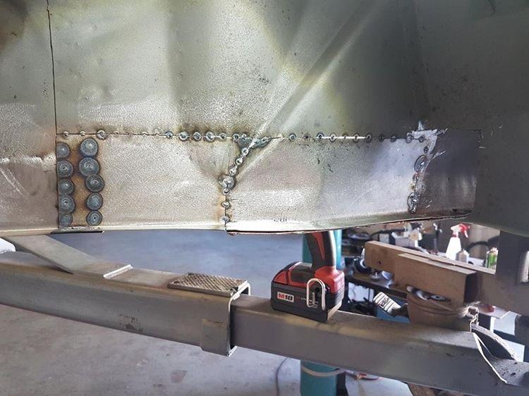

Back seat run repair with a new locally made panel
view of the front portion of the car's skin
The skins removed show very little crash damage and mostly rust repairs

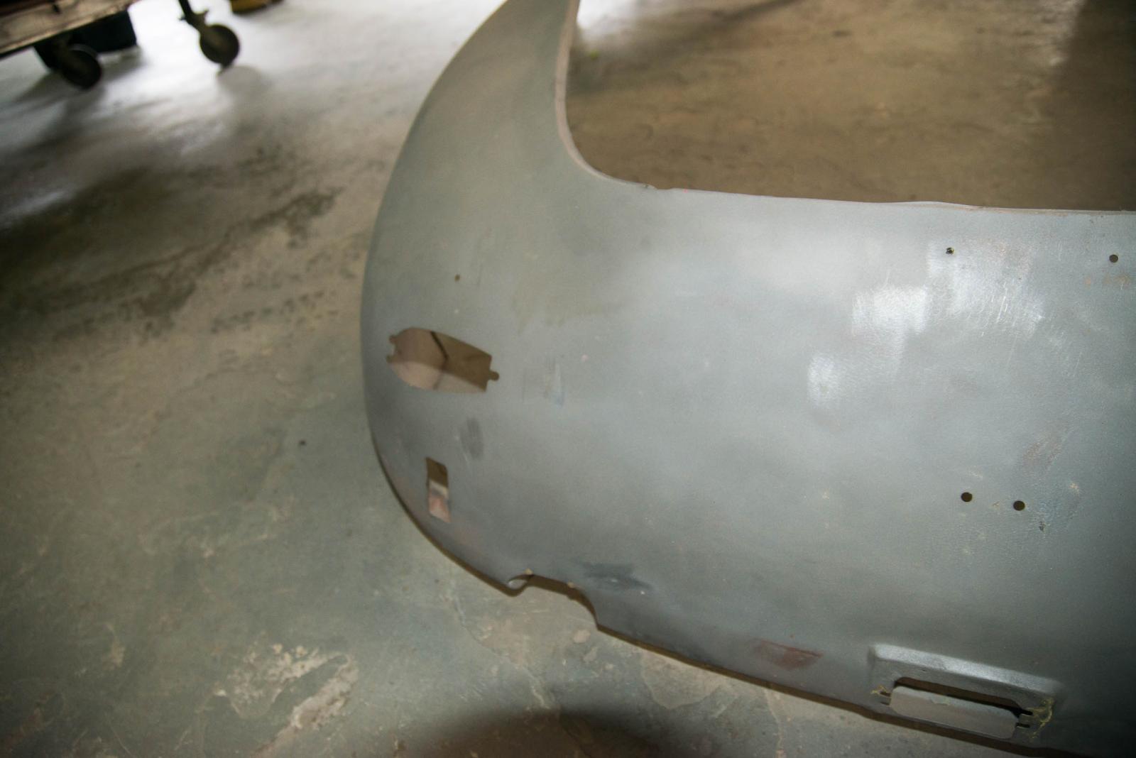

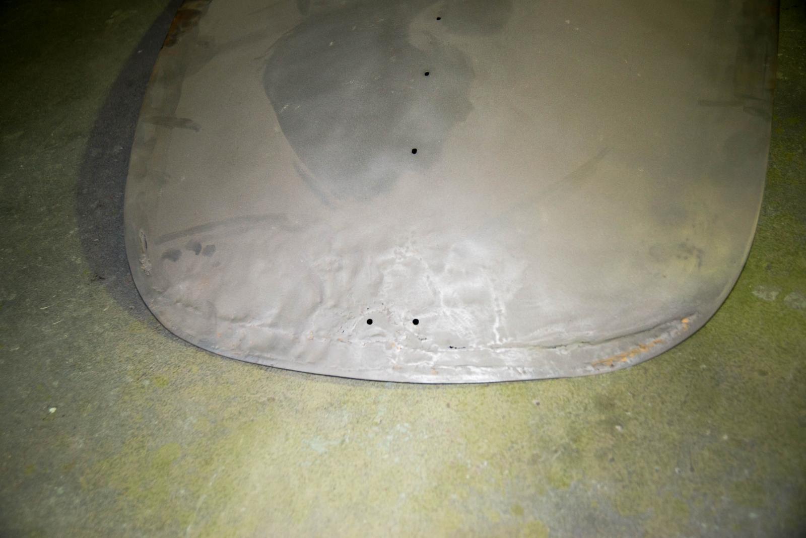

The engine lid is nearly perfect save a tiny dent in a flat portion that'll be easy to knock out.

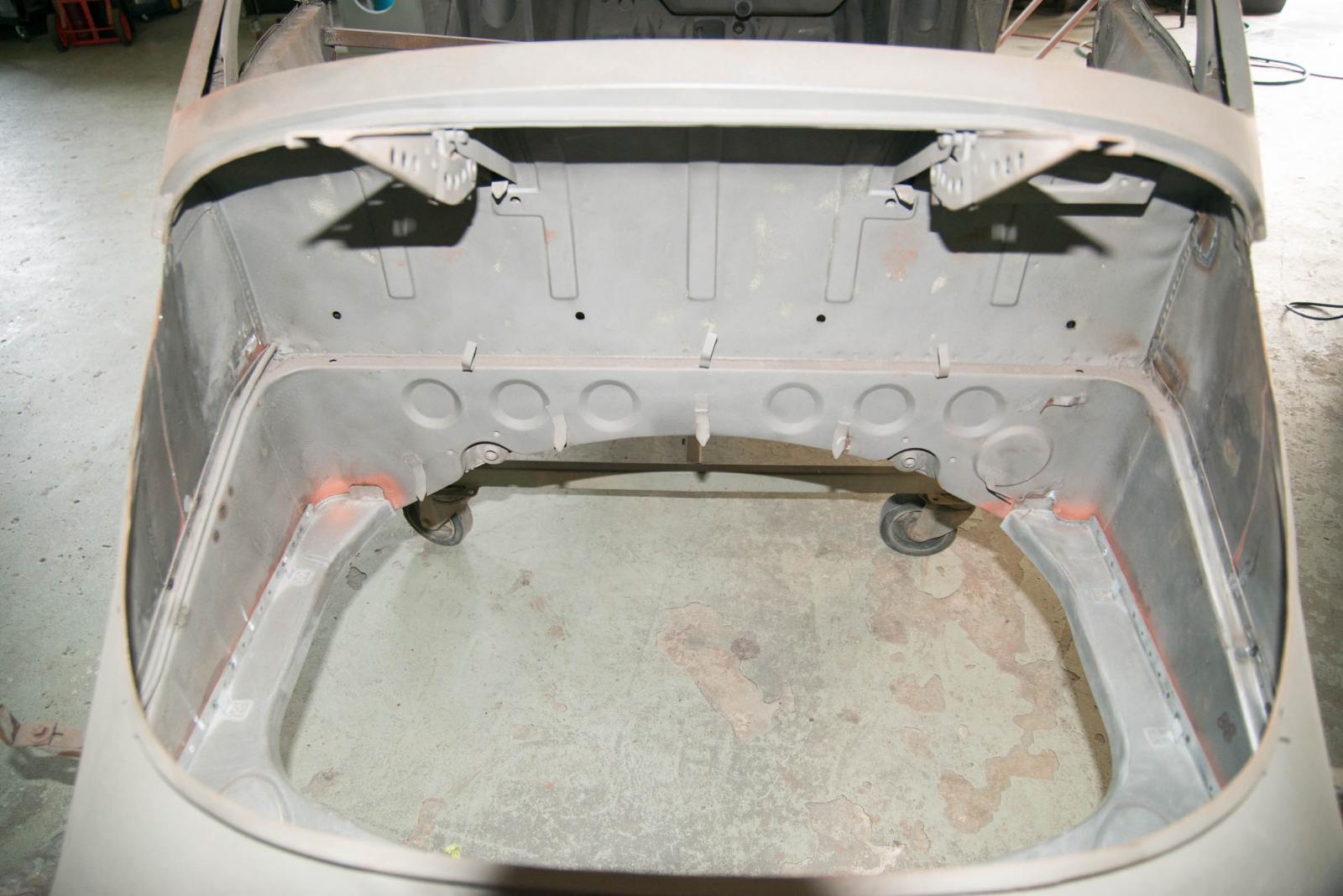

front trunk lid needs the front edge replaced. I've seen original Porsche parts available but those come at quite a high price.
Doors are mostly OK and just need lower skins added.
rear skin is mostly OK and just needs some shaping
Head light needs new metal.
Usual rust around the front lights and vents
Tinwork in the engine bay is completed with new metal

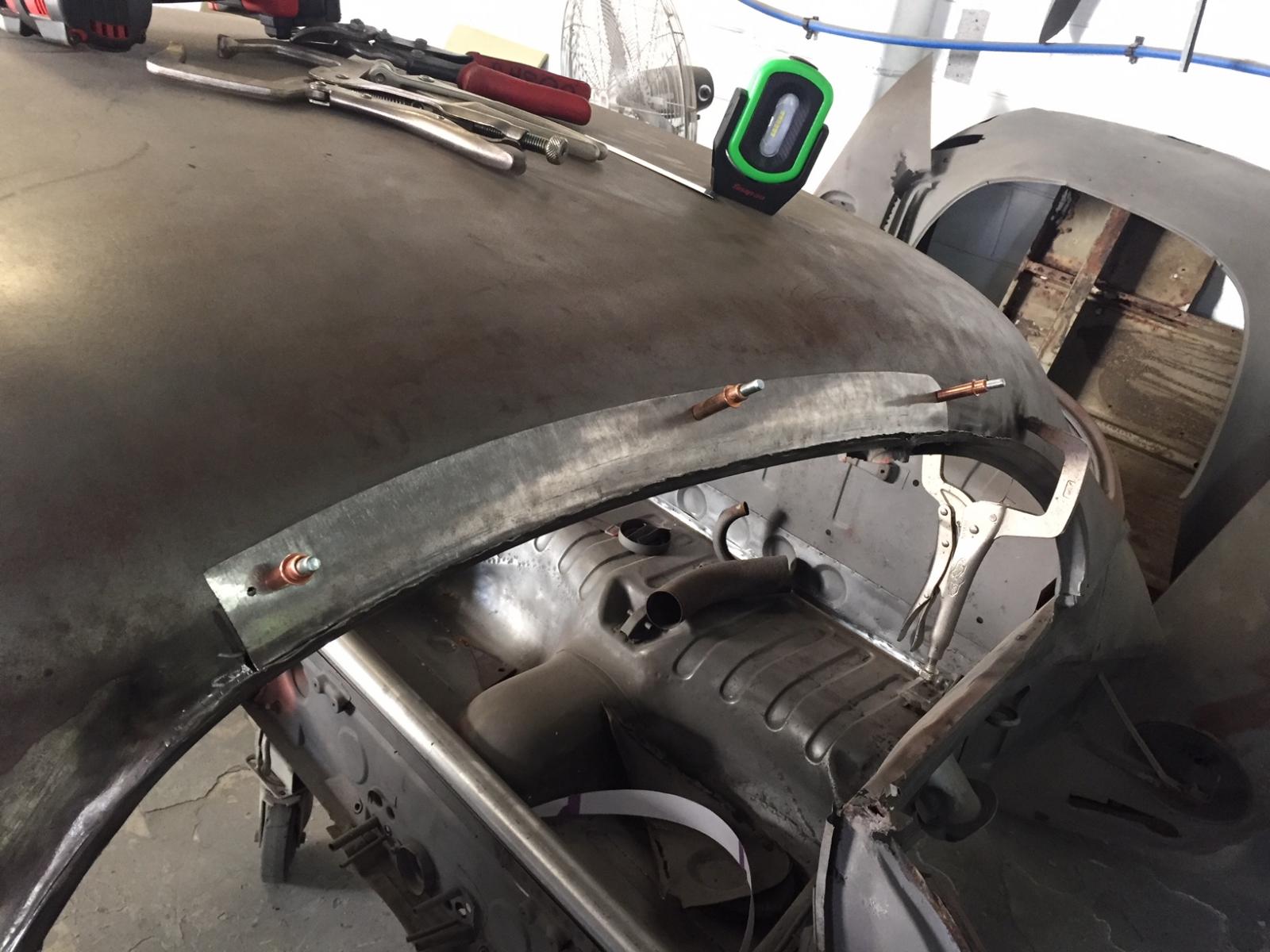

Progress updates
Here is the roof being patched to repair the rust holes in the gutters.

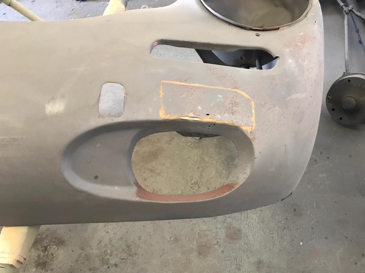

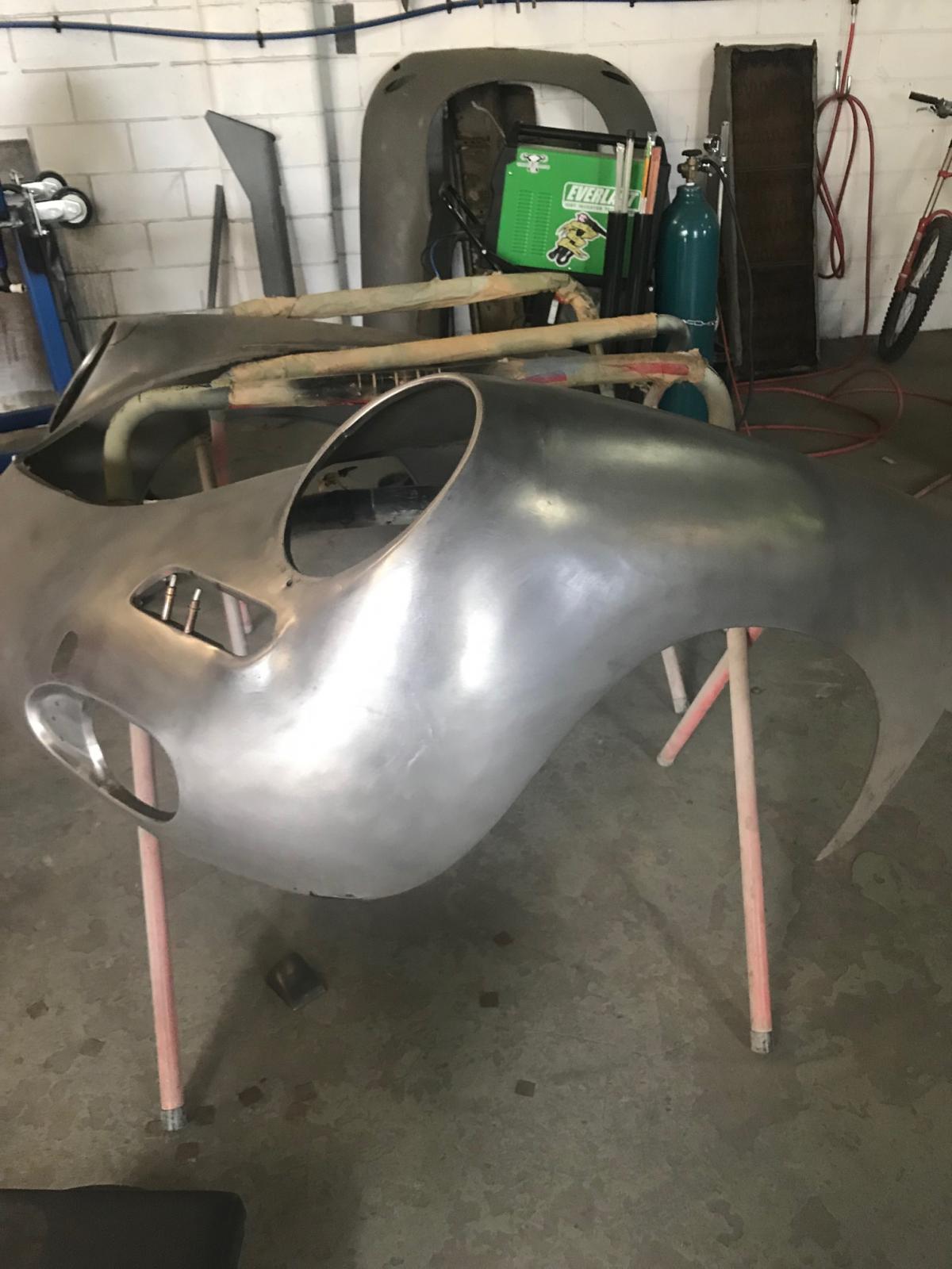

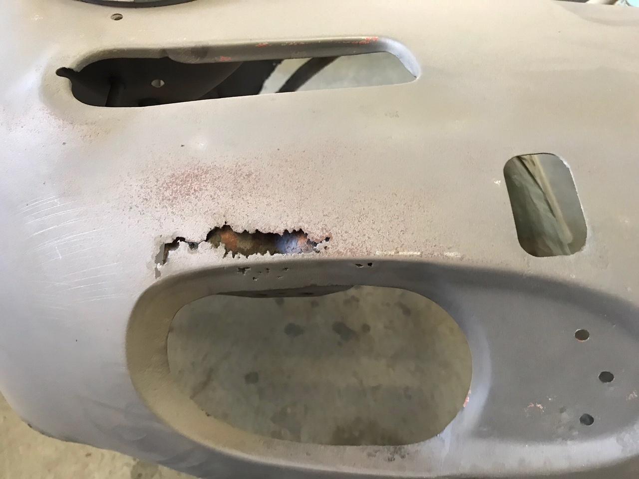

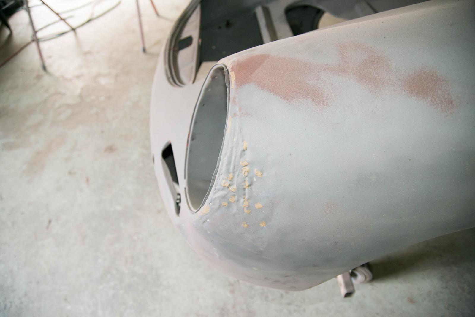

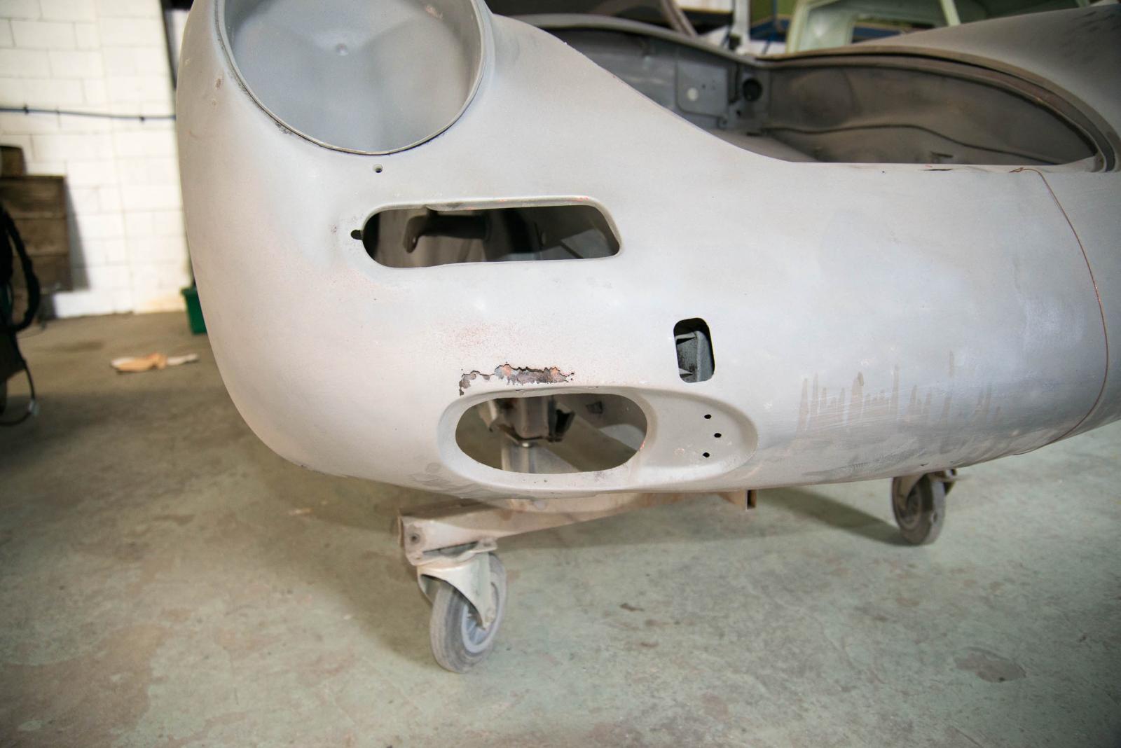

Attention has been up at the front.
This how the vents appeared at first
Then work started to fix those extra holes..

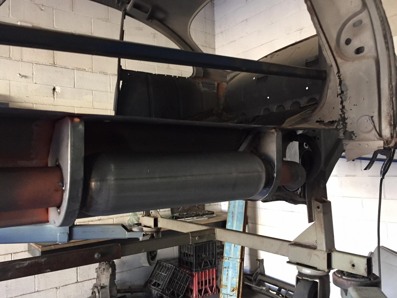

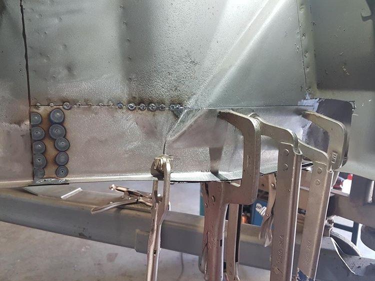

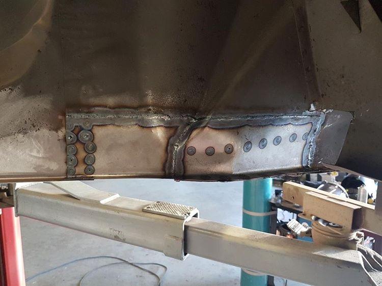

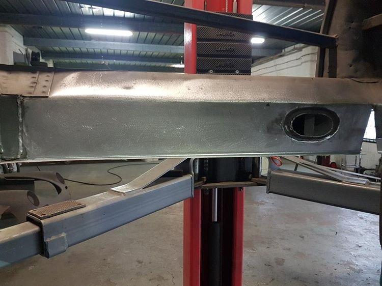

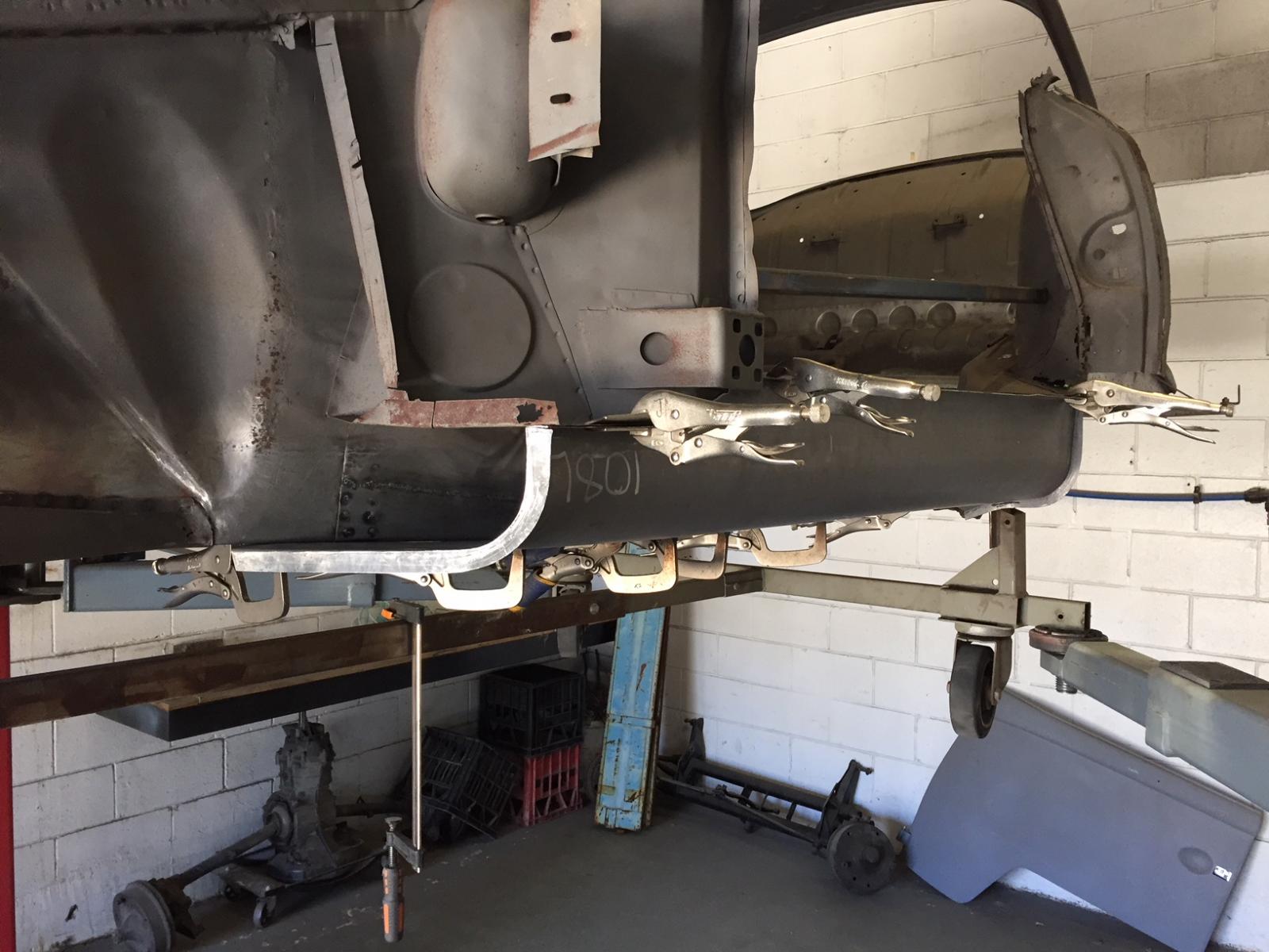

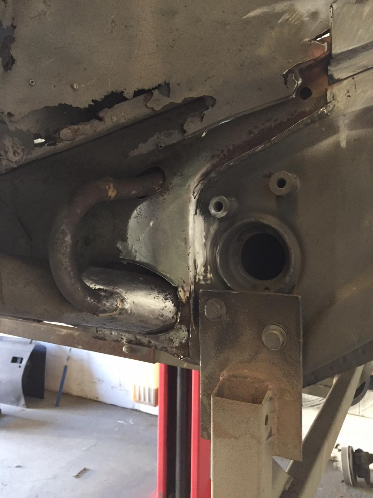

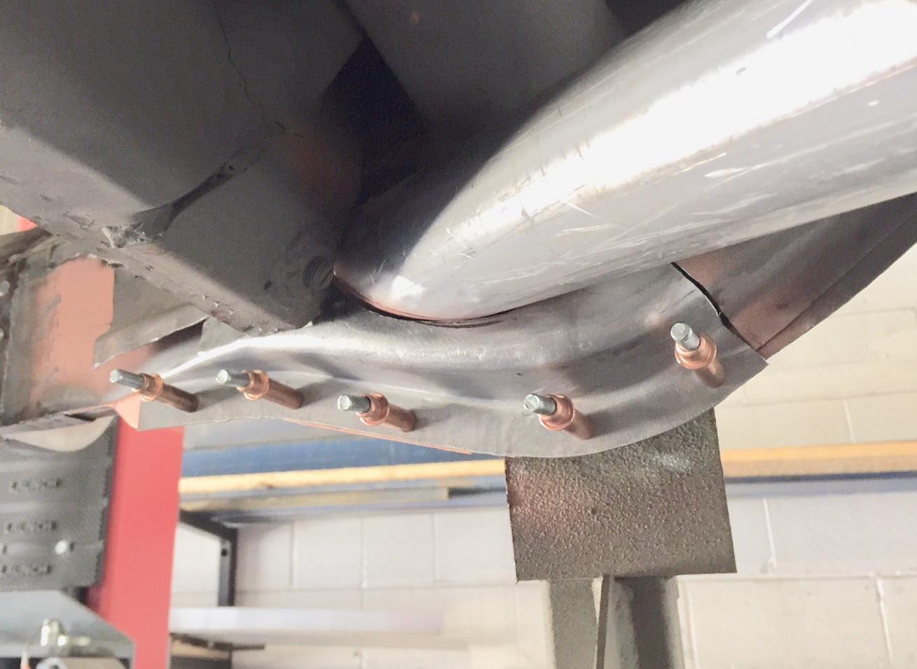

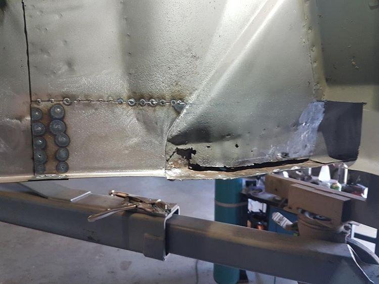

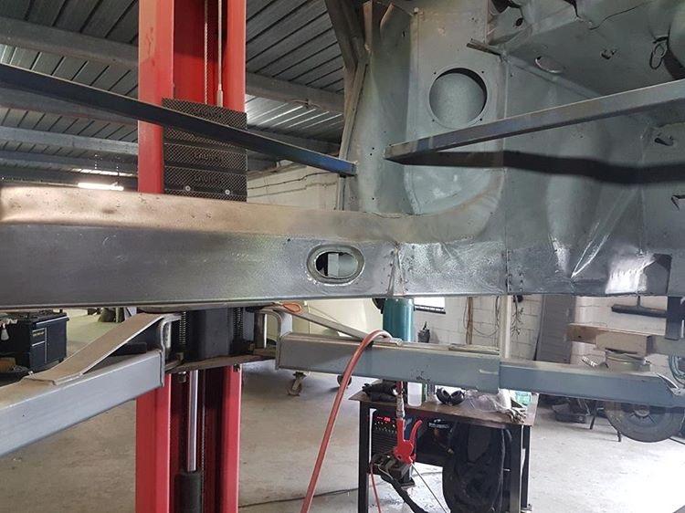

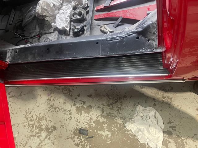

More work forging ahead. We are working on the Heat tubes and under the sills
There will be small pieces added in the lower guard, later.
Muffer added to keep down some of the noise.
Trial fit for the outer sill piece. This will all get a protective sealers and epoxy to stave of rust in the future.

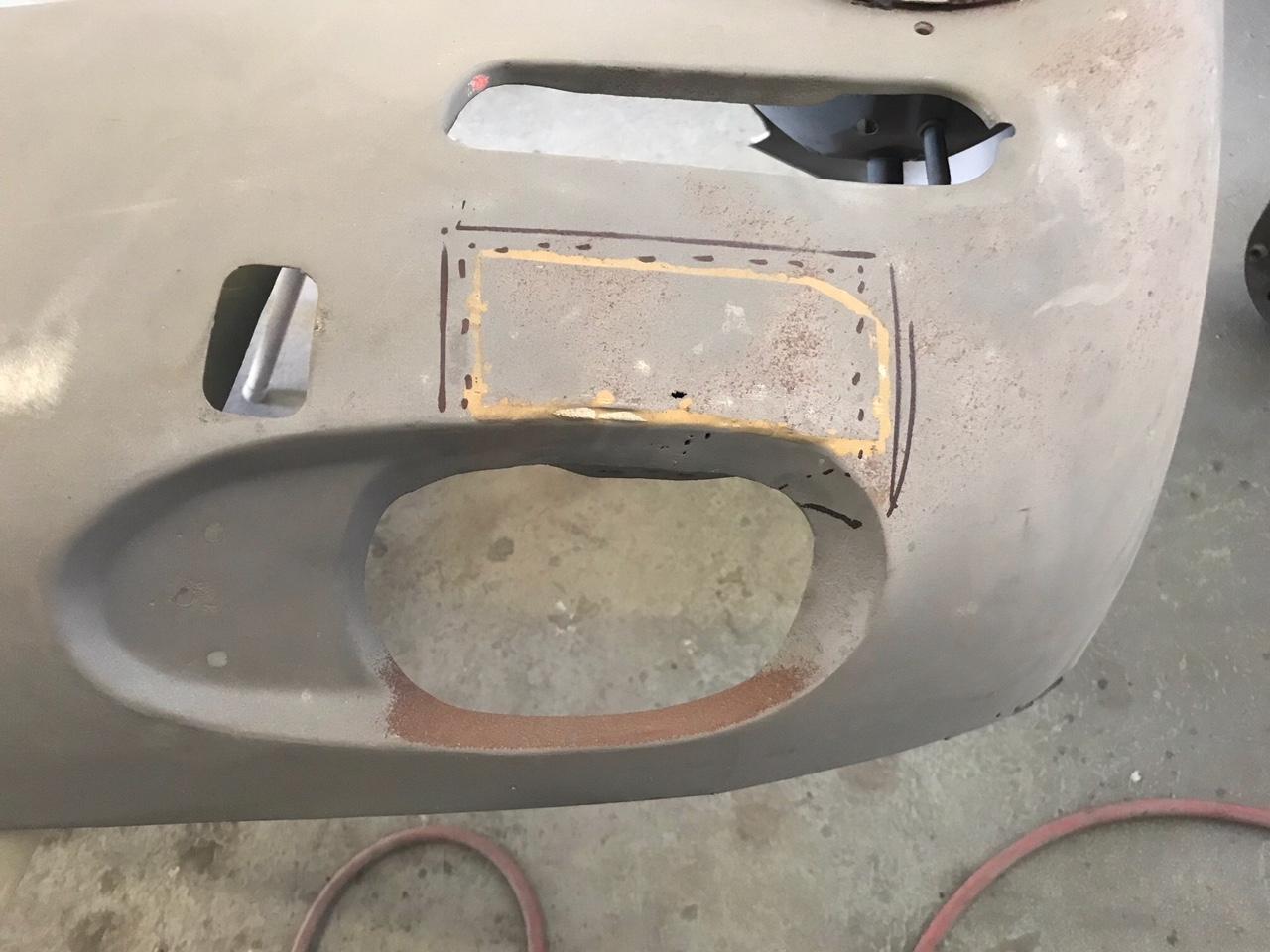

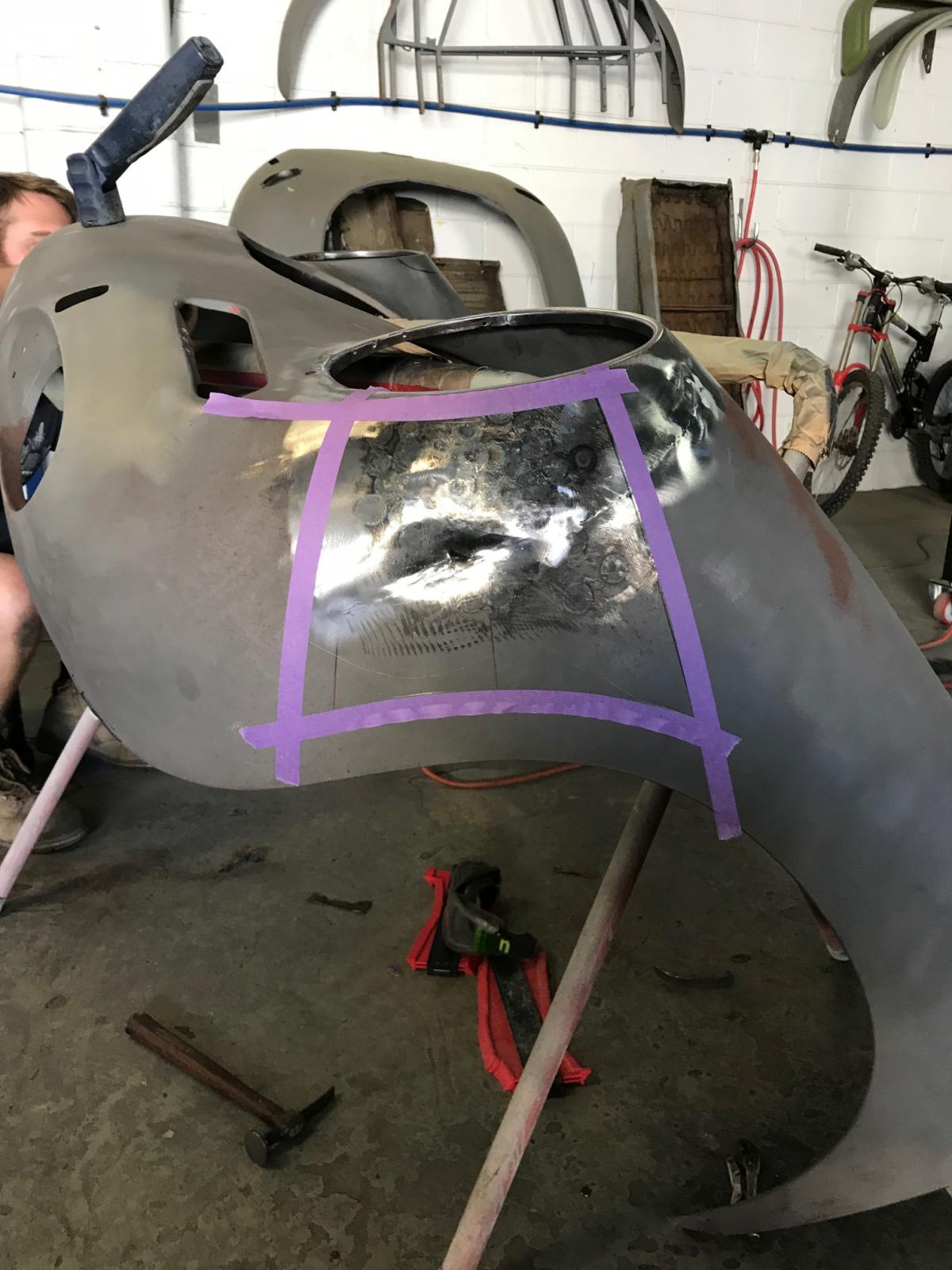

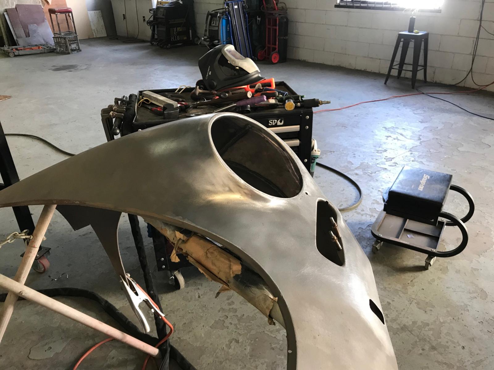

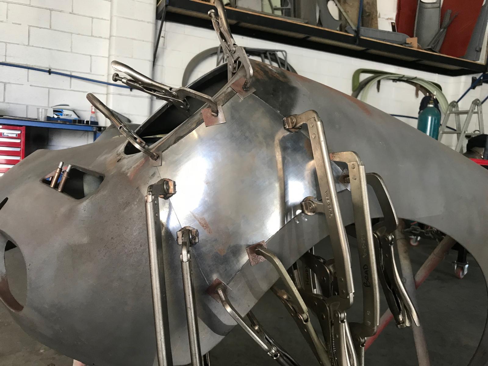

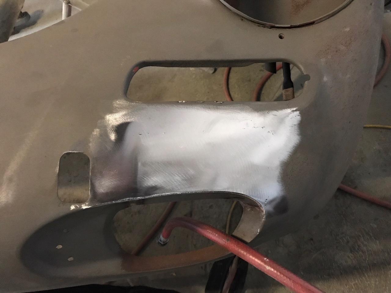

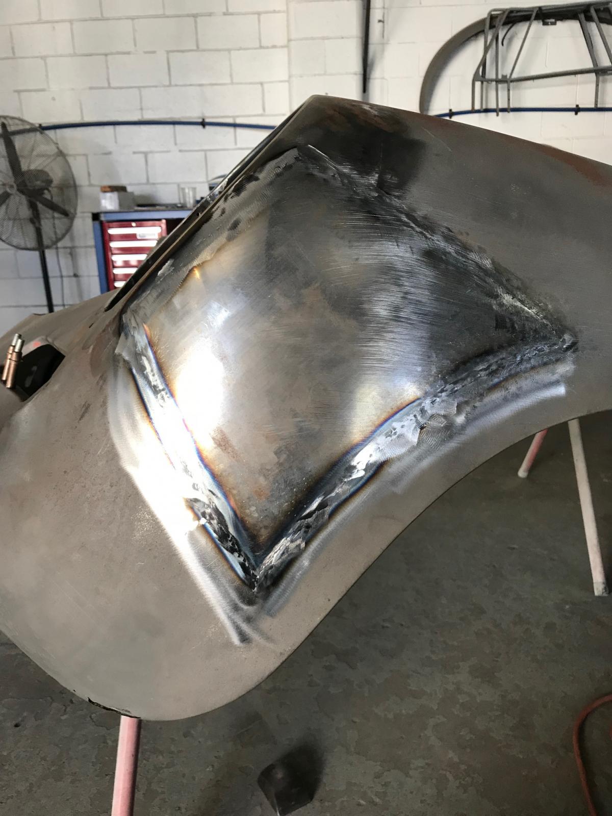

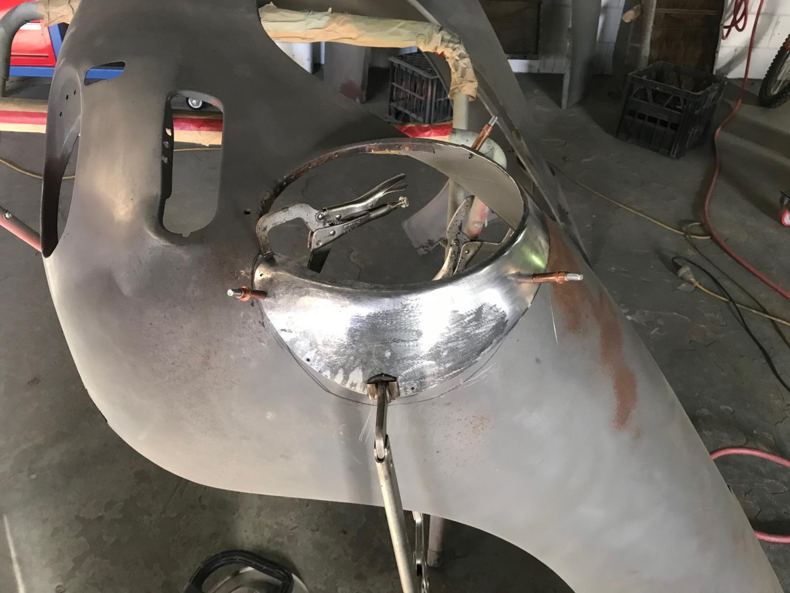

The RHS headlight needed more attention than expected. It started off well enough.....
.....until a crack developed with the heat stress. Further poking showed the metal was too far gone and it was systematically replaced.
This looks pretty good now.
Thanks for looking

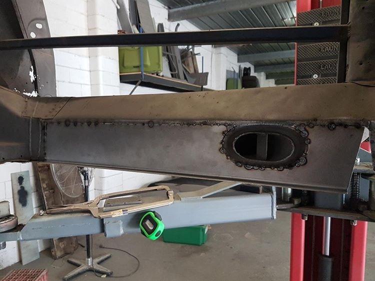

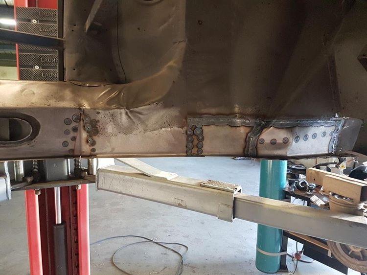

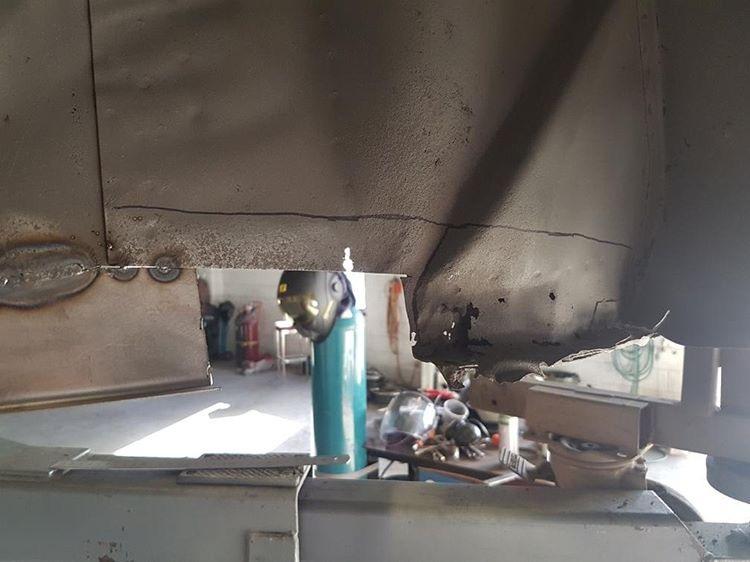

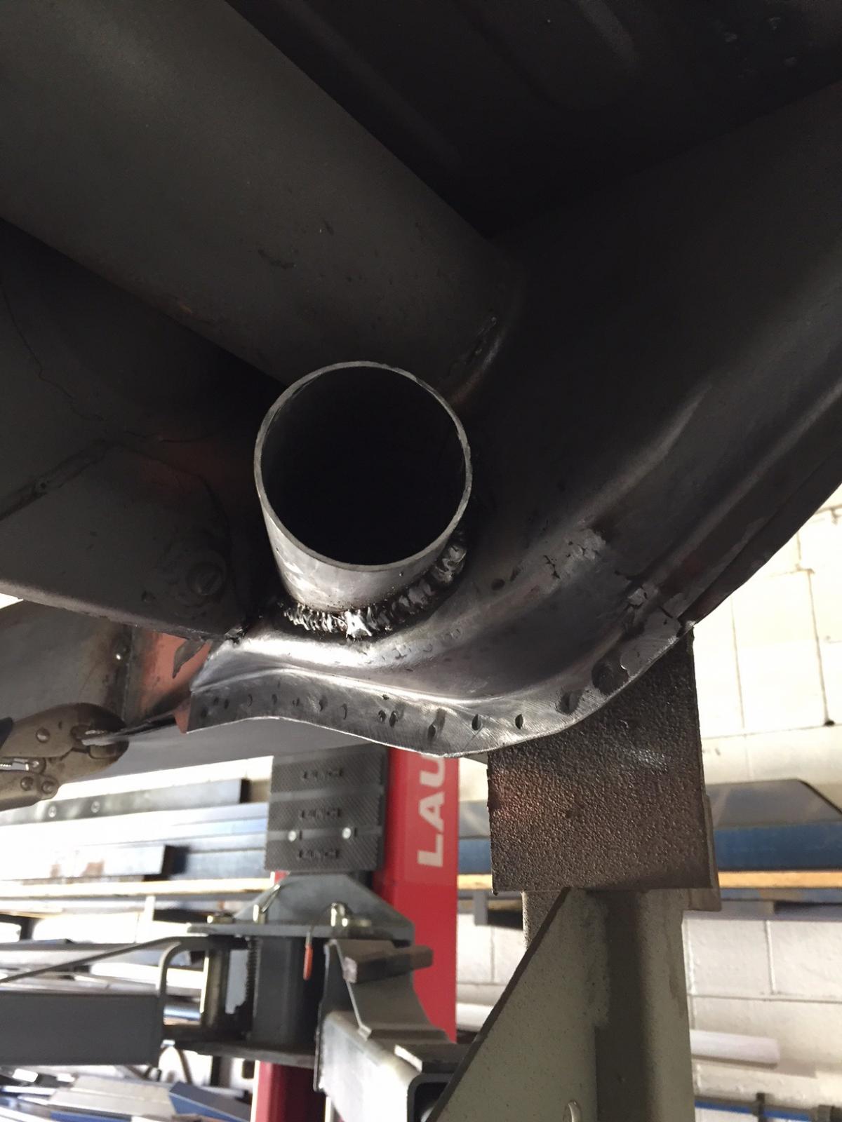

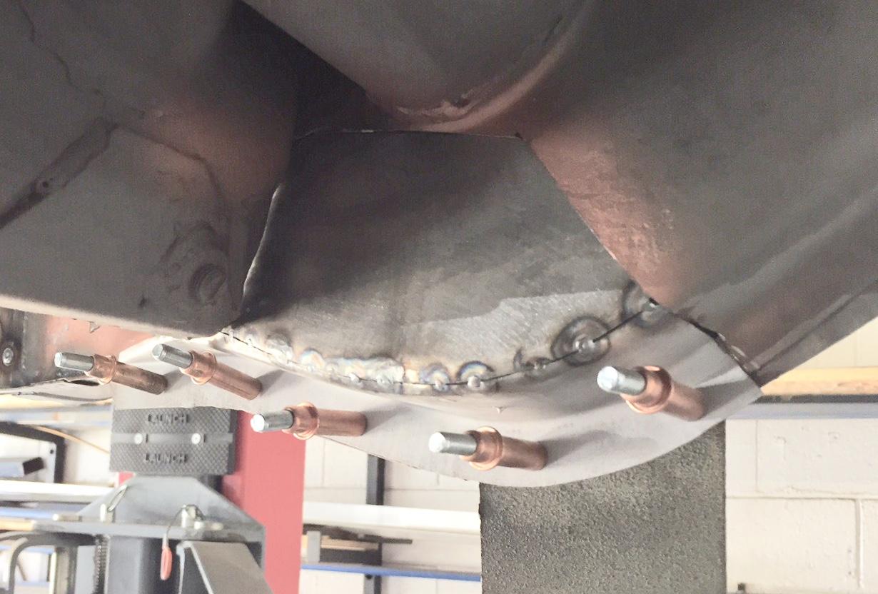

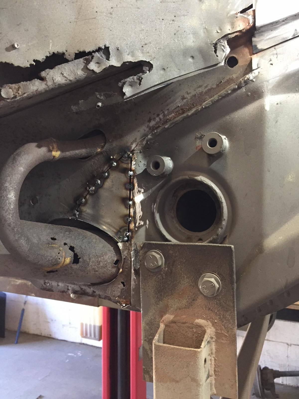

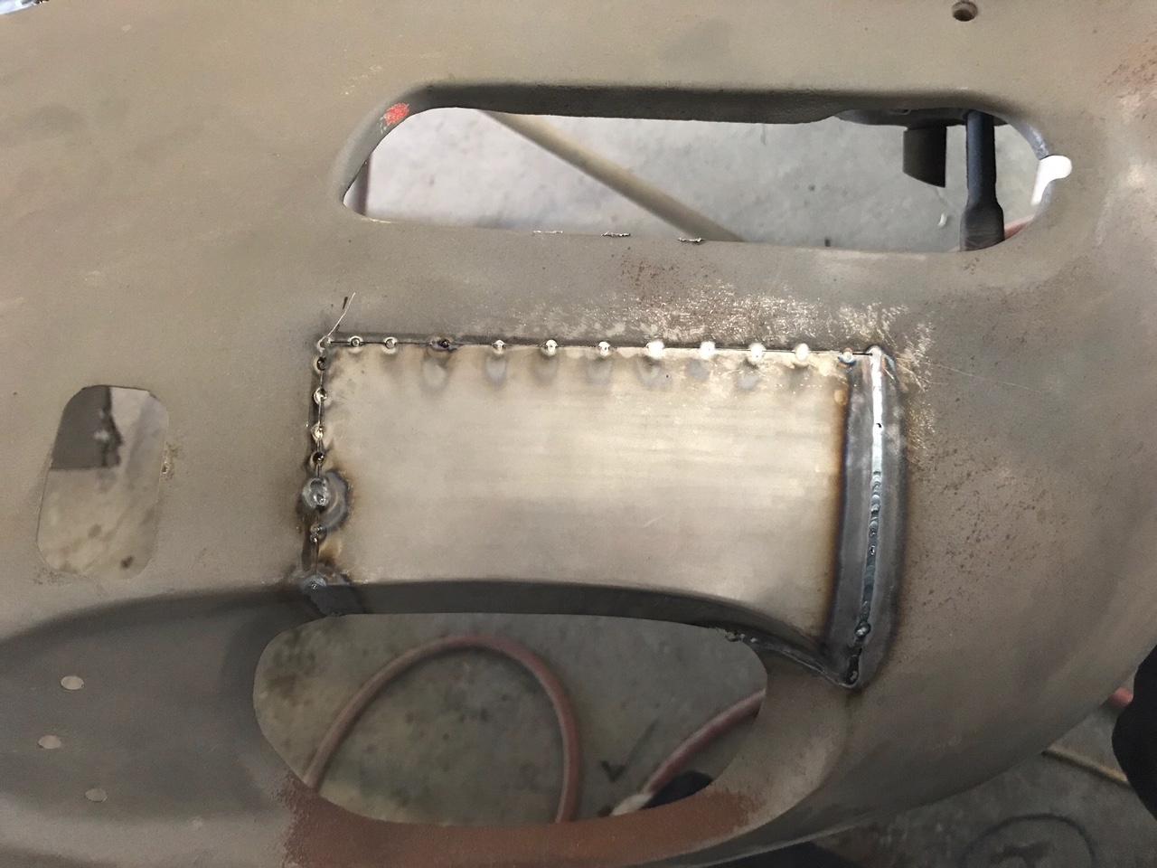

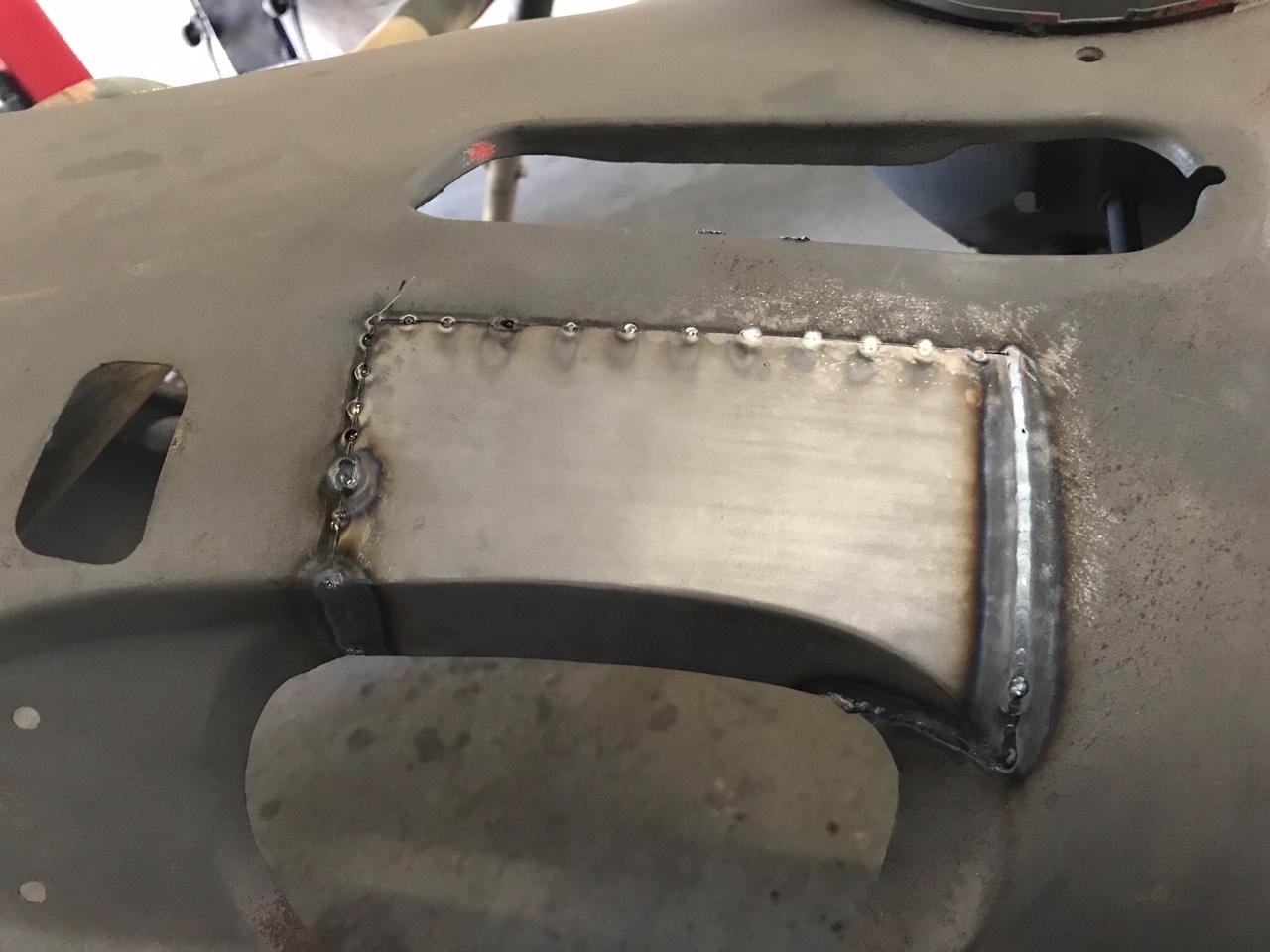

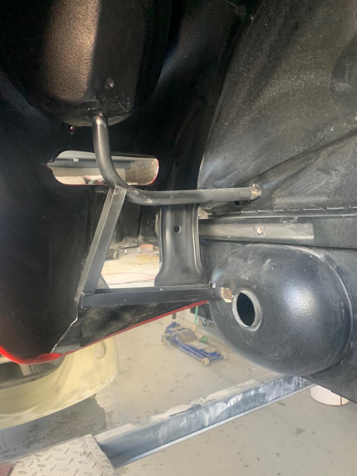

Anyhow, the tasks are being done and the remediation continues. This week we are dealing with the heat pipes in front of the rear wheel house region.
The piece is fabricated from two bits tacked together on the car
Then welded together on the bench
the welds are filed out, the hole added, the piece attached to the car and the heat pipe slid through...
....and finally the pipe welded in position
That’s a day’s work in itself.
