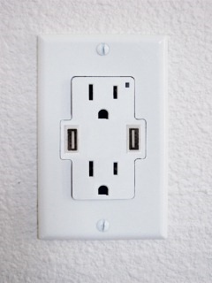

PostPosted: Sun Jan 24, 2010 12:03 pm    Post subject: Reply with quote
I was wondering when someone was going to post an USB option. Since most phones/handhelds are using 5v batteries and are able to charged via USB, it seems that everyone will only need to buy one car cell phone charger from now on.
For those of you with campers, these might come in handy for charging a few phones, etc....

PostPosted: Sun Jan 24, 2010 12:18 pm    Post subject: Reply with quote
I've seen 12V plug inserts that have a USB receptacle on the exterior end...
Before buying such things - you need to do some research on how much power will come out of the USB socket...and then compare to what your device power needs might be. I have read about people buying these units and then finding out there wasn't enough juice to recharge their phone (usually a smart phone).
