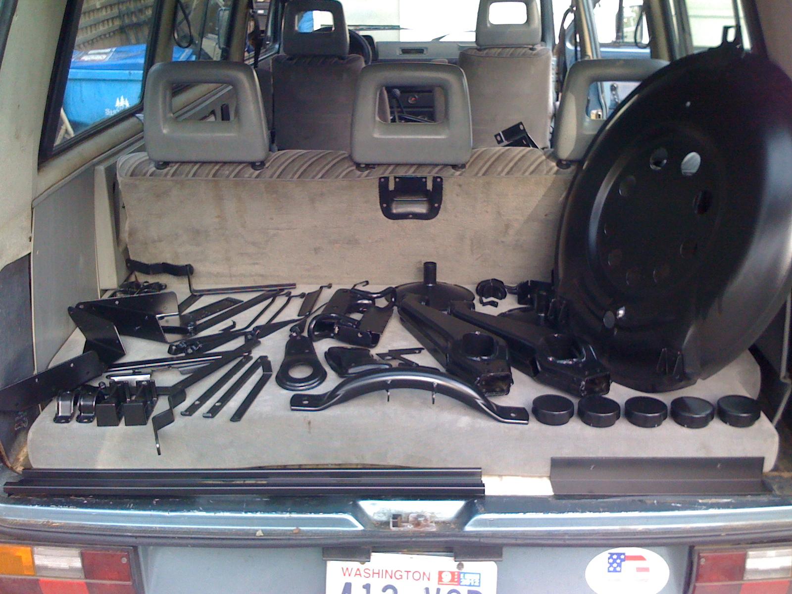

and sent them off for powder coating. I pulled the syncro harness and set it aside. I cut out the gas filler and also removed the gas tank but didn't take any pics.

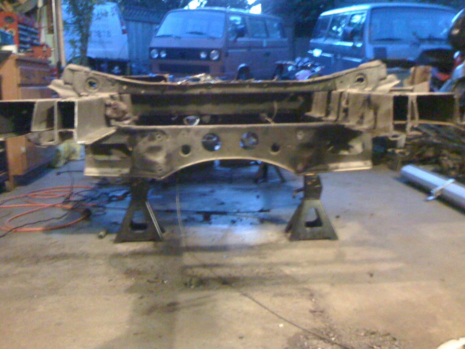

The Syncro started looking pretty bare!! I cut off the floor pan and was left with the frame rails. Here is a good view of the power steering rack that needs ot be cut off and transferred to your new van.
This is the frame rail flipped over showing the power steering rack again and also the center crossmember which either needs to be transfered or something fabbed on the 2wd.
I cut the power steering rack off and the center crossmember using the "cut extra and grind down" method as this leaves things much stronger! I cut a couple of other pieces off and sent the rest to the scrapper. Time to start on my van!!!

Got the first batch back from the powrdercoater. I went with a cardinal 20% gloss. I had asked for a flat black but the powdercoater informed me that you want at least a 20% gloss to protect from uv(even under the van...reflections ect). They look good and I can't wait to put them on!!

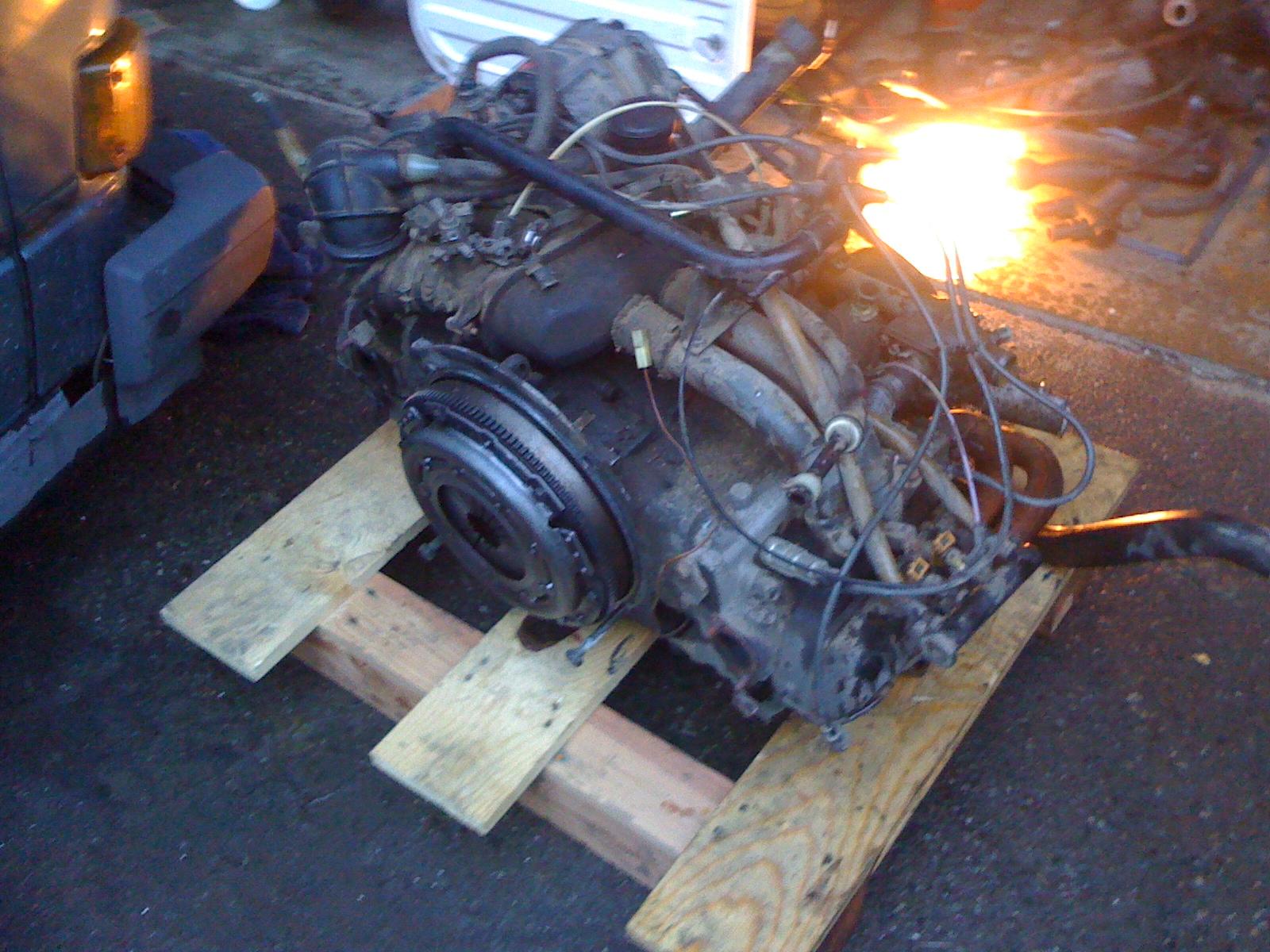

We dropped the engine outside before rolling the chassis into the garage. The 1.9 was sold to a guy with a bad engine that had his van stuck at a shop. They ran a compression test on the engine before putting it into his van...155/160/160/160. Not too bad for original engine with about 250,000 miles and a couple of rebuilds. Hopefully it takes the new owner to many places troublefree.
One of the biggest tips I can give is to bag and lable everything...pics too!!! It will help a lot. I pulled all suspension, wiring harness, everything that can be removed with out cutting...and then grabbed the sawzall. The 2wd suspension has to be cut out. On the upper parts I tried to cut low and then grind down. On the 2wd steering rack I cut it with a little extra to weld too.

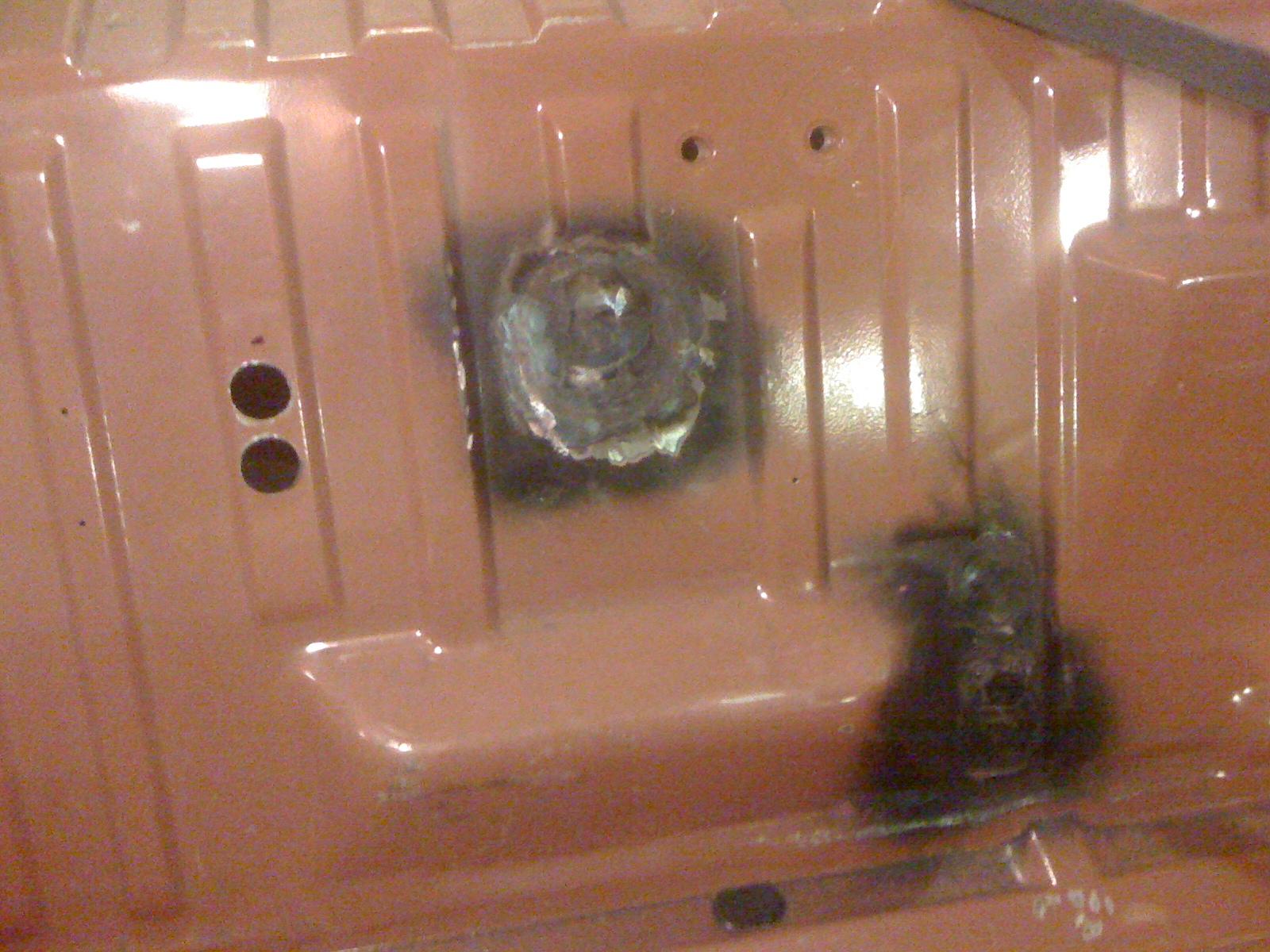

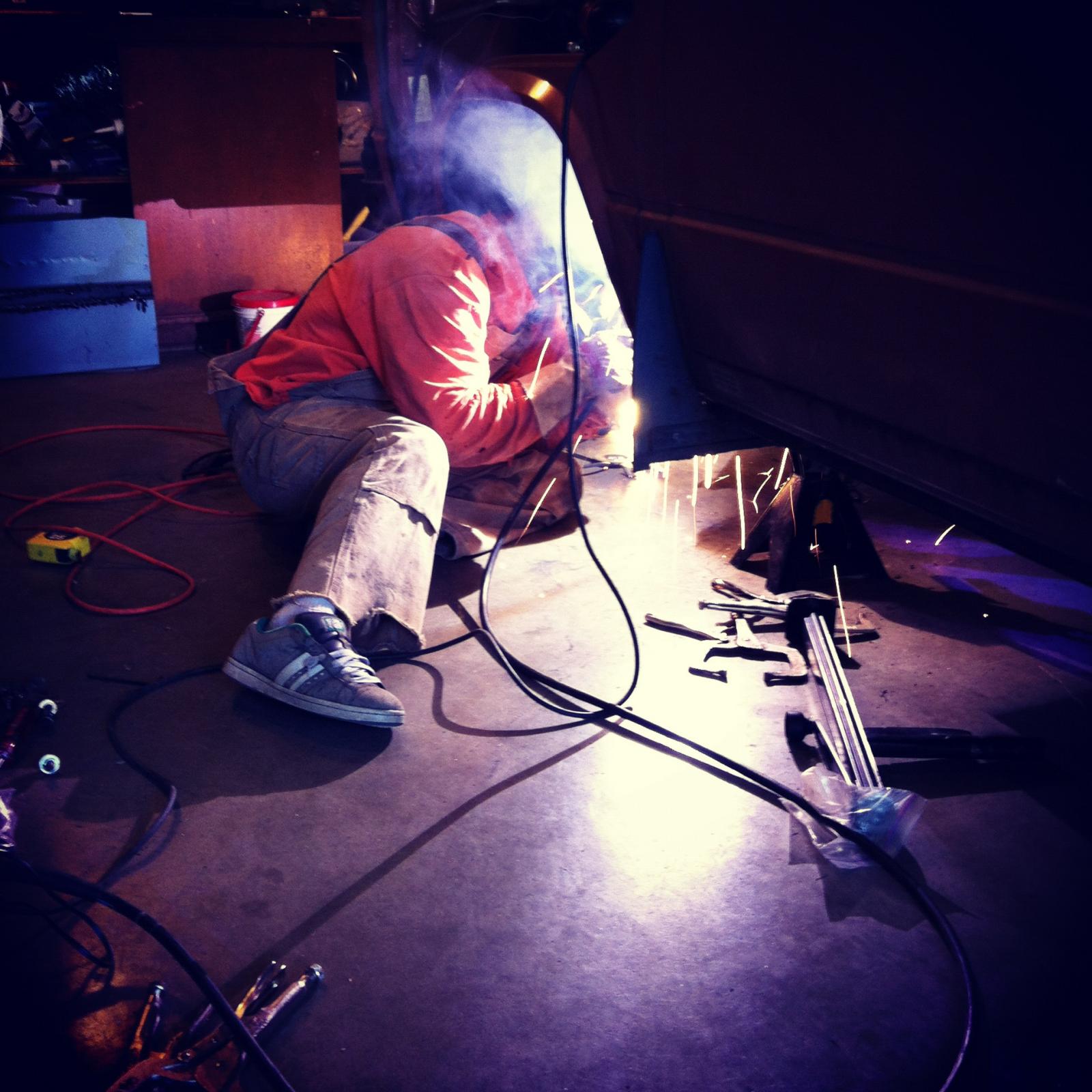

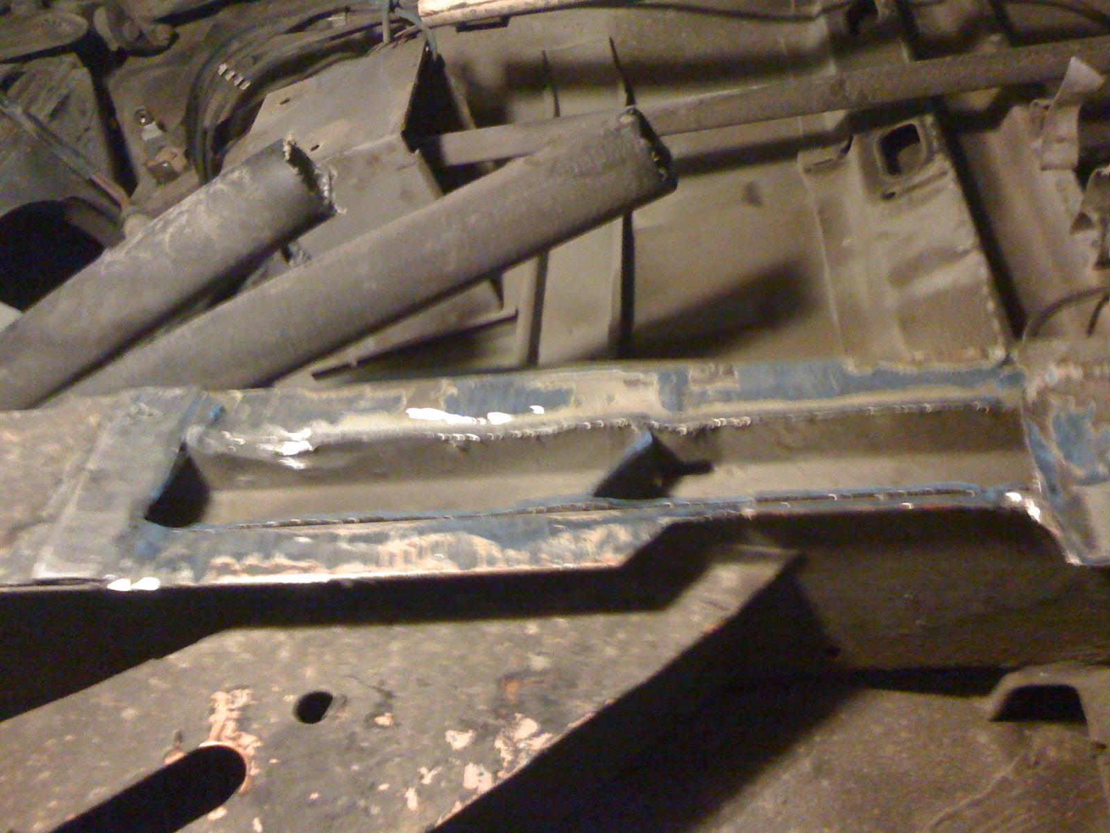

Thanks for the compliments guys. After I cut the holes for the rear part of the subframe I moved on to the front part of the subframe. From removing the 2wd suspension there is a void that needs to be replaced. I used a 1/8" steel plate 4" x 11". All of the metal that I have used on this project I have purchased from onlinemetals.com This place is awesome and has no minimum orders. Us in Seattle are lucky because we can pick them up will
call and save shipping!!
Here is where I make the disclaimer that my friend Joe did almost all of the welding on this project. I bought a welder during the project and have done some stuff(gas tank support bracket, 16" reinforcements, and the skid bar mounts and a couple other small things) but I left most of the welding to Joe as he is professional welder and does great work!! Once we had the plate welded in it was time to drill the holes to mount the subframe. We mounted the subframe using the 4 rear bolts which sucks the subframe right in perfectly. I measured against Joe's van just to make sure that it was completely perfect and then drilled holes. I still had the sections of the frame rail cut out where the subrame front mounts. I took the passenger one and flipped it upside down and bolted it to the drivers side and vice versa. This lined up the holes I needed for the sway bar mount so I could just drill through the holes in the donor syncro.
You can see the two holes towards the rear...these are what you are drilling for the sway bar mounts.
Power steering rack was next. Since I cut this out of the donor we grinded it down flush. At this point the curves of the syncro power steering rack nestle right into the vanagon. Again we measured(way too many times) and Joe welded the steering rack in.

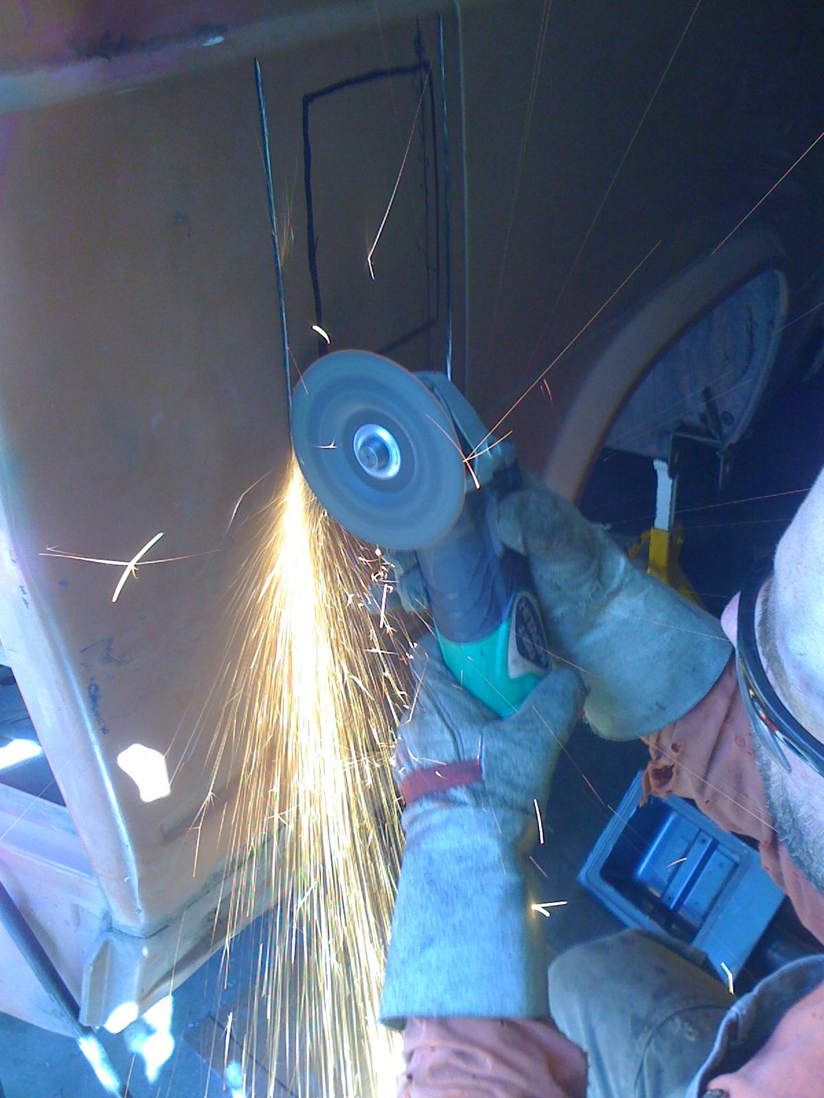

The battery boxes need a corner cut out so there is a little more room for tire clearence. I cut out the corners and Joe welded in triangles.
Donor syncro battery box
My van cut out
Finished with triangle of metal welded in

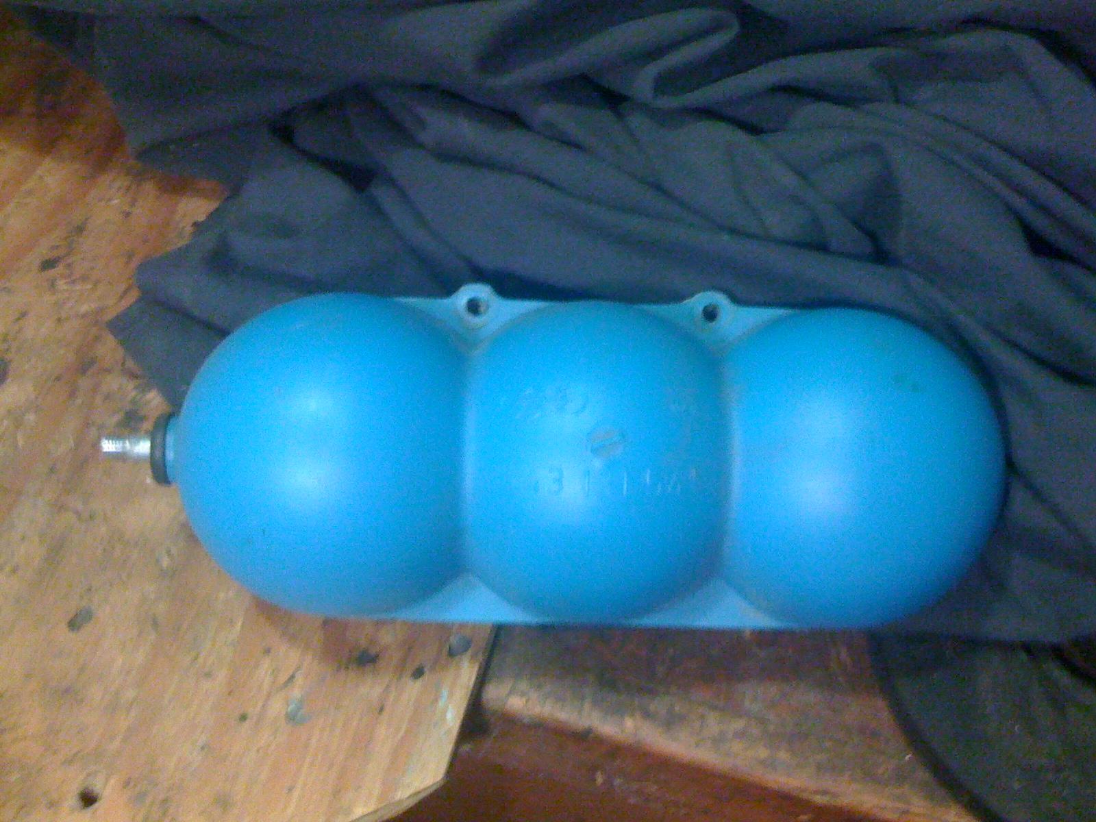

For the locker air storage(triple bubble) there are two threaded rods welded in. I got high grade bolts, cut off there head, and welded them to my van. The actual triple bubble came on a ton of vw in the 80's and 90's including the Jetta and Passat. I got mine off ebay for $20..mine was off some Audi and is blue.
I got some aluminum tube and threaded the end,popped that throught the rubber seal, and the air tank is ready to go.

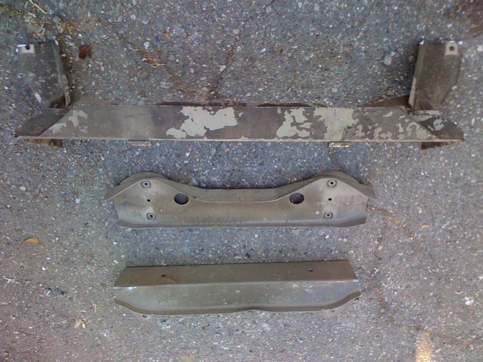

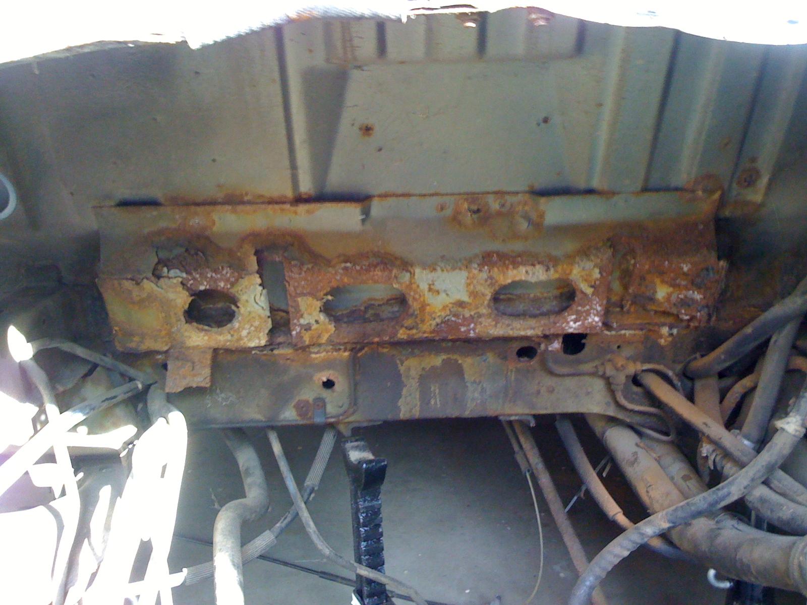

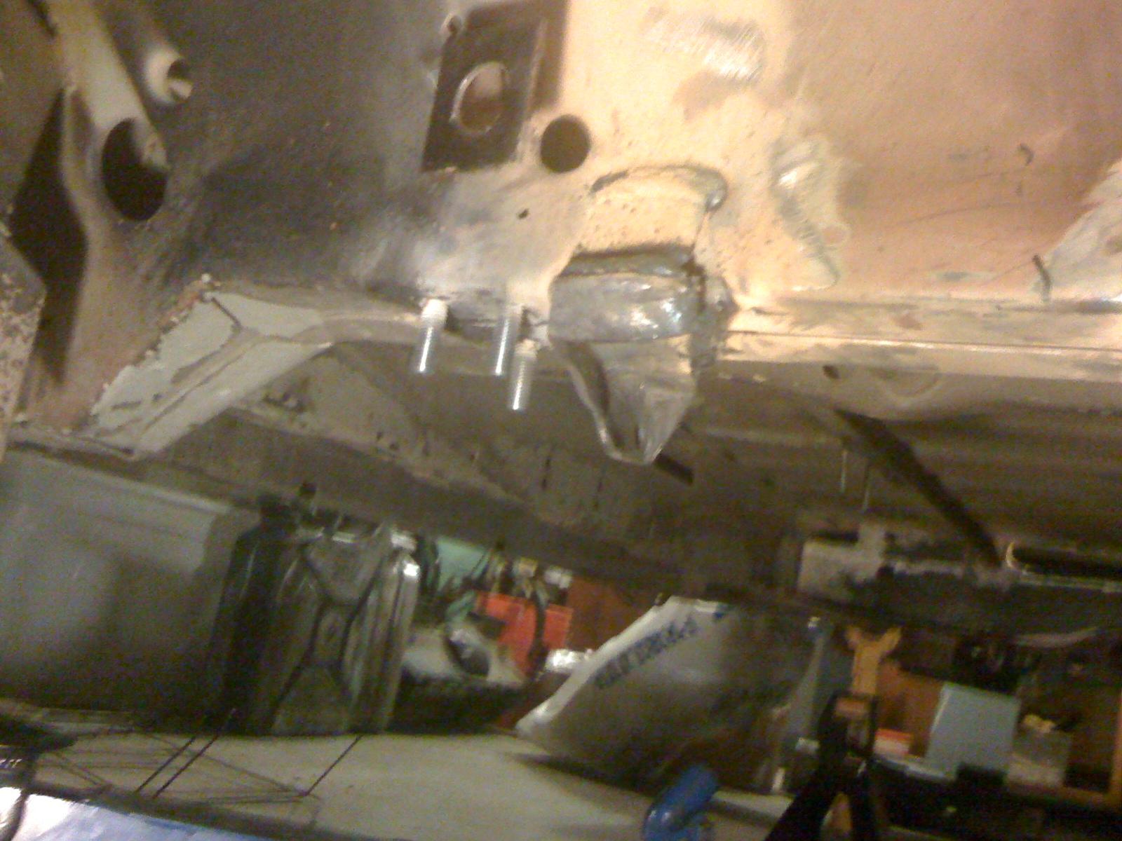

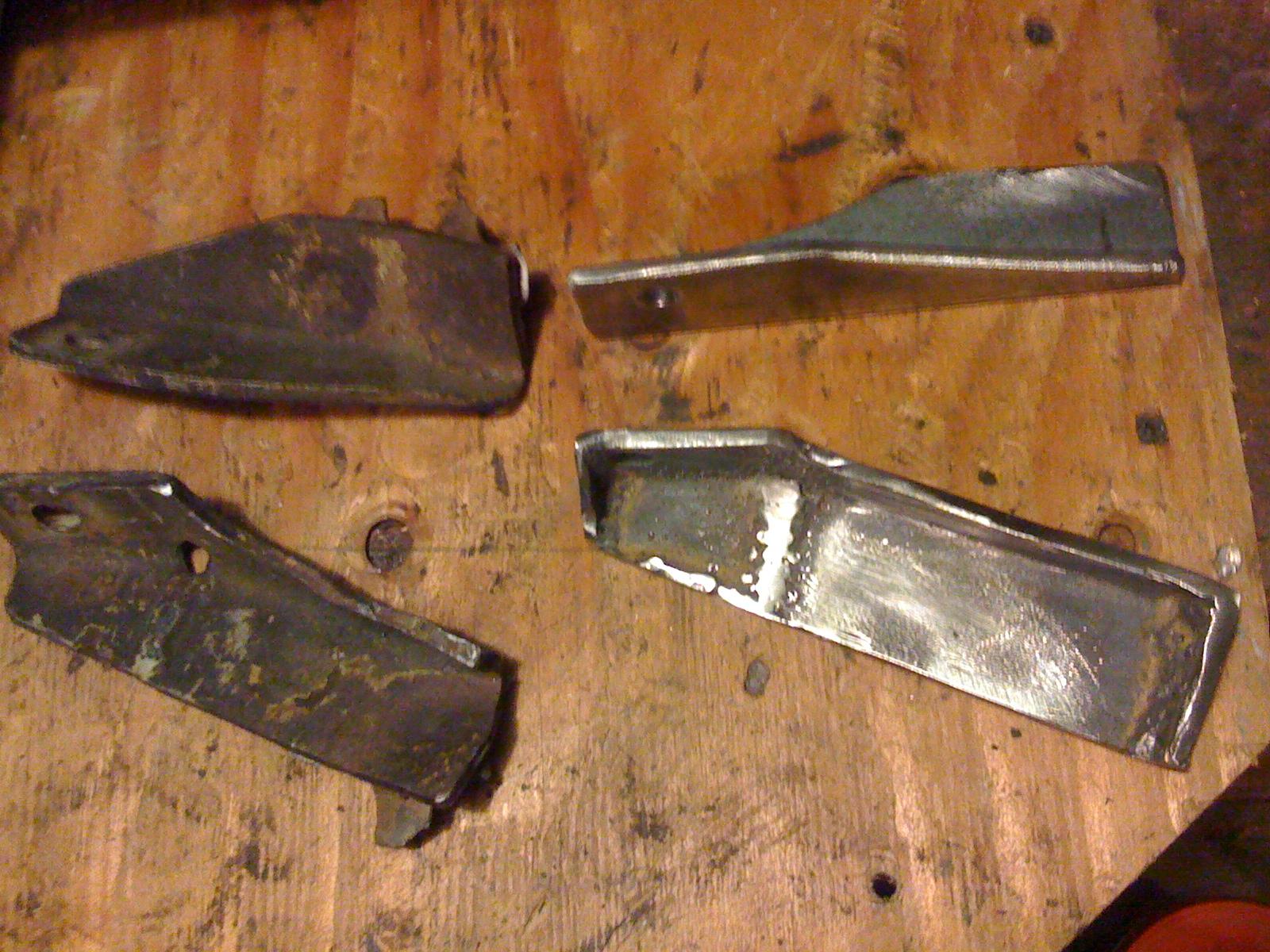

On the donor syncro the gas tank support was too rusty to use. The bottom part where the gas tank straps attach was so rusty it broke when I just touched it. I looked at some different ideas for brackets and settled on the one Mark posted. I welded some angle hot rolled with 1/8 plate cold roll behind it. Welded two captive nuts for the straps to attach to and drilled two holes in the 1/8 steel backing. I drilled two holes from the inside cabin area and put bolts through that were welded into place. Now the gas tank support just slided on the fixed bolts. This was my first welding project. It will be powdercoated before reassembly.
Pic of the donor syncro rusted out
Pic of a second gas tank support I bought with the new one above it
Pic of it finished just waiting for powdercoating!
The two bolts I had welded in to hold the tank support

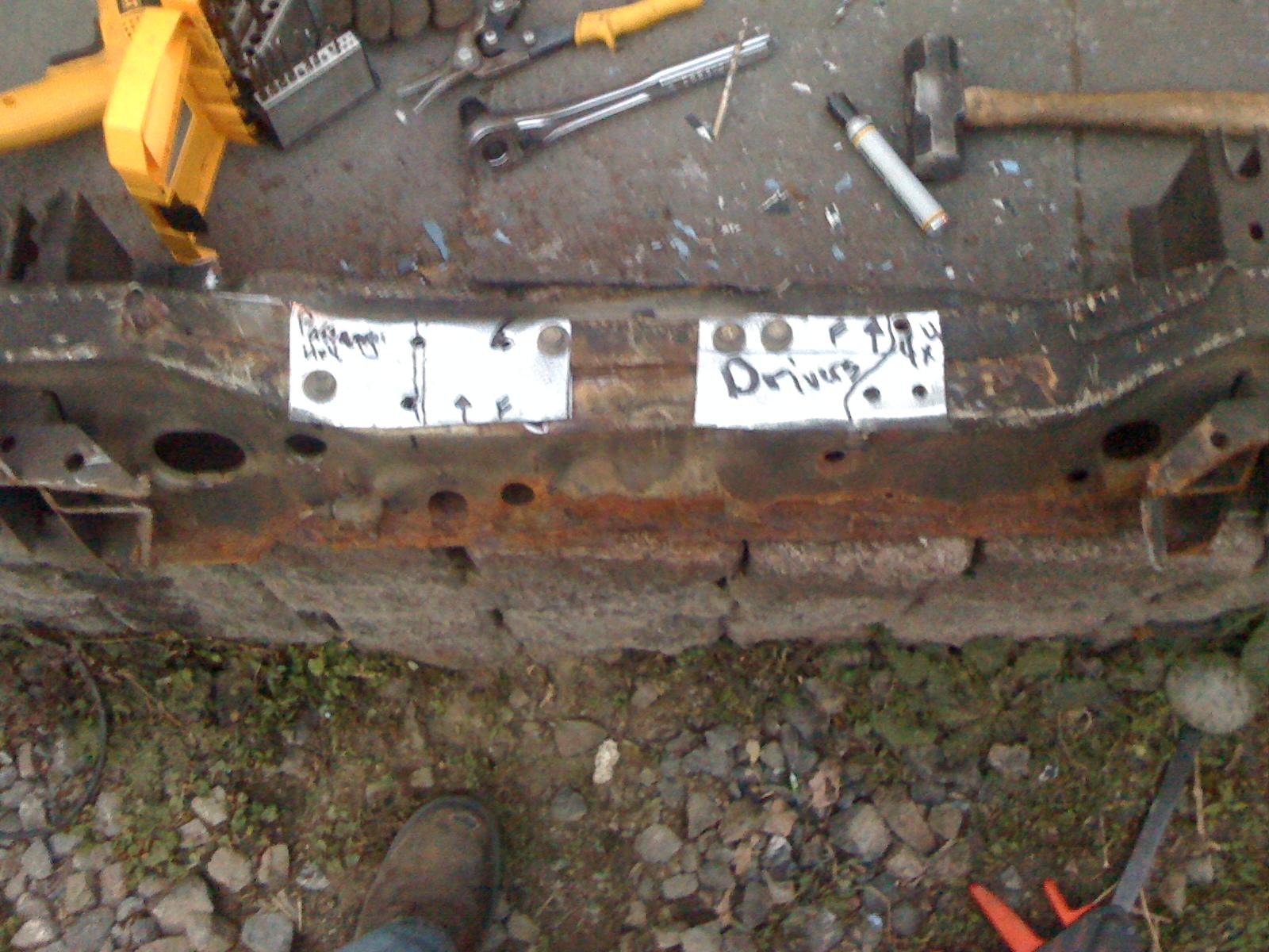

I had cut the donor whole rear crossmember out which made it a lot easier to work with. Using a mini sledge I was able to pound off the driveshaft protection bars mounting points. After these were off I was able to fab some new ones up. I wanted to improve on the originals so I boxed in the available ends and made them slightle longer towards the rear. On the extra tab towards the rear I put steel welded to the rear side of the crossmember.
The transmission mounts were one of the worst parts of the job. Joe did these and did an awesome job. I didn't take any pics of the actions but have after shots. I made templates on the donor syncro crossmember out of sheetmetal that bolts into the two wheel drive mounting spots. I banged the edges of the sheetmetal arount the donor crossmember , that way the templates had a specfic shape that could only go one way This way I was able to bolt the template up and drill the six syncro transsmision holes. I decided to put bolts down rather then put recessed nuts in. The drivers side was perfect....mount slides on very easy. The passenger side was more difficult due to the fact that one bolt comes in from the side. I had to cut the angle bolt shorter so the bracket can fit on. If I did this again I would do bolts except for the angled one which I would do a recessed nut. i think it would be easier that way.
