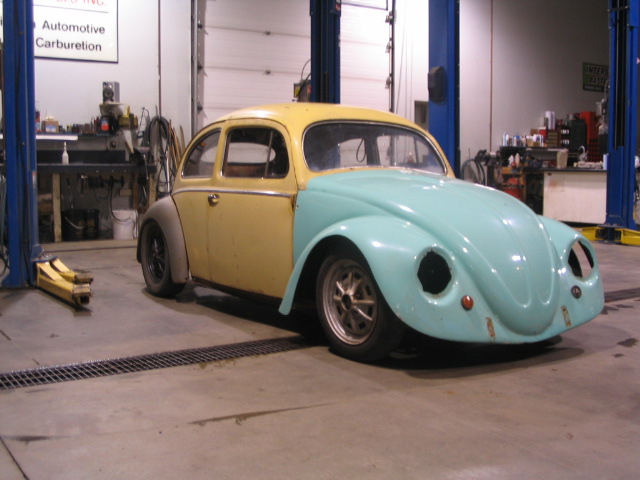

Well I ran my buggy in 2010 to 115 mph in the standing mile at Bonneville, next year I'm going back with my buggy and hopefully my latest project, a 57 that was saved from the scrap steel man a couple of weekends ago.
It's going to sit on the 71 pan that was originally under my first car 25 years ago. The chassis mods include changing the bulkhead to fit a kingl/ink 4" narrowed frontend with dropped spindles and disk brakes and raising the rear torsion housing 3 inches and lowring the rear one inside spline using HD springplates and torsion bars. Steel mounts will be used for the tranny as well as a Berg mid-mount. Rear brakes will be disks as well.
A 'glass areodynamic front end will be used (don't cry the front clip is going to be used to fix a 54. the rear will be all steel with the parcel tray being lifted 3 inches. I'm hoping to use as much of the factory metal as possible.
Engine will be a dry sumped, aluminum cased, 2332 with CNC heads and 48 Webers. Gearbox is yet to be determined but either a 3.88 or 3.44 R/P will be used.

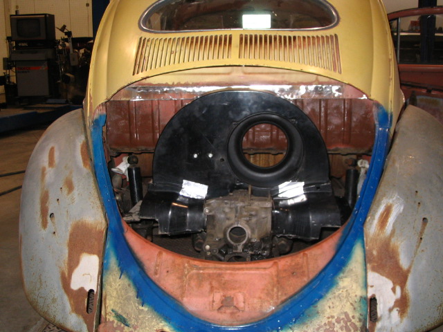

I started the biggest body mod today. Raising the rear parcel area 3" to match the raised torsion housing. I want the interior to look somewhat original and a big aluminum engine cover wouldn't do that.
Here's before
And after with rear section set in place. With some body work will look pretty good I think.
Side veiw showing the overlap. I will trim the inside piece so there isn't as much overlap. Some relief cuts and hammer and dolly work will be needed to get everything contoured correctly
The rear wheel well showing the raise. I'll probably cut and lift the rear portion to match the relocated lip on the bottom. Most of it needs to be replaced with good metal anyways and also some room added for the bigger motor.

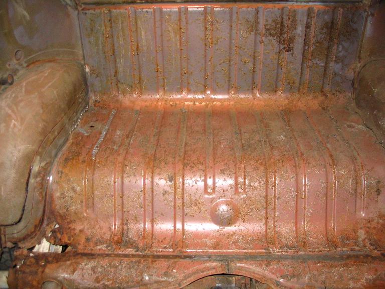

Stripped the pan tonite to get ready for cutting the tunnel and raising the torsion housing this weekend.

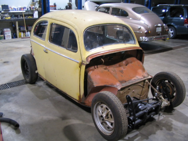

Got the torsion housing rasied today. Not a hard job, just lots of details to pay attention to. MEASURE 5 times cut once. then measure 10 times and weld. I've never done it before so it was about a 6 hour task from tear down to dropping the wheels back on the ground.
If anyone is interested in the plates to do this, PM me and I will give you the name of the supplier. Be forewarned that he will not sell to you if he doesn't think you are up to the task and can complete it competently. You WILL FK up your car if you do this wrong. He's a great guy, but doesn't want people to use his parts if they aren't able to do a safe job.
Here she is with a mystery rider
Tried it out with a rear wheel I had built for the buggy. Need to have the wheels set in about 1.5 inches in the rear.
Passenger side with 185/60/15s on the rear on 4.5 inch wheels. Still too much positive offset. Good thing I have friends that build wheels for a living.

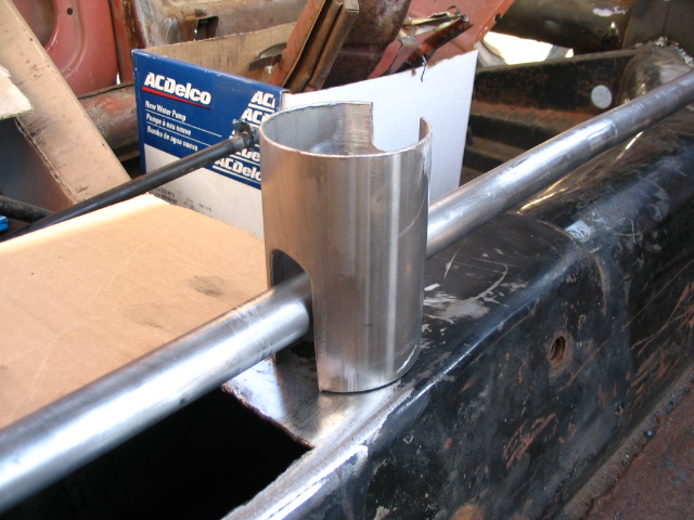

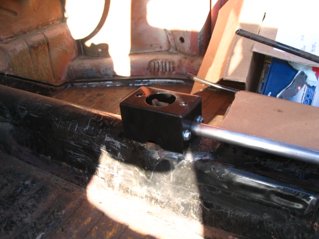

Figured out my shifter and park brake set up this morning and fabbed up a pedastal for the park brake mechanism to sit on. The shift rod is now above the tunnel so everyhting else has to move up.
I'm just using a basic buggy box as a starting point, no need to re-invent the wheel. I will probably build my gauge cluster and switch panel off of this. On my buggy I have my hydraulic park lock and brake bias valve for the front brakes mounted on it.

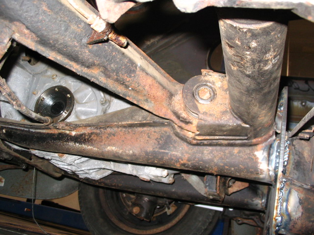

Here's some shots of the torsion raise. DLX-Fe Products supplied the plate and some gussets that have yet to be welded in. The parts and some very good directions from Doug made the job pretty easy.

You might also find that some triangular gussets might be necessary for your e' brake since is it smaller than the brake mechanism.

Chris, I'm running the same set up on my buggy and once welded into place is super strong. If it moves your pulling WAY too hard.
